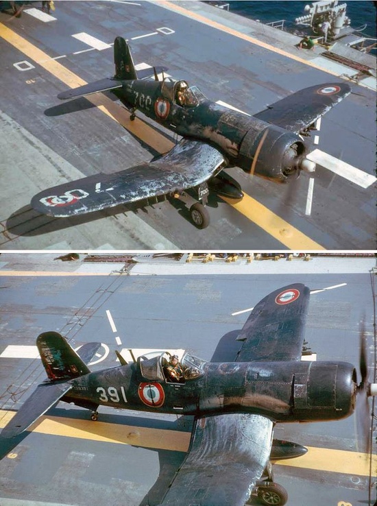

Troy Smith Posted July 22, 2020 Share Posted July 22, 2020 On 19/07/2020 at 15:43, Wez said: Were the external surfaces of aircraft like the Corsair, Avenger, Hellcat and Helldiver that were finished in the Gloss Sea Blue (GSB) scheme primed before the application of GSB? If so were they painted with Yellow Zinc Chromate primer? Did it depend upon the manufacturer? If anyone knows the full details of this, it will be @Dana Bell There maybe variance between different manufacturers in primers used though. Regarding dropping of painting, the USAAF found it acceptable. the USN did not. If you search up Corsair KD431, there is a walkround here, GSB is pretty durable Also, well worth a read Main point, that WW2 GSB ANA 623 is NOT FS15042 2 1 Link to comment Share on other sites More sharing options...

Seahawk Posted July 22, 2020 Share Posted July 22, 2020 (edited) 6 hours ago, Troy Smith said: NB. for the wider readership, the finish of this aircraft is NOT representative of an aircraft in service, even a well-used one: it's how an aircraft looks after 15+ years' use and abuse as a ground training aid at Loughborough and Cranfield technical colleges. Edited July 22, 2020 by Seahawk 2 2 Link to comment Share on other sites More sharing options...
Wez Posted July 22, 2020 Author Share Posted July 22, 2020 58 minutes ago, Seahawk said: NB. for the wider readership, the finish of this aircraft is NOT representative of an aircraft in service, even a well-used one: it's how an aircraft looks after 15+ years' use and abuse as a ground training aid at Loughborough and Cranfield technical colleges. Generally I would agree with your statement but as always, there are exceptions. I was looking into the French use of Helldivers in Indochina, on the whole they kept their appearance very well except for those areas most used by the crew and particularly the groundcrew, the wingroots in particular were quite worn, similar in fact to those on the forward part of the inner wing in the photo. As with all things, it's a case of studying your subject and applying your knowledge. 1 Link to comment Share on other sites More sharing options...

Blimpyboy Posted July 23, 2020 Share Posted July 23, 2020 (edited) Just a smidgin of undercoat showing through... Edited July 23, 2020 by Blimpyboy Link to comment Share on other sites More sharing options...
