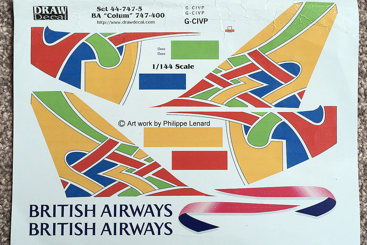

Back in the Saddle Posted November 23, 2020 Author Share Posted November 23, 2020 I agree with Keith, that second shot is rather good! 👍 I had my first session with the decals tonight, starting with the fin. First job was to cut them out: Then application, using slightly diluted Klear followed by Micro Sol to help bed them down: There is one major issue - the decal is too small! The tip of the fin should be green and yellow, but when the decal is positioned correctly at the base of the fin, the decal doesn’t reach to the top! Here’s how it should look: The decal is also too short to cover the entire tail cone, which should be completely red - see above. There is one other problem too, which I have only just noticed... On the real aircraft, the colours beneath the tailplane are yellow, green and red. On the decal they are yellow, blue and red. There’s not much I can do about that. Fortunately it is not immediately obvious, especially once the tailplane is fitted... I have contacted the supplier; hopefully I can get some swatches to fill in the areas that are still white. 10 1 Link to comment Share on other sites More sharing options...
71chally Posted November 24, 2020 Share Posted November 24, 2020 Excellent work getting the decal down Matt, but the manufacturer has definitely buggered up the tailcone area, comparing the picture of the real thing there's quite a few differences in the pattern and colours. Link to comment Share on other sites More sharing options...

Terry1954 Posted November 25, 2020 Share Posted November 25, 2020 15 minutes ago, Back in the Saddle said: James, Terry and Keith - thank you for the kind comments. The decals went on very easily, so I cannot really take any credit for the finish! I have been in touch with Philippe at F-DCAL, who supplied these. I get the impression he is mortified by the errors and has promised to rectify them and send out the new version. I will now try to remove these decals without damaging the paint underneath. I think more Klear should soften them, but I will do some research first! In the meantime, I will continue working on the wings, tailplane and engines! I had a similar experience of good service, with another decal manufacturer. The problem was different - no carrier film on a decal set, which turned out to be a faulty batch. Decals were replaced of course, and the manufacturer seemed equally apologetic. Great for the hobby that these folk want their products to work for us! One tip for removing decals I discovered quite by (unpleasant) accident - masking tape can often be used to remove decals as long as no protective varnishes have been applied. Worth a try Matt? HTH Terry 3 Link to comment Share on other sites More sharing options...

keefr22 Posted November 25, 2020 Share Posted November 25, 2020 2 hours ago, Terry1954 said: masking tape can often be used to remove decals as long as no protective varnishes have been applied. Worth a try Matt? That's definitely worth a try - and I've used sellotape to do the same before now, but that can be a bit more aggresive on the underlying paint. 2 hours ago, Back in the Saddle said: I think more Klear should soften them, I'm not sure about that Matt, I use Klear as a setting/sealing solution, and I don't honestly remember having underlying coats dissolved by more coats on top of them - quite the opposite tbh, they just seal the decals in better. I ''think'' I remember reading that applications of Microset can be used to remove decals, but that's not something I've tried. Good news about Fdcal, hope they can sort it out soon for you. Keith 1 Link to comment Share on other sites More sharing options...
DMC Posted November 25, 2020 Share Posted November 25, 2020 Hi Matt, How annoying is that. Rather than strip the decal I was going to suggest a dab of paint, Vallejo intermediate green for instance, looks a good match, but that was before I read about the blue. Whatever you decide on good luck with it. Dennis 1 Link to comment Share on other sites More sharing options...
71chally Posted November 25, 2020 Share Posted November 25, 2020 In fairness that design gets quite complicated under the tailplane line, I wonder if the decal manufacturer only had upper angle shots available to work from. Is there any scrap decal that you might be able to cut to shape and use? The Drawdecals seem to suffer with a similar issue. Thank you all for the kind comments, as these grand old aircraft bow out one by one I'm very eager to catch their last flights, but vary the angles etc a bit. There's only three left now, G-BYGD, 'GC and G-BNLY, the first two are due to us, 'GD this Friday. All quiet on 'LY though. 1 Link to comment Share on other sites More sharing options...
