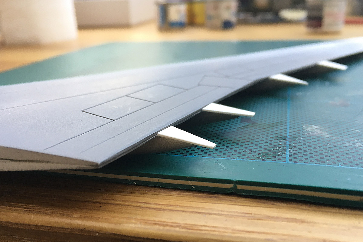

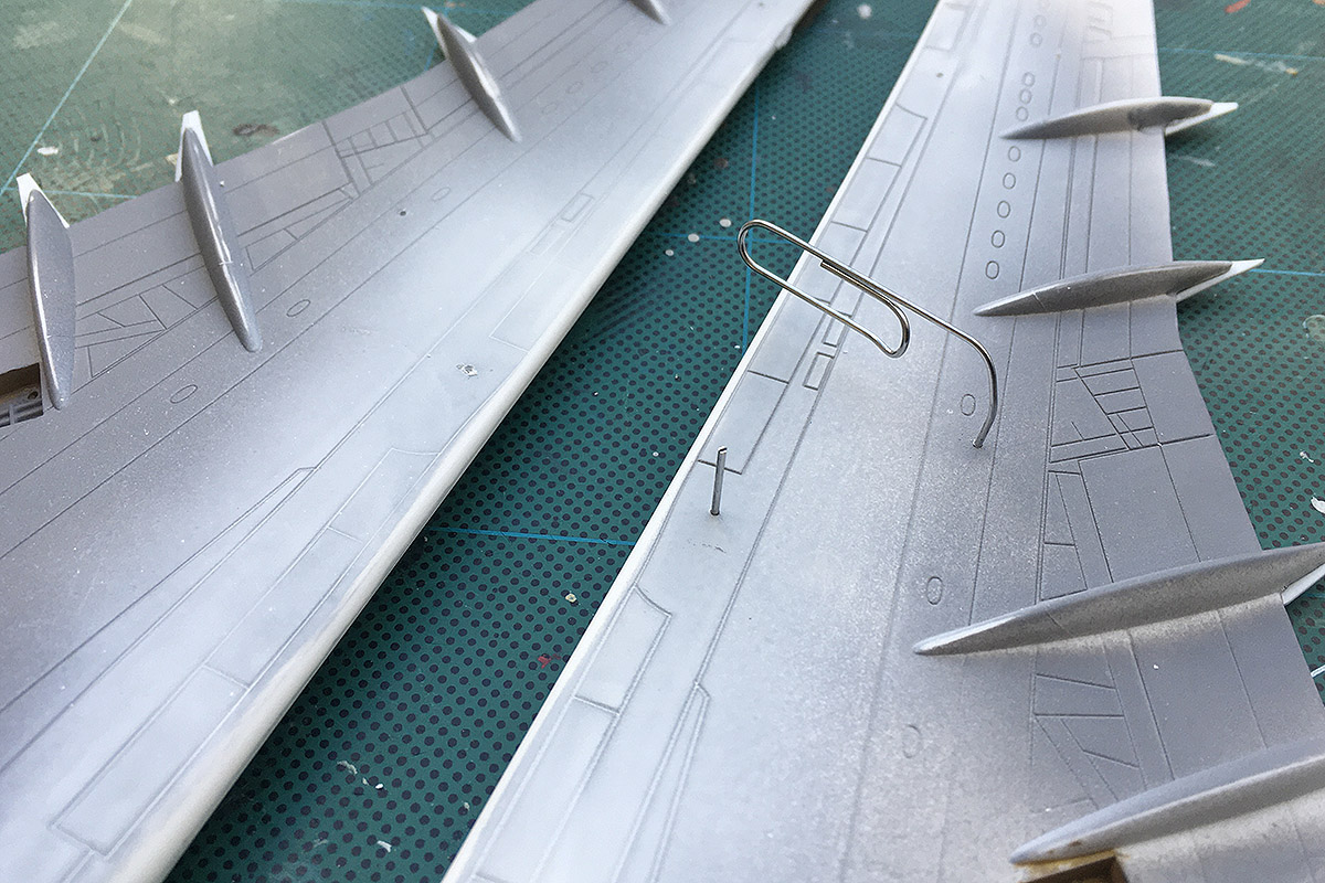

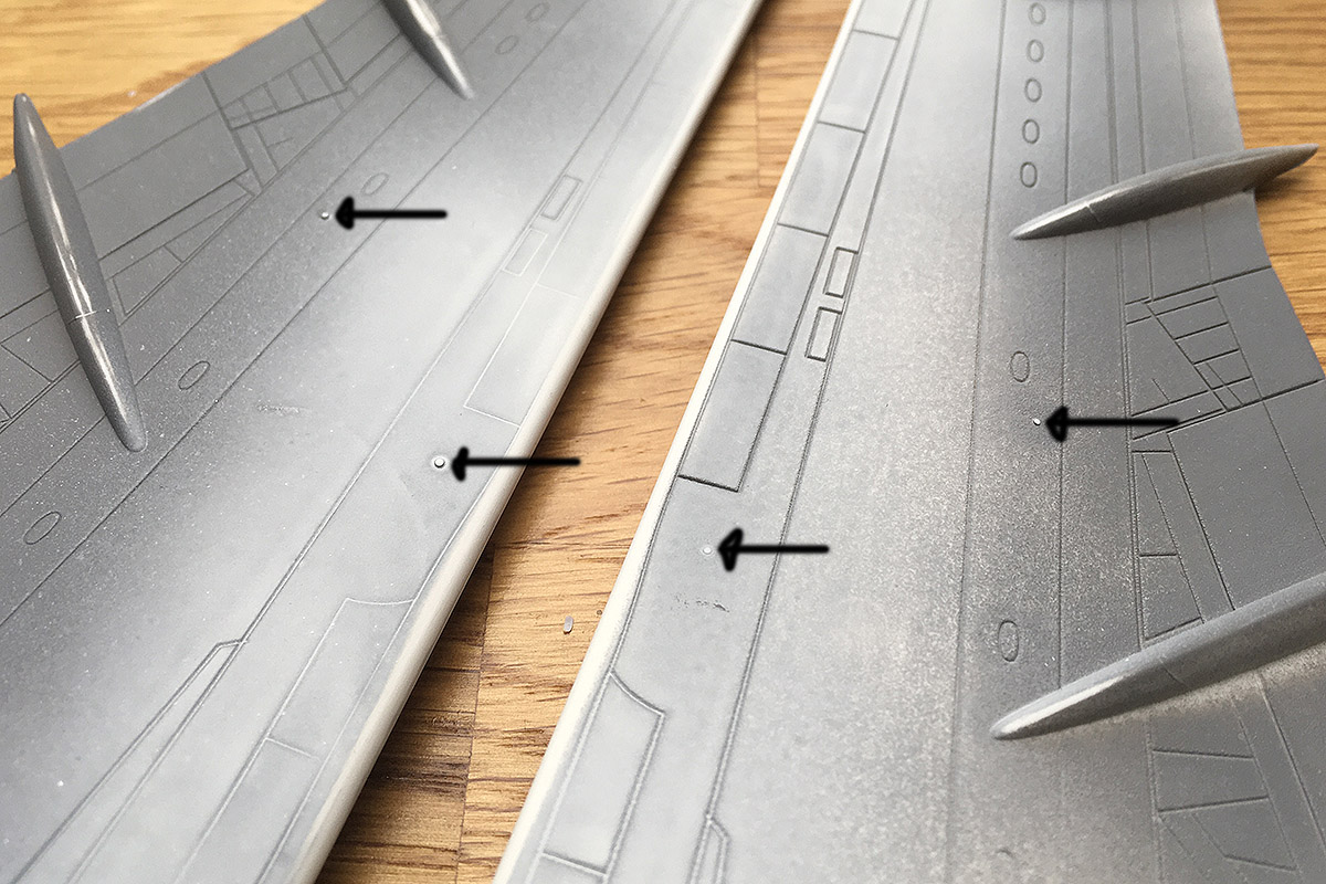

Back in the Saddle Posted October 23, 2020 Author Posted October 23, 2020 Right, update time...! Fingers crossed the images show as planned.🤞 The locating pins for the engine pylons are almost non-existent and certainly won't help with getting the alignment correct when I try to attach the engines. I've added the arrows to help show the tiny pins: I drilled the pins out and will use little sections of paper clips to secure and align the engine pods: I have also started work on the flap canoes, as you can see above. They need to be slightly higher. Here's a better view: Once these have set, I will trim, fill and shape as required to get them looking better. I will also thin the trailing edges down a bit more! 7

71chally Posted October 23, 2020 Posted October 23, 2020 (edited) ...Yep, all good here, thanks Matt. Excellent progress, great idea using pins for the engines locations, and the flap fairing levelling with the wing. Edited October 23, 2020 by 71chally 2

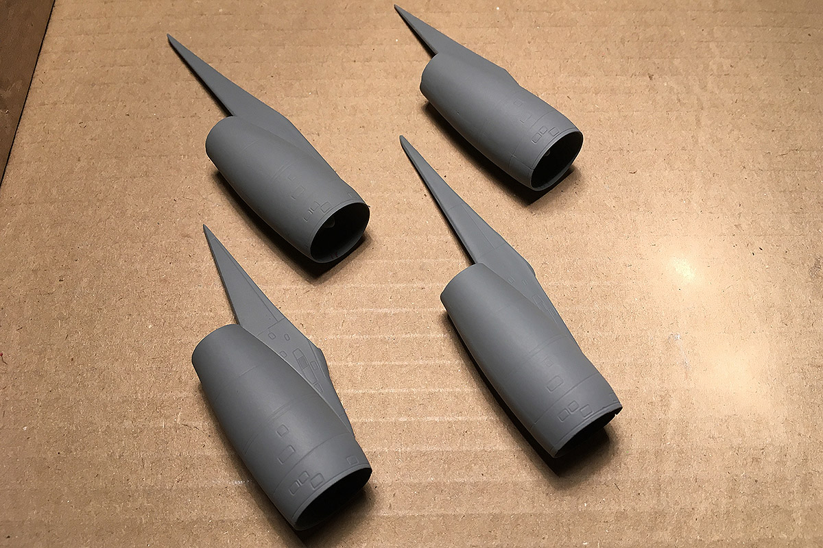

Back in the Saddle Posted October 25, 2020 Author Posted October 25, 2020 On 24/10/2020 at 18:15, Terry1954 said: Not a lot of runway for a 747 surely? Not a huge amount, but 16 brake units and an empty aircraft stop quite well! On 24/10/2020 at 20:41, keefr22 said: Was the go-around for a sighting look at the runway - or did the crew just fabcy a last few minutes in that lovely jet?! I don't know the reason, but the airline's policy is to go around if you are not happy with any aspect of the approach. That is particularly important with a limited runway length, but the policy applies on all landings - it's always a safer option to go around and make another approach. 4 hours ago, 71chally said: This was G-CIVF departing for Newquay today, Another stunner James! 👍 I primed the engines today and they look better than I expected: A few minor gaps to fill and then a coat of white primer awaits! 7
71chally Posted October 25, 2020 Posted October 25, 2020 (edited) Thanks Matt, I've been waiting forever to get a reasonable take-off shot and today everything aligned, I wasn't at work, it was a runway 30 dep, sun was in the right place, and there were lovely cloudscapes, so well chuffed. My friend at Newquay got a nice shot of it landing with a rainbow behind it. Those engines and pylons look very good, they look to be the stronger part of the kit actually. You've done a great job joining them and prepping them. Edited October 25, 2020 by 71chally 3
