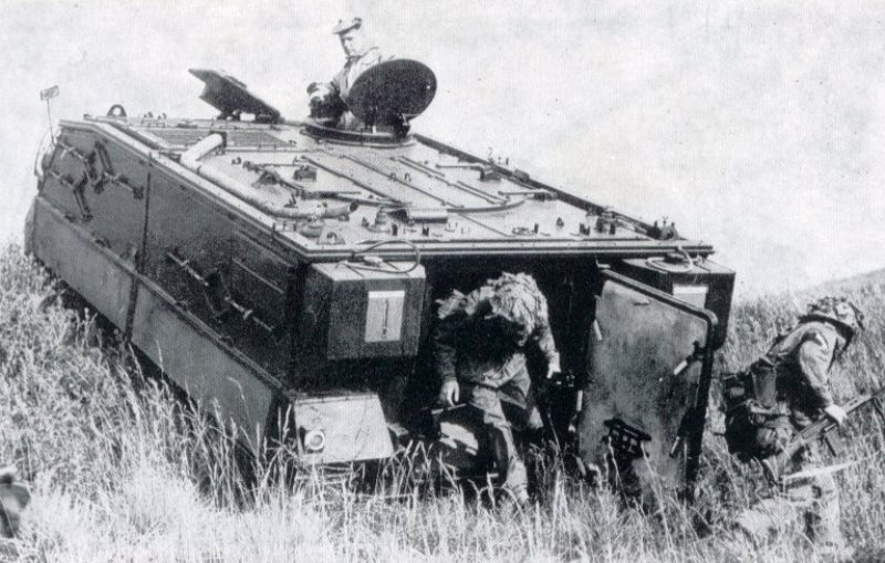

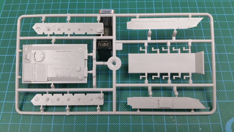

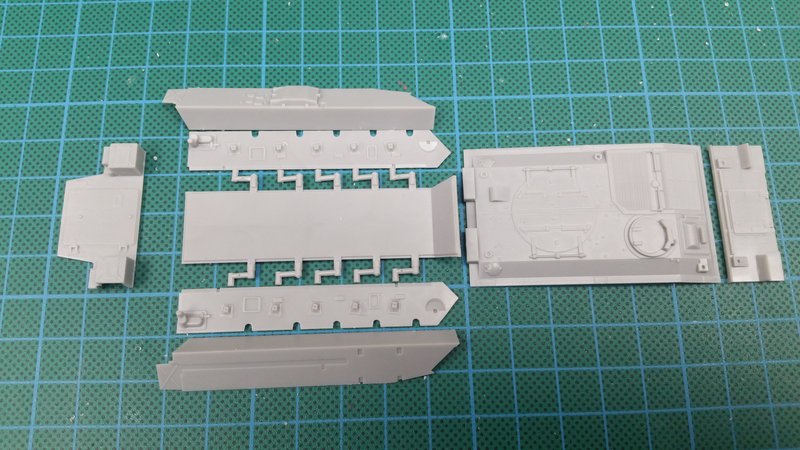

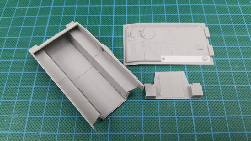

Courageous Posted July 16, 2020 Author Share Posted July 16, 2020 With the Vickers VI Light Tank on hold due to await parts, it's time to start on this sucker. Skipped stage I as it was wheels, later. Here are the hull parts for stage II, nice and crisp with no flash. Downloaded this image from https://www.zonerama.com/BAORphotoalbum/761317 With the hatches and doors set above, I have to decide what needs opening and will most probably be the main rear door and the commanders hatch, I'll leave the other bits for another day. Will need to try and find some modern British infantry too. Also from the same site: this useful pic will be helping me out for the main compartment. Their is a pic for the drivers position but...no. Stuart 5 Link to comment Share on other sites More sharing options...

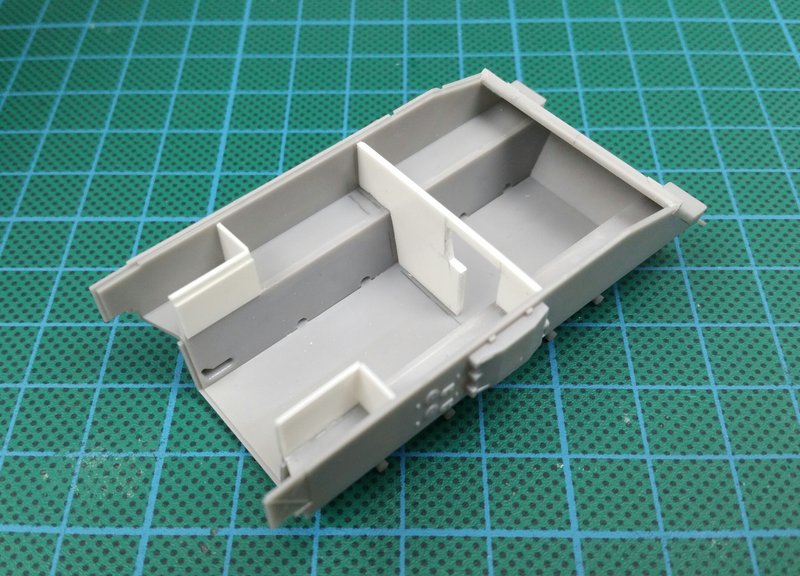

Courageous Posted July 20, 2020 Author Share Posted July 20, 2020 A gentle start... Floor, sides and the front cemented together and the main bulkhead positioned marked thus. Gaps are evident where the sides meet the floor, soon sorted with some PPP. In this scale, I'll be concentrating on the big lumps in the main compartment; internal fire extinguisher system, NBC system, seats, etc. If/when I remove the commanders hatch I'll decide what to do inside but seeing that I'm going to stuff a commander in his hole, there may not be much to see. Back door will be hacked out of the rear section. Stuart 3 Link to comment Share on other sites More sharing options...

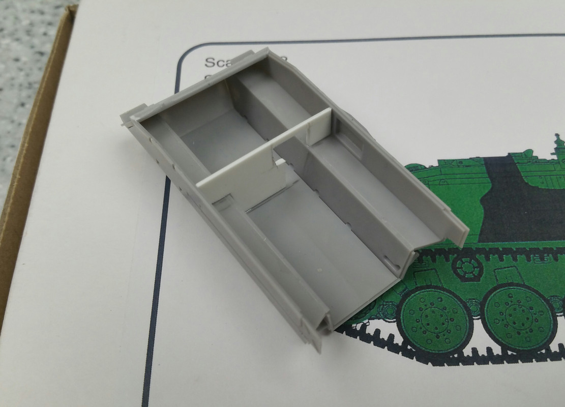

Courageous Posted July 21, 2020 Author Share Posted July 21, 2020 Another step forward. The bulkhead was a little fiddly to produce as I was only working from photos but here it is fitted. Stuart 3 Link to comment Share on other sites More sharing options...
Courageous Posted July 22, 2020 Author Share Posted July 22, 2020 More inside work Don't know what's inside those box sections but they're on everything I've looked at. Stuart 2 Link to comment Share on other sites More sharing options...
Dads203 Posted July 22, 2020 Share Posted July 22, 2020 Fuel tanks mate, you won’t get far in a 432 without them, 1.5 MPG cross country 1 Link to comment Share on other sites More sharing options...
