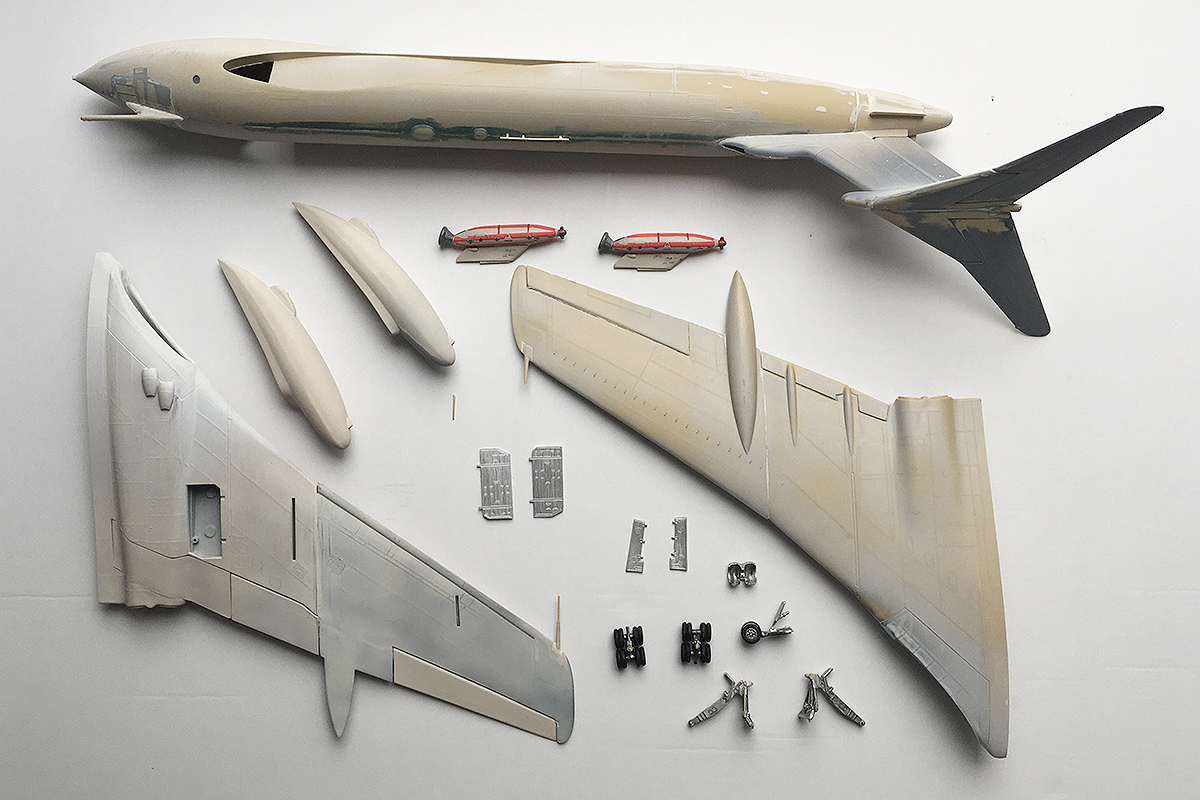

Back in the Saddle Posted June 3, 2020 Posted June 3, 2020 Having finished the Buccaneer, it's time to turn my attention to the next model on my shelf of doom - the 1/72 Revell HP Victor: It's not the first time this model has appeared on BM. It was on the recent KUTA GB at the end of last year, but never quite got finished... That build was a bit of a nightmare (the intakes immediately spring to mind!). If interested, that build is documented here: Since abandoning work on this model, I have taken delivery of the new Airfix version of the Victor - a vastly superior kit: My original plan was to have just one Victor, painted in the camouflage scheme. However, now I have two kits I want them to look different. I've decided that the Airfix kit will be getting the camouflage scheme, so what to do with this model? Two options: 1. Keep it as a K.2 Victor and paint it hemp 2. Convert it back to a B.2 and paint it white I've changed my mind a few times on which is best! I've finally decided to go with the second option, mainly because the Airfix kit has also included spare decals for this version and they are much better than the Revell offering... Also, I think white paint suits the aircraft better than hemp! So here's the current state of play: Obvious jobs include discarding the refuelling pods and underwing fuel tanks then filling those four holes in the wing. I could keep the wing tanks, but in the interest of making both models look different I think they should go - the camouflaged Victor will have these fitted and most photos of the white Victors show the aircraft without them, so that is a more representative way to portray this aircraft. A bit more surgery will be also be required on the belly to remove the central refuelling area. With any luck this will be a relatively quick project! 5

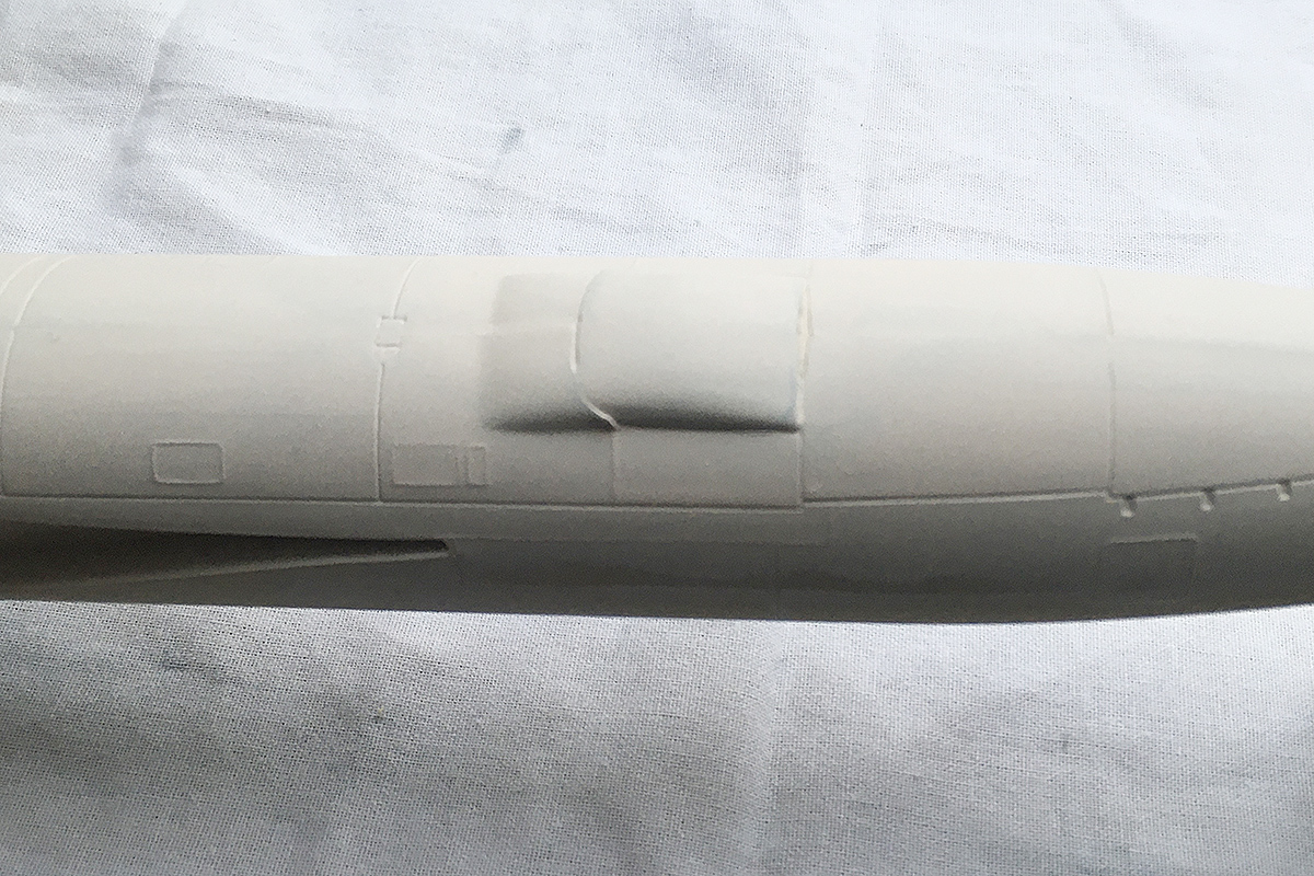

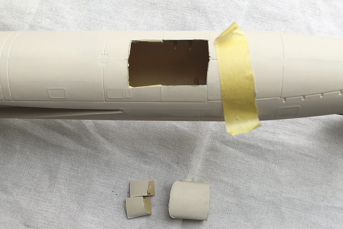

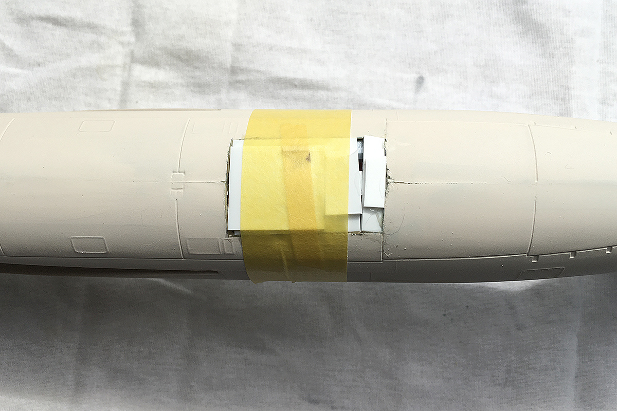

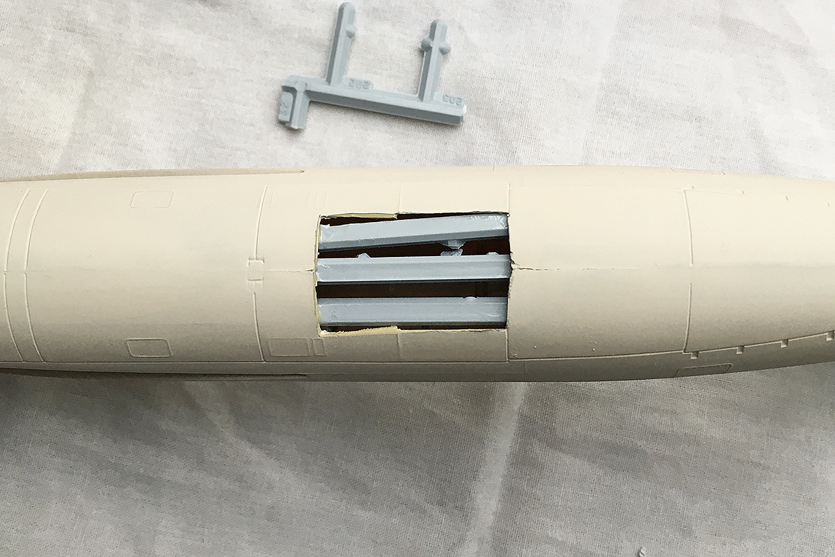

Back in the Saddle Posted June 5, 2020 Author Posted June 5, 2020 Time to do some work on this! I started with the refuelling station on the aircraft's belly: It had to go... A few minutes with a razor saw and scalpel left it looking like this: The fuselage split open slightly whilst sawing, hence the tape to hold it together as I glued it back. Next job was the addition of some scrap sprue to form a base for the new surface: I then glued some plastic sheeting over these bits, to form the basic shape of the lower fuselage, held down tightly with tape: PPP features highly in the next stage of this conversion! 😁 6
stever219 Posted June 5, 2020 Posted June 5, 2020 You, sir, are either brave or barmy! i started a similar conversion on the Matchbox kit when it was first issued. Two house moves and a teenaged daughter (amongst other things) and it is still unfinished somewhere in the loft. My conversion was inspired by an article in Scale Models magazine, one of a series covering RAF bombers and hacking out the HDU fairing was one of the early jobs. The chap who wrote the piece for SM had the luxury of a spare set of bomb doors from another kit; mine involved lots of plasticard and Milliput. You’re going to need to do some more work on the wings; firstly the lower surface joint just behind the outboard leading edge is horrible and need filling and smoothing to give a smooth undercamber. The tips need extending to match those of the Airfix kit (maybe someone on here could let you have a spare set if they’re building the Airfix kit as a tanker once the coved-19 restrictions are eased). It’ll be nice to see someone tackle this conversion again, but I’m not going to look for mine again just yet. 2

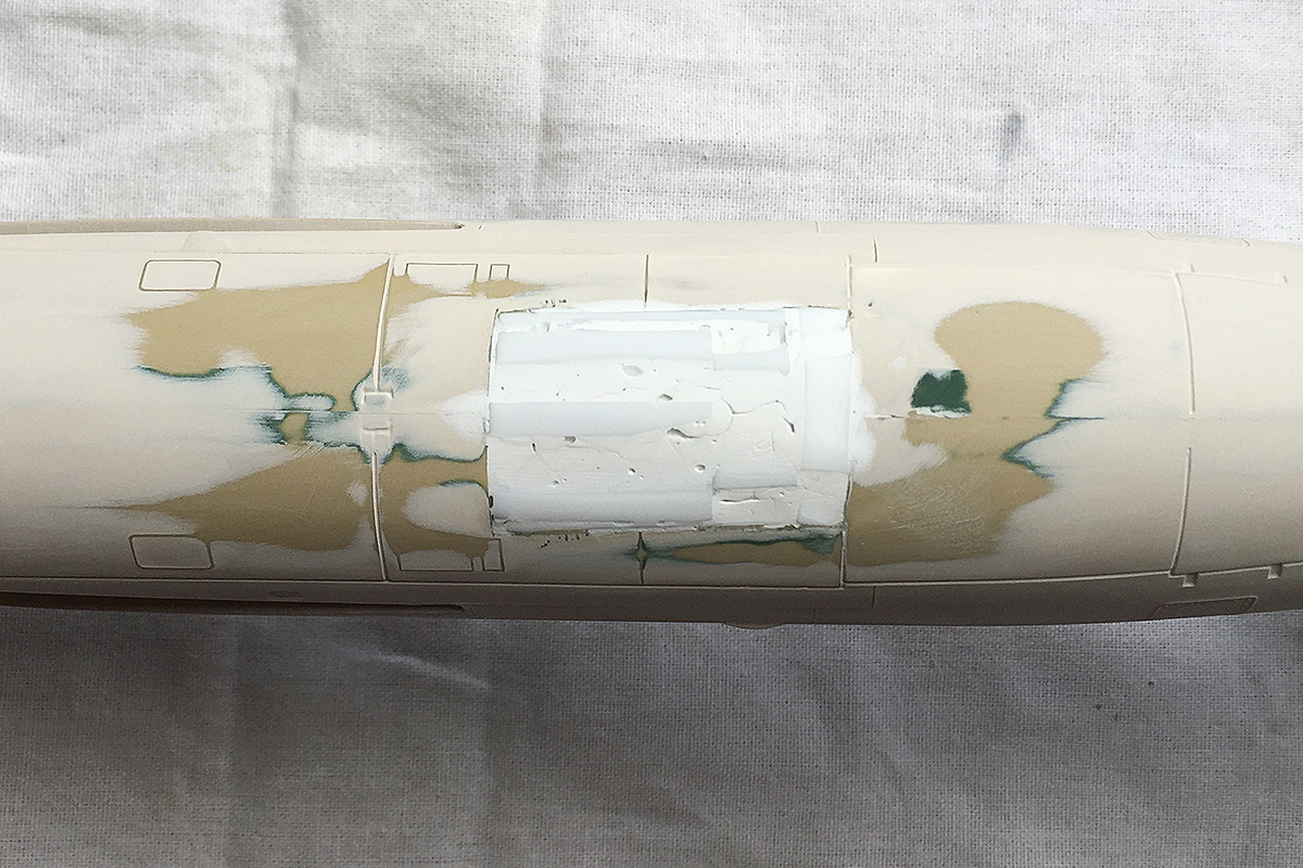

Back in the Saddle Posted June 7, 2020 Author Posted June 7, 2020 On 05/06/2020 at 21:26, stever219 said: You, sir, are either brave or barmy! Or maybe just naive - I hadn't realised there were wing mods required too! 😁 Work on the fuselage continues. PPP was applied liberally to the central refuelling area: Then sanded back: All very rough at the moment, but some more filler will fix that! I also took a look at the extended wingtips which are in the Airfix box: I will use these as a guide for converting the K2. 👍 I will do some more work to the fuselage first before turning my attention to the wings. 2

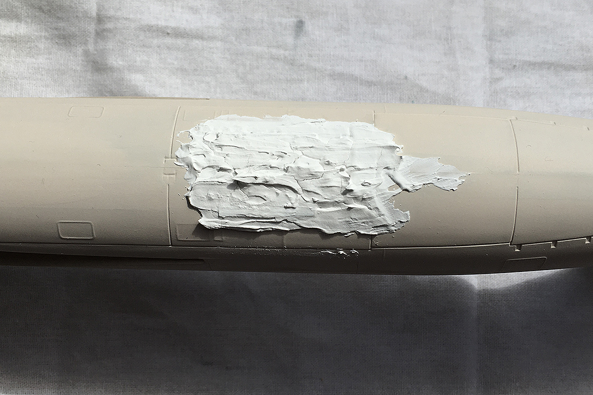

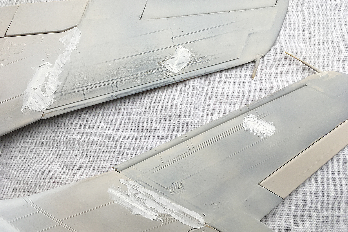

Back in the Saddle Posted June 9, 2020 Author Posted June 9, 2020 The belly conversion is coming along slowly. I have sanded and filled with PPP twice, but despite using a sanding block I have managed to sand away more PPP than intended - I suspect the foam backing on the sanding block was allowing it to attack the PPP to a deeper level than planned... To remedy this, I have glued some very thin strips of plastic over the PPP and will use a solid sanding block next time! Here's how it currently looks: The wing slots have now been filled and will be sanded shortly: I'm also considering my options for converting the wingtips! 2

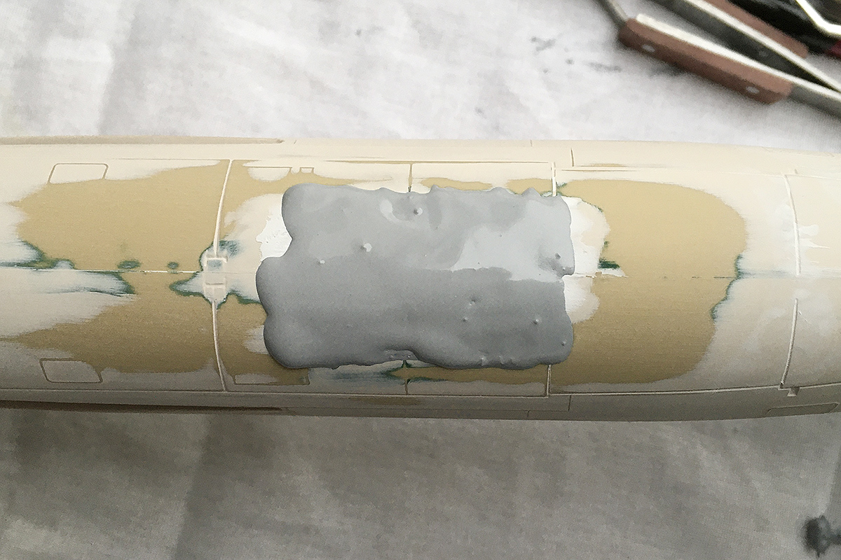

Back in the Saddle Posted June 11, 2020 Author Posted June 11, 2020 The additional strips of plastic (along with a more solid sanding block!) have helped considerably. Tonight it all looked pretty smooth with just a few minor blemishes, so time for some Mr. Surfacer 500: I'll leave it overnight then sand and repeat as necessary... 3

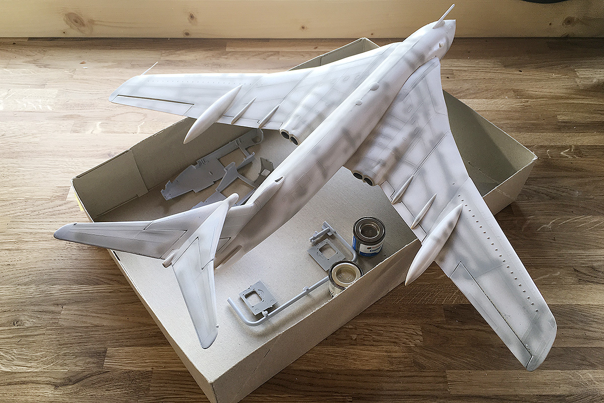

Back in the Saddle Posted June 30, 2020 Author Posted June 30, 2020 Now the rain in Scotland has finally stopped I have ventured outside again for some spraying. I decided to give the Victor a pre-shade in grey, as that colour was already in the brush for the Lynx... In addition, I'm hoping that it will cover more easily than a black pre-shade: The probe on the right wingtip has broken off, but I haven't bothered to repair it - I'm sure it wouldn't have lasted long anyway, not with with an 8-year old playing with it! It has also had a pass of white paint, but I think another coat will be needed - maybe two. White is not my favourite colour to spray!! 1
