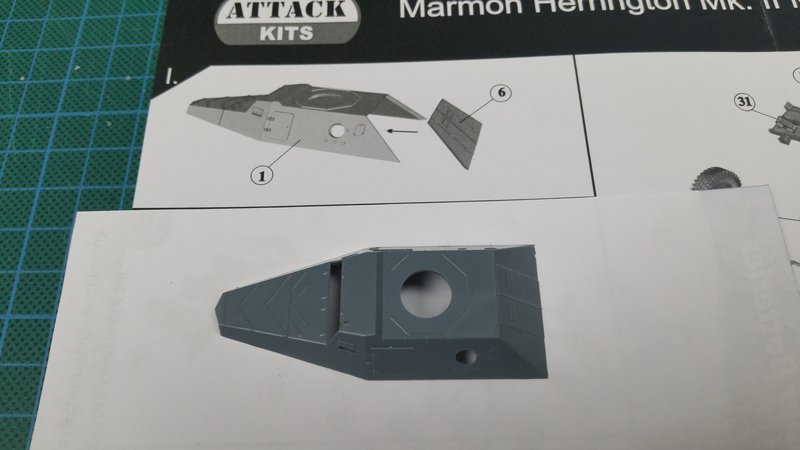

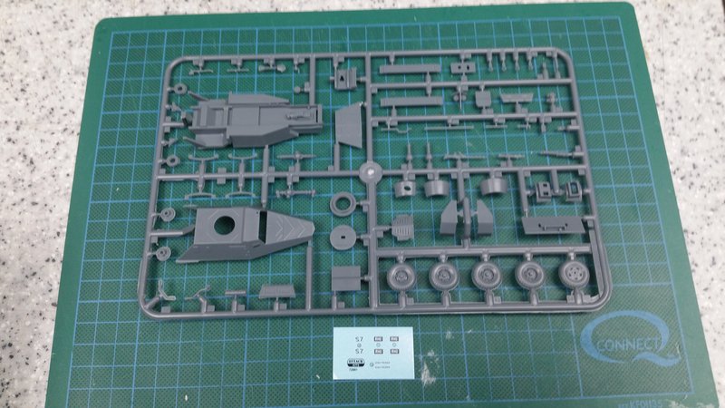

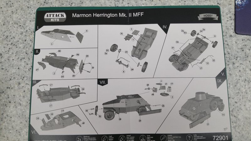

Courageous Posted June 3, 2020 Share Posted June 3, 2020 Hi people, another braille scale model for you. This time it's a Marmon Harrington MkII Armoured Car in 1/72 by an unknown manufacturer to me, Hobby Attack Kits that I picked up at the East of England Model Show held at Peterborough earlier this year. Front box art Rear box art. I'll most probably do the RAF subject. Sprue shot with a small decal sheet. Picture instructions. An obvious limited run kit. A quick scan of the sprue shows little or no location pins, so should make life a little interesting with a fair amount of flash. Quality detail isn't to bad for a limited run kit but knowing very little of the subject, investigation may prove otherwise. Stuart 7 Link to comment Share on other sites More sharing options...

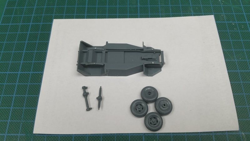

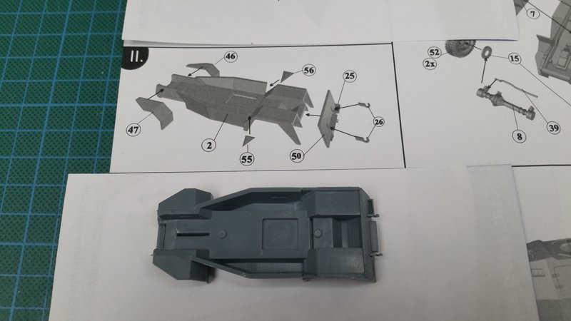

Courageous Posted June 3, 2020 Author Share Posted June 3, 2020 A started update... Upper hull done. Lower hull done although I'm not sure why they have parts 55+56 as separate parts, maybe a different version? Wheels sort of done. The space between the 'spokes' was full of flash and in the top two, you can see flash removed. A horrible seen runs round the circumference and will need tidying up. With no location points and vague instructions for the fitting of the leaf springs, I needed to temporarily fit wheels to axles to get a 'good' position and cement the leaf springs in place. Stuart 9 Link to comment Share on other sites More sharing options...

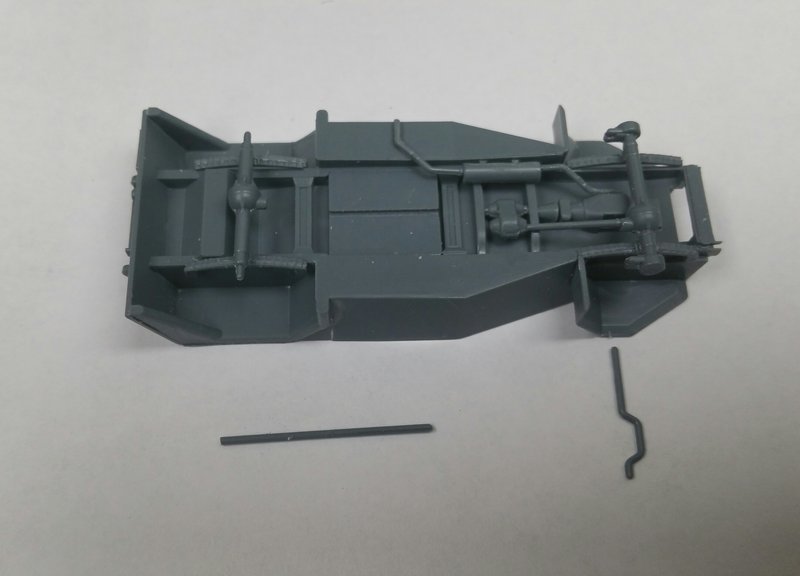

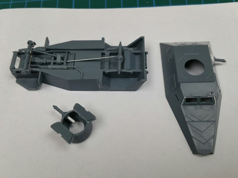

Courageous Posted June 4, 2020 Author Share Posted June 4, 2020 11 minutes ago, badger said: Attack have done a version with a full interior Might need to source that, quite fancy doing that. Today's lunchtime's effort. A bit of work on the underside was done; floors, various shafts and boxes, exhaust system were added. Unfortunately the bent rod (tie rod?) is slightly too short, as is the long drive shaft, so scratch options will be needed. Stuart 3 Link to comment Share on other sites More sharing options...

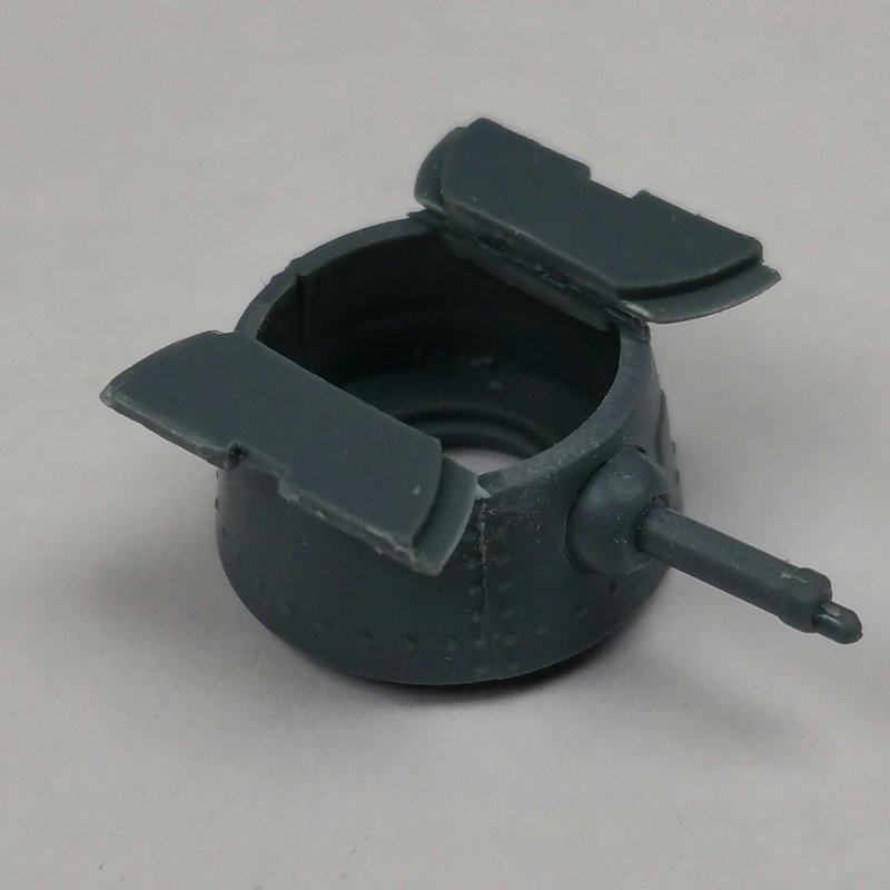

Courageous Posted June 8, 2020 Author Share Posted June 8, 2020 Turret time. Turret made from 6 parts but I turned into 9, the turret top was cut into 4 pieces and glued together. Now I have room for a figure in the top. Stuart 2 Link to comment Share on other sites More sharing options...

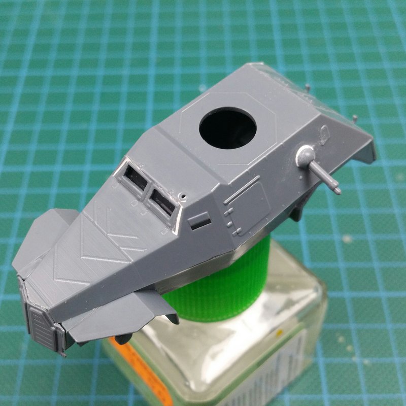

Courageous Posted June 10, 2020 Author Share Posted June 10, 2020 Bits & bobs. I've got round to fitting the longer drive shaft and tie rod to lower chassis. Added a plastic breach block for the turret Vickers MG. Upper hull had it's side MG fitted but a little filler was needed to fill the gaps. Also removed the 'plastic' windows. Before I join the hulls together, I'll need to fit some clear acetate in the window positions. Question, what colour would the inside be, silver or white? Stuart 3 Link to comment Share on other sites More sharing options...

Courageous Posted June 11, 2020 Author Share Posted June 11, 2020 Glazing added for the front windows. Hull halves joined together. Front fitted. Need to make good joins and stuff. Stuart 4 Link to comment Share on other sites More sharing options...

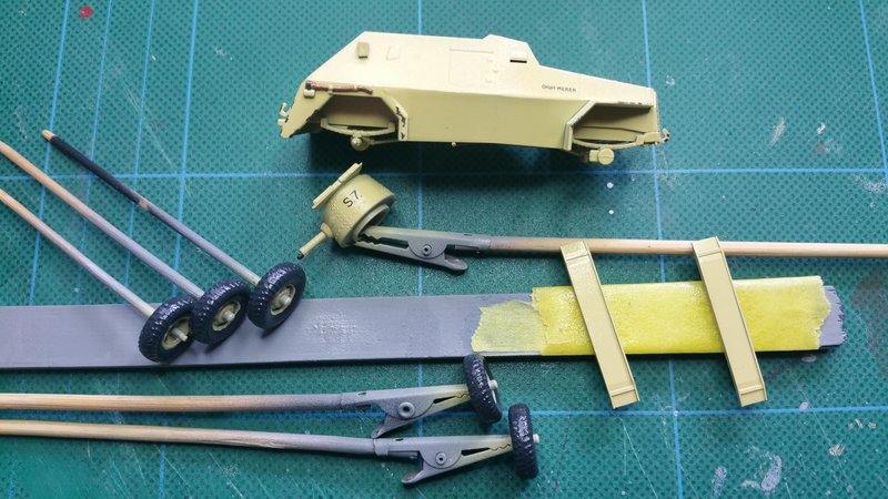

Courageous Posted July 13, 2020 Author Share Posted July 13, 2020 Sorry for lack of updates, waiting for paint shop availability. AK Light Stone applied overall. Next a little detail painting and think about some more accessories. Stuart 4 Link to comment Share on other sites More sharing options...
Courageous Posted July 17, 2020 Author Share Posted July 17, 2020 I'm slacking, so had a good talk to myself to move by butt. Tyres were painted with Vallejo Panzer grey. Everything had a good douse of gloss varnish. Decals were applied, all of them and glass varnished again, now ready for a wash and weathering process. Stuart 5 Link to comment Share on other sites More sharing options...
