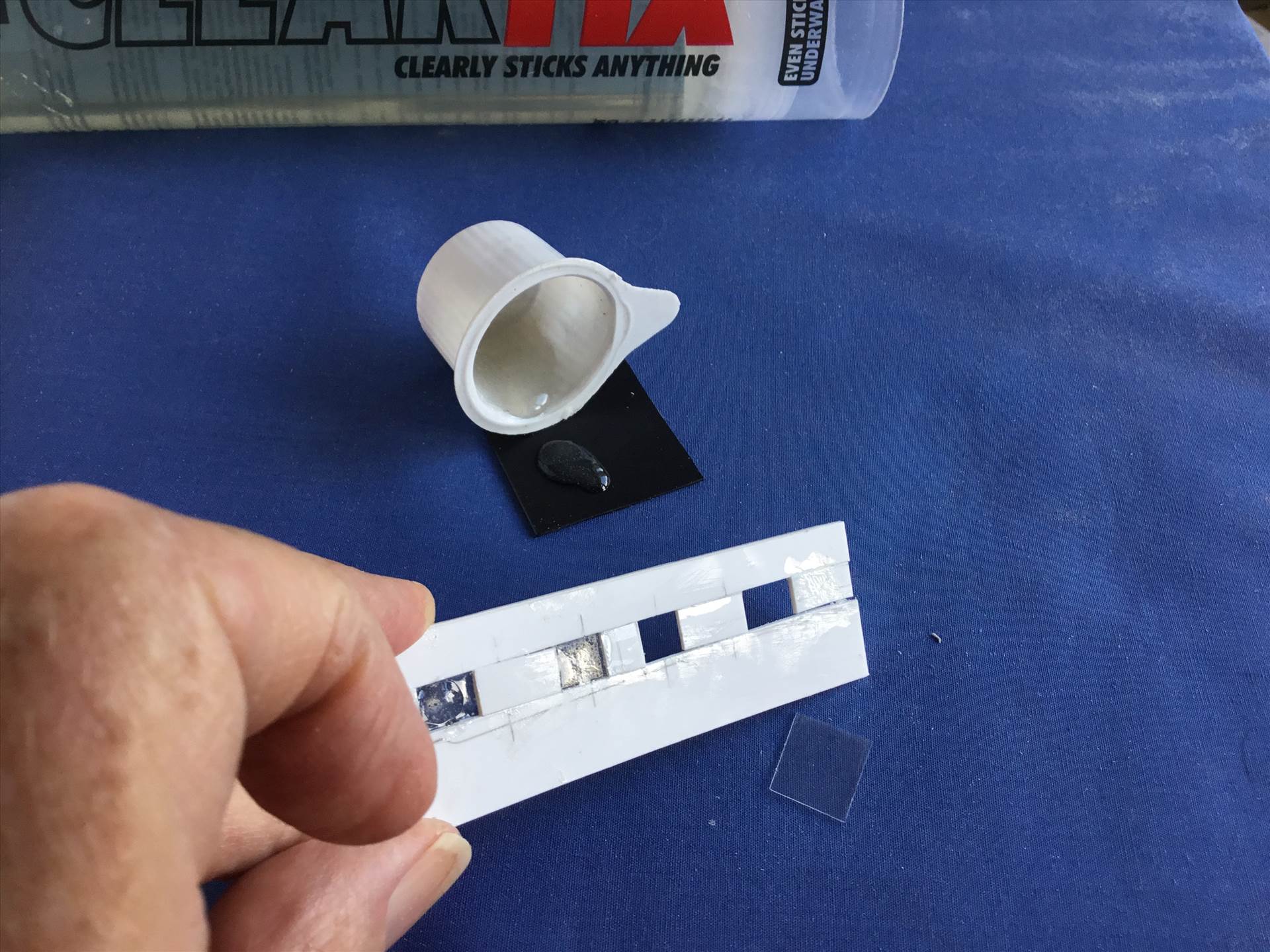

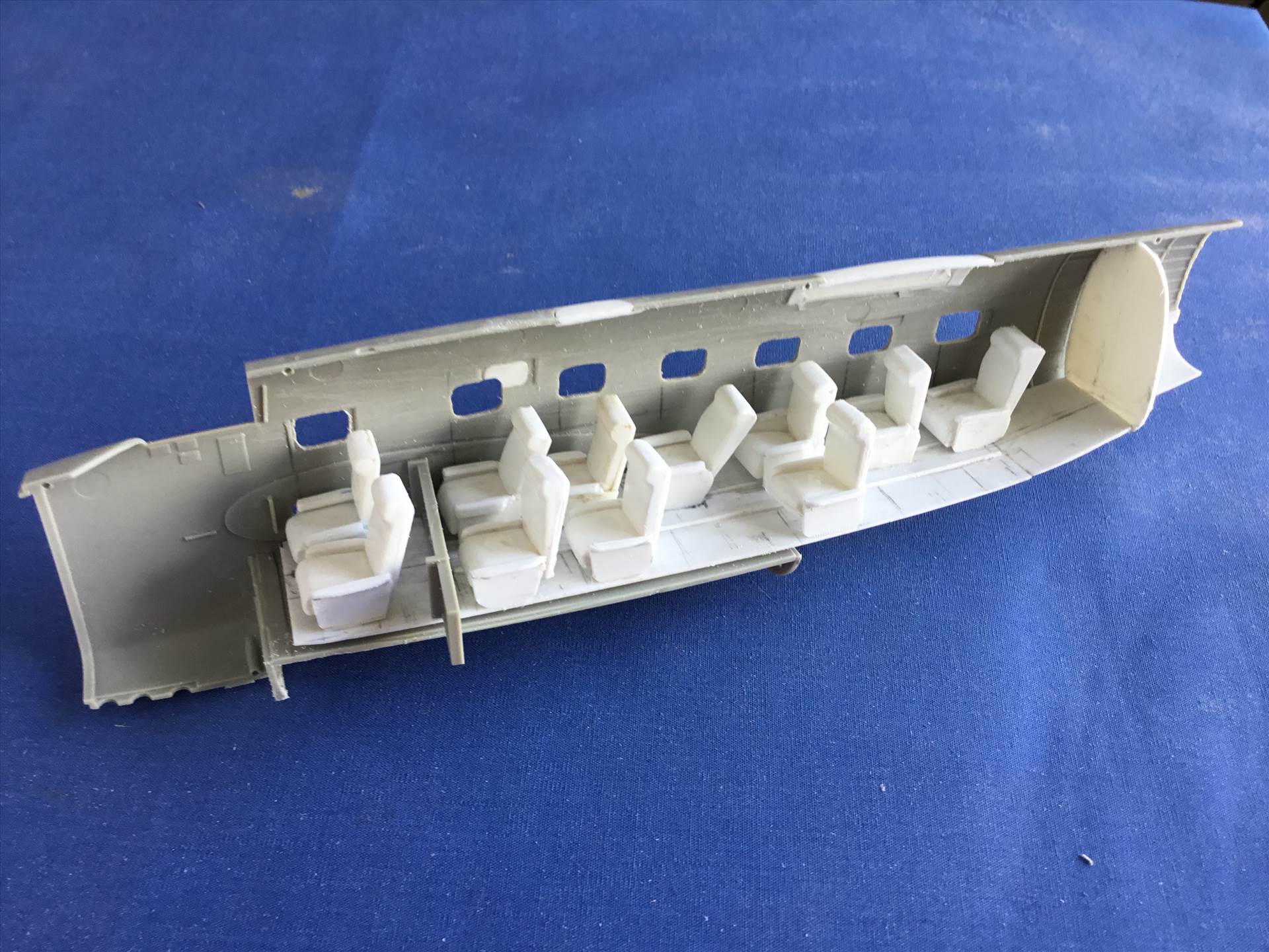

DMC Posted August 1, 2020 Share Posted August 1, 2020 (edited) A few more seats done. The remaining three are around 50% completed so only an hour or so left and finished. The seats aren’t exactly uniform either but as only abour 5% will be seen that’s not a problems. And, although I’ve posed some of the seats in the reclined position that is probably incorrect as b“please return your seat-backs to the upright position” is usually heard upon landing. I’ve been mulling this business of the windows over and how I might be able to avoid having to fit each one (14 in all) individually. I have a tube of ClearFix adhesive that I bought some time ago to simulate water in a diorama. The diorama never got made and the ClearFix has been gathering dust on a shelf. Until now. At first the idea was to plug the widows with PETG without fussing over the fit that much a using the ClearFix to cement them in (this stuff is very stick). Tried it on a piece scrap but the results weren’t satisfactory. Next light bulb moment was just to back up the opening with thin punnet plastic CA’d on the inside and then fill the recess with diluted ClearFix. To dilute the ClearFix I used 99.9 pure (recommenced on a YouTube video on making water effects) isopropyl alcohol. The first mix, left window, was too thick and the result was a little lumpy. After more thinning the mix flowed into the recess right to the perimeter. So, on to something? Maybe, a little experimenting will tell. Thanks for dropping in. Edited August 2, 2020 by DMC Spelling 3 Link to comment Share on other sites More sharing options...
rob Lyttle Posted August 1, 2020 Author Share Posted August 1, 2020 I'm have a hazy vague recollection moment, Dennis. Did I read a thread on here that featured a method of masking tape on the outside of the fuselage and the clear stuff poured from the inside.....?? May have been this kind of scale, or maybe a big Airliner with lots of tiny windows. I've never tried such a thing, but seeing your trials has a faint bell ringing, distantly Might be worth a test while you are trying out. 1 Link to comment Share on other sites More sharing options...
fjaweijfopi4j48 Posted August 1, 2020 Share Posted August 1, 2020 18 minutes ago, rob Lyttle said: I'm have a hazy vague recollection moment, Dennis. Did I read a thread on here that featured a method of masking tape on the outside of the fuselage and the clear stuff poured from the inside.....?? May have been this kind of scale, or maybe a big Airliner with lots of tiny windows. I've never tried such a thing, but seeing your trials has a faint bell ringing, distantly Might be worth a test while you are trying out. I remember that, it was an airliner, and done with clear resin. I have used another approach when the windows are in a flat area: replace a section larger than the window row with clear plastic, mask the windows, blend the edges of the clear part puttying and sanding into the surrounding area. 1 Link to comment Share on other sites More sharing options...
DMC Posted August 1, 2020 Share Posted August 1, 2020 (edited) 12 hours ago, rob Lyttle said: Did I read a thread on here that featured a method of masking tape on the outside of the fuselage and the clear stuff poured from the inside.....?? You just might have done, Rob I tried using the ClearFix on its own in a “window “ with a metal backup but that didn’t work at all as it stuck fast to the metal. It sticks to everything and I doubt the tape could be removed cleanly. I may be mistaken but I think Adrian was going to try filling in the windows on his vacuum form conversion with ClearFix. I doubt this is an original idea. Nothing ever is as it seems someone has tried it or a variation before. However, had I seen it somewhere before I would have certainly credited the originator. What I’m thinking about this method is it can be done after painting, or foiling, as long as the clear inside piece is fixed firmly in place. Losing one inside would cause problems. The stuff is perfectly clear and would certainly work well on ab airliner......with a bit of practice. A, say, 747 might be a few windows too far. 11 hours ago, Moa said: remember that, it was an airliner, and done with clear resin. Missed that one, Moa, but clearly there are several ways to approach the window problem. However, no filling, sanding, etc. with this method and curtains can be painted on the clear back-up if so desired. Also, if I remember, resin sets up pretty quickly. ClearFix needs a few hours to harden. Thanks for the input guys. Suggestions and advice always welcome Dennis Edited August 2, 2020 by DMC 2 Link to comment Share on other sites More sharing options...

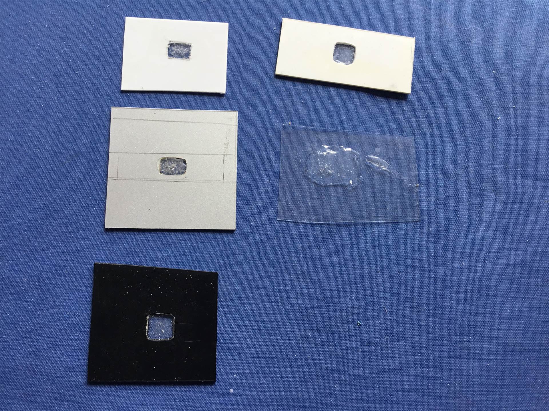

DMC Posted August 3, 2020 Share Posted August 3, 2020 Looking good, Rob, and I may end up following your lead. Continued my experiments with ClearFix yesterday and the results were less than satisfactory. Champagne-like bubbles in the mixture probably from too much stirring. Not good. Tried Kristal Klear and that might just work but it took 24 hours to clear up. All this faff might seem like a big bother but I like solving problems and if not successful I have your method as backup. I’ll post pics later. Dennis 1 Link to comment Share on other sites More sharing options...

DMC Posted August 5, 2020 Share Posted August 5, 2020 As I’Ve said, might end up doing as you did with inserts but here are the results of some of my faffing around. Left in photo: top, you can see the bubbles. middle, more bubbles. bottom (black) better, hardly any bubbles which might be because I thinned the mix and let it sit for a bit. Right: top, Kristal Klear with the punnet plastic backup. This doesn’t look too bad except that it’s a little concave. Another application might bring the surface up level. bottom: just a blob of the Klear on plastic. I’m liking the Kristal Klear more than the ClearFix now. Might do one window just to make sure. Seats all done and primed. What interior colour? Nice work on yours. Reserve a seat for me on the its maiden flight. 1 Link to comment Share on other sites More sharing options...
