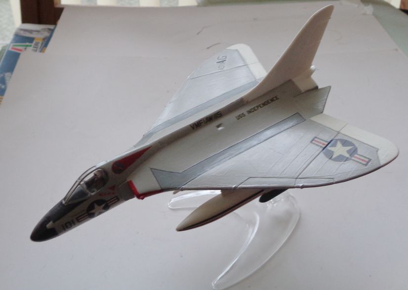

klr Posted August 3, 2020 Author Posted August 3, 2020 The age of decals meant that they required some touching up around the edges and other areas to hide the yellowed carrier film. This has the added bonus of helping to keep the decals in place. I didn't want to varnish the decals. They have a natural satin finish very similar to both Hu 129 light gull grey and Hu 130 white, but Humbrol Satin Varnish has a noticeably different finish. The wing roundels were tricky to apply over the wing fold joint, and required some touching up. As for the walkway boundaries: I initially considered using some spare walkway markings from an Italeri B-57, but they seemed too thick. So I looked at another option. On some decal sheets - particularly Airfix - the different sections of the sheet are marked off by solid lines. In fact, on pre-Cartograf sheets, there is a solid boundary line all around the decal sheet. I took a scissors to the leftovers from an Airfix U-2 decal sheet, from a kit I built about 15 years ago. And here is the result. It took some time and effort, and some trial and error, and there is still some minor touching up required. 9

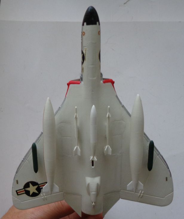

klr Posted August 3, 2020 Author Posted August 3, 2020 4 hours ago, modelling minion said: Excellent use of the spare black lines on the walkway boundaries, thats getting the most from a decal sheet! I must go through my spare decals to "harvest" them for future use. I had thought before about using them for something like this, but never took the plunge. Anyway, back to the Skyray. I've now attached the remaining stores, and noticed something: The display stand cannot be attached in the intended forward facing position. It can only be attached backwards, and then very carefully. This reveals that slot is too far back, meaning the kit is nose-heavy. The notch at the top of the stand stopped the plane from nosing down, when it attached facing forward. It's not quite as bad as it appears in this photo, but there really is no space between the tail of the centreline navpac unit, and the stand slot. Why did Airfix not offset the stand slot, as it did with the Fw 190 A/8 kit, released around the same time? The plane would have tilted slightly to one side, but that often happens anyway. To resolve this, I could do some surgery on the top of the stand arm, to allow it to be attached facing forward. Anyway, I now just have the arrestor hook to paint and attach, and some more cleaning up/detail painting to do, before painting and decalling the fin and rudder. So this kit is well in hand. 7

klr Posted August 3, 2020 Author Posted August 3, 2020 (edited) 16 minutes ago, modelling minion said: I often had trouble getting my models to sit right on the stands and also found that some sat a lot better with the stand the other way round. If the notch at the top is positioned towards the lighter end of the kit, it should hold it level, but if it's at the heavier end, it will have no effect. That's what has happened here. 10 minutes ago, Jinxman said: My 109 is the same - I had to leave the drop tank unglued so I could wiggle the stand past it. I don't ever recall having an issue with any stands as a kid. As I said earlier, I wonder why Airfix did not offset the stand slot in more kits? It might have been difficult with such a slim fuselage as the 109 though. The other option would be to put a slot in the centreline drop tank (or bomb, or torpedo, or whatever). I'm trying to remember if Airfix ever did that. Edited August 3, 2020 by klr 1
Richard Humm Posted August 3, 2020 Posted August 3, 2020 39 minutes ago, klr said: If the notch at the top is positioned towards the lighter end of the kit, it should hold it level, but if it's at the heavier end, it will have no effect. That's what has happened here. As I said earlier, I wonder why Airfix did not offset the stand slot in more kits? It might have been difficult with such a slim fuselage as the 109 though. The other option would be to put a slot in the centreline drop tank (or bomb, or torpedo, or whatever). I'm trying to remember if Airfix ever did that. The Jaguar has a stand slot in the fuel tank, which Airfix show as on the centre line, though usually the Jag carried two tanks, one on each wing. 1
klr Posted August 3, 2020 Author Posted August 3, 2020 3 minutes ago, Richard Humm said: The Jaguar has a stand slot in the fuel tank, which Airfix show as on the centre line, though usually the Jag carried two tanks, one on each wing. Bingo! That was it. I've built that kit twice, but not for some time. The Jaguar centreline tank was big though, with a very sturdy pylon. That approach would not have worked with the Skyray navpac. 2

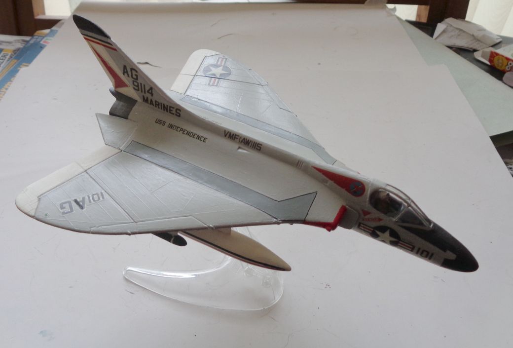

klr Posted August 16, 2020 Author Posted August 16, 2020 ... and finally, it's complete. Well, I'm calling it finished anyway. I decided to take off the rocket pods so I could paint the white bands fore and aft. Then I "lost" one of the pods, had to take the time to assemble, paint and attach another, and of course just after I'd done that, the lost pod turned up. As mentioned, the decals for the fuel tank stripes were very brittle. I also doctored the stand so that it could be attached the right way around, meaning that the kit sits nice and level: Not my best effort (by a long shot), but it's put me in the mood to build some more USN/USMC jets from the period. More pics ye olde gallery in 5 minutes. 8
