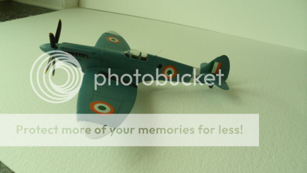

49904703273_113f63e6bd_b.jpgPRXIX HS961 by losethekibble, on Flickr
so white bands and saffron/white/green roundels....
49904702158_ede2a272f9_b.jpgPRXIX unidentified by losethekibble, on Flickr
EDIT and just found this...here of course...  Too give yo an idea of why I found the scheme so appealing...
So, have approx roundels, have generic serials,  have paint that will do for fin flash.....

Masking off...  Nothing like a bit of direct sun for fault picking ...
49913081312_60c3018702_b.jpg50620015 by losethekibble, on Flickr
I'm really getting to like this colour.....
A couple of glitches on the fin flash and fuselage band,  which I have been touching up with a fine brush... The slight ridge left by the tape and glossy PRU blue have helped.
natural diffuse light
49912784551_68db6cf34d_b.jpg50620017 by losethekibble, on Flickr
49912783081_6a04a49a10_b.jpg50620016 by losethekibble, on Flickr
Overall I'm pleased, paint finish has improved,  the thinning mix of water, flow improver and retarder has made brushing Xtracrylix viable, which is great as I have a load of it....
Next...decals,  and do the Hobby Boss Seahawk ones work OK..... I shall test out some I won't use on scrap first.
cheers all

and... after a long time of careful concentration in the kitchen (I use the coffee machine hot plate to keep decal water hot)
49913880008_11925155a9_b.jpg50620022 by losethekibble, on Flickr
kit decals for wing walkways, (the little bit I had to jiggle into place has jiggled so well it blends in...was about 1cm between roundel and rest of walkway, and it does not go beyond, see ref photo) and i thin the prop blade markings are for a warbird, I may paint out part of it.
  Avieology serials (as seen behind) ,  and Hobby Boss roundels.
The fuselage one chipped....
49913881178_768af1e957_b.jpg50620024 by losethekibble, on Flickr
The Hobbyboss decals... impressively thin and, not that visible here, but certainly visible...not that opaque... there is a distinct split down the centre ..
If you loo at the reference pic (and another I was sent) the lower wing roundels are that far out.  Possibly there are underwing serials, the clearer shot I was sent doesn't appear to have them, perhaps painted out?
A question perhaps for @Linescriber ?
.and this fuselage side also chipped, and is a touch lower...
Now, I do have another set of HB  roundels, so I'll try an overlay with those later.
I'm pleased with the serial,  the spacing in not quite right,  but the straight and even... I'm looking at the image on flickr several times real size and it looks decent so I'm pretty happy, not having done that before.
Given my years of procrastination, dithering and research rabbit holes this is the third decal job I've done since the early 90's, when I built a Ki-84, and before that it would have been 1982, and the most complex, using 3 different types and assembling a serial...
makes me more confident about actually now completing some more involved projects.
cheers
T
  • Like 8
