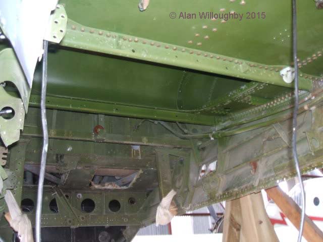

I've been having a read over some the previous WIPs on this kit on here. From what I can gather based on what I've read here and on the IMPS link that has popped up a lot - I'm thinking it should be interior green through, with no bronze green around the pilot area?
Couldn't find any info on the bomb bay colour - interior green is called out in the AM instructions or should it be zinc yellow / insignia white etc? Any thoughts?

To help with your question, it's my understanding that the GM (General Motors)
built TBM (M designating a GM build), were finished with US Interior Green for Crew
areas, and a Zinc Chromate (Green) for other areas like bomb bay etc
This photo of an RNZAF TBF-1C, I took some few years ago shows the original
(Darker looking) tinted Zinc Chromate Green used by Grumman.
Caveat, it may not be the same/exact match to the type GM used
Hope that helps you?
Look forward to your build :)
