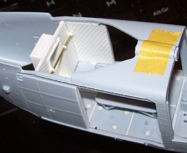

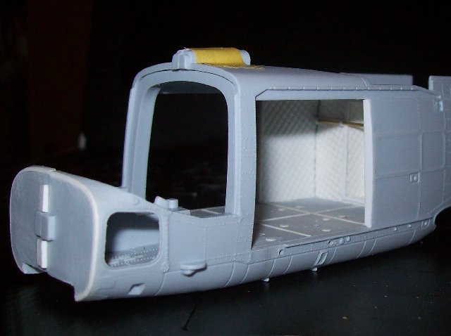

Martian Posted February 20, 2020 Author Share Posted February 20, 2020 22 hours ago, Hewy said: I like your bulkhead Much better than the kit one, smashing job Cheers Hewy, more to come on that front tomorrow. A Martian of my word, here is the promised update. After much dithering, I decided that I could not live with the mismatch between the kit quilting and the replacement stuff that I added to the new rear bulkhead. Therefore it was "Out Dremel time" and the offending quilting ground away and replaced by my party/barbeque plate material. I shan't bother doing the cabin roof in the is was. Partly because it would involve plating the plate material down over compound curves and I don't think it will take this. Also, so little of it will be seen that its probably not worth the effort anyway. I then added the bar that the shoulder straps for the rear seat harnesses are hung from. I am none to happy about Airfix's interpretation of how the actual seats attach to the rear bulkhead, so I am off to see what this part of the aircraft actually looked like. Thanks for looking Martian 7 1 Link to comment Share on other sites More sharing options...
Hewy Posted February 20, 2020 Share Posted February 20, 2020 The party plates make for a convincing quilt material, i must round some of those up for my one , being plastic does it respond to styrene cement ? 1 Link to comment Share on other sites More sharing options...
Martian Posted February 20, 2020 Author Share Posted February 20, 2020 1 hour ago, Hewy said: The party plates make for a convincing quilt material, i must round some of those up for my one , being plastic does it respond to styrene cement ? I have used Tamiya Extra Thin and Tamiya standard glue with no ill effects at all. Martian 1 1 Link to comment Share on other sites More sharing options...

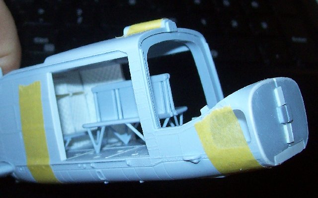

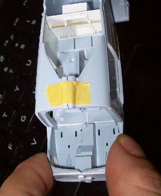

Martian Posted February 21, 2020 Author Share Posted February 21, 2020 I couldn't sleep last night so I decided to do some fettling while away the hours. I began by sorting out the seats for the rear cabin bulkhead. This was pretty straightforward once appropriate pictures had been located. Next I raided my spare Lynx kit for the missing part and got it safely glued to the transmission housing. Most of the parts for this assembly need some degree of fettling and/or filling so be prepared to lose most of the surface detail in this area of the model. I am thankful that I have the Eduard Exterior Detail Set which provides the missing panels which should lay down fine after a bit of annealing. I must remember to anneal some brass mesh as well so that I can have a look at those intakes. If things look too tricky on that front, I shall be adding a good dollop of Miliput over the top of the kit parts and painting them red to represent intake covers. I went back and had another look at the underside of the model and the news is that even after a lot of trimming of the stub wing assembly, there is going to be a significant amount of filling and sanding needed to get the underside to look right. I have come to the conclusion that getting as many of the kit's parts as possible, fettled very early on in the build is the key to getting a decent result from this kit. The finer details are going to have to wait until I have completed this process. Thanks for looking Martian 13 Link to comment Share on other sites More sharing options...
Pappy Posted February 23, 2020 Share Posted February 23, 2020 (edited) Whoa, who are you and what have you done with Martian, all this progress is very unusual Great work Martian, I am following very closely. I decided to jump in and cracked the bags on mine to build as part of the 'In the Navy' GB. Whilst test fitting the cockpit, I found that the top of the fuselage needed a bit of pressure to get both sides to meet. Looking inside the fuselage halves, I found ejector pin marks (very slightly raised) right where the forward frame (part 5D step 12) fits. Once these were removed, the fuselage halves could close with only light pressure. I also added the exhaust fairings (36D/37D) to their respective fuselage halves to avoid any nasty steps. I agree that most parts will require a 'fettle' to avoid nasty surprises. Also a question for you (or any other Lynx experten who may be reading this) - I want to use the folded main rotor option. In step 110, the destructions indicate that a clear part (6E) is added to each main rotor blade hub. Step 110 deals with the unfolded rotor assembly but the addition of part 6E is not shown in the equivalent folded rotor option steps (111-120) is this an oversight? cheers, Pappy Edited February 23, 2020 by Pappy 1 Link to comment Share on other sites More sharing options...
Martian Posted February 23, 2020 Author Share Posted February 23, 2020 3 hours ago, Pappy said: Whoa, who are you and what have you done with Martian, all this progress is very unusual Great work Martian, I am following very closely. I decided to jump in and cracked the bags on mine to build as part of the 'In the Navy' GB. Whilst test fitting the cockpit, I found that the top of the fuselage needed a bit of pressure to get both sides to meet. Looking inside the fuselage halves, I found ejector pin marks (very slightly raised) right where the forward frame (part 5D step 12) fits. Once these were removed, the fuselage halves could close with only light pressure. I also added the exhaust fairings (36D/37D) to their respective fuselage halves to avoid any nasty steps. I agree that most parts will require a 'fettle' to avoid nasty surprises. Also a question for you (or any other Lynx experten who may be reading this) - I want to use the folded main rotor option. In step 110, the destructions indicate that a clear part (6E) is added to each main rotor blade hub. Step 110 deals with the unfolded rotor assembly but the addition of part 6E is not shown in the equivalent folded rotor option steps (111-120) is this an oversight? cheers, Pappy It is in fact me Pappy, fret ye mot, things will slow down when I start the fine detailing. Perhaps as soon as today as I intend to take a look at those horrible mesh intake guards. I think that I am enjoying this kit because it very much fits in with my chaotic lifestyle at the moment. The kit is very much one that has to be tackled in short sessions, which is all I am going to get for the foreseeable future. Were things "normal" here at Martian Mansions, with plenty of time for modelling, I think I would be finding it a rather frustrating build. I suppose what I am trying to say is that it is the right kit at the right time. I have found that Airfix have allowed too little tolerance between many of the major parts and that it is well worth taking some time to ease or even remove some of the locating ridges for the main interior parts of the model to allow a bit of "wriggle room". I will have to have to have a look at the instructions to answer your question about the rotor hub as I have not looked that far ahead in the build. Martian 1 Link to comment Share on other sites More sharing options...

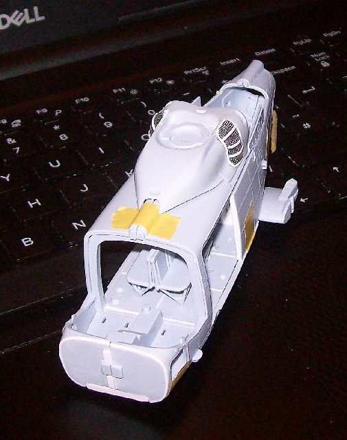

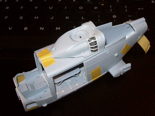

Martian Posted February 23, 2020 Author Share Posted February 23, 2020 Well, I was originally going to do the model with red intake covers. Right up until some little oik suggested I try making the intakes. This of course nagged at the Martian brain until I at least had to have a bash at it. I has taken me all day, that's right, al £*%$("g day to make just one side! I did adapt the idea suggested here in that I have fettled the mesh so that it is detachable to allow for painting the intakes. It goes without saying that there is a blurglecruncheoning awaiting said oik, once I have remembered who he is, for putting the idea in my very suggestable mind. First technical question; what colour was the intake mesh on Lynx? Anyway, I hope you like the result of today's efforts, guess what awaits me on the morrow? Thanks for looking Martian 14 Link to comment Share on other sites More sharing options...

Martian Posted February 24, 2020 Author Share Posted February 24, 2020 Just a quickie today as I am utterly exhausted following what Hewy would describe as another "productive day". For whatever reason the starboard intake mesh decided to fight me all the way. I would have thought it would have been easier second time around. Still we now have a matching (ish) pair of intake guards. One thing is for certain, the next Lynx I build will be getting intakes covers! Thanks for looking Martian 9 Link to comment Share on other sites More sharing options...
Ex-FAAWAFU Posted February 24, 2020 Share Posted February 24, 2020 They may have fought you, but under paint those will look excellent. 1 1 Link to comment Share on other sites More sharing options...
Martian Posted February 24, 2020 Author Share Posted February 24, 2020 51 minutes ago, Ex-FAAWAFU said: They may have fought you, but under paint those will look excellent. Thanks Crisp, coming from BM's resident Lynx expert, that means a lot. All I have to do now is to wait until tomorrow so that everything is dry and I can clean the fairing up. Martian Link to comment Share on other sites More sharing options...
