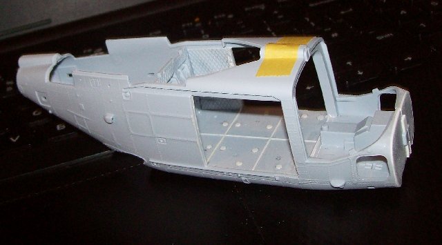

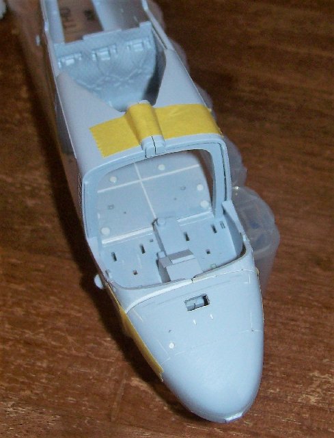

Martian Posted January 26, 2020 Author Share Posted January 26, 2020 Where to start? Quite bit has been going on today but perhaps we will begin by keeping @Pappy happy and highlight another potential pitfall in the kit. I will explain why I say "potential" in a bit as it will go a long way to explain why some people have problems with this kit and not others. The nose assembly of the kit does not even begin to fit properly. This is due to the inside of the nose mouldings not matching the fuselage. There was clearly now way I was going to be able to fettle the nose to fit , so I decided that the mountain was going to have to come to Mohammed so to speak. I began by cementing some .30 x .30 'thou plastic strip around the lip of the fuselage where the nose is supposed to fit. When this was dry I sanded it to the fuselage contours and flush with the end of the fuselage. I the sanded the mating edge of the nose assembly on my vacform sanding board until it matched the fuselage. I added a couple of tabs from plastic card in order to pull the front of the fuselage level. This gave a much better and stronger, join, albeit a butt one. There will still be some filling to be done but not nearly as much as if one had gone down the route advocated by the kit instructions. Detail is going to have to be re-instated on the nose and I am glad that I bought the Eduard exterior detail set for this kit. I think that many of the issues surrounding this kit are due to Airfix trying to get too many variants out of a single set of mouldings, which leaves the parts vulnerable to warping, more so given the softish plastic Airfix have been using. The plastic is, of course, a bit of a double edged sword. Prone to warping as already discussed, but mush easier to carve. Will that do Pappy? A lot of detail had been lost in removing the runners from the cabin floor so I decided to get rid of it all and start again with a clean slate. It was then out plastic strip, plastic card and punch and die set and using the spare floor for the German version of the Lynx as template, the detail was duly re-instated.. The cabin light was removed from the roof and a mounting for a new light added from a punched disc of card. Finally I carved out the moulded grille on the nose in readiness for an etched brass replacement from the Eduard exterior set.. Thanks for looking. Martian 10 1 Link to comment Share on other sites More sharing options...

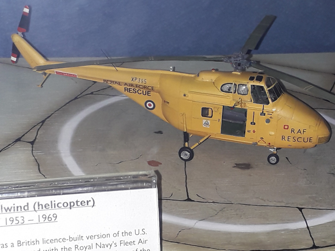

perdu Posted January 28, 2020 Share Posted January 28, 2020 Looking forward to that Martian This is the only vac form kit I was ever successful with but in spite of often trying I have been lacking in success since (Had to be a helicopter didn't it, from me) I have a two seat Lightning I would love to get past the starting gate, just because someone now makes such as a kit is no reason to discard a long term wish is it? 8 Link to comment Share on other sites More sharing options...

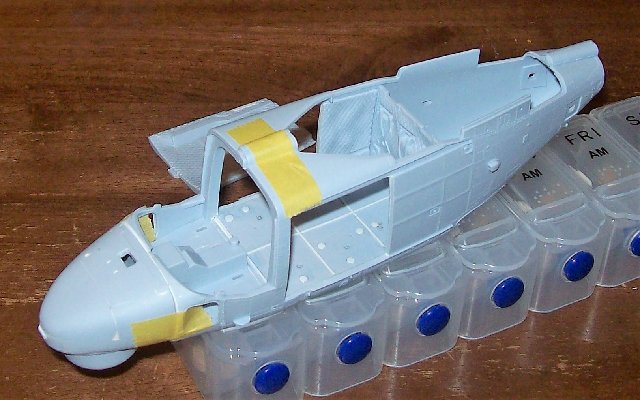

heloman1 Posted January 29, 2020 Share Posted January 29, 2020 Looking good Martin, good to see Jens here too ( hello Jens). Are the pill boxes from a diorama or is the Lynx self medicatiing? Colin 1 2 Link to comment Share on other sites More sharing options...
Martian Posted January 29, 2020 Author Share Posted January 29, 2020 9 hours ago, Marklo said: I'll keep looking. Just to contradict myself further vis a vis not liking helicopters. , I went and bought a Mil 24 Hind in 1/48 scale this morning. Clearly you only think you don't like helicopters but deep down you are a closet fan of them. 5 hours ago, heloman1 said: Looking good Martin, good to see Jens here too ( hello Jens). Are the pill boxes from a diorama or is the Lynx self medicatiing? Colin Cheers Colin. The pill boxes contain the medication that Mrs Martian uses to keep me "sane". Or should that be sedated? https://www.youtube.com/watch?v=Y0L0jVe0duc Martian 3 Link to comment Share on other sites More sharing options...

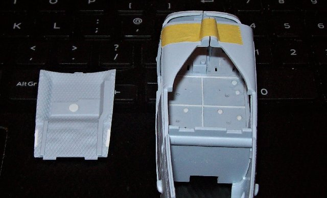

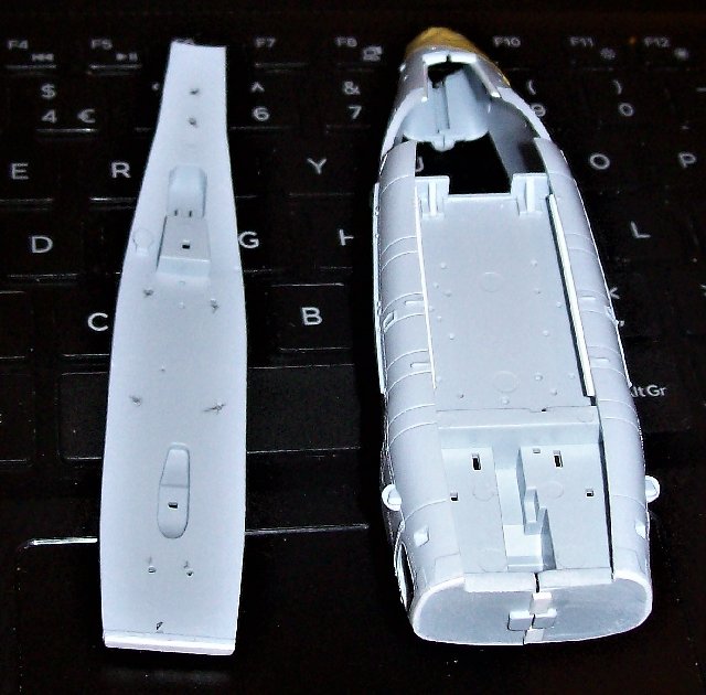

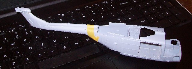

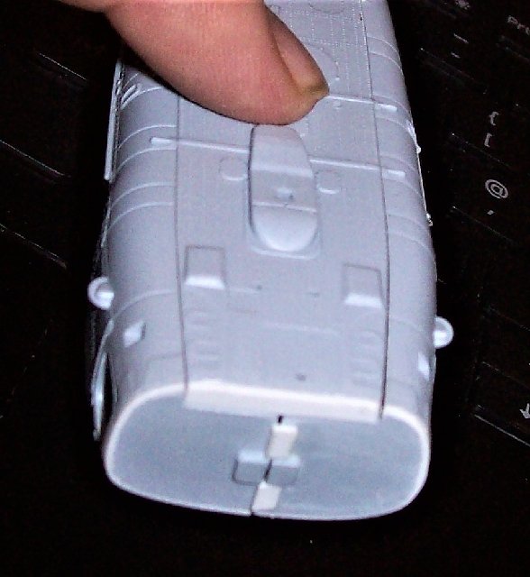

Martian Posted January 29, 2020 Author Share Posted January 29, 2020 The next heads up on this kit is the lower fuselage. Firstly the panel concerned is too short at the front. This was remedied by adding a strip of plastic card to the panel. I then noticed that there was a marked degree of flexing in the lower panel and clearly, the join was always going to be at risk of opening up later down the line. To get round this problem, I glued supporting strips of card around the inside of the opening in the fuselage. This has made things a lot stronger. I next took a look at the tail boom. The starboard side of the rotor pylon needs some filling but, other than that. things were no too bad, even the fit to the fuselage looks to be reasonable. One thing one is going to have to address is the issue of the riveting on the fuselage. A certain amount of this detail is inevitably going to be lost in cleaning up some of corrected fit issues and one is going to have to choose between reinstating the detail a la @Ex-FAAWAFU or to lose the rivets altogether. To Crispinate or not to Crispinate? That is the question. Well, its a matter of personal taste really and I have yet to decide which way I am going to go. My apologies if the thread seems a bit boring at the moment but it seems to me that it is better to get on top of these issues now, rather than further on in the build, when they will be much harder to fix. At least @Pappy will be happy. Thanks for looking. Martian 7 Link to comment Share on other sites More sharing options...
