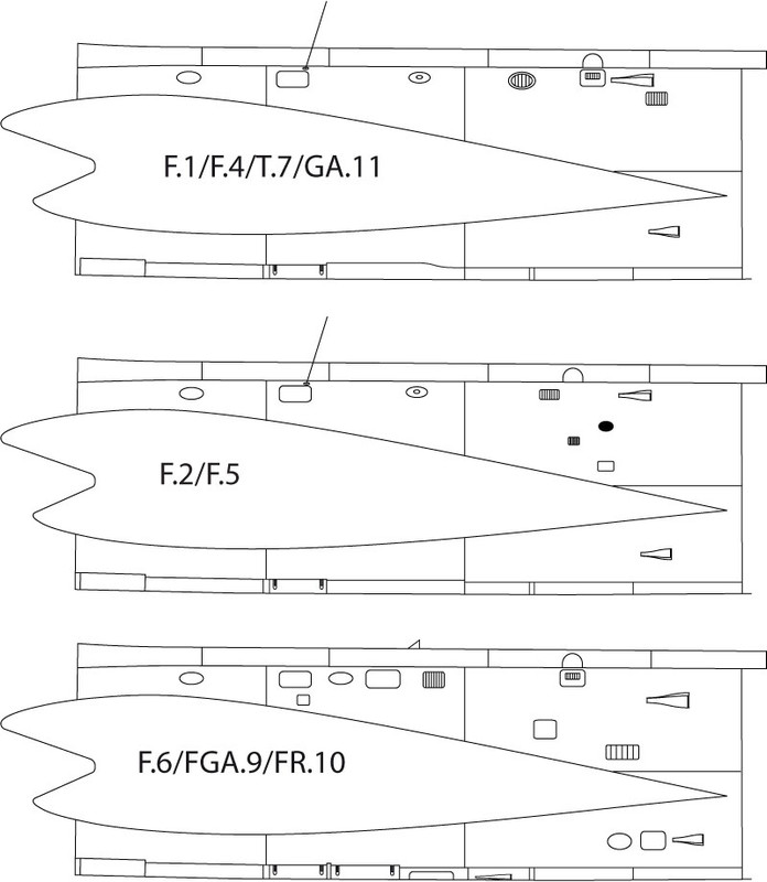

71chally Posted January 14, 2020 Share Posted January 14, 2020 2 hours ago, Jon Kunac-Tabinor said: l The only thing the Mk 5 builder will need to do, if they are in the mood, is alter the fuselage vents and grilles for the sapphire engine. ...if you're that fussy you need to change some for the F.2 & F.4 aswel, as I understand it it comes with the upper wing and fuselage of the F.6. Link to comment Share on other sites More sharing options...
Jon Kunac-Tabinor Posted January 14, 2020 Share Posted January 14, 2020 19 minutes ago, 71chally said: ...if you're that fussy you need to change some for the F.2 & F.4 aswel, as I understand it it comes with the upper wing and fuselage of the F.6. You are most probably correct there. If you have the F6 model and can comment on what should be changed, then I'm sure it would be welcomed. the F6a spine ledge is still there etc etc - but as i said these are all the foibles of the original F6 release. I'm not totally sure how the upper wing changes for an F2/4/5/early 6 other than the dog tooth going? I think somewhere I've posted about the 3 different Aden cannon shell ejection port styles, but I must confess that the nuances of the Sapphire vs Avon fuselage tend to escape. cheers Jonners 1 Link to comment Share on other sites More sharing options...
71chally Posted January 14, 2020 Share Posted January 14, 2020 (edited) I will try and get around to that. Luckily I have been intimate (more than I liked on some occasions!) with small and big bore Avon Hunters so will dig out the pictures. I don't believe the wing itself is any different, apart from the extended outer leading edges. Regarding the Sapphire differences that really will need referral to walk around shots, hopefully @StephenMG can help. Edited January 18, 2020 by 71chally 1 Link to comment Share on other sites More sharing options...

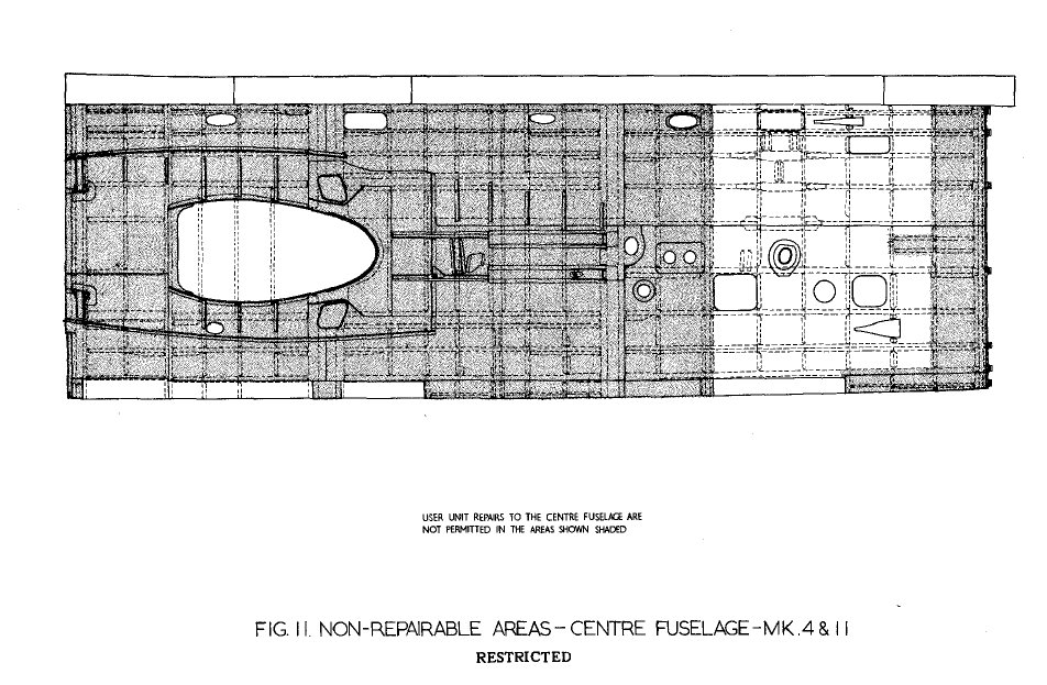

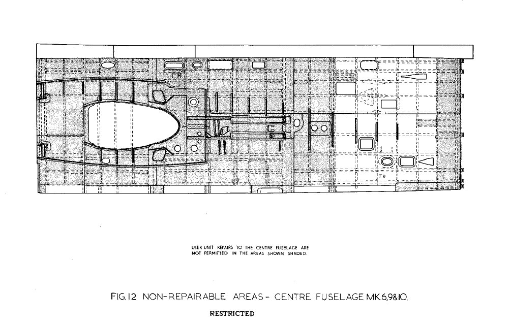

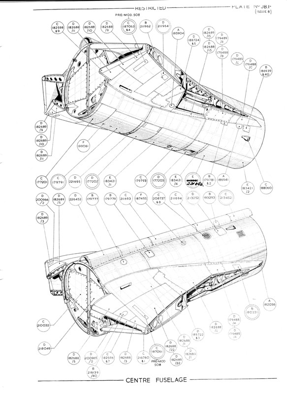

StephenMG Posted January 18, 2020 Share Posted January 18, 2020 Not sure if this will help but this is what I came up with for the SAM Datafile. These are some scans from the repair manual that also shows the 'openings' in the 100-series Avon aircraft (Mks 1, 4, 7, 8, 11) and the 200-series Avon aircraft (Mks 6, 9, 10), This is a scan from the Vol.3 which shows the 100-series in more surface detail, Incidentally, if you really want to get fussy, the early Hunters had a different design of airbrake to the later marks. Early design, Later design, Hope that helps. Mark 5 6 Link to comment Share on other sites More sharing options...
71chally Posted January 18, 2020 Share Posted January 18, 2020 It doesn't come better than that! 1 1 Link to comment Share on other sites More sharing options...

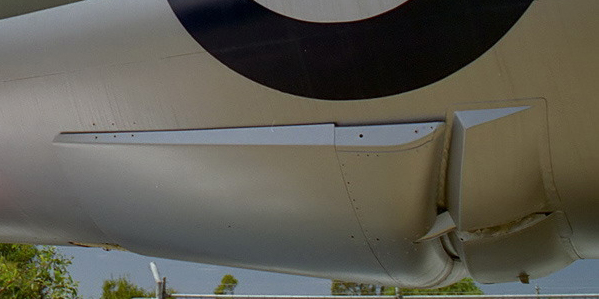

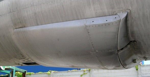

Bedders Posted January 18, 2020 Share Posted January 18, 2020 As far as I can work out, the T7/8 and GA+PR11s had the early airbrake and the 6, 9 an 10 had the later one. Justin 2 Link to comment Share on other sites More sharing options...
StephenMG Posted January 19, 2020 Share Posted January 19, 2020 (edited) Yes, 100-series engine (plus Sapphire) = old airbrake, 200-series engine = new airbrake. The new design of airbrake provided greater surface area, therefore more braking power, to aircraft with the more powerful engines without having to move the jack or hinge positions. Edited January 19, 2020 by StephenMG 1 Link to comment Share on other sites More sharing options...
gingerbob Posted January 19, 2020 Share Posted January 19, 2020 I'm pretty sure this has been covered elsewhere, but is the "back part" (aft of the obvious join line) the same on the two air brakes? Link to comment Share on other sites More sharing options...

StephenMG Posted January 19, 2020 Share Posted January 19, 2020 9 minutes ago, gingerbob said: I'm pretty sure this has been covered elsewhere, but is the "back part" (aft of the obvious join line) the same on the two air brakes? I'm pretty sure it is. I don't know for certain but I suspect they just redesigned and extended the front 'bit'. 1 Link to comment Share on other sites More sharing options...
