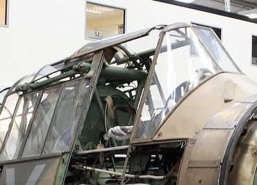

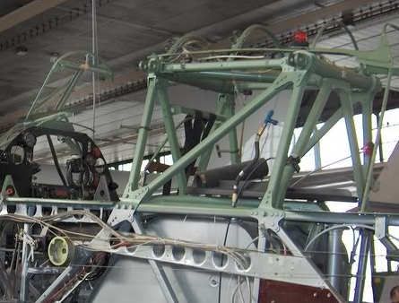

Procopius Posted January 5, 2020 Author Share Posted January 5, 2020 Yes, I think so. It looks like the upper tank has a cross-section a little like that of a gumdrop or an inverted U, correct? Link to comment Share on other sites More sharing options...
CedB Posted January 5, 2020 Share Posted January 5, 2020 You and your gumdrops! Er, yes, with a triangular bit on one end to go between the frame. As you’re going to scratch it I would use the framing and those pictures to make something that fits - the exact shape won’t really be seen once it’s all together eh? Link to comment Share on other sites More sharing options...

stevehnz Posted January 5, 2020 Share Posted January 5, 2020 17 hours ago, Procopius said: So just to be sure, are you saying this is an oil tank? From what I've seen online (I know, I know...) the indication seems to be it's an additional (and optional) fuel tank. Did oil tanks generally have dual feed lines, one on either side? 5 hours ago, CedB said: These pictures of the tank from my 1/48 build might help I think this pipe at the back is supposed to go into the other tank? My interpretation of these photos is the large inverted u shaped tank is an extra fuel tank, the smaller triangular tank is likely to be the extra oil tank. In the photo in @Procopius post, it shows as a slightly different colour, more zinc chromate green that the grey green of the larger tank, so making me believe it is a seperate tank rather than an extension of the lager one. Maybe? Steve. 2 Link to comment Share on other sites More sharing options...
dogsbody Posted January 5, 2020 Share Posted January 5, 2020 The larger internal tank is the regular fuel tank fitted to all Lysanders. The extra fuel for the SOE Lizzies was carried under the fuselage. The smaller internal tank is the extra oil tank. Chris 1 Link to comment Share on other sites More sharing options...
Ex-FAAWAFU Posted January 5, 2020 Share Posted January 5, 2020 I think Steve has a point. That would be a LOT of oil just to cope with extended ops 1 Link to comment Share on other sites More sharing options...

Procopius Posted January 6, 2020 Author Share Posted January 6, 2020 3 hours ago, stevehnz said: My interpretation of these photos is the large inverted u shaped tank is an extra fuel tank, the smaller triangular tank is likely to be the extra oil tank. In the photo in @Procopius post, it shows as a slightly different colour, more zinc chromate green that the grey green of the larger tank, so making me believe it is a seperate tank rather than an extension of the lager one. Maybe? Steve. 3 hours ago, Ex-FAAWAFU said: I think Steve has a point. That would be a LOT of oil just to cope with extended ops I don't disagree, but my copy of Hugh Verity's We Landed By Moonlight arrived today, and he mentions the oil tank resting behind the pilot, so... ¯\_(ツ)_/¯ (Incidentally, he mentions Noor's flight; she wore a green oilskin, apparently.) 5 hours ago, Steve Coombs said: Edward, I don't know if you have access to British TV, but Noor Inayat Khan has just appeared in an episode of Doctor Who. By all accounts, a fair number of people are looking her up online. And a good thing too. To some extent I do (I have a subscription to Britbox), but while I don't begrudge anyone who enjoys the revived Doctor Who, for me it ended in 1989 with "Survival". I'm glad Noor is back in the public consciousness; I hope their portrayal of her was respectful. In any case, I figured I might as well get started on throwing something together to go in that spot, oil tank or fuel tank or whatever. I cut a piece of thick plasticard to size: Then cut two more pieces like it, plus my right index finger. (It turns out that it can make a great deal of difference whether or not you're holding the scalpel upside down.) I also cut a delta out of plasticard, after some not-terribly-scientific but serviceable measuring. That will be used, or lost and replaced and the replacement will then be used, later. Then I used a spare Spitfire chin from an Eduard sprue I had left over, hacked it up, and glued it atop the three pieces of plasticard. Then I added thinner pieces fore and aft to close it up. Then I went over it with Mr Surfacer 500. Once it dries, I'll sand it down more or less. I may use my punch and die to add the filler cap up top and the drain ports or whatever on either side. Normally I absolutely would not entertain this level of effort, but Noor died for me and since this is somehow for her, I can't justify not doing it. 15 Link to comment Share on other sites More sharing options...

CedB Posted January 6, 2020 Share Posted January 6, 2020 Nice work on the tank PC Is the 'V' bit upside down though? On my Eduard kit it had the pointy bit on the top… Link to comment Share on other sites More sharing options...
Procopius Posted January 6, 2020 Author Share Posted January 6, 2020 3 minutes ago, CedB said: Nice work on the tank PC Is the 'V' bit upside down though? On my Eduard kit it had the pointy bit on the top… On the rear framing, the V points up like so: /\, but on the front, it's the other way 'round. No points for scaring me, you naughty man. 7 Link to comment Share on other sites More sharing options...
CedB Posted January 6, 2020 Share Posted January 6, 2020 Oh phew, thanks PC, I can now have a peaceful day 2 Link to comment Share on other sites More sharing options...
