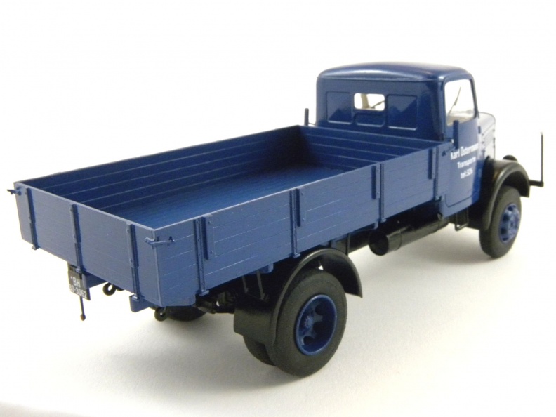

I chose Vallejo's Gold Brown to paint the interior, Medium Brown for the seat. The chassis and engine are all black, no detail painting on the engine as it will not be visible and I wanted a nice and quick build. The blue is Dark Blue with a touch of black.

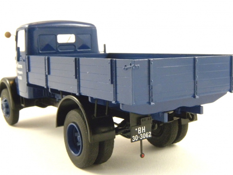

I used Gloss Varnish for the first time, I thought it would give a nice look to the truck. All paints and varnish applied by brush.
I "borrowed" some decals from the MiniArt L1500S kit which has enough for 8 different versions anyway.
There should have been one on the back as well, but of course I managed to totally destroy it.
