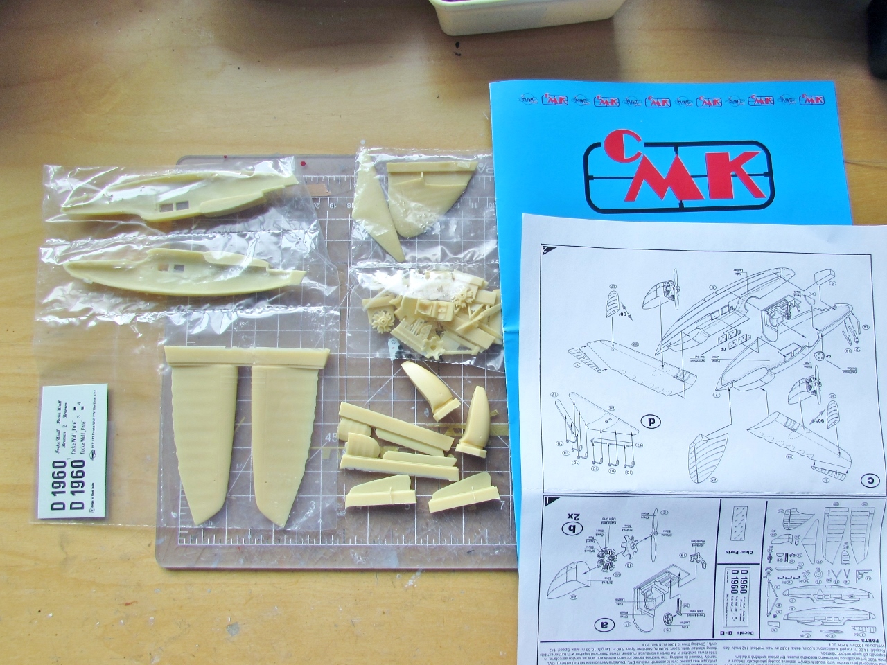

fjaweijfopi4j48 Posted November 12, 2019 Author Posted November 12, 2019 Material is provided for you to cut your own clear parts: The surface detail: The rattling bag of delicate parts, what could possibly go wrong: The parts still with their pouring blocks: The "curly" detail parts for the foreplane are not very accurate, more on that later: Other detail parts (rudder pedals, control column, inst. panel): Some of the more delicate bits broke apart: 4

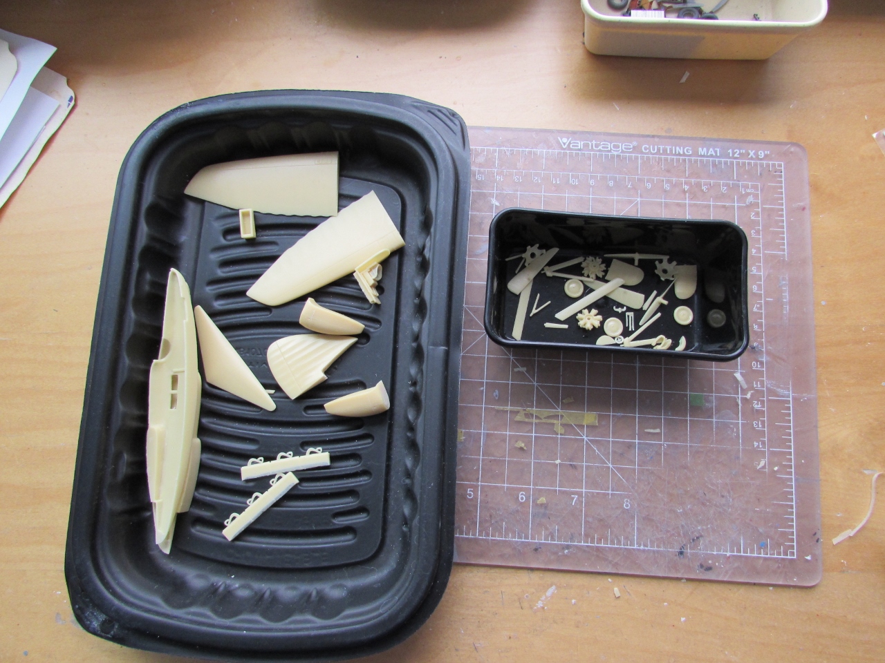

fjaweijfopi4j48 Posted November 12, 2019 Author Posted November 12, 2019 Fortunately, after cleaning up, no banana fuselages "a la Dujin", but the nose wheel well will need correction (more on that later): All parts separated form their pouring blocks and cleaned up: Substitution of some not so good items begins: 7

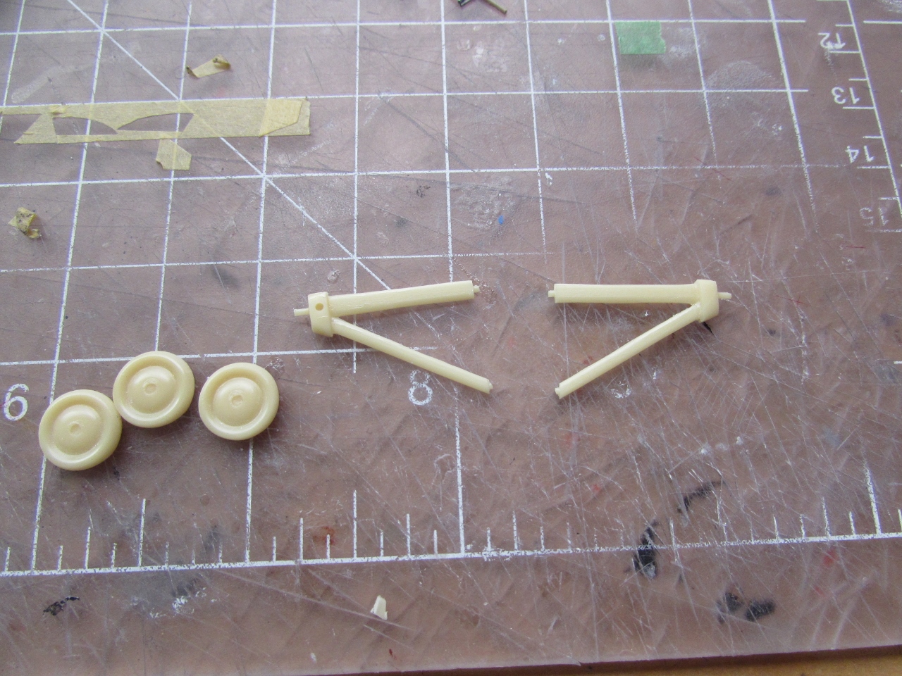

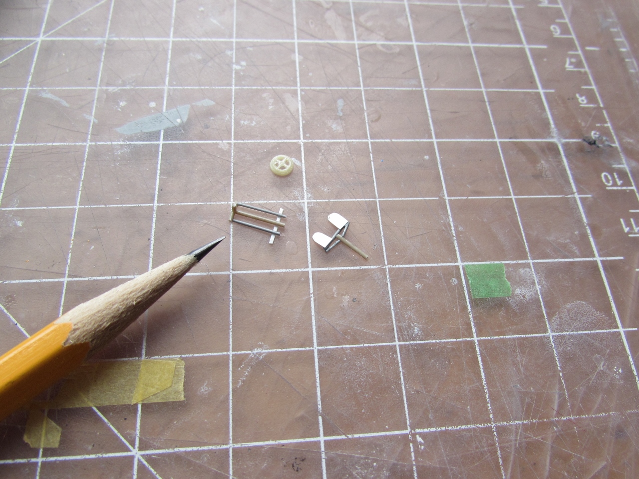

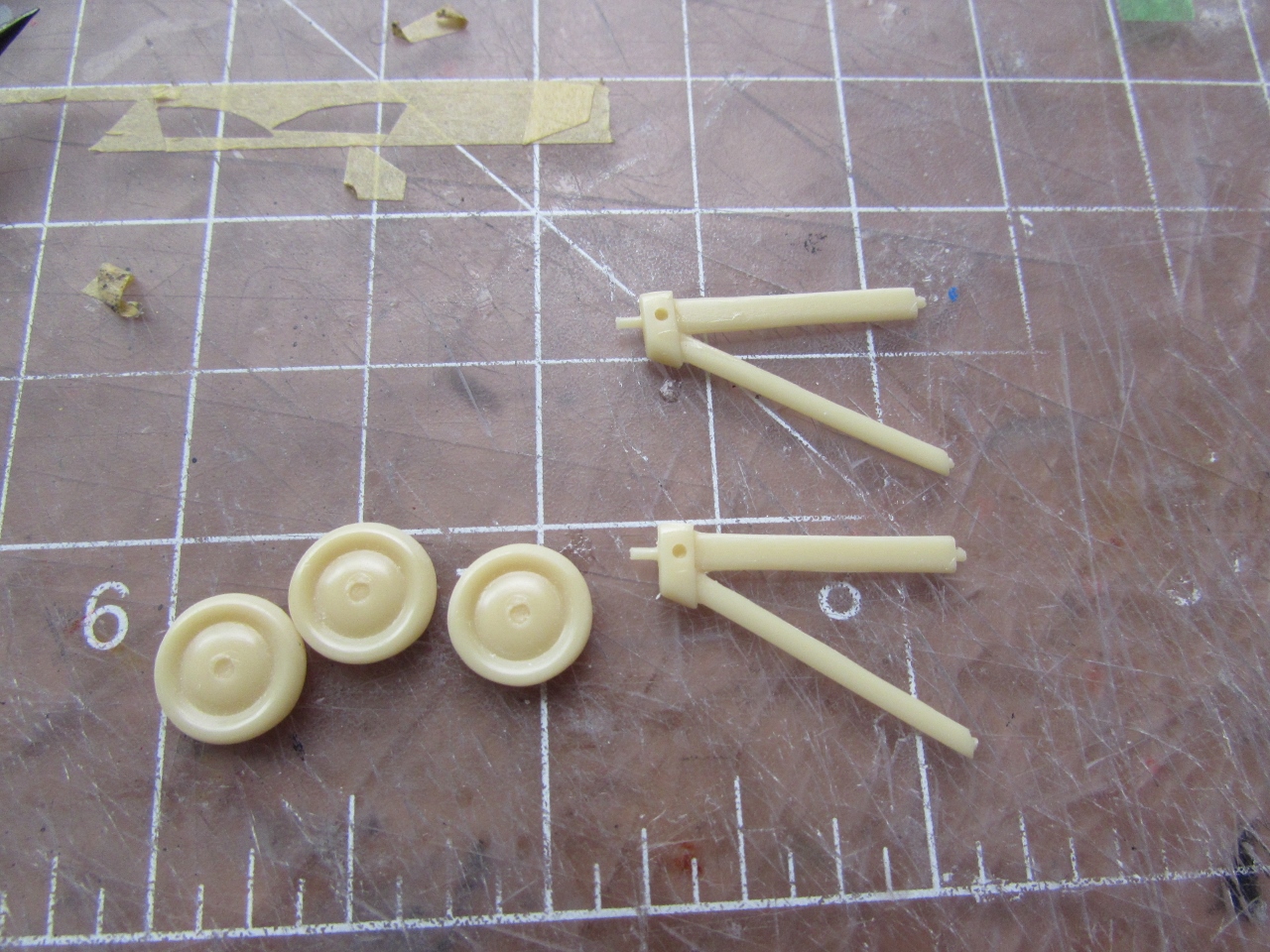

fjaweijfopi4j48 Posted November 12, 2019 Author Posted November 12, 2019 Notice something? Do you notice it now? The two issues are now fixed: hole for one of the the struts in the proper side, and replacement of weak resin axle for a metal pin: The mudguards were a bit chunky to my taste, so new ones are vac-formed over slightly bigger wheels: 5

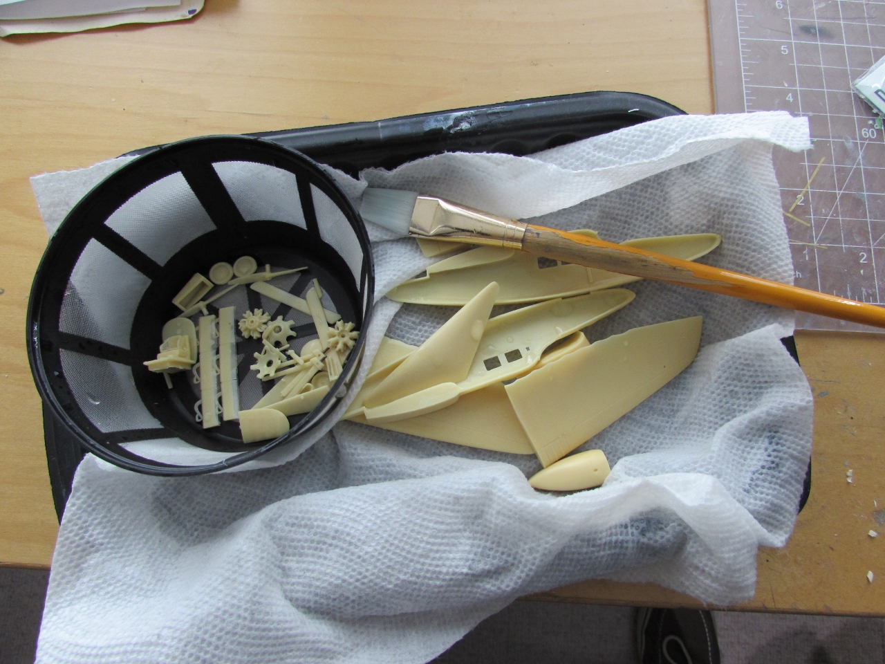

fjaweijfopi4j48 Posted November 12, 2019 Author Posted November 12, 2019 A thorough wash with mild detergent and lukewarm water. In the past I learned that resin kits have a persistent mold-release agent: It would have been smarter if Planet would have integrated that bit of rudder with the rudder: The bits are separated: Then glued together and in turn glued to the rudder, where they can be later blended-in much comfortably: 7

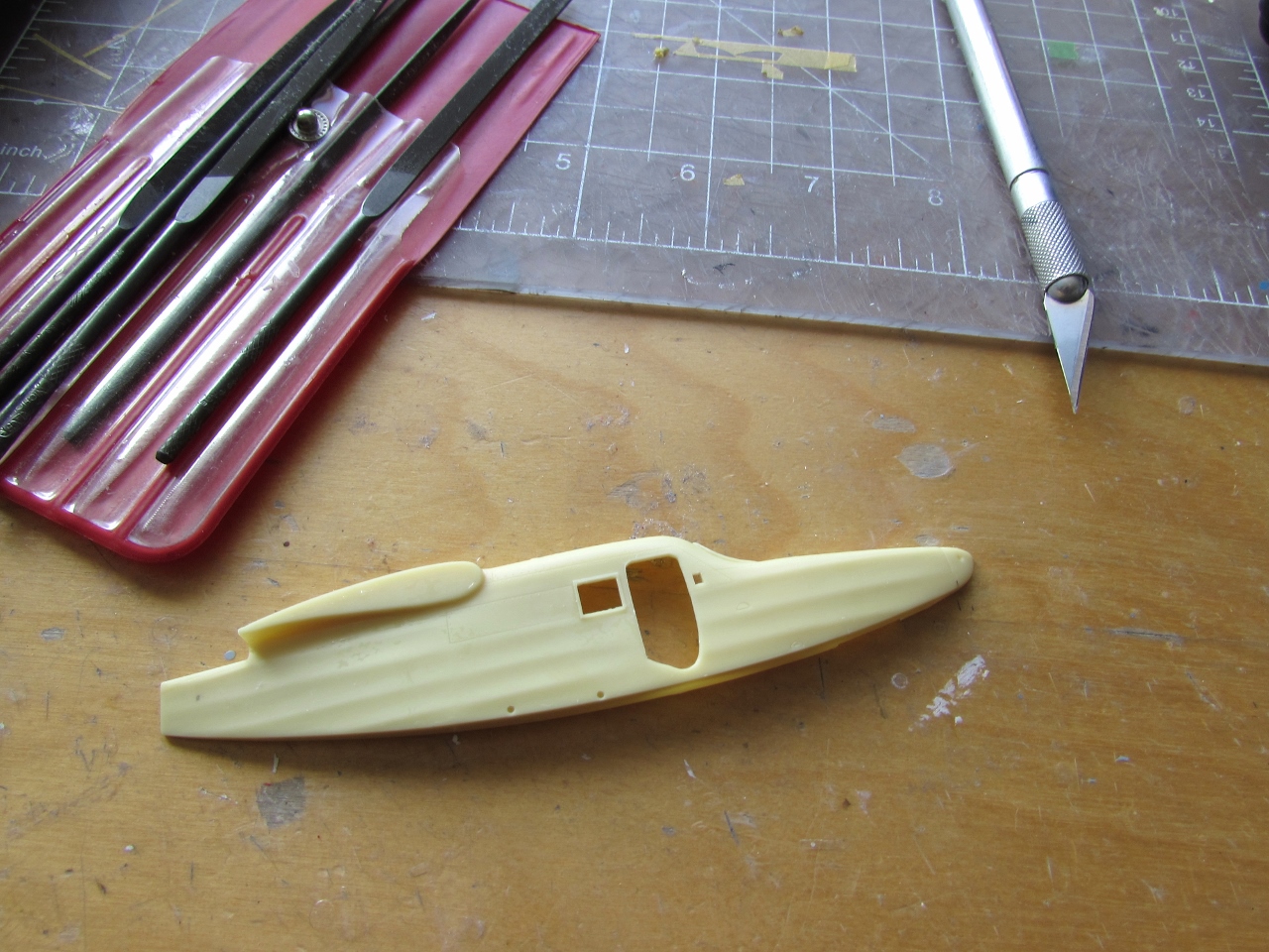

fjaweijfopi4j48 Posted November 13, 2019 Author Posted November 13, 2019 Now that I am familiarized with the parts, I would like to mention that the casting looks very good in the sense that I have found no bubbles or unsightly excrescences, or any deformities. My only nitpicking is that the wings could perhaps use a bit more washout, which was pronounced on the Ente. I struggled to decide if opening the door or not, but at the end sanity prevailed...and I opened the door: 2 4

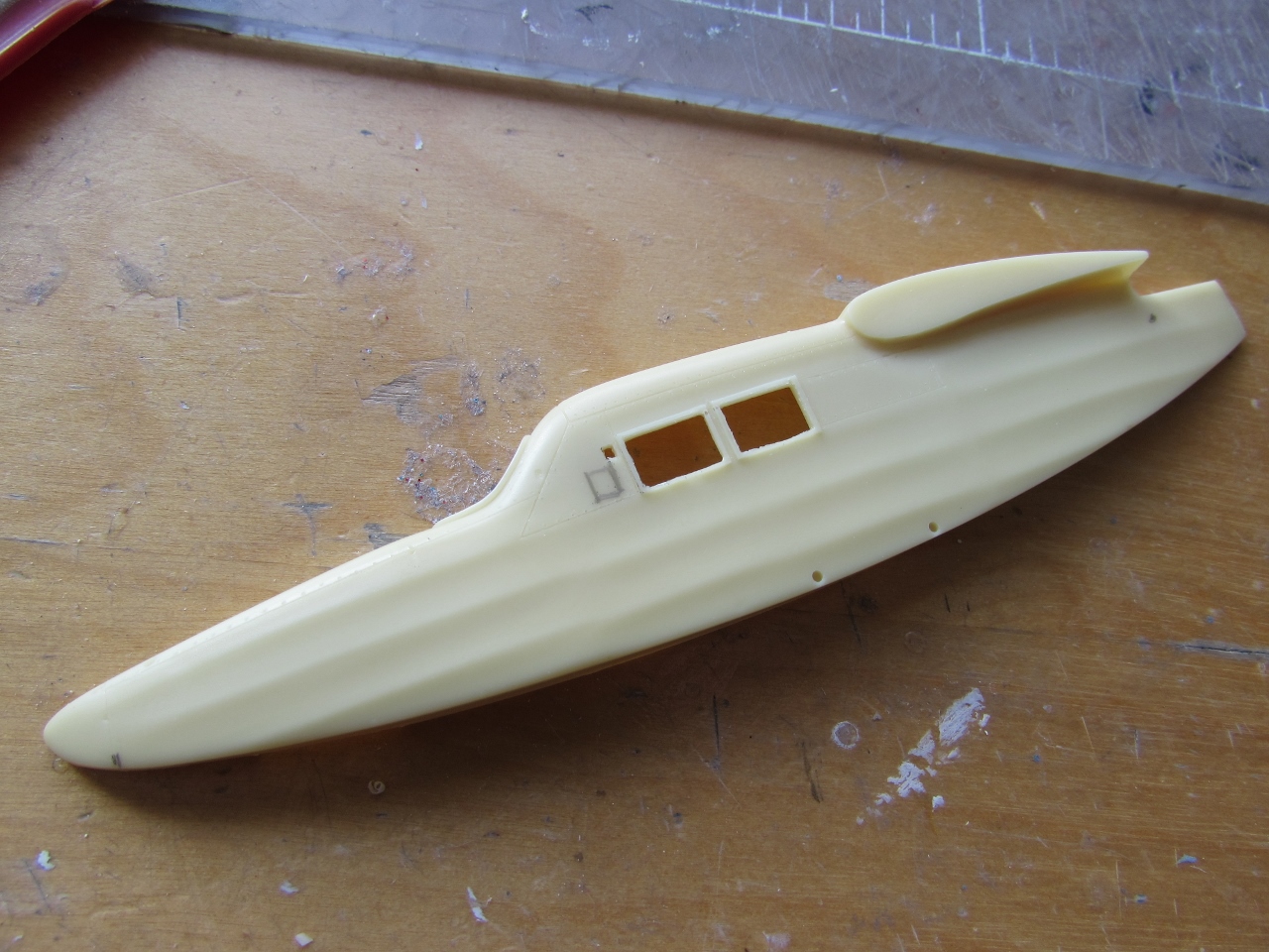

fjaweijfopi4j48 Posted November 13, 2019 Author Posted November 13, 2019 Next was to correct the too small little windows. (It is worth noting that as just built and flown the Ente did not have those little windows). In the case of the left fuselage that small window was entirely misplaced. The pencil mark shows where it should be: The right-side fuselage small window is enlarged: New little window in place: Inaccurate one plugged: And now... HOUSTON, WE HAVE A PROBLEM... Planet has the windows not aligned, being the right-side fuselage ones too far ahead: Which produces this: Now, I immediately went back to my references and checked all photos and clips that show the plane from the side, and I can see that, opposite to what the kit features, they windows are aligned, which also makes sense structurally. So, what do we do now... 1 3
Martian Posted November 13, 2019 Posted November 13, 2019 I guess its out plastic card, super goo and baking soda time. Been there myself more times than I care to remember. Helpful of Mars 👽 1 1

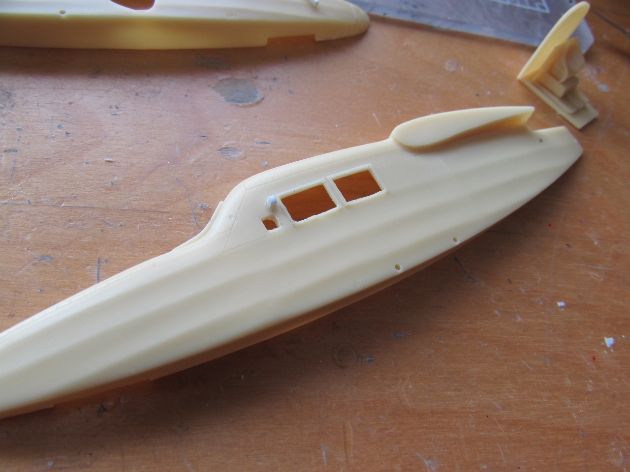

fjaweijfopi4j48 Posted November 13, 2019 Author Posted November 13, 2019 Both sides are actually a bit displaced, but it's easier to fix the left fuselage side: 3
fjaweijfopi4j48 Posted November 13, 2019 Author Posted November 13, 2019 Regarding the above: One thing about references is that you should read them all, not selectively. If I would have really read the Jet & Prop magazine article I cited at the beginning, I would have realized that the modeler had exactly the same issue. Live and learn, but also good ole read and learn. 1
fjaweijfopi4j48 Posted November 14, 2019 Author Posted November 14, 2019 The frames are restored with thin styrene strip, and the small window is relocated: No little matter this blatant inaccuracy of the kit, but fortunately relatively easily* corrected. *three adverbs of manner in a row! 5

Silenoz Posted November 14, 2019 Posted November 14, 2019 Nice and intriguing aircraft. Beautiful work to. Isn't the door too far to the front? 1

fjaweijfopi4j48 Posted November 14, 2019 Author Posted November 14, 2019 6 hours ago, Silenoz said: Nice and intriguing aircraft. Beautiful work to. Isn't the door too far to the front? Thanks Silenoz Yes, as I wrote above the windows are misaligned in the kit, pushing that door a bit ahead of where it should be. To cut open the door, I strictly followed the kit's outline of it. Still, it will align with the bulkhead, as it in turn will be moved forward a bit, so it will be between the edge of the door and the little window, as in the original. The solution is a bit of a compromise, but the alternative is either trashing the kit and dedicate some proper language to the kit maker, or redo both fuselage sides through extensive surgery that may remedy one thing but create other issues of its own. I followed the same solution found by the modeler in what it seems was the first published build of the kit long ago. And these kits did not come cheap, as you can find doing an Internet search for them. Cheers 1
