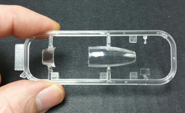

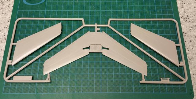

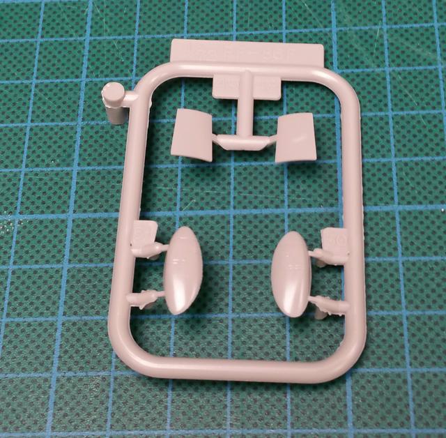

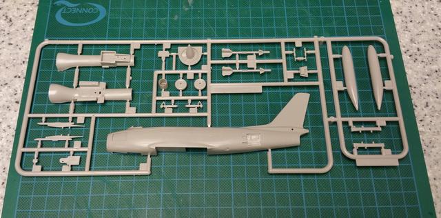

Courageous Posted October 24, 2019 Share Posted October 24, 2019 Hi All, With my F-86F-30 fighter-bomber now at home and heading for the spray booth, it's time to ready-up my next Sabre build. So, by popular request, I'm doing an RF-86F Recon Sabre of the Japanese Air Self-Defense Force using the 1/72 Fujimi kit, my first Sabre from this manufacturer. Usual intro: Pretty box. Wing sprue. Starboard fuselage+ sprue. Port fuselage+ sprue. Side blisters and 'blank' gun-port panels. Underside camera fairings. Cockpit glazing. Decal sheet. And obviously an instruction sheet. This will run alongside my Caudron build at my 'works' work bench and will be built OOB, unless somebody knows something I don't with this kit. Laters... Stuart 3 Link to comment Share on other sites More sharing options...
RidgeRunner Posted October 25, 2019 Share Posted October 25, 2019 (edited) Nice one, Stuart. My main gripe with the Fujimis (and I think they are THE best in 1/72) is the less than snug fit of the lower wing section with the fuselage. Be prepared for a fair bit of sanding. Get it "comfortable" and dont force it as you will lose the dihedral, as I did in the early days . If you can get one, go for a resin cockpit. It really adds to the detail. Martin Edited October 25, 2019 by RidgeRunner 1 1 Link to comment Share on other sites More sharing options...

Andre B Posted October 25, 2019 Share Posted October 25, 2019 (edited) I was impressed by the cockpit glasing. First time i've seen that in 1/72 scale. Don't knew any other with those lines on the canopy... Following with interest! Sheers / André Edited October 25, 2019 by Andre B Link to comment Share on other sites More sharing options...
Courageous Posted October 25, 2019 Author Share Posted October 25, 2019 19 minutes ago, Andre B said: I was impressed by the cockpit glasing. First time i've seen that in 1/72 scale. Don't knew any other with those lines on the canopy... Your welcome to follow André. The 1/72 Academy kits also has type of canopy but I've managed not to use them in previous builds as I didn't know what those lines were, maybe @Sabrejet can tell us? Stuart 1 Link to comment Share on other sites More sharing options...
72modeler Posted October 25, 2019 Share Posted October 25, 2019 IIRC, they are the ADF sense aerials imbedded in the canopy- wait for @Sabrejet to confirm or deny. Mike 1 Link to comment Share on other sites More sharing options...
Sabrejet Posted October 25, 2019 Share Posted October 25, 2019 Yes - radio compass sense antenna; the other part of the system is the loop antenna, which is the domed glass-encased item beneath the aft canopy. Watching this with interest! 2 Link to comment Share on other sites More sharing options...
Courageous Posted October 25, 2019 Author Share Posted October 25, 2019 48 minutes ago, 72modeler said: IIRC, they are the ADF sense aerials imbedded in the canopy 12 minutes ago, Sabrejet said: Yes - radio compass sense antenna Cheers guys. As a matter of interest, when were these fitted into the canopy...and please don't say 'from the beginning'? Stuart Link to comment Share on other sites More sharing options...
Andre B Posted October 25, 2019 Share Posted October 25, 2019 (edited) 1 hour ago, Courageous said: Your welcome to follow André. The 1/72 Academy kits also has type of canopy but I've managed not to use them in previous builds as I didn't know what those lines were, maybe @Sabrejet can tell us? Stuart Hi, Some pictures on the real thing (#11) in this thread about the ADF sense aerials thanks to Sabrejet... Cheers / André Edited October 25, 2019 by Andre B 1 Link to comment Share on other sites More sharing options...

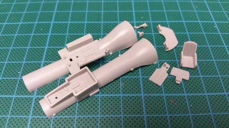

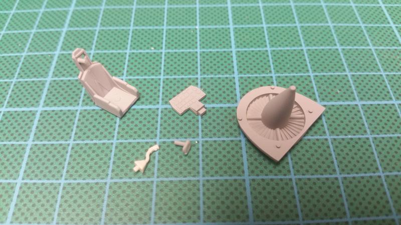

Courageous Posted November 1, 2019 Author Share Posted November 1, 2019 Sorry for the slowness, been one of those weeks... As usual, the cockpit is the first place to be tackled. The parts are not that different from the Academy/ Hobbycraft kits. Parts cleaned and primed. I have fitted the seat to its ejection rail but I'm not sure whether I like the seat or not. I might see what a resin option looks like (should please @Terry1954 and @RidgeRunner) The new kid on the block is the turbine that I will of course paint but won't see any of it down the intake...well maybe, if you had a torch. Intake halves joined together and primed, also added the rear wall. Some nice detail on the side consoles but I have a dilemma on my hands in that the kit supplies decals for the consoles and i/p. So, do I sand flat the detail or leave the detail and apply the decal? Also of note are two lines of sink marks, not an easy place to fill and sand. A little further ahead, the fuselage halves. The instructions call for the slot to be added to the sides and holes added in each fuselage bottom half to facilitate the fitting of the side blisters and camera fairings. No work on the 'RF' for a week or so 'cos it's at work...and I'm not. Stuart 2 Link to comment Share on other sites More sharing options...

pinky coffeeboat Posted November 2, 2019 Share Posted November 2, 2019 That's coming on nicely, we don't often see JASDF Sabres. Regarding the floor sink marks, are you actually going to attempt to remove them? I would imagine there won't be much to see once fully assembled especially if it is painted black. Which marking option will you be using? Jeff 1 Link to comment Share on other sites More sharing options...

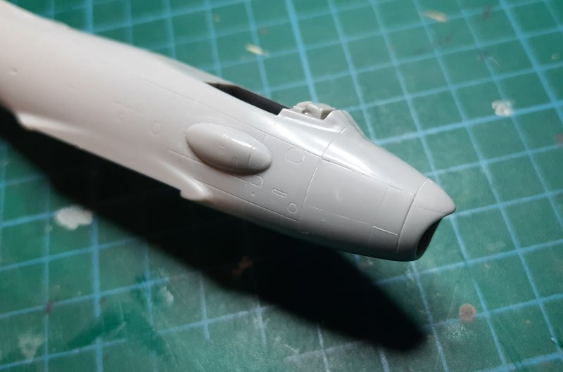

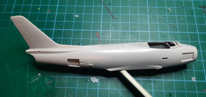

Courageous Posted April 22, 2022 Author Share Posted April 22, 2022 Hi folks. Can't remember why this build stopped but after reeling from a club group build that I didn't enjoy one bit, thought I'd head back to familiar territory. With a suitable amount of weight fitted in the nose, the fuselage halves were joined and the joints were tidied-up using 'gloop', a first for me. The gun panels were replaced with blanking panels. Camera bays were fitted, as was the nose. Nice to be back Stuart 2 Link to comment Share on other sites More sharing options...

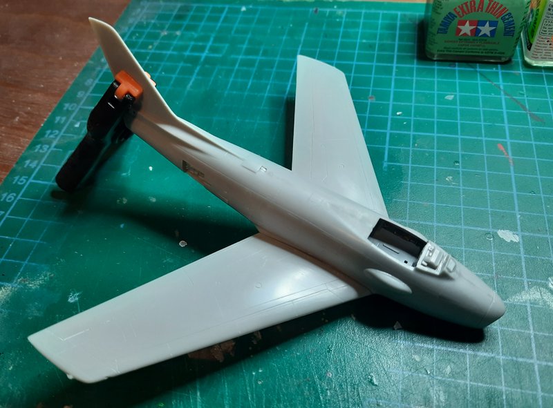

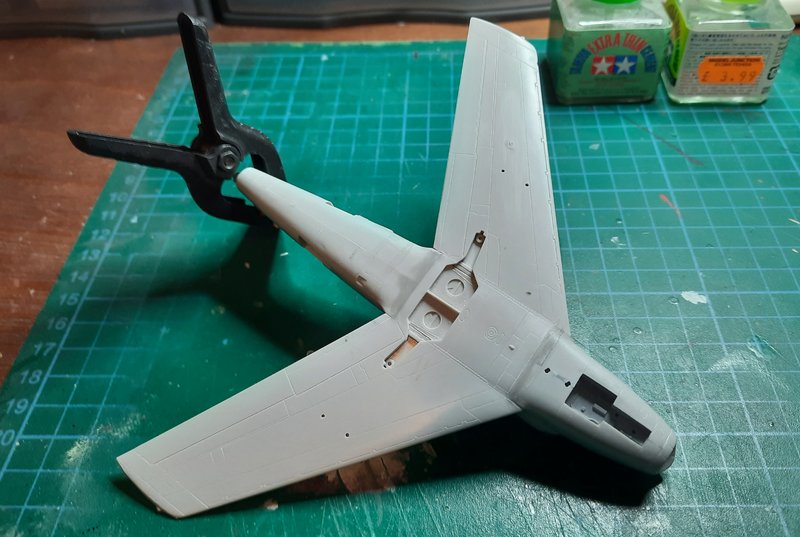

Courageous Posted April 24, 2022 Author Share Posted April 24, 2022 No wing surgery on this build, so the wings go on. Just a little filler along the wing root. Again, a bit more filler/ sanding to blend things in underside. Stuart 2 Link to comment Share on other sites More sharing options...
Courageous Posted April 24, 2022 Author Share Posted April 24, 2022 Question: On the underside of this Sabre, their are three camera bays with square windows with cameras, what colour do people suggest that I paint these cameras and windows? Stuart 1 Link to comment Share on other sites More sharing options...
