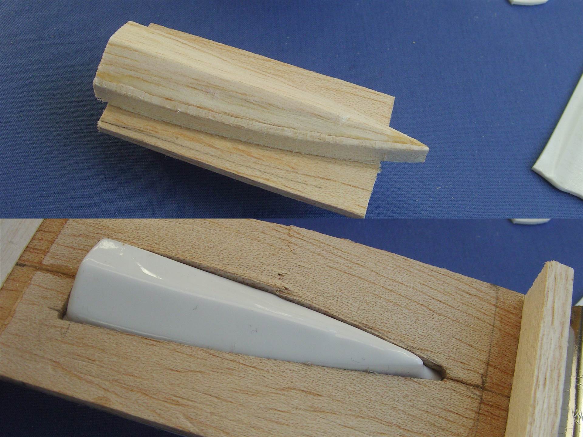

DMC Posted September 5, 2019 Author Posted September 5, 2019 Male moulds carved then and ready for the female moulds. I use thick balsa for most of my female moulds. This piece almost a quarter inch thick. Anything less for a plunge this big is likely to crack. Early on I learned that it was easier to split the wood lengthwise and then carve out the opening rather then try to do out it of one piece. I’ve also experimented with clearances and, for most plunges, have settled on 1/16” or near enough. Smaller plunges need less. After gluing the mould halves together I made risers (?) thick enough to keep to hot styrene from bottoming out and spoiling the plunge. On some moulds the risers are glued on but on this mould I only pinned them on so I could swap sides rather than make a mould for right and left. That’s it for today, must get cracking on with the wing or I’m going to run out of photos and have nothing done. Thanks for looking Dennis 5
greggles.w Posted September 5, 2019 Posted September 5, 2019 Appreciate the tutorial- there’s quite a bit of meticulous planning & preparation toward one melting moment!
DMC Posted September 6, 2019 Author Posted September 6, 2019 8 hours ago, greggles.w said: Appreciate the tutorial- there’s quite a bit of meticulous planning & preparation toward one melting moment! No problem , Greg. I realised early on that the more time I took with with the moulds, usually, the better the results. Logical I suppose but sometimes even best efforts get it wrong. Here is the first fuselage plunge. I use bulldog clamps to clamp the styrene to the mould and heat it in an old toaster oven. A large kitchen oven really wouldn’t do. Madam doesn’t care for the fragrance of cooking plastic, not to mention the electric bill if you do a lot of plunging. Takes about 5 minutes to soften .040 styrene to plunge ready. The balsa stops on the male mould keep me from plunging too deeply. Hmmm, Village Photos not working for me this morning. I’ll try again later. Ah! There it is. Thanks for looking Dennis 3
Courageous Posted September 6, 2019 Posted September 6, 2019 (edited) 1 hour ago, DMC said: The balsa stops on the male mould keep me from plunging too deeply. Having never done anything on this scale, would you not make it a little deeper to allow for the thickness of the plastic? Stuart Edited September 6, 2019 by Courageous
DMC Posted September 6, 2019 Author Posted September 6, 2019 4 hours ago, Courageous said: would you not make it a little deeper to allow for the thickness of the plastic? Stuart Edited 4 hours ago by Courageous I would and do, Stuart. In this example I only used the v-shaped bit. You can see in the photo that the plunged bit is deeper than what I actually needed. No formula for it, mostly trail and error. Early days I sometimes made 3 or 4 moulds. Getting a little better at it now, however. Dennis 5 1
