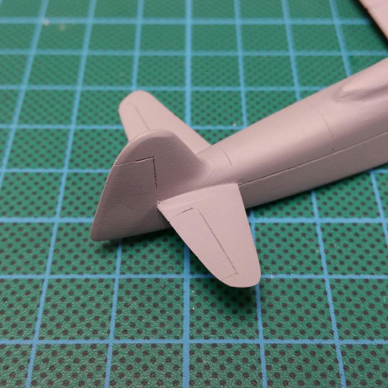

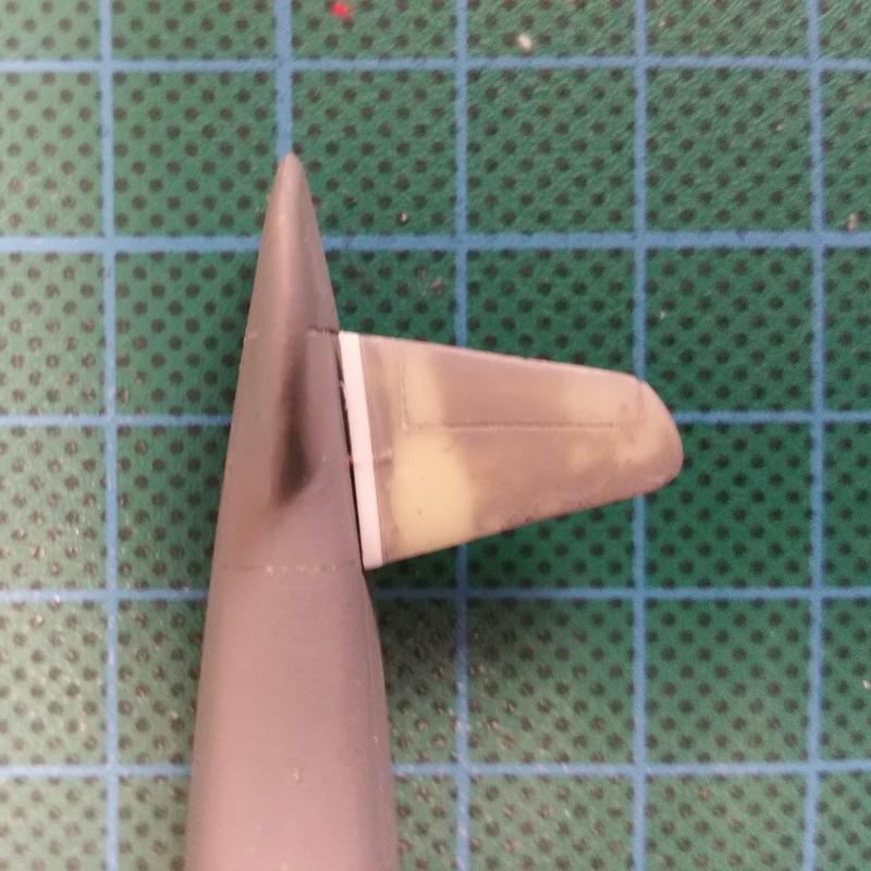

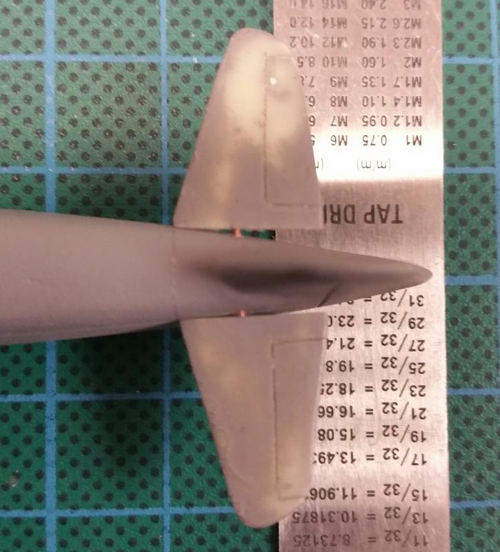

Courageous Posted January 2, 2020 Author Share Posted January 2, 2020 Back to the work's workbench. I managed to drill a 0.6mm hole into each tail plane, fit a copper pin and placed on the model's back end. It was at this time that this kit gave me another bite in the bum with the tail being slightly deformed giving me a bigger gap on the starboard side as opposed to the port...bugger! A bit of head scratching then ensued. First the port plane, a wedge of resin was removed from the plane and a 1mm shim added and sanded. It fits quite nicely to the fuselage and the elevator hinge is nice and perpendicular to the centre line. All I've got to do now is replicate it on the other side but as can be seen from the top pic, the gap is bigger, so a little more tricky. Stuart 6 Link to comment Share on other sites More sharing options...

Terry1954 Posted January 2, 2020 Share Posted January 2, 2020 6 hours ago, Courageous said: Back to the work's workbench. Great to see this going again. Looks like a Tap Drill conversion ruler there. Interesting. Terry 2 Link to comment Share on other sites More sharing options...

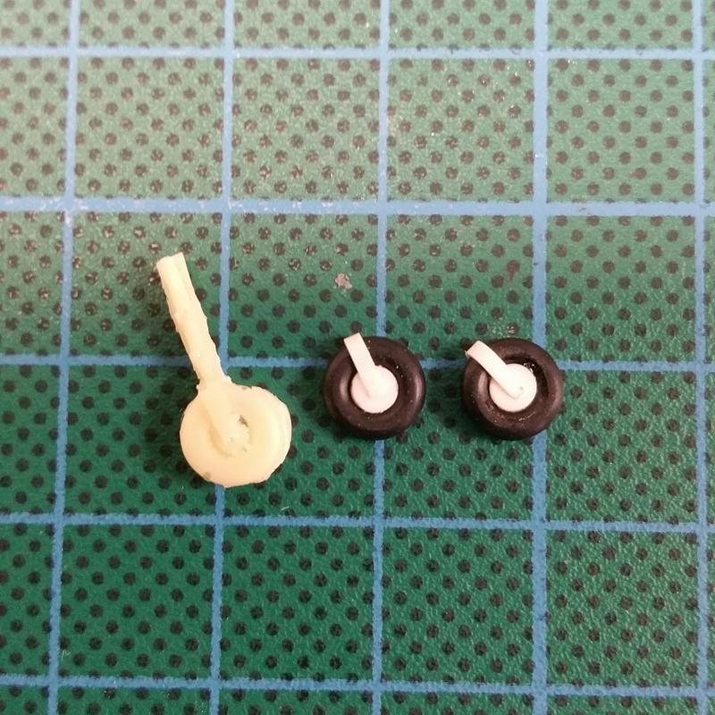

Courageous Posted January 3, 2020 Author Share Posted January 3, 2020 12 hours ago, Moa said: The dreaded Build of the Dujin Resin Kit was among the last challenges at the Shaolin Modelling Monastery. Last challenges...what happens next, oh, oh. 14 hours ago, Terry1954 said: Looks like a Tap Drill conversion ruler there. It might be but I deal in electronics... 13 hours ago, Massimo said: Anyway you're handling it quite well!!! Cheers Mas. Where have you been? Back to the build... Still need a little remedial work. Lined up nicely. Kit resin option was crap, so i took a leaf out of @Moa's book and knocked up a set of wheels from O-rings, punched plastic centres and a thin plasticard 'bridge'. Stuart 13 Link to comment Share on other sites More sharing options...
Johnson Posted January 3, 2020 Share Posted January 3, 2020 That's looking good Stuart. 38 minutes ago, Courageous said: knocked up a set of wheels from O-rings, punched plastic centres and a thin plasticard 'bridge' What a good idea, never thought of doing that. Link to comment Share on other sites More sharing options...
Terry1954 Posted January 3, 2020 Share Posted January 3, 2020 4 hours ago, Courageous said: It might be but I deal in electronics... And there was me thinking I'd found a fellow closet engineer Those wheels are neat. Terry 1 Link to comment Share on other sites More sharing options...

Marklo Posted January 4, 2020 Share Posted January 4, 2020 On 1/3/2020 at 1:19 PM, Courageous said: so i took a leaf out of @Moa's book and knocked up a set of wheels from O-rings, punched plastic centres and a thin plasticard 'bridge'. I use buttons 1 Link to comment Share on other sites More sharing options...

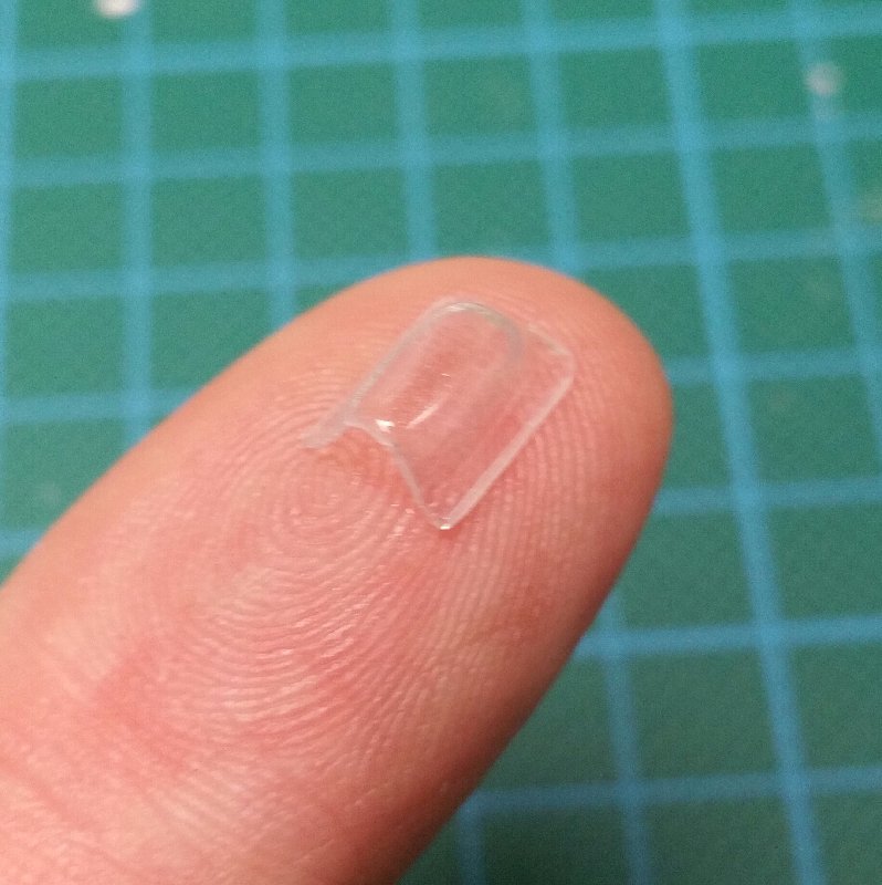

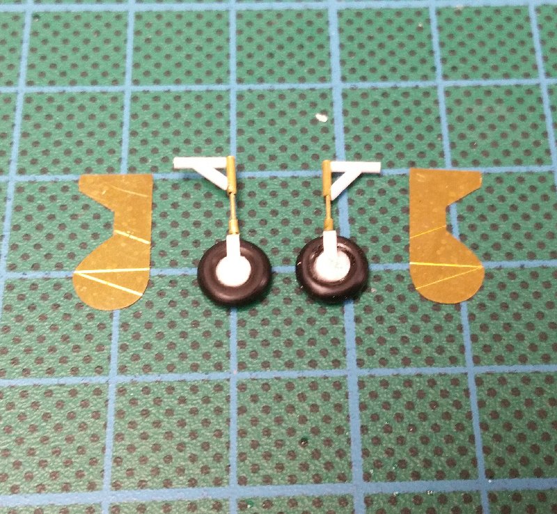

Courageous Posted January 13, 2020 Author Share Posted January 13, 2020 Getting over a lack of mojo. A small update but then again updates on this build a small. Wheels and undercarriage done to an approximation of what would've been there. The PE doors look a little awkward to do but I'll get there. And just for a laugh, here is the sliding canopy and I've still got to mask it! Stuart 9 Link to comment Share on other sites More sharing options...

Johnson Posted January 13, 2020 Share Posted January 13, 2020 34 minutes ago, Courageous said: And just for a laugh, here is the sliding canopy and I've still got to mask it! I think its even smaller than the canopy for my Supermarine S.6B! Glad you're feeling more like it Stuart. It's only a hobby I know, but it can be hard work and difficult to feel motivated sometimes. 1 Link to comment Share on other sites More sharing options...
fjaweijfopi4j48 Posted January 13, 2020 Share Posted January 13, 2020 I concur, fantastic work! Man, that's a small thing! (in size, not in smartness) Cheers 1 Link to comment Share on other sites More sharing options...
Massimo Posted January 13, 2020 Share Posted January 13, 2020 Coming along nicely! The kit is difficult to describe,but those undercarriae legs are remarkable and you're doing agreatjob!!! Well done!!! 1 Link to comment Share on other sites More sharing options...
AdrianMF Posted January 13, 2020 Share Posted January 13, 2020 Wow! Just caught up with this. Superb work on whittling an aeroplane out of those blobs of resin. I like the O-ring wheels too. Regards, Adrian 1 Link to comment Share on other sites More sharing options...

Courageous Posted January 13, 2020 Author Share Posted January 13, 2020 Cheers guys. 7 hours ago, Lightningboy2000 said: very racy looking. That's because it's a racer Martin 7 hours ago, Johnson said: I think its even smaller than the canopy for my Supermarine S.6B! Not much in it I'd think. These speedbirds were pretty dinky things. 3 hours ago, Moa said: Man, that's a small thing! I've been told that size in't everything. 3 hours ago, Massimo said: he kit is difficult to describe Try horrendous, the worst I've encountered so far. 3 hours ago, AdrianMF said: Superb work on whittling an aeroplane out of those blobs of resin. Their were occasions it came close. 2 hours ago, Bengalensis said: It's obvious they need quite a bit work to reach this level. I've got another 3-4, I'll let you know. Stuart 1 2 Link to comment Share on other sites More sharing options...
