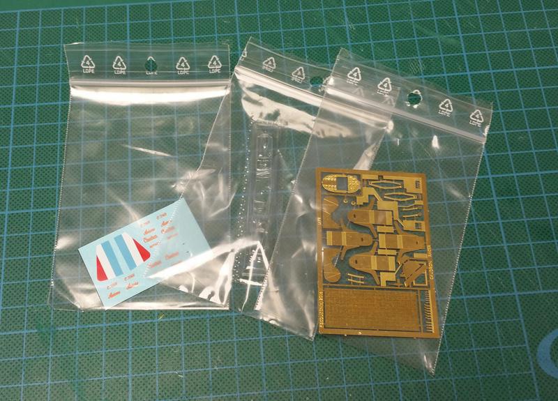

Courageous Posted August 23, 2019 Share Posted August 23, 2019 Though I'd dip my toes into a resin kit build, haven't done that in a very long time. I recently purchased a number of Caudron racers from Dujin and thought I'd start off by looking into the 714R. First of all... ...the box, looks innocent enough. Open the box, open the box! A PE fret, a vac canopy and some nicely printed decals...looking good. Aaahhhhh!!! I dare not look too closely at the moment but it looks like I've got my work cut here with lots of cleaning. And three pages of stuff that only a Google translator will be able to decipher. Am I put off, nah, just a flesh wound, modellers are made from this stuff. You can all have a laugh now. Stuart 8 Link to comment Share on other sites More sharing options...

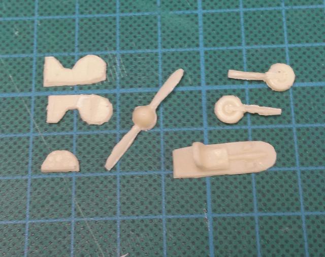

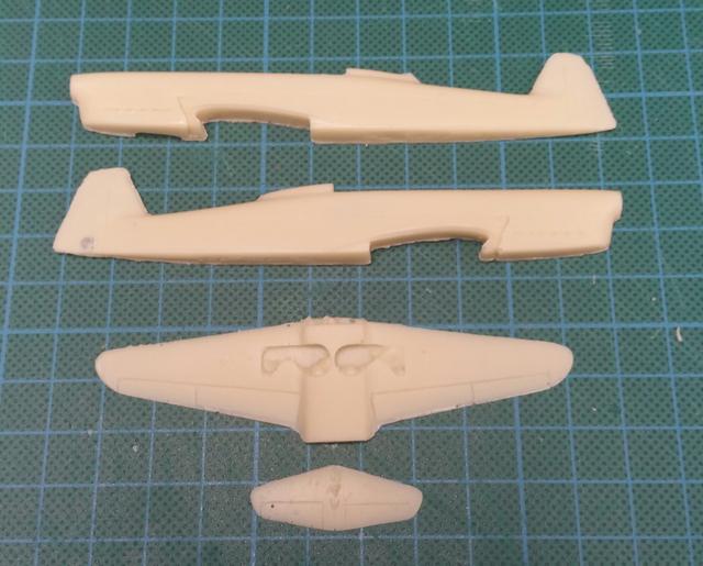

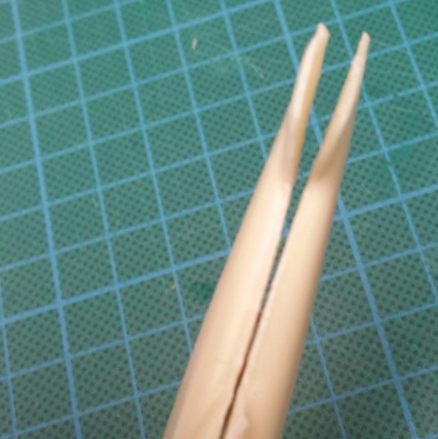

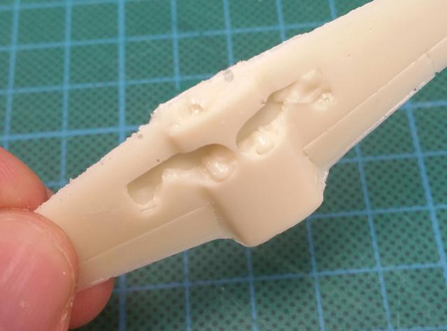

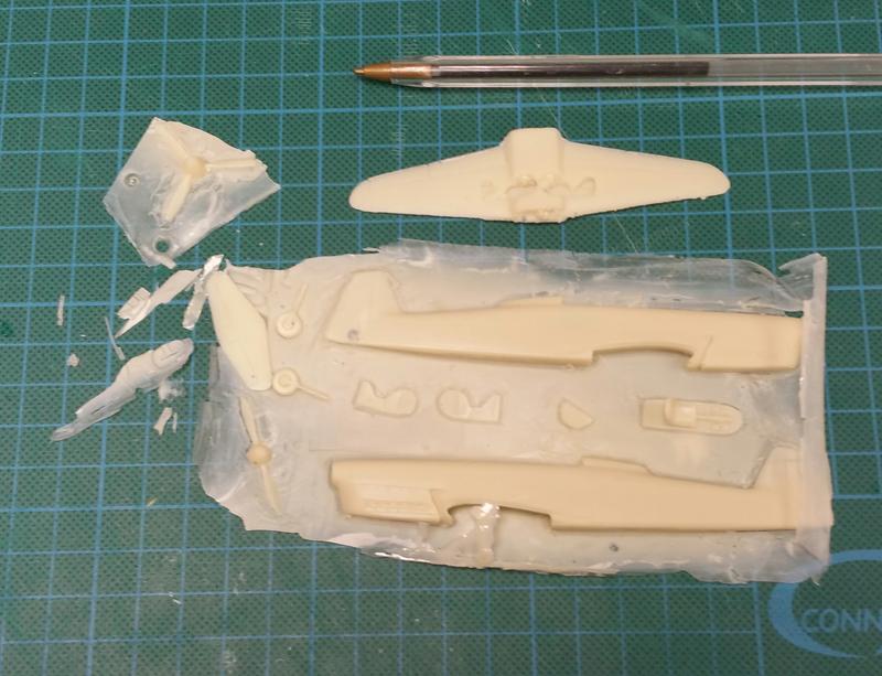

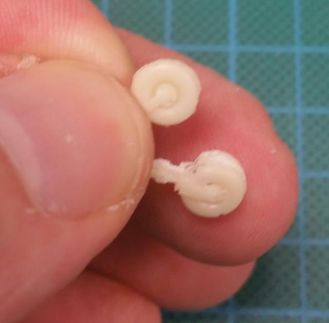

Courageous Posted October 14, 2019 Author Share Posted October 14, 2019 Thought I'd do a little investigation into this resin kit. and separated the parts from the bucket of flash. Fuselage halves, main wing and a horizontal stabilizers. That is some warpage on the fuselage rear section, not to sure how I'm going to sort this. Main wing with wheel wells full of c**p, will have to be very careful here. Smaller parts; wheels with legs, wheel covers, integral cockpit, I/P and a prop, that's 11 parts in all... ...and these are meant to be wheels with their legs. I can safely say that this is the worst kit I've ever encountered and is going to give me much pain and anxiety. If I can wrestle the main parts into submission, I may have to scratch parts like the wheels, undercarriage, wheel well covers, etc. Have I met my match here...time will tell. Stuart 5 2 Link to comment Share on other sites More sharing options...

Marklo Posted October 14, 2019 Share Posted October 14, 2019 (edited) Personally I’d just use it as a template to make a new one. Otherwise a Dremel, lots of patience, some very strong clamps and possibly some very strong alcohol Edited October 14, 2019 by Marklo 1 2 Link to comment Share on other sites More sharing options...
Courageous Posted October 14, 2019 Author Share Posted October 14, 2019 6 hours ago, roadrunner said: very courageous... ...or very stupid. I have seen you WiP (2017) but I seem to have trouble seeing all your images at the moment. 3 hours ago, Marklo said: use it as a template to make a new one. Nice idea but with a number of Dujin racers in the stash, I need to tame these beasties...looks like my bottle of Jameson's might take a hit. Stuart Link to comment Share on other sites More sharing options...
fjaweijfopi4j48 Posted October 14, 2019 Share Posted October 14, 2019 7 hours ago, Courageous said: ...and these are meant to be wheels with their legs. As it pertains to Dujin kits, they are not referred as "parts", but as UROs (Unidentifiable Resin Objects). 5 Link to comment Share on other sites More sharing options...
fjaweijfopi4j48 Posted October 14, 2019 Share Posted October 14, 2019 7 hours ago, Courageous said: Main wing with wheel wells full of c**p, will have to be very careful here. Those delicious bubbles you also see in the general area are the result of the French recipe for resin, which includes Champagne*. Always the gourmands, the French! *Appellation d'origine contrôlée (AOC, not to be confused with my hero AOC, Alexandria Ocasio-Cortez) Cheers 1 3 Link to comment Share on other sites More sharing options...
Bronzemeister Posted October 14, 2019 Share Posted October 14, 2019 Word of warning on these type of resin kits. The temptation is to sand the fuselage halves flat so the tail and nose meet up again, however this usually lends to an unintentional wasp waisted fuselage. Heat is what is needed, but what type? Boil them! Give them a good bath in a nice rolling boil for about 5 minutes. Use a big enough pot so they don't get crowded and use tongs to keep them off the bottom. They generally tend to float about in the bubbles anyway, so it's not too hard. When they's good and warm throughout, lift out with tongs, flex them a bit more they need to go (over-correct), and then plunge them into a sink of cold water to set them. If they don't look good after the cool down, boil them again! A hair dryer is usually what works better on thin things, but it will never get the internal thickness of this resin up high enough to get it to stay where you want it. Boiling will. And you get to enjoy all those lovely resin vapors again! They are part of the bubbles after all! 2 Link to comment Share on other sites More sharing options...
John Aero Posted October 14, 2019 Share Posted October 14, 2019 A Bain Marie, which is a pan full of hot water, with an inner bowl which does not contact the bottom of the pan, is a way of transferring the heat of the pan water to the liquid in the bowl, in which is immersed the resin parts. This is the way you melt chocolate, without it burning on the pan bottom. Polyurethane resin has a heat deflection temperature of around about 50 deg. An alternative way is to strap the resin fuselage either side of a thin piece of metal such as a small steel rule or a thin large nail file or flat knife blade and immerse that into the water. allow to heat and then run under cold water. This gives you a constant centre line. John 4 Link to comment Share on other sites More sharing options...

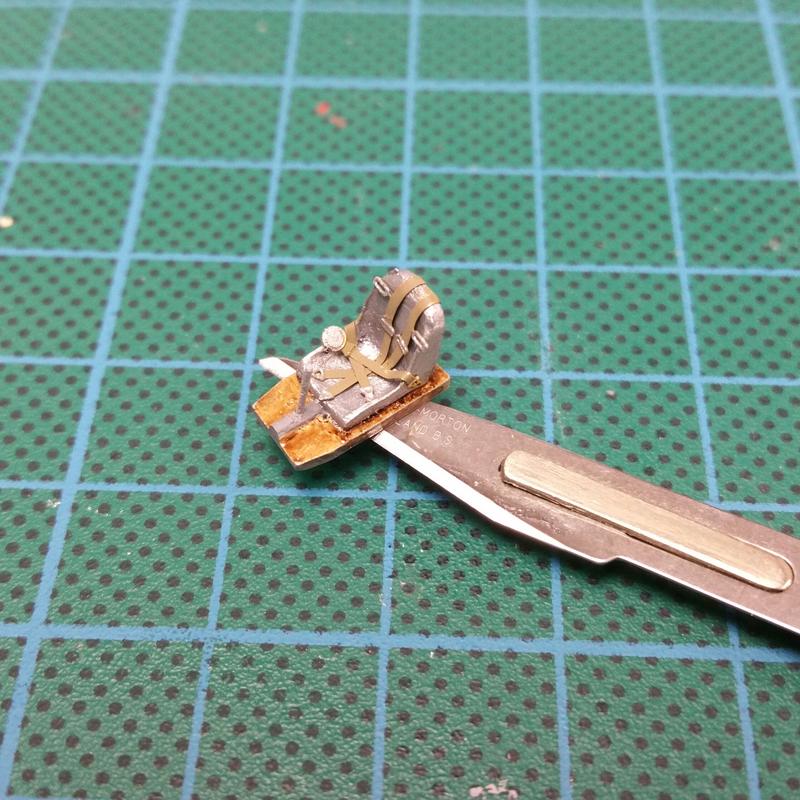

Courageous Posted December 3, 2019 Author Share Posted December 3, 2019 Well here I am, thought I'd better get my butt in gear with this, this....thing. Not very much here. The floor and seat are moulded as one piece and so just need to be painted. The floor was wood I believe, so had a coat of Vallejo Iragi Sand as a base and then had a thin layer of burnt Umber oil paint. Seat was painted Aluminium. The kit PE belts were painted Khaki with silver metalwork. Control stick is a short length of aluminium tubing. The floor/seat part was CA'd into the fuselage half and the halves were CA'd together and now being restrained by a number gutsy clamps. It will not beat me...I hope. Stuart 7 Link to comment Share on other sites More sharing options...

Courageous Posted December 4, 2019 Author Share Posted December 4, 2019 9 hours ago, Johnson said: I swore off resin As I have indicated earlier, this is the worst kit ever that I've worked on but short of scratch building one, I believe their is no other option, so you've just got to get stuck in if you want one. 8 hours ago, 72modeler said: doesn't look like a Sabre You're right but you need little demons like this to sharpen your skills don't you? I'm hoping that in the end, I will prevail and produce something worth looking at. Clamps off a little later and we'll see how much work has got to be done on the seem and stuff, a lot I should imagine. Thanks guys. Stuart 1 Link to comment Share on other sites More sharing options...
