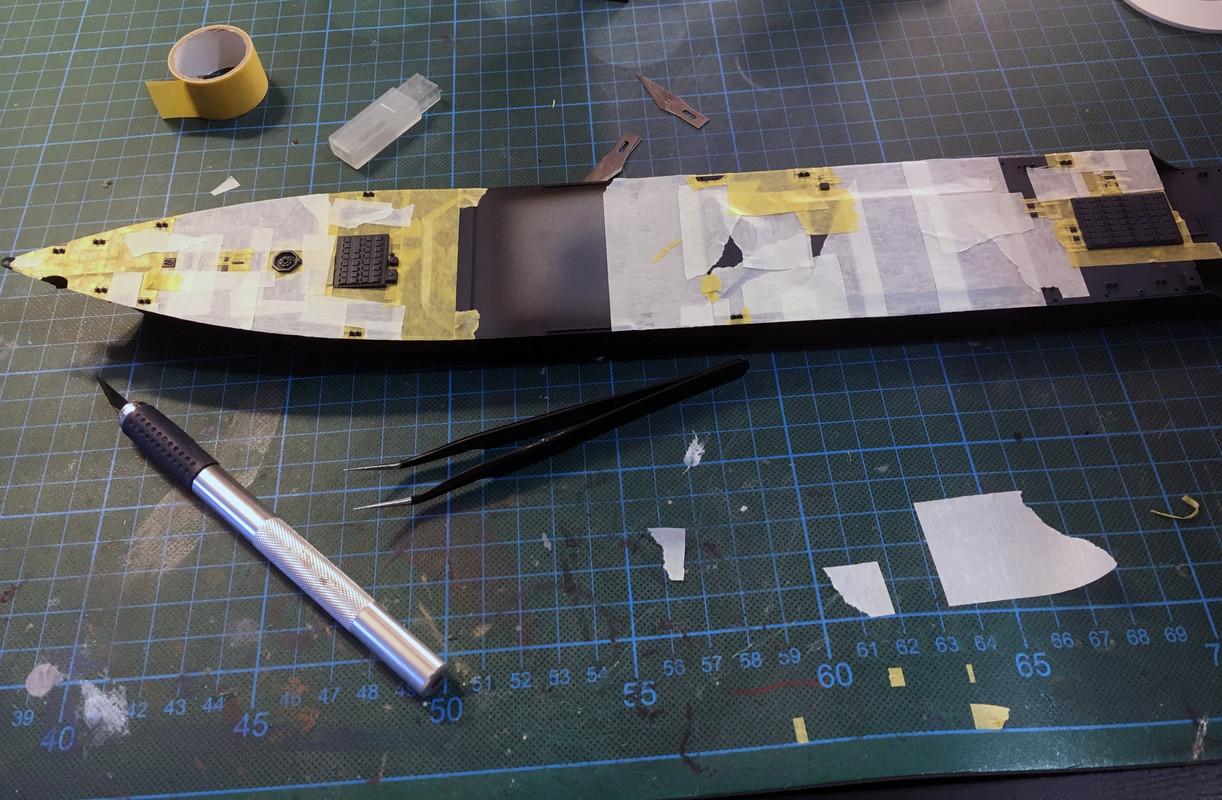

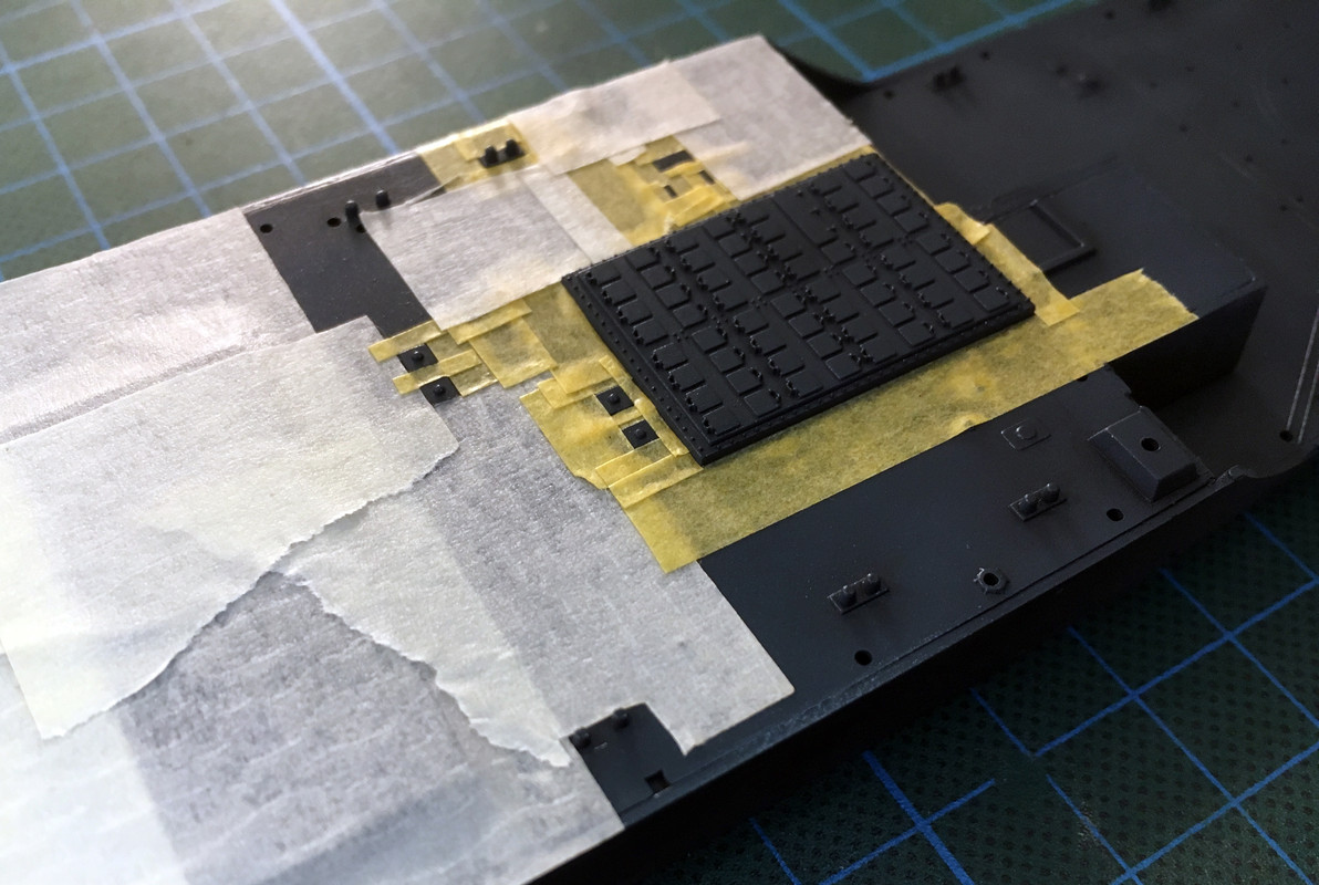

I made a start on masking the decks. To keep my sanity I only do a few hours a time
here's the result of yesterday's two sessions:
And what I did today:
I think I'll spare you the rest of the masking... next update when I start painting the hull colors...
