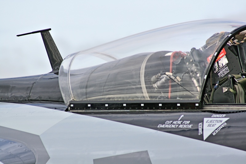

Flankerman Posted July 27, 2019 Share Posted July 27, 2019 This topic has cropped up on various discussion groups - so I deliberately sought out the Hunter at the recent RIAT 2019 show and took this photo..... It shows cleary that there is no metal frame at the rear of the sliding canopy. I spoke to the pilot - and he confirmed that, as the canopy slides forward, the thin black-and-tan arch at the rear of the canopy slides over the buff-coloured hoop at the front end of the spine (note the dip in the spine) - which then inflates to form a seal between the spine and the canopy rear end. Hope this helps all you Hunter builders... Ken 1 Link to comment Share on other sites More sharing options...
Max Headroom Posted July 28, 2019 Share Posted July 28, 2019 Thanks @Flankerman. On mine there was a distinct groove between the bulkhead and the front of the spine. I thought it was either me inserting the pit incorrectly or else bad engineering, so I applied filler and smoothed it out! Ah well, I’ll just paint a buff strip in its place..... Trevor Link to comment Share on other sites More sharing options...

Graham T Posted July 28, 2019 Author Share Posted July 28, 2019 23 hours ago, albamac said: Hi Graham, A lovely model of a 19 Squadron airyplane. Top marks for the finish but just a teeny, weeny criticism. The rear of the canopy appears to have been painted or has a seal. I served on a Hunter Squadron overseas and can't remember any of our aircraft having that as it was generally clear. That doesn't detract from an otherwise excellent model of a classic aircraft. Keep up the excellent work. Best wishes. Regards Albamac Yes you're right. I realise there was no actual frame but an inflatable seal which I erroneously though was on the canopy but as pointed out below was actually on the spine. I'll have to get rid of it. Airfix have correctly provided the canopy with a line just like the real thing which I THINK represented a slightly thicker area of the canopy? Link to comment Share on other sites More sharing options...
