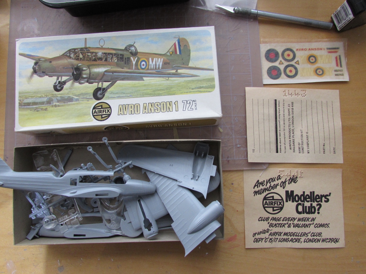

fjaweijfopi4j48 Posted July 25, 2019 Posted July 25, 2019 Well, work on the second Anson started, and this time the goal is to reproduce a machine used by the London School of Flying, G-AMDA. The previous experience with the recently posted Anson should be of help, and an opportunity to improve a thing or two that I missed on that one. G-AMDA also flew in other guises (Derby Aviation), equally attractive, but the elegant two-tone blue scheme of this one definitely appealed to me. This airframe needs a few things modified: new clear nose, cowls, landing gear, the addition of a football antenna loop fairing, and other minor details. An old release: With documentation! I acquired a set of Eduard masks and a Flightpath photoetched set. You can see that I have made already the new cowls and gotten new engines: 7

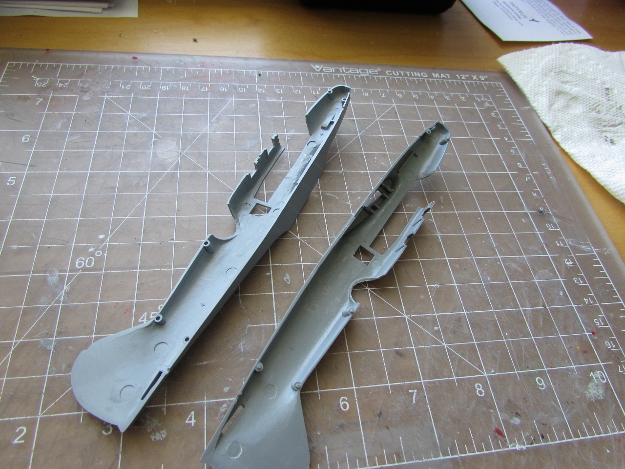

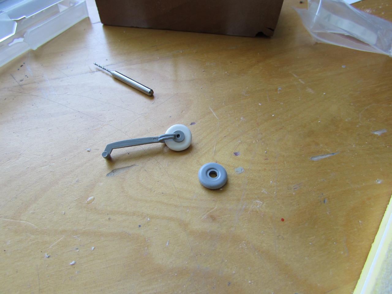

fjaweijfopi4j48 Posted July 25, 2019 Author Posted July 25, 2019 The rib detail is erased, since there were panels on the surface: As many times happens with old kits, there are missing parts, a wheel in this case, so one had to be fabricated: 9

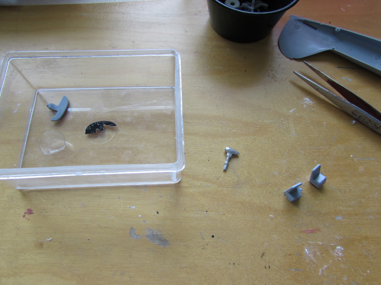

fjaweijfopi4j48 Posted July 25, 2019 Author Posted July 25, 2019 The turret detail inside the fuselage has been deleted: The other internal details, partitions and locators, were eliminated too: Although a new landing gear is needed, I am dealing anyway with the ejector pin marks on the legs, just in case I may need them at some point in my life: 8

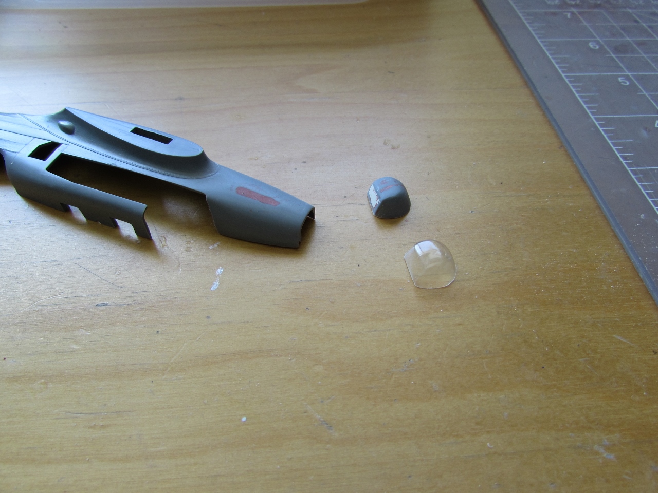

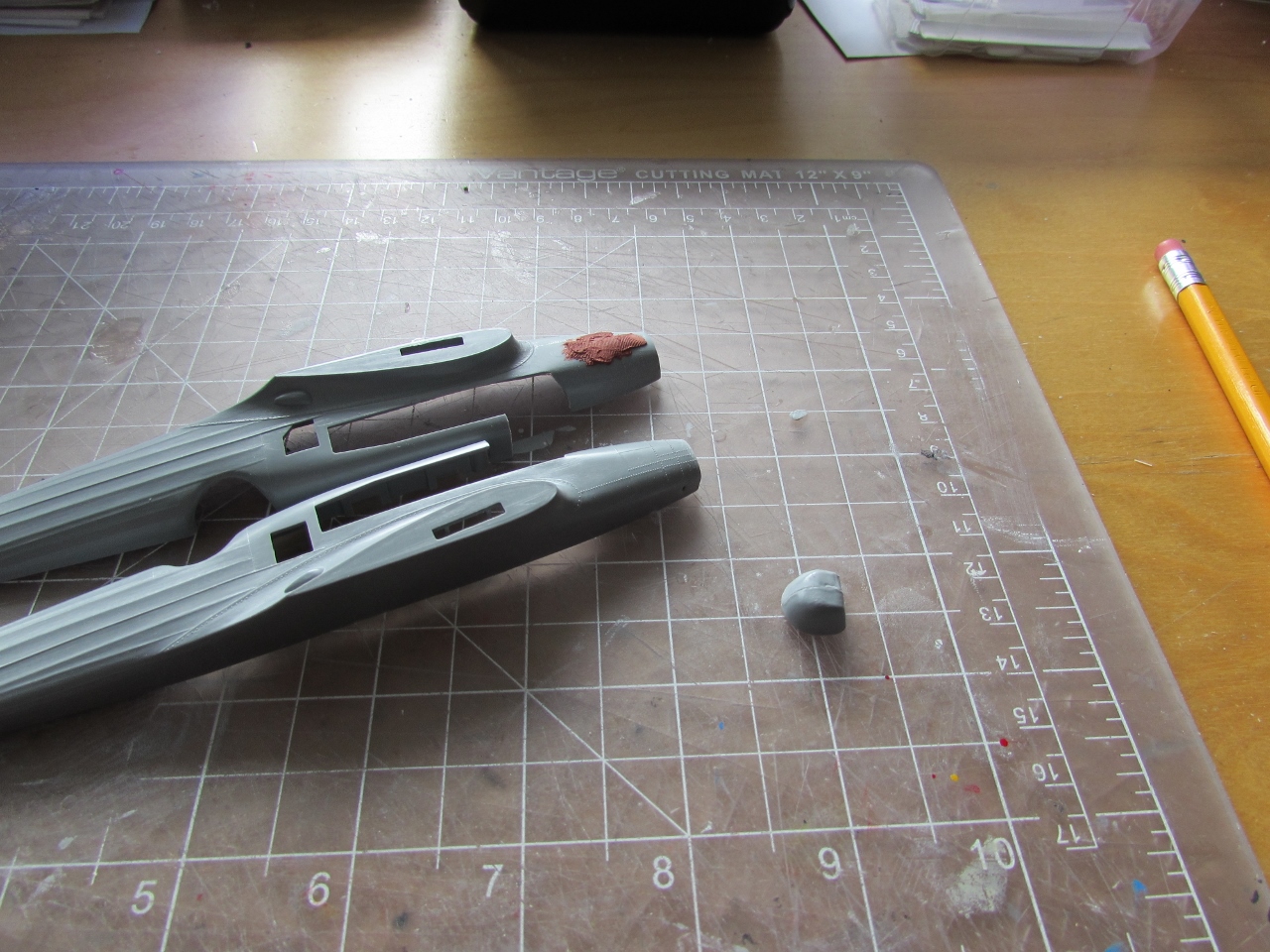

fjaweijfopi4j48 Posted July 26, 2019 Author Posted July 26, 2019 The nose tip is separated: This detail has to go: A clear part is vacuformed with the plug to match photos of this airframe: 10

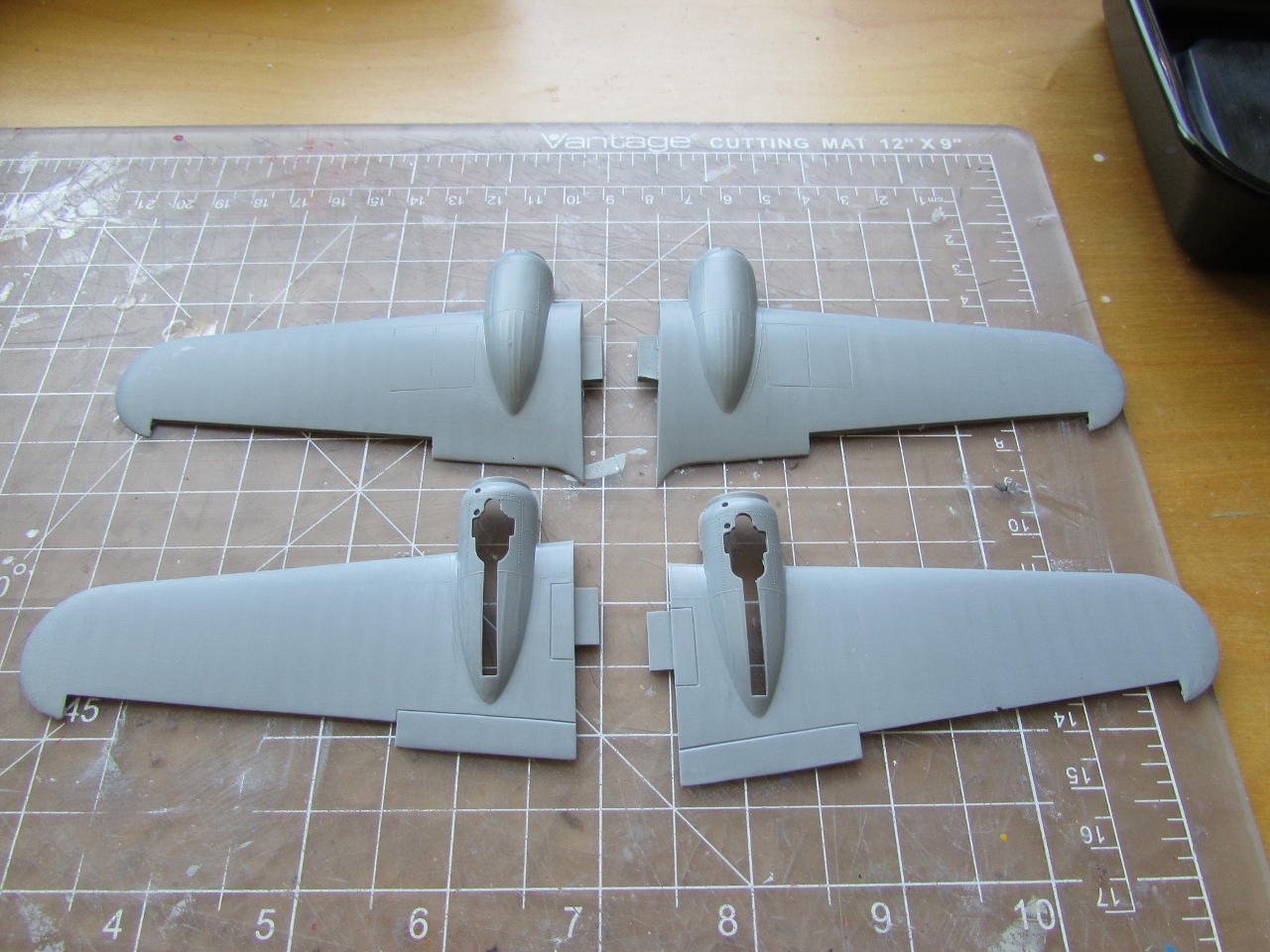

fjaweijfopi4j48 Posted July 27, 2019 Author Posted July 27, 2019 The window frame is a good fit to the kit. It requires that you fill the gap in the fuselage with rigid clear material, which I have. I will pass, maybe, on redoing the kit's front transparency area, since (my subjective perception) it seems to create more problems than those it solves, with high risk of messing up. So I will only partially be using the provided frames, which, by the way, like any other part in this set are superb, if a tinsy bitsy thin and flimsy for my level of photo-etched handling dexterity, this is good for appearance (more realistic) but makes me frown too much as I handle them (says my wife). The comment is valid only for the window frames, the rest of the parts, being smaller, work perfectly at that thickness).: The task of removing and re-sizing ailerons and flaps is under way: As you can see I used part of the removed flaps to extend the areas on top that goes immediately above the flap. I will do the flaps with sheet styrene, if simpler no doubt, better for my purposes and with the correct length: 7
fjaweijfopi4j48 Posted July 27, 2019 Author Posted July 27, 2019 Wings halves glued: Just for the giggles, fuselages of Anson and Short Satellite compared: 8

Courageous Posted July 28, 2019 Posted July 28, 2019 Flying along here Moa, great work as usual. On 7/26/2019 at 8:56 PM, Moa said: A clear part is vacuformed with the plug to match photos of this airframe: Can i ask, what thickness clear did you use? Stuart 1
Brandy Posted July 28, 2019 Posted July 28, 2019 This looks like another Moa special in the making. I'm looking forward to seeing you work your magic on it. You just can't beat a thread where an old inaccurate kit is given a major update and left with a smile on its face! Ian 2 1
fjaweijfopi4j48 Posted July 28, 2019 Author Posted July 28, 2019 2 hours ago, Courageous said: Can i ask, what thickness clear did you use? Stuart Hi Stuart I have been using my Mattel Psychedelic Machine for many years. I bought it with its original supply of styrene sheets, which soon run out at the pace I build and scratchbuild. I managed to find a vendor (Mike Damen) that made a similar product that I used for a time to good results, but he went out of business later on. I still have the color sheets, but had none of the clear ones. I tried all the suppliers of alternate sheets you see online and none worked well. Some didn't work at all. Finally I gnashed my teeth and bought an original Mattel clear package of 16 sheets for an unfairly high price on ebil bay (my son did, actually, since I don't do ebil bay or fakebook). These were produced by Mattel in the 60s in Hawthorne, California a 30-minute drive down the hill from where I live. So I am using original thickness as provided by the manufacturer, which, to answer to your question, is not stated in the package, nor is it known to me. My guess would .015 of an inch, as these troglodytes here count. 4 1

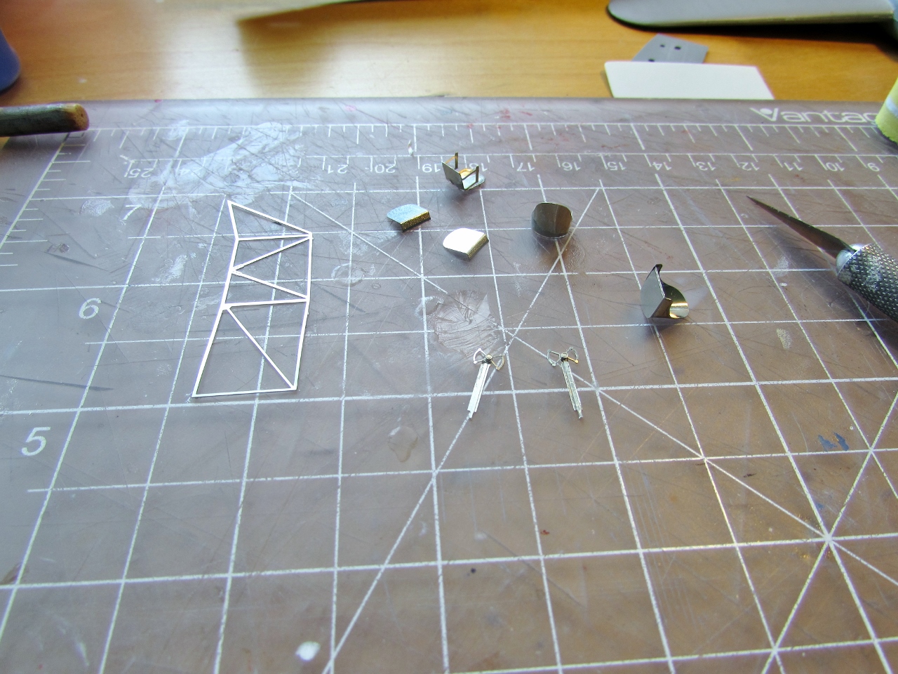

fjaweijfopi4j48 Posted July 28, 2019 Author Posted July 28, 2019 Work starts on some of the photoetched parts: 5
rob Lyttle Posted July 28, 2019 Posted July 28, 2019 Good luck with this lot! Do you solder these things, or CA glue them? 1
fjaweijfopi4j48 Posted July 28, 2019 Author Posted July 28, 2019 I found a suitable Aeroclub football antenna. Thanks to @John Aero for having made those available at the time!Those accessories keep rescuing my builds: The position of the seats, control columns and inst. panel is inaccurate in the kit, but I will used the platform provided. A cabin floor was cut from styrene sheet: 5
fjaweijfopi4j48 Posted July 28, 2019 Author Posted July 28, 2019 1 hour ago, rob Lyttle said: Do you solder these things, or CA glue them? Just CA glue. There are three (ahem, may be a lot more...) shortcomings I suffer as a modeler: I don't do resin molds/copies, I don't solder, and I don't have/don't know how to use a lathe. All those would have been extremely useful many, many times. I have done very occasionally the first two. It's a pain in the exhaust pipe. Cheers 3
