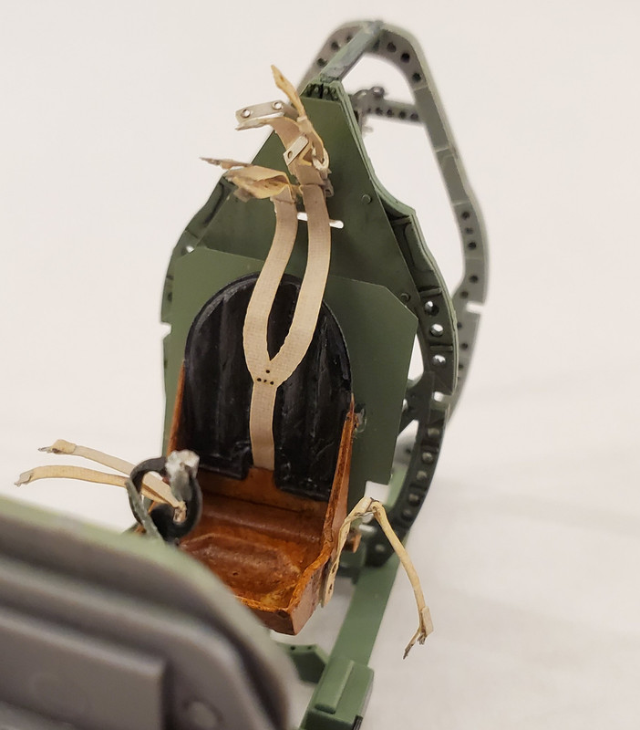

I deviated from the instructions and added the sidewalls to the fuselage halves so that I could add some wiring.  I just noticed on the second picture that I'm missing a couple of bits that still need to be glued down on the starboard side.  These upclose photos also unfortunately are demonstrating my sloppy painting.  I usually brush paint Model Master Acryl semi gloss black for these parts, but have been unable to get it appropriately thinned - it either runs everywhere or goes on too thick, as below.  I'm expecting a bottle of UMP universal thinner, which I'm going to try on it before switching brands entirely, but does anyone else have a favored paint for this?  I prefer not to try to mask and spray all these little parts, so brush painting is a must.
Control column and rudder pedals.  There is a trick of the light, here, the starboard  pedal has not suffered from green overspray.  I added straps to the rudder pedals from Tamiya tape.

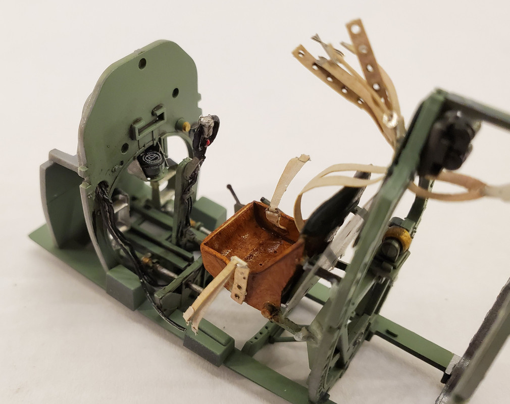

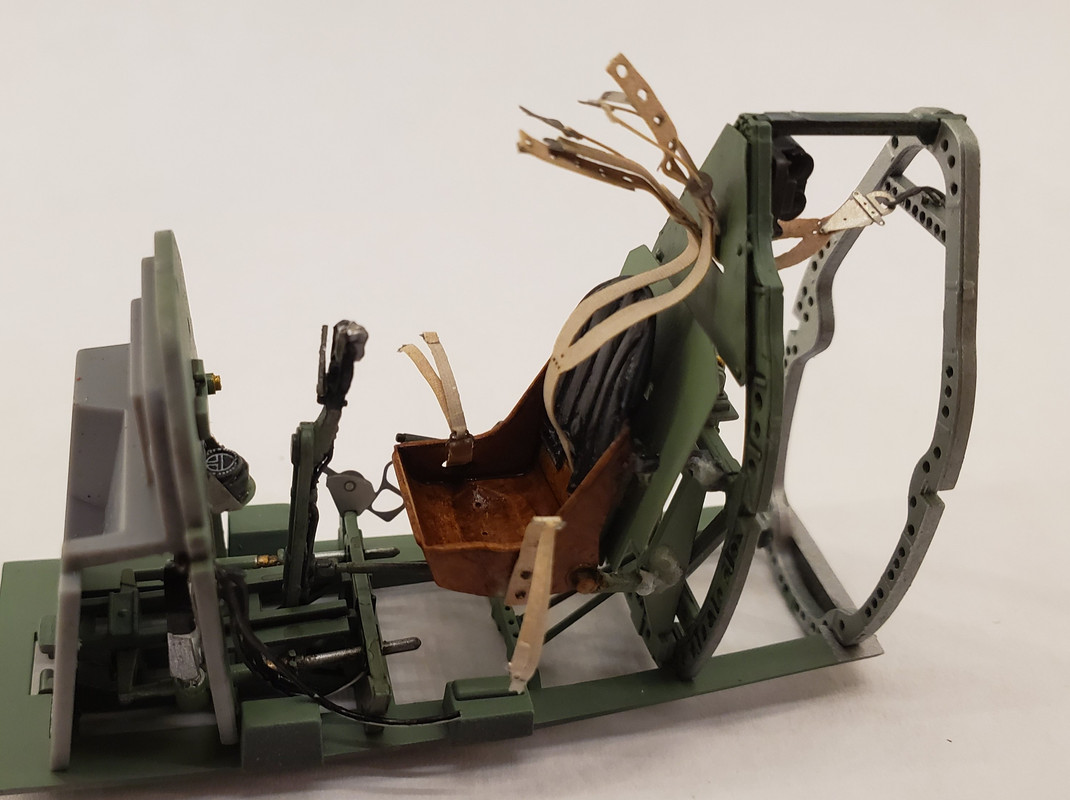

Got some washes on, placard decals from the Barracuda set, a little touch up painting, and a final dull coat. My Yahu IP is on backorder, so this is as far as we go on the cockpit for now. Mar on the starboard sidewall is where I had the oxygen hose attached, but realized with test fitting that it needs to go on after attached to that fuselage side.
20190708-072657.jpg[/url] 20190708-072717.jpg 20190708-072729.jpg 20190708-072735.jpg 20190708-072745.jpg
