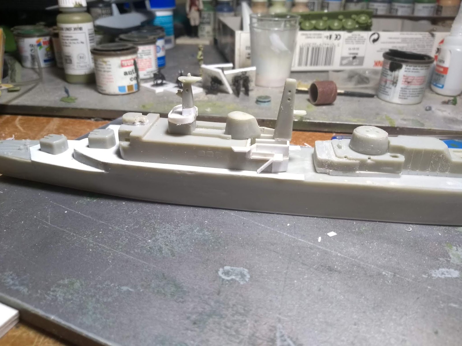

Duilio Posted June 1, 2019 Posted June 1, 2019 Out of sheer nostalgic memories and the challenge of an old kit I took the plunge for an accurate small model of Hms Devonshire Sadly no plans for this particular ship although still not feasible paying for large scale plan Lot of photos of the class but they have to be of the actual ship The actual model is far too inaccurate main issues forward superstructure short and far too back main mast on wrong structure Aft deck too short 6

Chewbacca Posted June 2, 2019 Posted June 2, 2019 Likewise, having built one of these about 5 years ago and converted it to a Batch 2 (GLAMORGAN), I know about most of the inaccuracy issues and at least you have spotted them before you started. I missed the forward superstructure position until it was way too late. Interestingly I'd never noticed that on DEVONSHIRE and LONDON the mainmast was on the forward superstructure. I wonder why they moved it for the later ships? 2

czechnavy Posted June 2, 2019 Posted June 2, 2019 There is a very useful article on improving the Airfix 1/600th HMS Devonshire at: http://www.modellmarine.de/index.php?option=com_content&view=article&id=992:baubericht-hms-glamorgan-teil-1-recherche-und-rumpf&catid=210:hms-glamorgan It includes some simple plans showing how the main superstructure needs moving.
Duilio Posted June 2, 2019 Author Posted June 2, 2019 Thanks Yes a very good article. Actually it triggered me on until I realised that the Glamorgan and most of the ships of this class are different. One has to appreciate the amount of work these guys go through to share such research for the benefit of fellow modellers. A recommended site. I found a good source of photos on county class destroyers site especially on hms Hampshire but then again different from the Devonshire I have yet to calculate the space between the front funnel and the radar mast. Thanks for the feedback and hope this article will be useful and inspirational to all davidgrech.blogspot.com 1

Chris Hewitt Posted June 2, 2019 Posted June 2, 2019 I built one 2 yrs ,yes how Airfix got it so wrong,even to the point they called their model HMS Devonshire should have been Kent,because as you mention the rear mast, is in the wrong position for Devonshire.Again they got the position of B turret to the forward structure,the gap is too big.I didn't change the aft deck left as it was, too far forward on the build to change that.That German site ,is a must to check, I found it after starting the build. I also bought the 3D parts from Shapeways.Have bought you the 1/600 etching set from Atlantic models http://www.modellmarine.de/index.php?option=com_alphacontent§ion=11&category=210&Itemid=59 My build ,hope you don't mind showing. 6
Duilio Posted June 2, 2019 Author Posted June 2, 2019 I have followed your built too and it also a guided to the many flaws of the airfix model. You did a great research with the comparative profiles and your finished model is a result of great determination. Well done. 1
