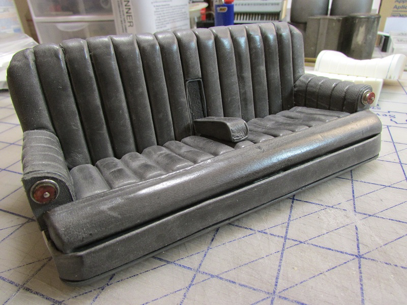

PROPELLER Posted March 2, 2020 Author Share Posted March 2, 2020 Thanks gents! Before doors installing, I have to do seats. Some leather is needed: How to, my way... With a mill is easier, but you can do the same thing with wooden slats! Then, CA glue and God help you! Note the large thickness of the leather, and it works, not easily... Next, rear side of course... Dan. 5 Link to comment Share on other sites More sharing options...
JeroenS Posted March 2, 2020 Share Posted March 2, 2020 A method to remember. Looks quite comfy too Link to comment Share on other sites More sharing options...
Codger Posted March 2, 2020 Share Posted March 2, 2020 Dan, your range of skills is vast- now leather. I had best results with thickness by skiving (shaving the back) down to about .005" thick. Makes it very pliable. 1 Link to comment Share on other sites More sharing options...
PROPELLER Posted March 2, 2020 Author Share Posted March 2, 2020 I agree Codger! My result seems really poor behind yours... Dan. Link to comment Share on other sites More sharing options...
Codger Posted March 2, 2020 Share Posted March 2, 2020 15 minutes ago, PROPELLER said: I agree Codger! My result seems really poor behind yours... Dan. Not at all Dan. It looks perfect for the type vehicle and time period. Link to comment Share on other sites More sharing options...
PROPELLER Posted March 2, 2020 Author Share Posted March 2, 2020 I agree again... It's not a luxury car. But your seat is really superb and to beyond my abilities! Congrats sir. Dan. 1 Link to comment Share on other sites More sharing options...
