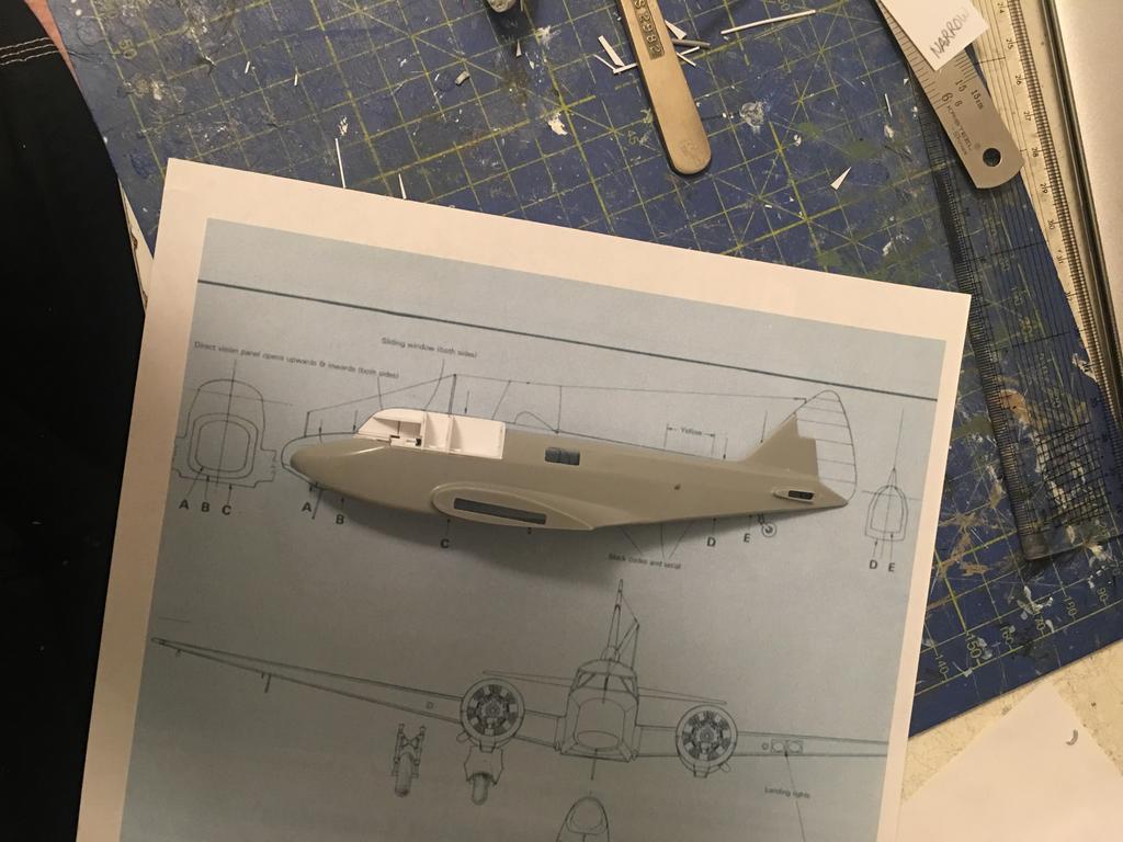

The biggest problem with this is the canopy, which is nothing like an Oxford. The problem is caused partly by the upper fuselage, which should be much more arched. So I need a fix for that:

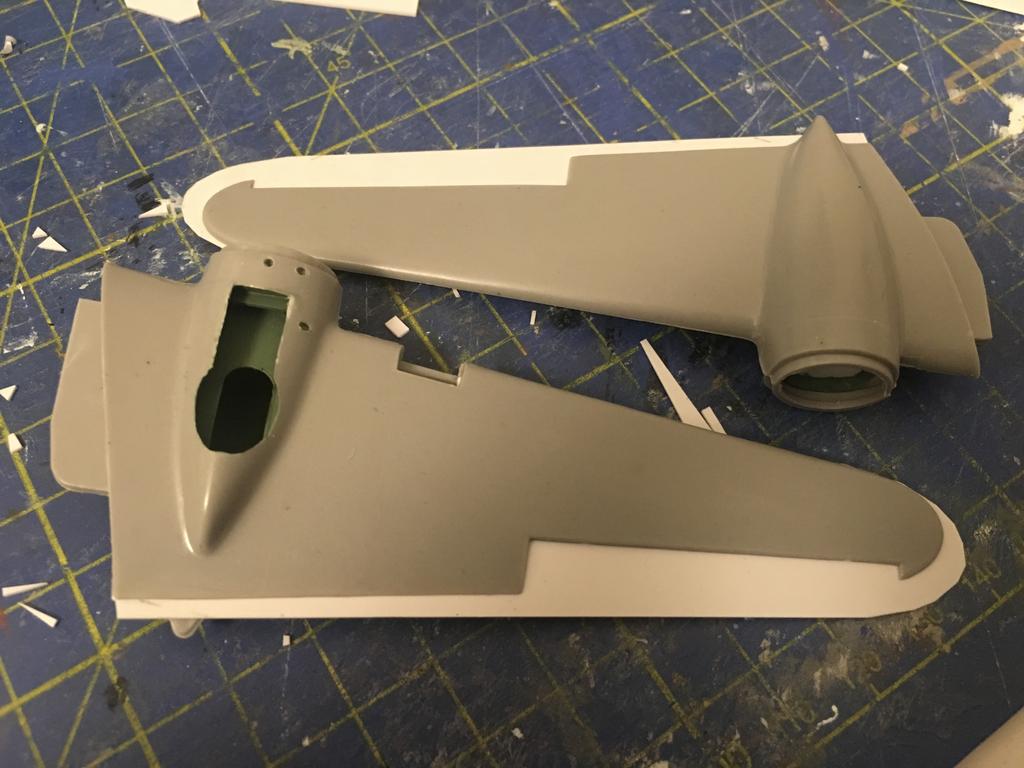

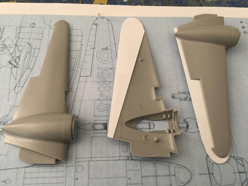

Also, the propellers are too small (and one of mine is broken) and the wing chord is too narrow. I’m hoping to scavenge or make some new propellers, and I will be inserting some 10 thou card to get the wing to a better chord.

I did some research today and found some plans that were posted here on Britmodeller.
Ive built a new canopy master that matches the higher roof profile and has the more streamlined and curved appearance of the real thing:
E20-D9-A26-2-A15-44-DB-8828-E48-ED954863
The nose is a bit small (Envoy-like indeed, which makes me wonder if a militarised Envoy got into their references) so I’ve made a new windscreen sill as a prelude to Milliputting.

Oh, and the wings:
41-D40-ED4-E4-F0-4669-A1-A0-1-B79-D1-D02

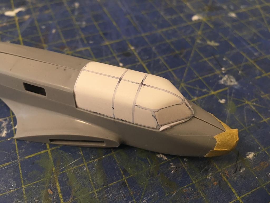

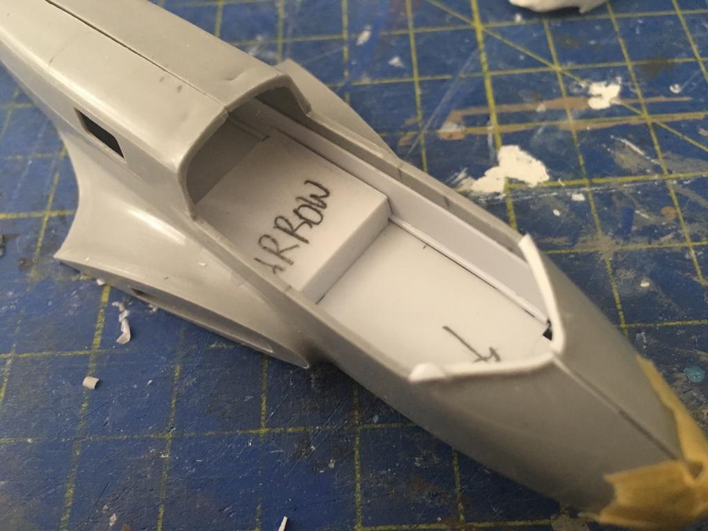

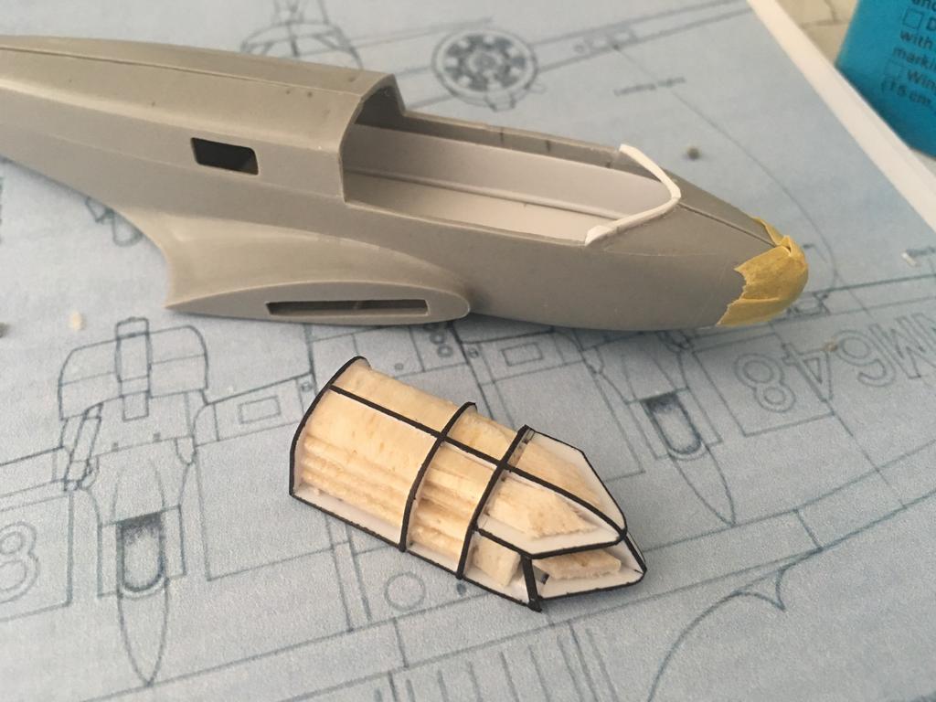

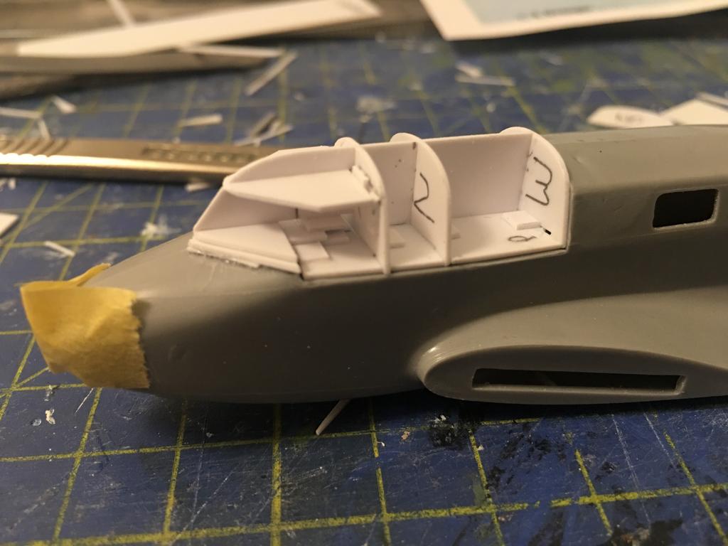

Cockpit floored and lined, canopy blank filled with balsa and outlined with a sharpie prior to Milliput:
3584-F5-E8-F839-4-CE9-BD01-421-AAA619-F3
Thanks for looking,
Adrian
  • Like 8

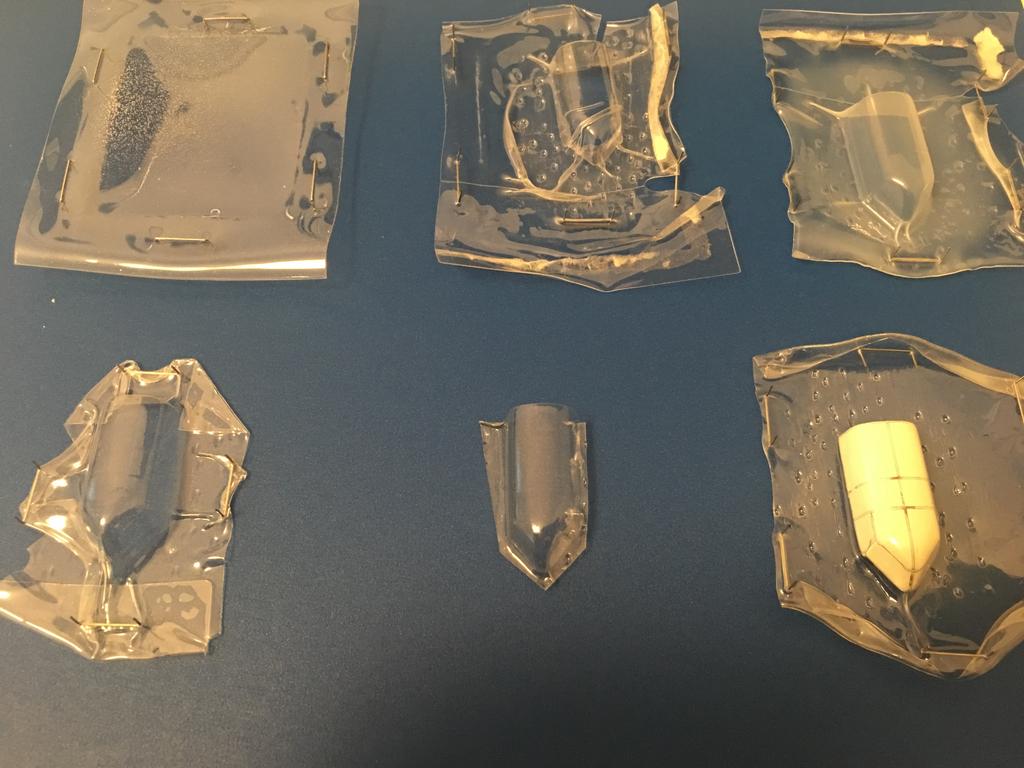

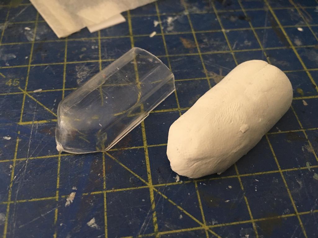

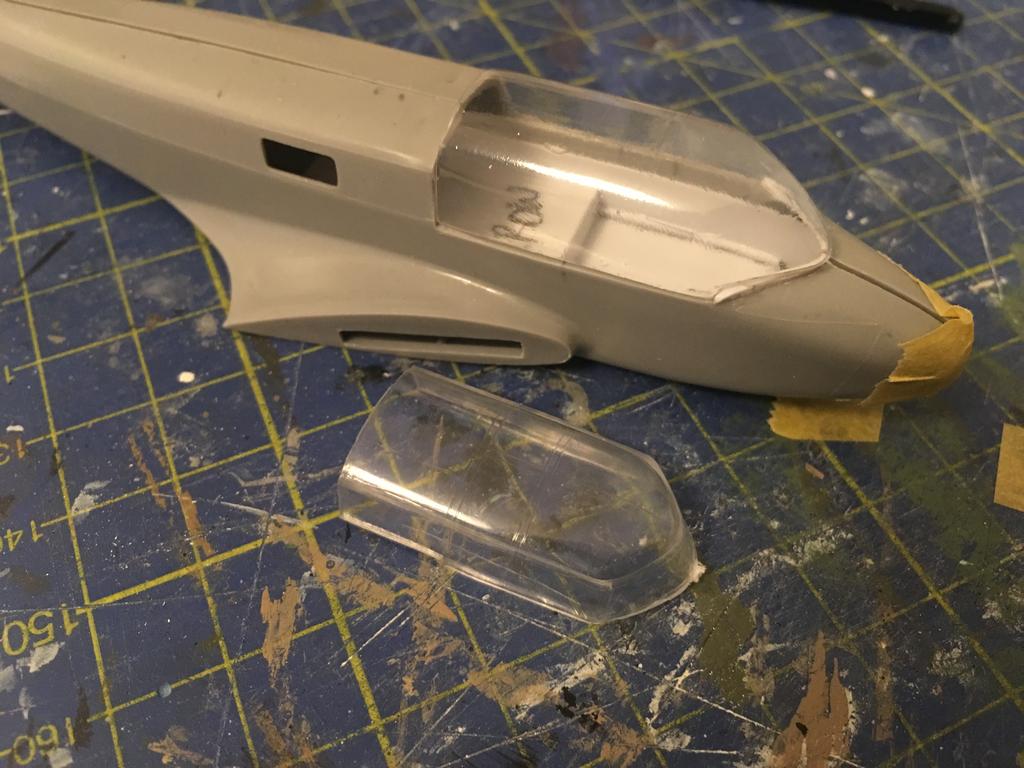

So I had a go with the hi-tech vacform equipment :)
Top row, l-r:
* went all bubbly just as it went soft
* too bulgy, folded over
* went white
Bottom row, l-r:
* didn’t hunker down on the right hand side
* pretty good
* perfect! (I hope)
B3199-A84-E4-A7-4-D96-98-E2-10-A22-B2-F8

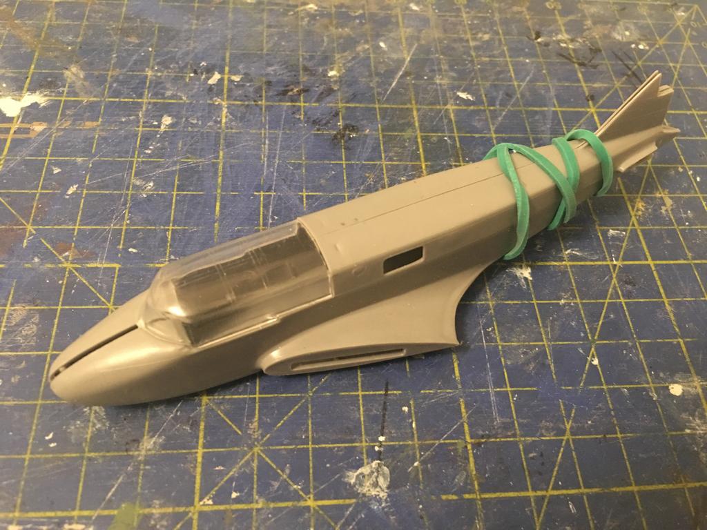

And here is the good one test fitted:
05-B09352-643-C-4112-B25-C-0-E42-D669-F3
It should blend in pretty well if I put a strip for it to sit on. What you can’t see from the photo is that it’s 2-3mm higher than the existing roof line.
Thanks for looking,
Adrian
  • Like 18

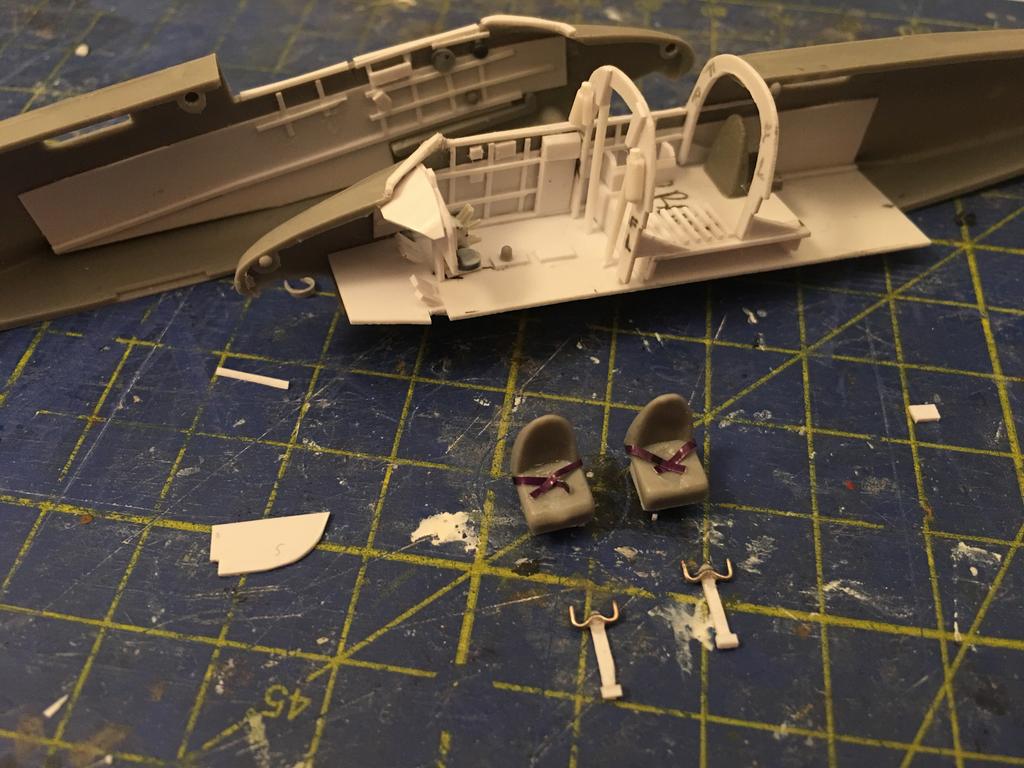

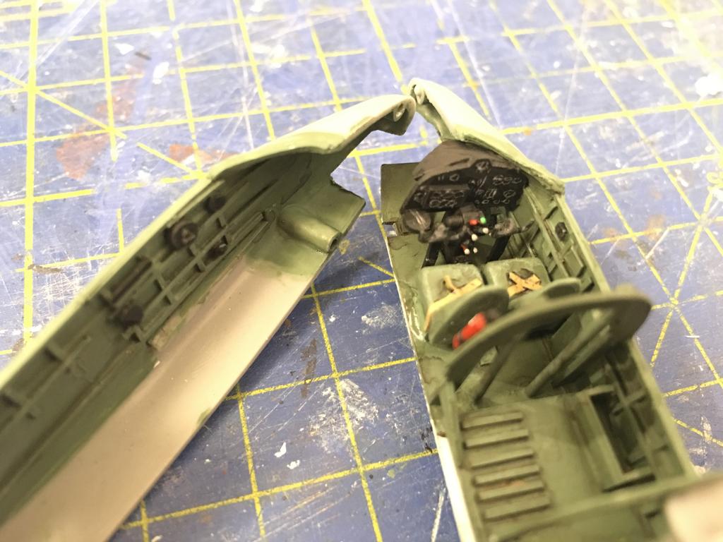

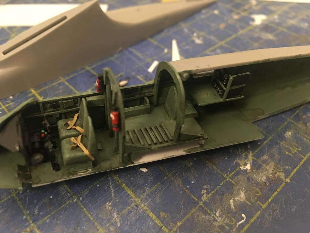

Cockpit time:
D7929-B07-EA0-C-4-B28-BA67-944-EFC06-D88
I am using the Frog seats because early Oxfords at least seemed to have the rounded seats with just lap belts. I will put something big black and boxy next to the back window to represent the radio but otherwise I’m done inside.
Thanks for looking,
Adrian
  • Like 15
My lord Adrian, you certainly know you way with plastic strip and card. That cockpit looks amazing!!
Who needs AM resin and PE when you can build all that from scratch?
Cheers.. Dave
  • Thanks 1
  • 100% 1
Comprehensive work in there Adrian :goodjob:
  • Thanks 1
31 minutes ago, stevehnz said:
interior work
Thanks all - it’s my favourite bit of modelling.

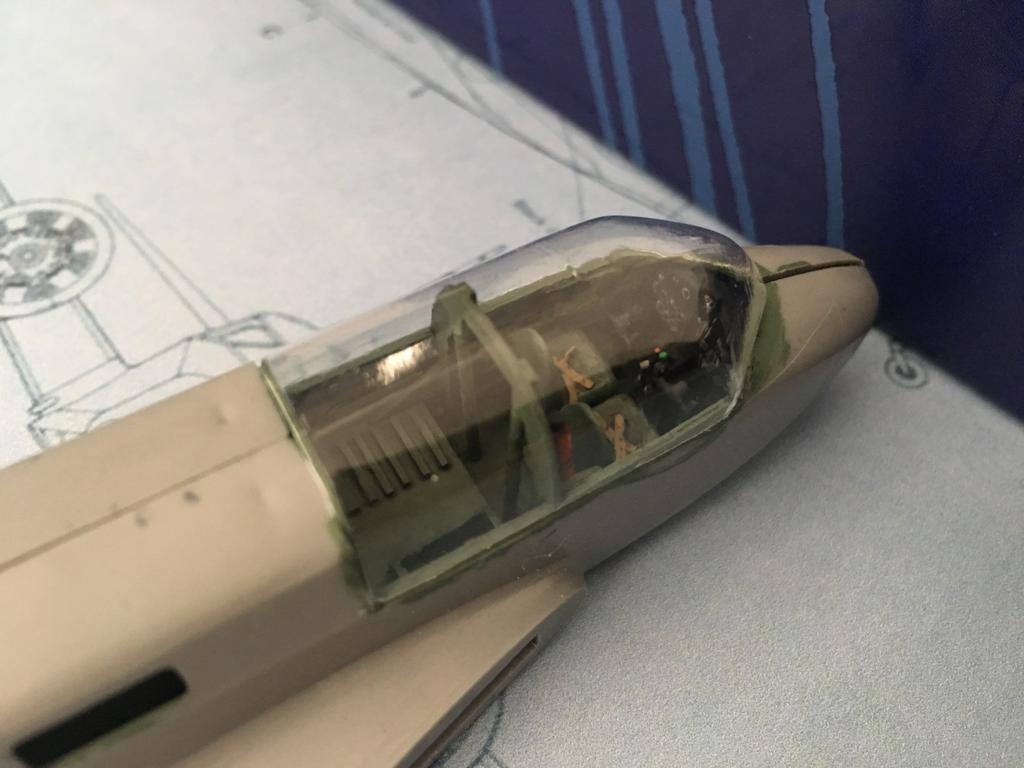

The canopy has been dunked in Future, cleaned off because it went runny, and dunked again, letting it drain off better this time:
6-C96-D23-A-7-ABB-47-E6-AC8-D-978442-C3-

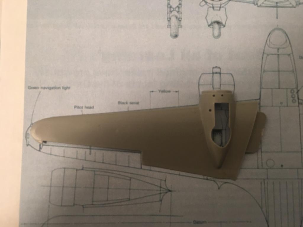

And I’ve started to fix the wings. I intend to scribe the ailerons so I can get the narrower top and wider bottom:
DAF70-AE9-B50-D-4-B14-A96-E-CD15-F95-F05

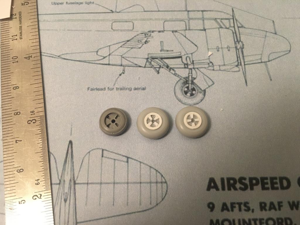

A bit more progress tonight. I made some four spoke wheels to replace the horrible kit ones, starting with the slightly-too-small-for-a-Blenheim wheels from the MPM Blenheim, slices of torpedo tail from the old Airfix Sea King and some plastic card. They will look OK with paint:
8-AC1-AC83-FE54-45-C6-86-F2-1-A5-C03-E05

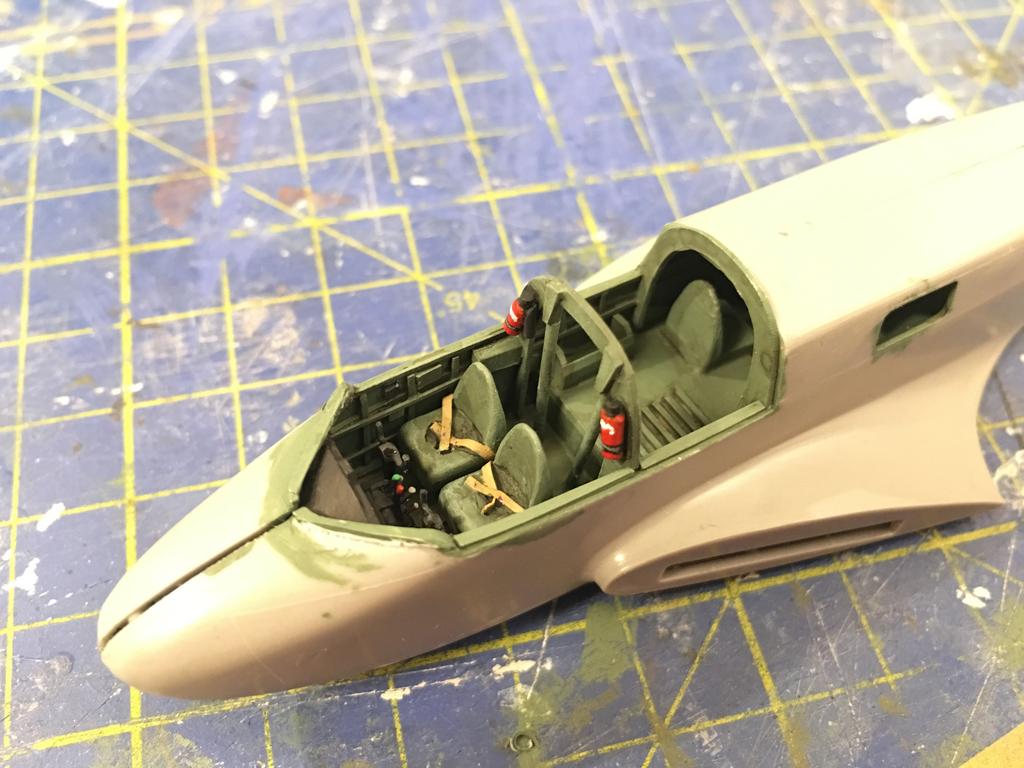

I promised something black and boxy for the radio:
23-EE9-DB6-DF1-A-4057-A3-CE-54-F72353-D7

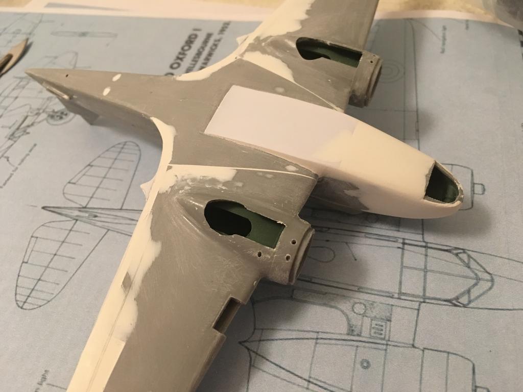

Milliput has been deployed in large quantities:
B22-ED070-3-B3-A-49-C9-897-F-7629-C56-D0
This pack must be over four years old. I have nearly finished it and I’m hoping my next one is a bit softer.
Thanks for looking,
Adrian
  • Like 8

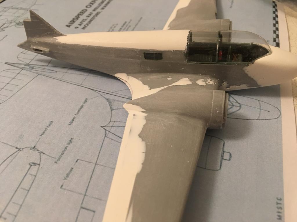

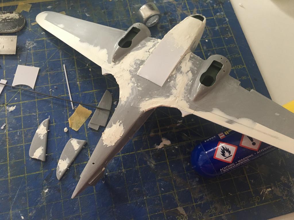

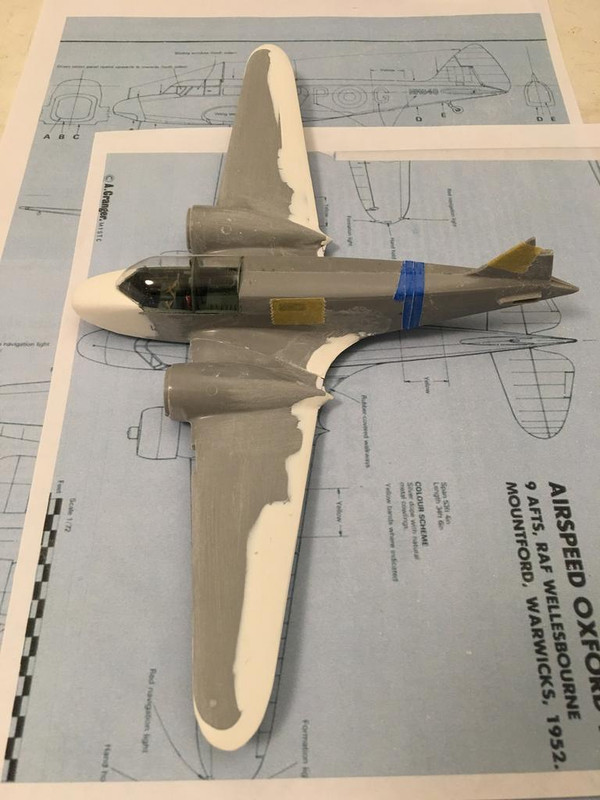

Well that was quite a lot of sanding...
8015-D144-716-D-4-EC4-A340-721-A9776752-
I’m happy with the wings and nose, but there’s still the wing roots and the weird diagonal join to fill, and a distinct rectangular belly section which needs a sheet of card adding (edit: oh, and the raised roof!). Then it can be back to kit assembly. Sadly I’m away for a week starting Saturday, so this is going away for a bit.

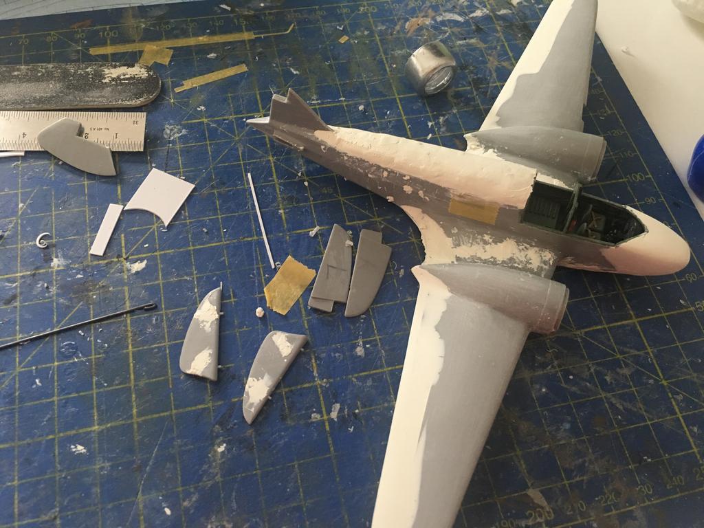

Back again. Out with the Milliput:
61594-E8-F-E338-4131-840-B-6-E5-F415-A2-
A71710-F4-C036-43-F3-A165-092-CA3-D70489
My Milliput is very old (bought at ModelZone waaay before it closed down) and hard. A quick squeeze of a pack bought some four years later resulted in the last half-inch of the current pack heading for the bin. Fingers crossed the old stuff is fine to sand when dried, but it is very difficult to apply and shape ( as you can see!)
Thanks for looking,
Adrian
  • Like 5

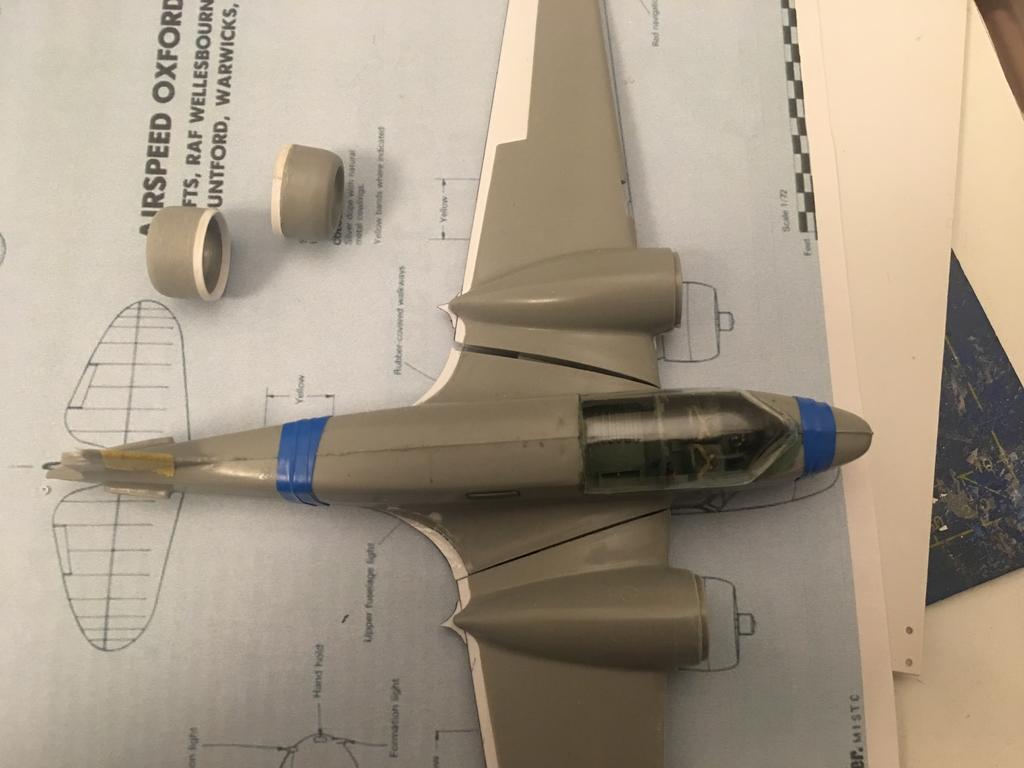

Lots of filing and sanding later...
08613-E6-E-E98-F-44-EA-AE40-1-CBD7667809
E4788-EAE-392-B-4-A1-A-BB9-C-F8-F5546-F9
Scribing and a bit of primer tomorrow.
 Thanks for looking,
Adrian
  • Like 4
