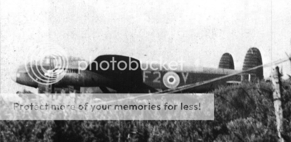

This one..
EDIT Farnborough post war.
The codes are unusually small.

A bit of manipulation in Photoshop reveals the underwing serials in the shot Troy posted.  Not a clear one to begin with and I pretty much ruined the original.  So I saved 'em both in my Lancaster directory, sewing confusion for myself for years to come.

I forgot to mention that Martin Streetley notes the non-standard small codes on F2-V and speculates that, as a Lancaster VI, this airframe may well have had additional window chutes on the lower fuselage sides, where the codes would normally have been painted. Hence the smaller codes.
from the other photos it just looks like  635 sq used smaller codes
compare
lancm6.jpg&key=01c2abf5a9f920f2da7cd72f4
compare, and F2-F as well
Avro_Lancaster_-_L%25C3%25BCbeck_-_Briti
the roundel is 48 inch, so the codes look about 30", maybe 36", the serial is 8" BTW.

Note that even though the F in F2-V is well proportioned, it is larger than the other characters. It's on an angle but even the F in F2-Z appears fractionally larger. You need the eye of faith to see it in F2-F but I wouldn't be surprised. Presumably some 635 quirk or an odd assortment of stencils.

It certainly does:  48 inch codes in 1/72 scale equate to 32 inch in 1/48.  Plenty of 1/72 48 inch code decals out there.
Finding 32inch codes in 1/72 might be more of a problem, although 36 inch are readily available.
Sorted!
