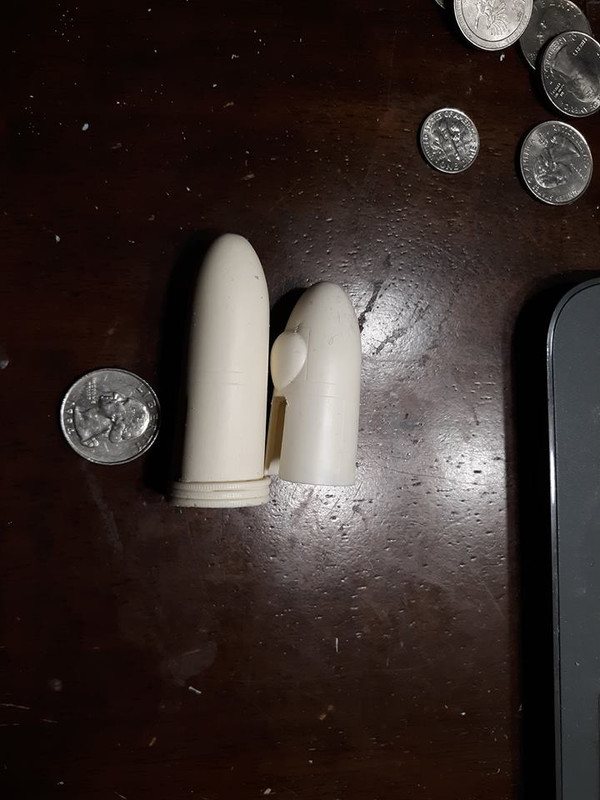

Kevin Martin Posted February 4, 2019 Share Posted February 4, 2019 (edited) Hello all! I have molds for close to 50 parts for all the various Meteor sets I make under the 109ACE brand on Ebay. I had no idea amongst all that rubber, I had all the parts needed to make a NF12 . Kind of like unknowingly going past the finish line and not noticing I won the race. RAF aeronautics is a bit of a black science to this yank. Need a reference wheel to keep track of it all. Thanks for the heads up. You asked for it, I provide it. The NF 12 is now for sale. My sets are easy to find by going to Ebay and searching seller "109ace". A google search of 109ace will also bombard you with pictures of my sets and links to the listings. Edited February 5, 2019 by Kevin Martin 1 Link to comment Share on other sites More sharing options...

Kevin Martin Posted February 23, 2019 Share Posted February 23, 2019 17 hours ago, 71chally said: Thanks for posting here, can you confirm that the NF.14 kit is indeed of the correct length? what is the agreed length it should be? I can say I did NOT employ the theroy that the NF 12 radome was 17 inches longer then the NF11/13. And that an additional 17 inches was added to the NF12 radome to get to an additional 34 inches total added to the NF14 radome over the original starting point of the NF11/13 radome. To make this NF14 radome I used a picture of a NF14 side profile of an actual NF14 and with my printer, adjusted the size to 1/48 scale to lay under the kit fuelage half. If anything, and I hope it so, my radome is longer then needed as I believe in modeling, it's easier to remove material to adjust, then it is to add material. Link to comment Share on other sites More sharing options...
viscount806x Posted February 23, 2019 Share Posted February 23, 2019 Mr Bass Man, I quoted this on the forum a while back and gives a good grounding on your rhetorical question regarding nose lengths. If you can stay with the following pasted text, it will greatly enhance your grounding on the subject. Mind you, your resin looks really good by the way. "Nose lengths of the nightfighter Meteors used to be a minefield until John Adams of Aeroclub got it sorted for us. At the risk of plagiarising his good work and findings, it might be worth repeating again. John did measurements from actual airframes using plumbs dropped onto the hangar floor so they are very reliable. Most sources have the NF.11 and NF.12 correct and most sources have the NF.14 WRONG. And I mean most sources, including many esteemed and worshipped books. Indeed, out of more than 10 books on my shelf specifically on the Meteor, all bar one gets the NF.14 length wrong. The correct one is the Haynes 'Super Profile' by MJ Hardy. Unfortunately he quotes the NF.12 as being the same as the -11/13. You just cannot win it all can you? The NF.11 and NF.13 are both the same, both being versions of the same variant. The NF.12 was longer and was identical in length to the NF.14, contrary to quotes still seen regularly. The apparent differences were due to the later NF.14 windscreen being redesigned in shape and appearing to be further back along the nose than the -12. The shorter 'Deep Breather' nacelles on the -14 compounds this visual anomaly. When the radar became redundant in the NF.TT.14 era, sometimes the metal ring around the rear of the nose dielectric cone also got painted on some a/c, making the nose radome appear longer. All this is detailed in a couple of places by John Adams. One I dug out today is a letter in Scale Aircraft Modelling Vol.26/10. Thanks John. Incidentally, the -14 length at 49ft 11in. is also confirmed in AP 2210AP Vol.1. Lengths: NF.11/13 48ft 6ins. NF.12 49ft 11ins. NF.14 49ft 11ins. It also turns out that later in life, all -14s and some -12s received a tail radar warning receiver, the antenna being in the extreme tail cone which shortened these a/c by 3.5ins. This wouldn't change the nose length though. at some point in prehistory, someone got the quoted length of the -14 wrong and it has been perpetuated ever since. Certainly Shacklady had it wrong. Was he the original sinner? Certainly his book has been the Meteor bible down the decades hasn't it? I hope it is of interest anyway, cheers. Nige " 1 Link to comment Share on other sites More sharing options...
Kevin Martin Posted February 23, 2019 Share Posted February 23, 2019 I will point out that the same radome used in my NF14 is the same used on my NF12 conversion. 1 Link to comment Share on other sites More sharing options...
71chally Posted February 24, 2019 Share Posted February 24, 2019 19 hours ago, viscount806x said: at some point in prehistory, someone got the quoted length of the -14 wrong and it has been perpetuated ever since. Certainly Shacklady had it wrong. Was he the original sinner? Certainly his book has been the Meteor bible down the decades hasn't it? I hope it is of interest anyway, cheers. Nige I guess it depends what source you trust, but Flight, period Observers aircraft books and Glosters' own references always stated the 49' 11" for the NF.12 & 14, thankfully I've always used these - time for new reference material maybe! It is interesting to to work out when the information was corrupted, but various threads on here have prompted me to look at Putnam's the British Fighter, and an Air Britain NF.14 article and both give the erroneous longer length. Link to comment Share on other sites More sharing options...
theplasticsurgeon Posted February 24, 2019 Share Posted February 24, 2019 (edited) I've just measured one of my Matchbox NF-14s, built using nose parts for the 12. 49'11" is 599" long/72 = is 8.319" model length. Measured as accurately as I can to 8 and 5/16" or 8.3125 - spot on! Bin the longer nose parts! Very happy about that, it gives me a warm fuzzy feeling. Edited February 24, 2019 by theplasticsurgeon more info 1 Link to comment Share on other sites More sharing options...
