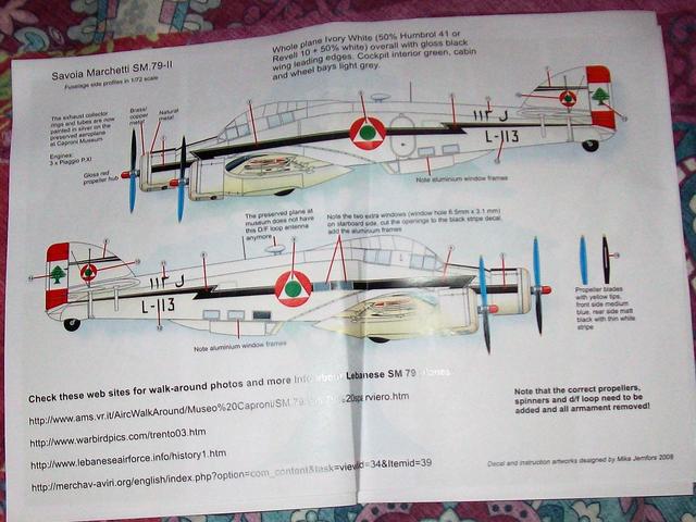

Martian Posted December 31, 2018 Author Posted December 31, 2018 Just a quickie, I am trying to decide whether these Lebanese machines were powered by Piaggio P40 14 cylinder engines or Alfa Romeo 128 nine cylinder motors. The Airfix kit provides the former and I have the Pavla detail set for the latter, I just need to now which ones to use on this build. Martian 👽
neil5208 Posted December 31, 2018 Posted December 31, 2018 13 hours ago, Martian Hale said: I will be working using the old style Airfix "Locate and Cement" style instruction sheet (my favourite) I don' t remember see this kit or instructions like this before, looks like a challenge in itself. 4
clive_t Posted December 31, 2018 Posted December 31, 2018 4 hours ago, Martian Hale said: Just a quickie, I am trying to decide whether these Lebanese machines were powered by Piaggio P40 14 cylinder engines or Alfa Romeo 128 nine cylinder motors. The Airfix kit provides the former and I have the Pavla detail set for the latter, I just need to now which ones to use on this build. Martian 👽 Martian, I don't know for sure but there are a set of 'walkaround' photos at https://www.net-maquettes.com/it/pictures/savoia-marchetti-sm-79-vol2/ Some good detail on show, including some engine full-frontals - maybe they will answer your question? 1 1
TheBaron Posted December 31, 2018 Posted December 31, 2018 Martian, Just to add to Clive's info, there's a list of variants about halfway down the page here: https://www.militaryfactory.com/aircraft/detail.asp?aircraft_id=294 which states: That would make your SM.79-II a: 6 hours ago, Martian Hale said: Piaggio P40 14 or Fiat A.80 according to this. Over here: http://www.airport-data.com/aircraft/MM24499.html L-113 itself is given as having 6 hours ago, Martian Hale said: Alfa Romeo 128 engines, in contradiction. Pretty standard stuff for WWW I'm afraid in both being assertions lacking provenance and sources. Is it possible to judge from this shot of L-113? Source:Wikipedia Commons This isn't one of her engines removed in this shot is it? https://www.airplane-pictures.net/photo/326245/l-113-lebanon-air-force-savoia-marchetti-sm-79-sparviero/ 2

Martian Posted December 31, 2018 Author Posted December 31, 2018 8 hours ago, neil5208 said: I don' t remember see this kit or instructions like this before, looks like a challenge in itself. As I remember, the kit goes together very well and I love these type of instructions, they take me right back to when I was a small Martian. 6 hours ago, clive_t said: Martian, I don't know for sure but there are a set of 'walkaround' photos at https://www.net-maquettes.com/it/pictures/savoia-marchetti-sm-79-vol2/ Some good detail on show, including some engine full-frontals - maybe they will answer your question? Thanks Clive, some good detail there but still unsure about the engines. 5 hours ago, TheBaron said: Martian, Just to add to Clive's info, there's a list of variants about halfway down the page here: https://www.militaryfactory.com/aircraft/detail.asp?aircraft_id=294 which states: That would make your SM.79-II a: or Fiat A.80 according to this. Over here: http://www.airport-data.com/aircraft/MM24499.html L-113 itself is given as having engines, in contradiction. Pretty standard stuff for WWW I'm afraid in both being assertions lacking provenance and sources. Is it possible to judge from this shot of L-113? Source:Wikipedia Commons This isn't one of her engines removed in this shot is it? https://www.airplane-pictures.net/photo/326245/l-113-lebanon-air-force-savoia-marchetti-sm-79-sparviero/ Thanks Tony, I was erring towards nine cylinder radials right up until the last bit of your post. Confusing isn't it? Martian 👽 3

Giorgio N Posted December 31, 2018 Posted December 31, 2018 The Lebanese machines should have been powered by the AR.128 engines used on the Bis variant 2 1

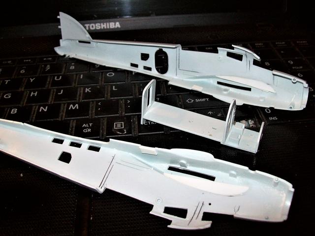

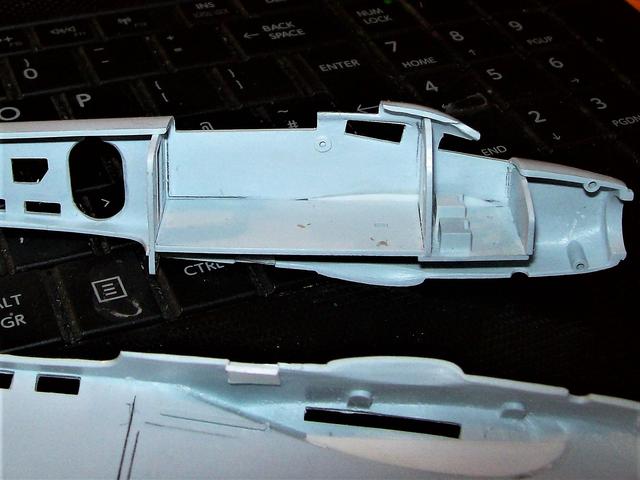

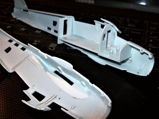

Martian Posted December 31, 2018 Author Posted December 31, 2018 A very enjoyable session was had at the bench today. I began by removing the door separating the forward and rear parts of the fuselage to allow for a see through look. next I cleaned up the floor, instrument panel and bulkheads and glued them together. Attention was then turned to the inside of the fuselage. The upper parts of the recesses of the wing roots were blanked off with plastic card and many of the locating ridges for the interior were removed along with those horrid ejector pin marks that many reviewers these days seem think make a kit if not virtually unbuildable, then an uphill struggle: they took me less than ten minutes to shift. I then thinned down the edges of the dorsal gunner's compartment and tidied up the bottom of the cockpit rear bulkhead where it fouled the new wing root blanking plates. The final job I did today was to re-scribe the raised panel lines on the forward fuselage. I am going to have to be very careful to preserve the raised detail that Airfix have used to represent as it is probably way finer than I can duplicate. Well, I can replicate it and have done so in the past but it takes an awful lot of time to do properly and would rather negate the point of this being a mojo restoring build. Thanks for looking and hopefully some more tomorrow. Martian 👽 21
