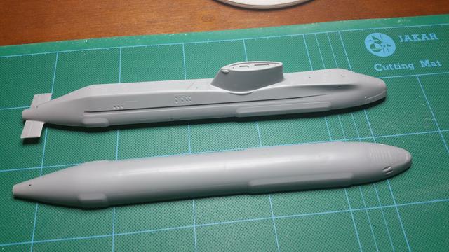

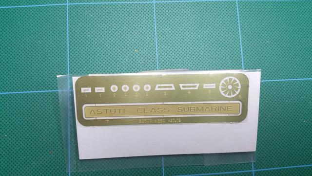

Courageous Posted October 13, 2018 Share Posted October 13, 2018 Next on the building mat, a 1/350 Astuste Class Submarine using the HobbyBoss kit. The Astute Class is the current class of 'Hunter-killer' of the RN, replacing the older Trafalgar Class. Box art Hull halves. The upper hull comes complete the fin and aft planes fitted. Traditionally the fin would have been 2 parts and the after planes 4. Sprue shot that looks like parts for the top of the fin, masts, rudder,propulsion and foreplanes. Some photo-etch. Some 'blurb', instructions and painting call-out. Looks like a simple build but I've never built a HobbyBoss kit, so that might come back to bite me on the 'arras'. Stuart 7 Link to comment Share on other sites More sharing options...

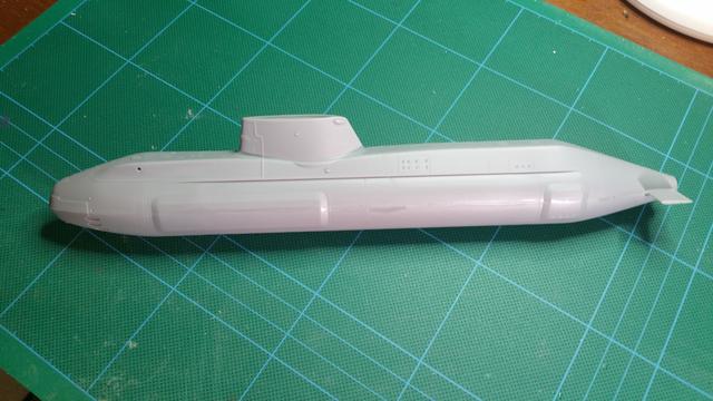

Courageous Posted October 15, 2018 Author Share Posted October 15, 2018 Small update, just to show you that it's moving. Hull halves joined. A scan across the plastic finds a bit of messy plastic at the base of the fin and the odd fine lines of plastic that shouldn't be there, so these were tidied up. A little work is needed along the seem also but the usual PPP and sanding will cure that. Stuart 6 Link to comment Share on other sites More sharing options...

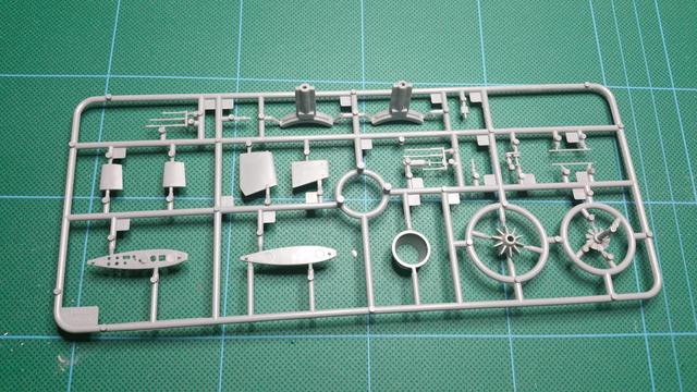

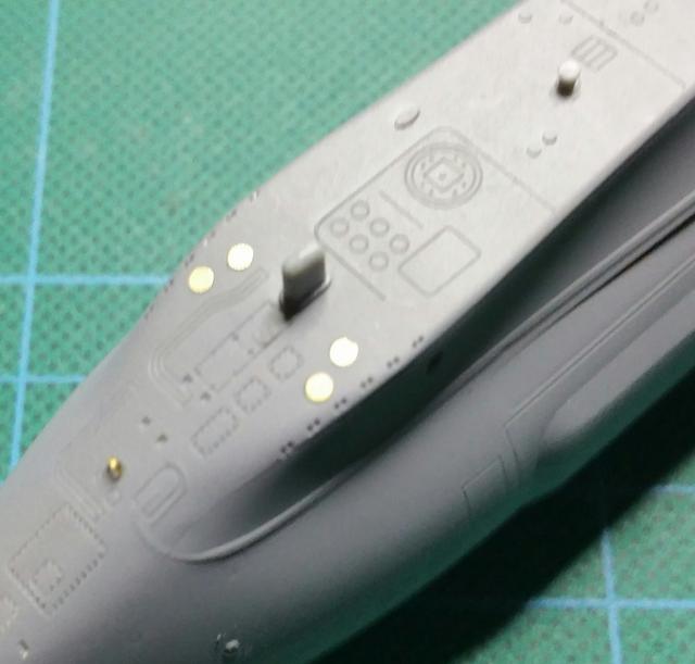

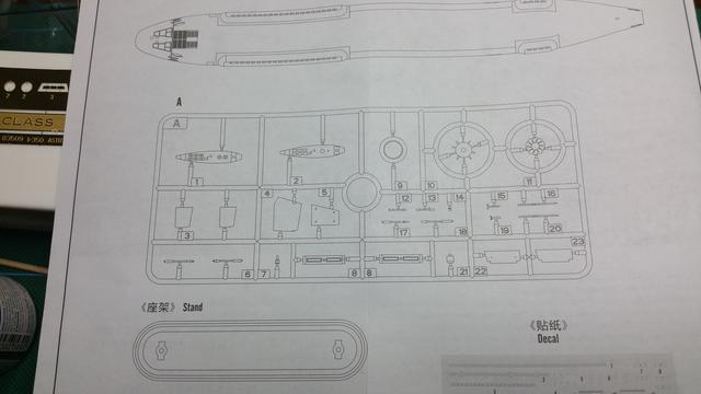

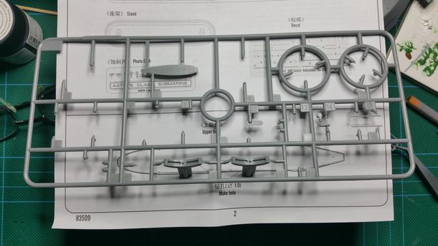

Courageous Posted October 19, 2018 Author Share Posted October 19, 2018 (edited) Hiya all. Been mucking about with this build and wondering if I'm being stupid...and I'm not... I don't think. I've noticed that part numbers called on instructions are either wrong or the part doesn't exist. Sprue on instruction sheet. The sprue. The bottom quarter is the problem area. Parts 22 & 23 are the aftplanes and are molded as part of the lower hull. Parts 12, 13, 14, 15, 17 & 18 are separate on instructions but here they are molded together under one number, very weird. Sorry for the soft image. He we have the forward PE parts fitted. Not sure what the four discs of PE; not capstans as they're the group six and there're lots of them, main vents...must be more than four surely? Any clues as a matter of interest? I haven't fitted the forplanes yet as I believe that the casing was modified in this area but I don't how soon it went in or how widespread it was. Stuart Edited October 19, 2018 by Courageous 7 Link to comment Share on other sites More sharing options...

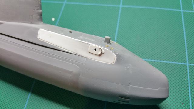

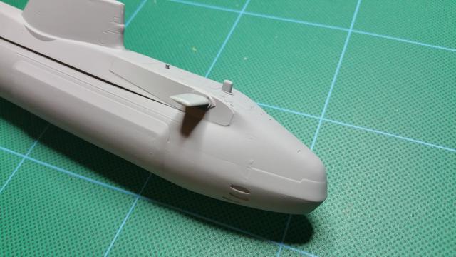

Courageous Posted October 25, 2018 Author Share Posted October 25, 2018 After trawling the 'net' for Astutes, this modification seems quite widespread, so I've decided to carry out the same mod. I used the thinnest plasticard to create this. The semi-circle fairing is made from wire and everything was 'faired-in' with PPP. A blast of primer, a temporary fit of the forplanes 'et voila'. I don't think it looks to bad, Stuart 3 Link to comment Share on other sites More sharing options...
Terry1954 Posted October 25, 2018 Share Posted October 25, 2018 That mod looks pretty neat Stuart. I really like the look of these boats. Terry 1 Link to comment Share on other sites More sharing options...

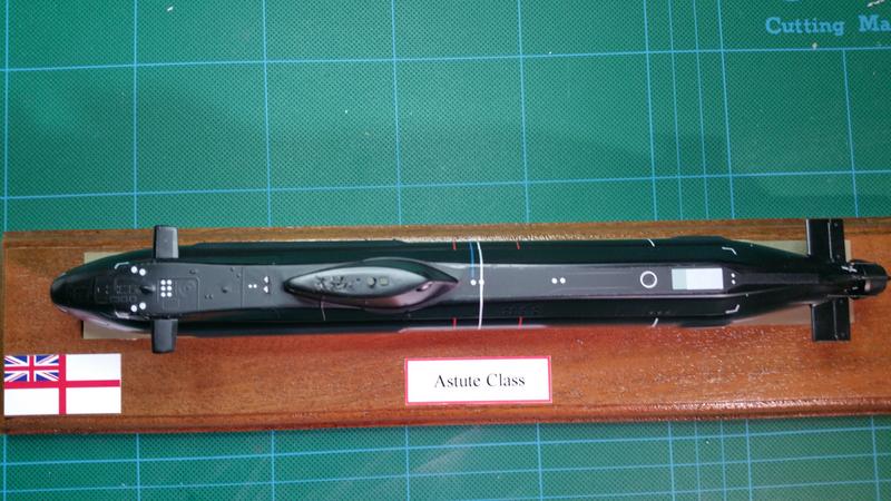

Courageous Posted November 20, 2018 Author Share Posted November 20, 2018 Has been a busy few weeks for one thing and another but here is the last update. Here we have the now complete Astute on its base. Painted overall with Halfords Satin Black from a rattle can with the side blisters (of whatever they are) painted in Mig Grey Shadow. Coated with Future, decals added and sealed. Hull masked off to apply Tamiya flat varnish to non-slip deck. Mounted my usual way that I'm not happy with nowadays, might have to do something different. RFI: Regards, Stuart 6 Link to comment Share on other sites More sharing options...
