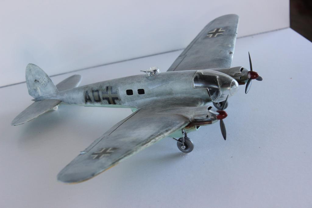

TonyW Posted September 10, 2018 Posted September 10, 2018 Another entry from me. A US Airfix boxing of their He111. The plan is to build it as a whitewashed Russian Front plane. Nothing fancy, an out the box build with minimal added detailing to keep the build doable within the GB timetable. A bit of effort will be put into a snow covered base for the plane. I've long held a fascination for the efforts and hardships of keeping an airforce flying during a Russian winter. Online pictures of Ju52's and He111's etc. in the most appalling weather conditions look incredibly sad to me, but what a subject for a model! Here's progress so far... Assembly has gone very smoothly. A fair bit of filler has been needed, especially around the wing roots. The underside needed a whole load of filler to cover the large gaps. The trench like aileron fit wouldn't do at all. The huge gaps got filled and rubbed down and a bit of re-scribing applied. A coat or two of white primer highlighted any more work needed and then it was on with a bit of green as an undercoat. I've hit a major snag in the build as the canopy had a bit of bad luck. It's a bit rubbish in the first place, with a very difficult to hide seam around the middle of it. Efforts to line everything up with the fuselage were going well right up until I managed to ping the thing off onto the floor. I really did think it flew off forwards and under my bench. The cracking noise when I stood up and stepped back to find it indicated otherwise. Grrr. I've glued all the bits back together but as it sits, the thing is unusable. I'll have a go at moulding a new one but if that fails the canopy area will be getting a tarpaulin cover to keep that Russian winter off the glazing. More later. Tony. 5 3
Heather Kay Posted September 10, 2018 Posted September 10, 2018 Crikey! You don’t hang about Tony! 1 1
TonyW Posted September 10, 2018 Author Posted September 10, 2018 If some is good, then more must be better! 😁 ...and there's been a time extension added to the GB, what could possibly go wrong? Tony. 5
Rabbit Leader Posted September 10, 2018 Posted September 10, 2018 I like your form Tony. Every GB seems to bring out thise mega builders and you’ve taken to that title most wonderfully well - you’ve got a few rivals though, so let’s not forget Heather and Peter (Mr. Airfix) himself! This Heinkel looks like another quick and super Tony build.. another one to watch. Cheers.. Dave 2
Lawzer Posted September 10, 2018 Posted September 10, 2018 Whoa slow down fella! You're making us look bad!! 😁 Great progress (apart from the canopy ☹️).

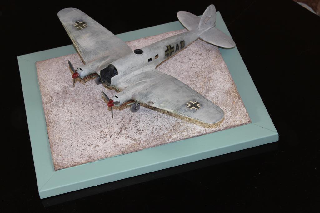

TonyW Posted September 10, 2018 Author Posted September 10, 2018 (edited) If only I could be this prolific at shed building! Oh well, the sheds will be built at some point. Then I can really get cracking on the models 😁 Meanwhile, back at the bench.... The plane got masked up, using the pattern shown on the US instruction sheet. Strict accuracy didn't come into this really, I reasoned that most of it was going to dissapear under the intended whitewash finish. Two coats gave an even coverage. I used Humbrol Authentics German Camouflage Medium Green and Xtracolor RLM70 Schwartzgrun for the greens. Transfers went on the minute the paint was dry enough, in a nod to sixties impatient building. Then the good bit started. On with the whitewash, using a very pale blue/green Humbrol 23. Scrubbed on with a semi dry brush it looked like dirty, scruffy faded white to me. Result! That little lot brings things right up to date, and here's how the plane sits at the moment. Dabbing the barely dry paint with various kitchen scourers and cleaning sponges removed a fair bit of the 'white' leaving the plane looking like it's spent a winter in the open on a Soviet field somewhere. At least, thats what I hope it's looking like! I took a look in a cheapo, pile 'em high, sell 'em cheap shop in Ely this afternoon and came out with a load of bargain picture frames that will be doing a bit of alternative duty as model bases in the near future. More later. Tony. Edited September 10, 2018 by TonyW 6

TonyW Posted September 12, 2018 Author Posted September 12, 2018 The plane is on hold until delivery of its replacement canopy, courtesy of Pete up in Lincs, meanwhile a bit of base construction got underway. The board backing from a cheapo picture frame got a smear of tinted polyfilla and a layer of sand and grit tapped into it. Then it got a sprinkling of Precision Ice and Snow. This stuff is supposed to twinkle just like real snow. I can't see any of that at all. It might be my old eyesight letting me down here, or I might have fallen for the advertising. Either way, a bit of talc or unmixed pollyfilla would have given me an identical finish. Live and learn I guess. There's a bit of tone correction needed on the planes finish and maybe a bit of additional scenery needed. The usual oil drums and gas cans would fit the bill here I suppose. I've got another built He111, finished in the colouring of the Type 2 Airfix box. That one has a snow background on the box. I'll take a look for it and try it out on my new base. More later. Tony. 4

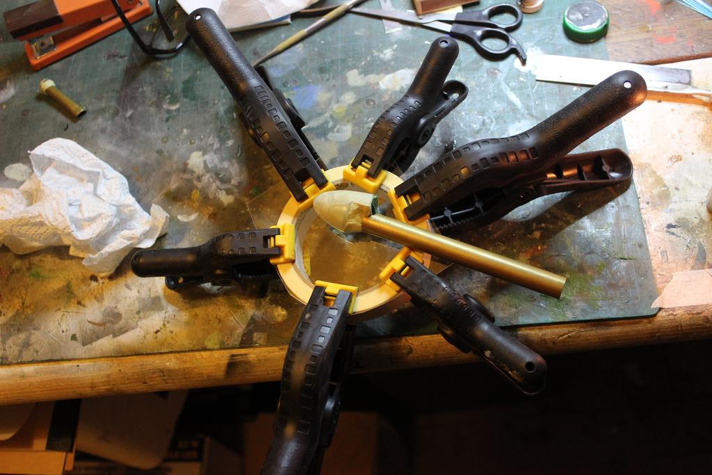

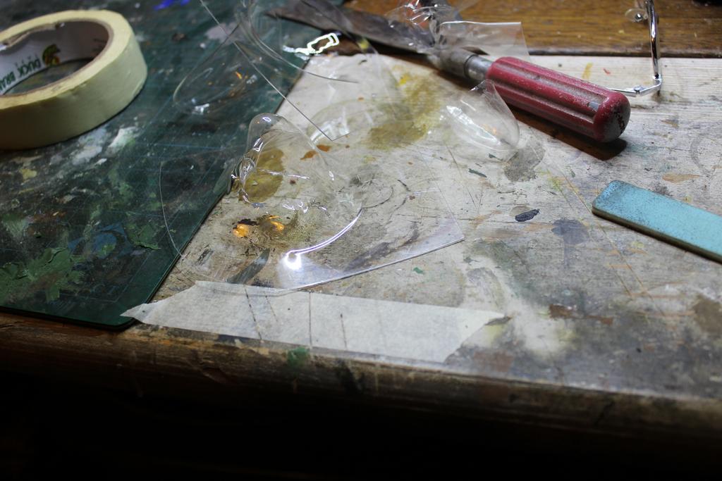

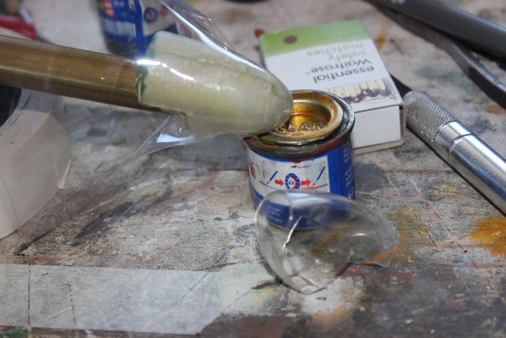

TonyW Posted September 24, 2018 Author Posted September 24, 2018 Well, it looks like the Royal Mail have made a Royal Bodge of things. The He111 canopy Pete kindly sent me has not arrived yet. It will probably show up the day after the GB ends! I've had a go at moulding one using the re-glued original, packed with milliput and with a brass pushing handle wedged into it. I failed though. I ran out of clear plastic before anything like a decent canopy was produced. The depth of the draw needed defeated me. Ho Hum. I then tried hitting the mould tool with silicone mould release, followed by a few heavy coats of clear car paint. A thin but brittle canopy was what I though I might be able to make here.Total failure was the result when the clear ate straight through the silicone and wrinkled the canopy! I've got two options left. First, make a tarpaulin cover for the canopy, I have a picture somewhere of the real thing on the Russian Front so it might work. Another mate thinks he has a canopy buried in his parts box. If so, it's mine. It's getting tight, but I think this one is still possible. The base for the plane got a coat or two of nice, cool blue. I wanted the thing looking cold, it kind of works but looks a bit like a sixties Buick colour to me. I might try giving two of the corners yellow diagonal bands, mimicking the Luftwaffe Eastern Front under surfaces, to see if that works. The plane itself has had a bit more whitewash applied. It might get more. More as it happens... Tony. 4

TonyW Posted September 26, 2018 Author Posted September 26, 2018 Well, thanks to Adrians kind offer of a vac formed canopy I'm back in business with the He111. Postie delivered the canopy this morning. Thanks Adrian, you are a star. This no doubt means Pete's canopy will arrive tomorrow. You can never have too many canopies though. It needs a bit of trimming, but it's going to do the job nicely. Too nicely for that rather bare interior, a bit of detailing is definitely needed given the clarity of the glasswork now. I don't know if I lost it opening the parcel, or if it was not included, but the very tip of the canopy nose was missing. No problem, I moulded another with my plunge mould tool. It turned out fine at the second attempt and has now been added to Adrians canopy. This evening see's a bit of basic detailing for the pilots seat and surrounding area. More later. Tony. 7
