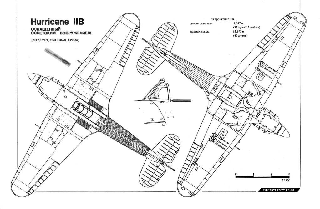

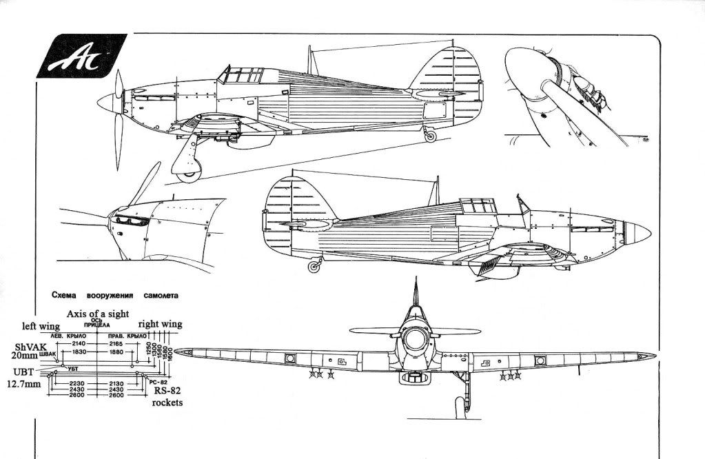

Troy Smith Posted August 29, 2018 Posted August 29, 2018 27 minutes ago, Corsairfoxfouruncle said: You wouldn't possibly have a close-up photo of the RS-82 rocket mounts on the Soviet hurricane’s ? I would like to take a stab at scratch building the rails at leas The rails and rockets are standard VVS fitting AFAIK so could be sourced from another kit, @Learstang knows more what 72nd kit would have spares, regarding details, google is your friend...honest http://www.arcforums.com/forums/air/index.php?/topic/218449-rs-82-rockets-rails-colors/ note this image is titled 'Hurricane' posted by Sergey Kosachev, who emailed me the drawings below regarding the regunning http://massimotessitori.altervista.org/sovietwarplanes/board/index.php?topic=881.0 A while back I asked on Hyperscale about the regunning of the Hurricane, and was emailed drawings by Sergey Kosachev of Vector. Points to note are the slight asymmetric layout of UB guns in each wing. This is better shown in the frontal view with the dimensions in mm from the centre line. I presume this is due to allowing for the ammo feeds of UB guns? The added underwing plates with the spent cartridges slots. These well the show the asymmetry of the UB's. Small plates round the UB guns one wing leading edge. The asymmetry of the RS-82 mountings. I added in a photo of the ShVAK cannon, the grey object top left, to the same scale. The rear gun access hatch looks a little narrow in the drawings, but the important details are well shown and look accurate. I'm not sure why there are scrap views of the nose included in the drawings, but do provide some useful details. the pics were showing but now getting the photobucket demand, if you don't have an embed fix on your browser, try right clicking and going to the PB site as an aside, here's another VVS modification http://massimotessitori.altervista.org/sovietwarplanes/board/index.php?topic=2122.0 a bit more on two seaters http://massimotessitori.altervista.org/sovietwarplanes/pages/lendlease/hurricane/hurricane.html note the links to other Sovietwarplanes links HTH T 1 1

Troy Smith Posted August 30, 2018 Posted August 30, 2018 4 hours ago, Corsairfoxfouruncle said: need to change the wing guns from 12x.303’s to 4x 20mm ShVak cannons. Add the rocket rails. It will need the Day fighter scheme of Dk.Green & Ocean grey over Med. sea grey. The RAF markings will be painted out and Red Stars over lay the areas. That in turn will need a winter white wash. Nothing major that i can see. See you as soon as i can Two points. Not 4x 20mm ShVak, the inner guns were 12.7 mm UBT, note the assymetric position, as shown on the 2nd set of drawings. Which are not showing for me, but are on PB... Note the added underwing plates for the ejector slots. Yes RAF DFS, but in most cases RAF markings were painted out by the British before delivery, with RAF standard paint. Typing on a tiny tablet, so may add more later, might be worth asking in the wanted section if anyone has any spare RS-82s, @Procopius just did an Il-2 and don't think he used any rockets.... Not sure if base kit had them, but it the sort of thing that ends up in a spares box, and are small enough they'd be the cost of a stamp to post, so ask in the wanted section Cheers T 1 1
