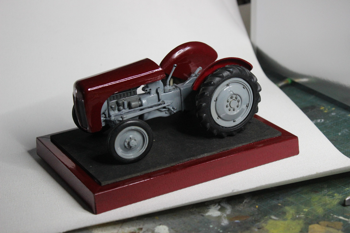

TonyW Posted September 14, 2018 Author Posted September 14, 2018 Time to quit for the evening, steady progress got me a tractor sitting on all four wheels! The front suspension scratch build went just fine. It all has to match up to the existing steering arm drag link as I don't fancy removing that bit after the near disaster with the rear wheel. Everything got carefully balanced into place with a bit of turn added to the wheels to bring the model to life a bit. Careful gluing then commenced and it's all sitting there drying until morning. I'll reinforce the joints then and file a couple of small details down to match the other side. A bit of brass tube has been bent into a circle for possible use as a steering wheel. It might be a bit too thick though. I have some other tubing that might look better but that can wait until another day. Tony. 8

TonyW Posted September 15, 2018 Author Posted September 15, 2018 ...and a bit more gets done this morning. The third attempt at bending a brass tube circle looks like it will work for the steering wheel rim. It's the thinner one in the tray. I'll make a start on the spokes this evening. I've also hit one of the cheapo picture frames I bought with a first coat of Humbrol 20 to match the finish on the tractors hood and fenders, or bonnet and wings if you must. It's just a try out for a possible base for the model, I'll give it another coat this evening and see how things look then. This restoration is a whole world away from the Commando Comic builds I've just done, the change of pace is very refreshing. 8
Foxbat Posted September 15, 2018 Posted September 15, 2018 You're doing a cracking job and that base sets it off perfectly. Can't wait to see that steering wheel finished - what did you use to get the perfect circle? Andy 2
TonyW Posted September 15, 2018 Author Posted September 15, 2018 Thanks, I wrapped the brass tube around a 19mm bit of pipe, cut it at the crossover and pined it with a bit of finer brass rod inserted into the open ends. I surprised myself at how easy it was! 4

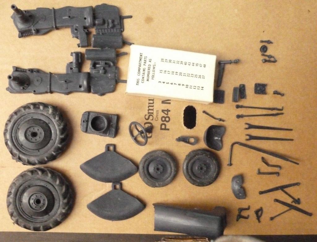

Bonhoff Posted September 17, 2018 Posted September 17, 2018 Did the original kit come with all that engine and steering detail? If so that's really impressive for a 69 year old kit! IanJ 1
TonyW Posted September 18, 2018 Author Posted September 18, 2018 (edited) Here's most of the parts laid out as they came. The chassis and most of the detailing, exhaust manifold, starter etc. are all moulded as two parts. Suspension and steering are separate parts. Simple but fairly effective. The appearance of the model could be improved quite a bit if the starter and stuff were detail painted in different colours. Ferguson seemed to like that rather dull grey for everything though. The base looks like it will be used although the black bit is a bit gloomy. The grey and maroon don't help here. A bit of the field outside my house might get pressed into use as a very simple scenic base for the model. Here's how it sits this morning. It's had a wash with a darker grey in an attempt to bring out a bit of the detailing. It doesn't look any better for it and may well get covered with another coat of the gloss grey. Shadows will have to provide any detailing. There might be a bit more to report later, Dinosaurs permitting! Edited September 18, 2018 by TonyW 7

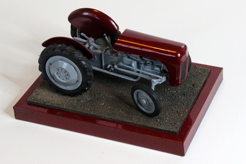

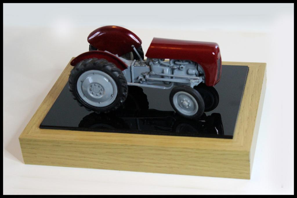

TonyW Posted September 18, 2018 Author Posted September 18, 2018 Today's been a day for bases and scenic stuff, on this build and on a couple of others. The Fergusons maroon base got a layer of Fenland Field Dirt (The real deal) added to a layer of PVA glue as an experiment in cheering up the rather drab base. It's a definite improvement over the painted board and might even get used. Another tryout was built out of yet another cheap picture frame. I took the glass out of the frame, sprayed one side with black aerosol and glued that to the top of the frame, with the painted side facing down. It looks very posh! Maybe too smart for a grey tractor though. 8
