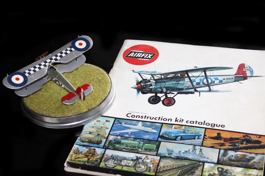

TonyW Posted July 2, 2018 Author Posted July 2, 2018 With the completion of my attempt at the Airfix DH88 Comet, it's time to get back on the Bulldog, if you will pardon the expresion! A bit more assembly done, mainly to the engine and a bit of cleanup started on the undercarriage and other assorted bits and pieces. A base has been started as well. A Lidle Youghurt pot lid got a coat of silver spray, followed by a buffing with a metaliser powder. A card disc was painted green, had sand sprinkled on it, then scenic grass. Cheap as chips and done in a flash! Final assembly can't be far away now, then it's time to crack into the Lancaster prototype. I'll be having a think about the next build, possibly something nautical for a change. Hmmmm. 12

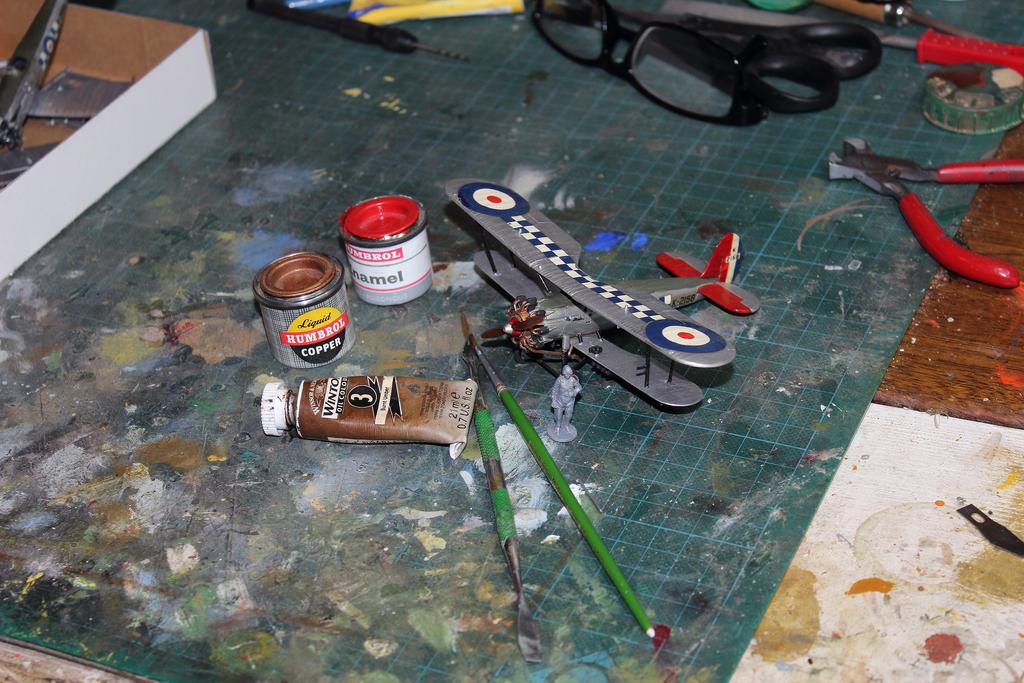

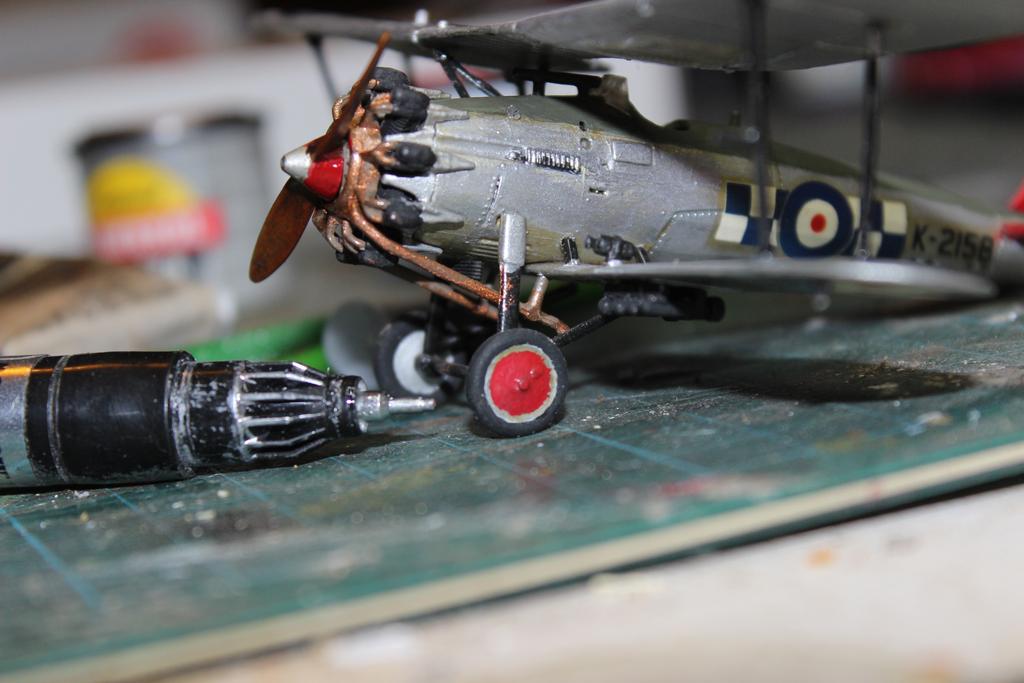

TonyW Posted October 4, 2018 Author Posted October 4, 2018 Nothing to report on this build since August the first. A shocking state of affairs! Something just didn't work for me with the build at that point. Mojo went, nothing could be done about it, other than start another build. It happens... Fast forward to today, when I find what I thought was an October the Seventh finish to the GB turns out to be a full ten days further away! Time to take another look at the Bulldog. I've dug the thing out and straight away seen a booboo I've made. I painted the rear part of the tailplanes red... Wrong... Error now corrected, red where it should be. The exhaust has had a coat of Humbrol copper as part one of the paint treatment there. A couple of chips on the decals have been touched in and a bit of oil paint has been smoothed over the prop. The red area on the prop got a fresh coat of red and the wheels got an outline with a Molotow 1mm pen. All in all, about an hours work. It's got the plane back on track, and that can only be a good thing. Tony. 6
Ventora3300 Posted October 4, 2018 Posted October 4, 2018 Is the pen on the wheels for the tyres? Always difficult to hand paint tyres on these small 1/72 wheels. Have you got a Top Tip here? 1
TonyW Posted October 4, 2018 Author Posted October 4, 2018 (edited) Molotow pens are the best thing since sliced bread. The chrome effect is just about unbeatable. I use the 1mm and 2mm pens. I didn't need the chrome part for the Bulldog wheels, but the 1mm bit looked like it could sort out the bit on the wheel between the tyre and the hub. It worked just fine. I took a deep breath and drew a circle around the wheels. One went fine, the other needed a bit of touch up. A dry brushing with matt varnish got everything looking about right. I might have gone a bit wrong by drybrushing the cowl at the same time. I thought the chrome effect a bit bright. The dulled down look isn't right either. I'll have a think about this. Edited October 4, 2018 by TonyW 4 1
TonyW Posted October 5, 2018 Author Posted October 5, 2018 (edited) Having a break from this build seems to have done the trick. I spent an hour or two finishing the model off, nothing major the usual tiny bits and bobs. I also refinished the polished ally fuselage sides with a 2mm Molotov pen. It still looks a bit bright to me but the dulled down attempt yesterday just looked wrong. No rigging for this one, I'll need something a whole lot simpler and with a bit more space to work with. It sounds daft, but the Airfix HP 0/400 might be a good first try. The rigging holes are already there and the Airfix wing design allows the wing assembly to be rigged, then built up. A bit difficult to describe, I'll dig out the kit instructions at some point to demonstrate. Here's a quick shot of the Bulldog as it is. There's a pilot to be added yet, to disguise the complete lack of any detail in the cockpit. More for the Gallery later. Edited October 5, 2018 by TonyW 9
