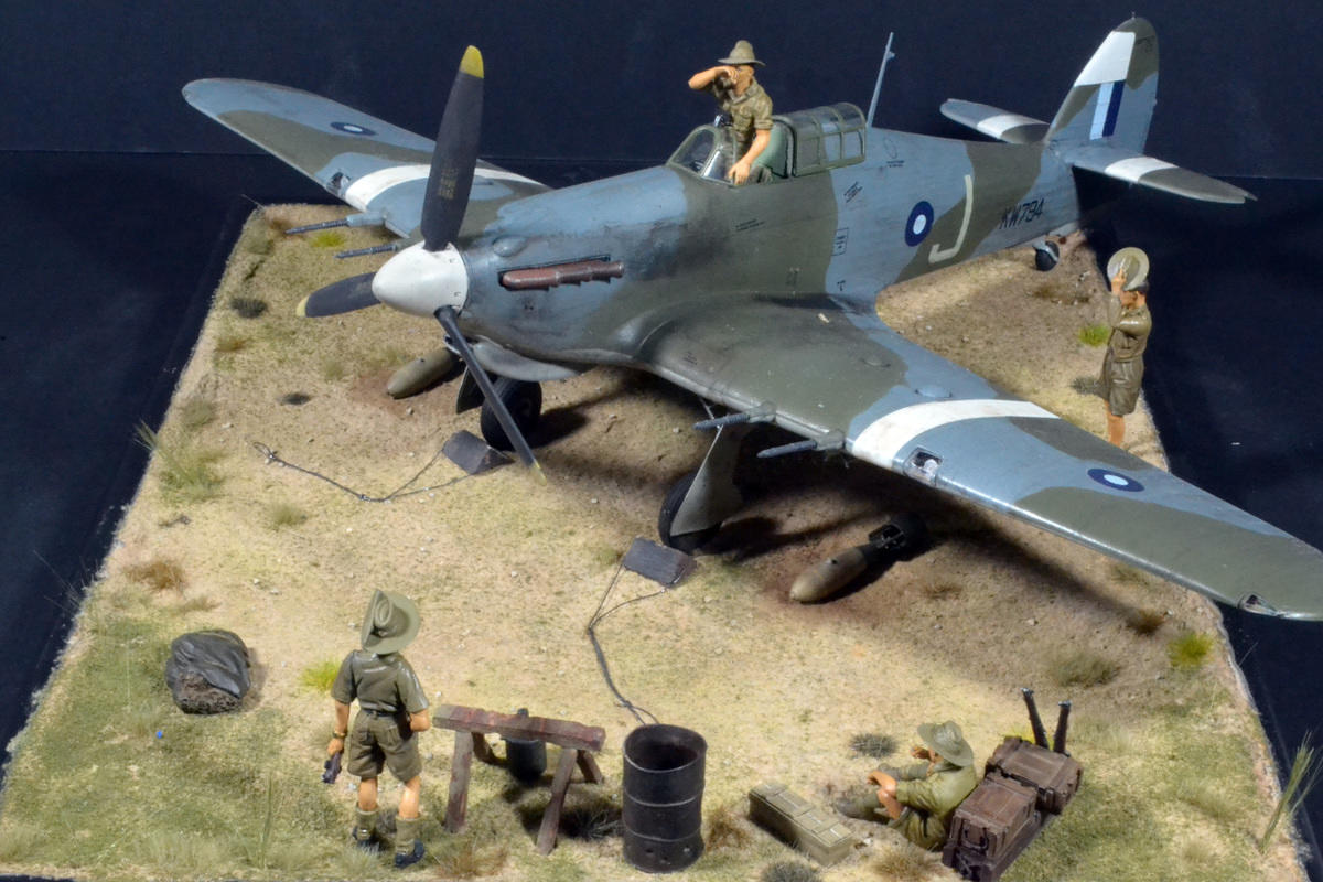

Kallisti Posted July 7, 2018 Share Posted July 7, 2018 I've built the Fly IIc and have the IId and IIb in the stash. They are not easy to build but they look the business You can see my build of it for my "Clang!" here 2 1 Link to comment Share on other sites More sharing options...

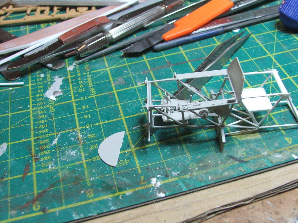

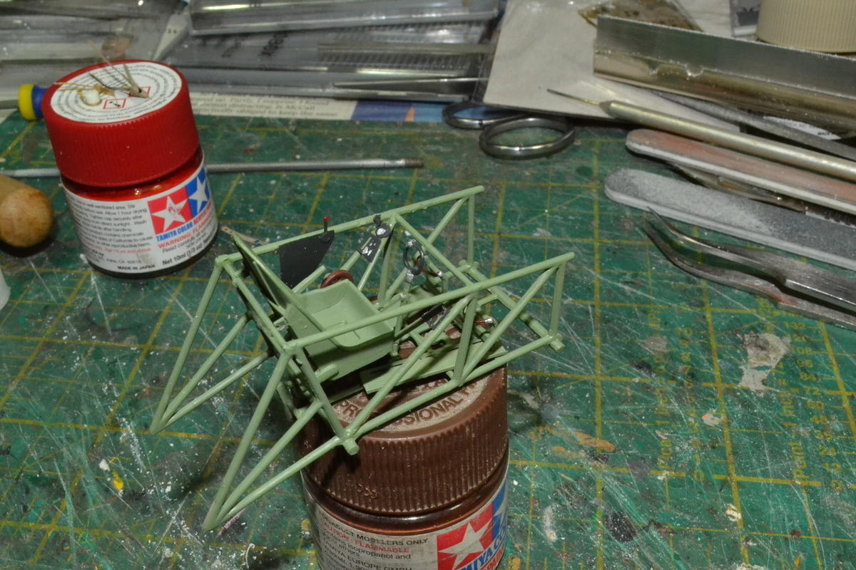

Kallisti Posted July 10, 2018 Share Posted July 10, 2018 Having built both the Fly kit and a Revell with the Grey Matter cockpit, I'd be hard pushed to decide which one is better or worse. I'm not sure what reviews are saying about the Fly cockpit but I don't remember finding it all that difficult to build. It is a short run kit so its not so easy as a Tamiya kit might have been... This was my Fly cockpit in progress and this is my Grey Matter cockpit from back in 2012 when I added a scratch built rear to the framework to allow me to open up the fuselage panels behind the cockpit One of the biggest obvious differences is the side panels for the FLy kit are moulded into the fuselage sides whereas for the Grey matter they are attached to the frame as the Revell kit has no internal detail at all. 2 Link to comment Share on other sites More sharing options...
