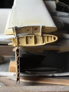

A little update - flaps and ailerons were fitted to the wing using brass wire to help align them and then glued once I was happy with the alignment - the structure on the front edge of the inner flap was a spacer to get the flap to sit right
.Jury struts were made from Albion Alloys slide fit pack SFT1 - the plastic collars were made from heat stretched tube and sanded to size using a toothpick - also used a couple of metal washers from an old left over etch
Struts in place doing their job - wing angles will need tweeking later - navigation lights & flap hinges fitted
