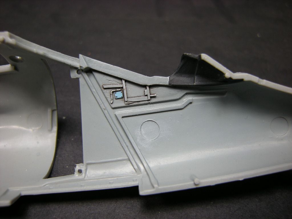

The cockpit side walls are completely featureless OOB, so I decided to add a few details loosely based on references

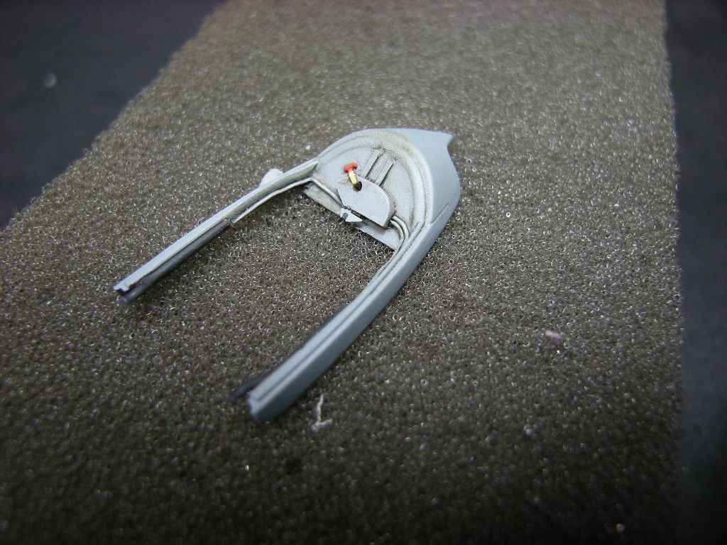

The canopy frame did not miss out either
The PE set supplies a MDC control box cover for the aft canopy frame bulkhead but I think it is a little too big so I decided to make my own instead. A quick blast of paint and a wash and drybrush later and the cockpit sides were done!
Likewise the tub

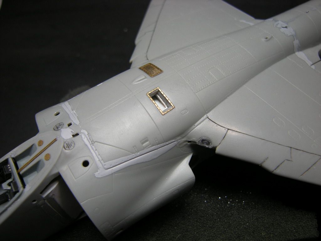

G'day people,

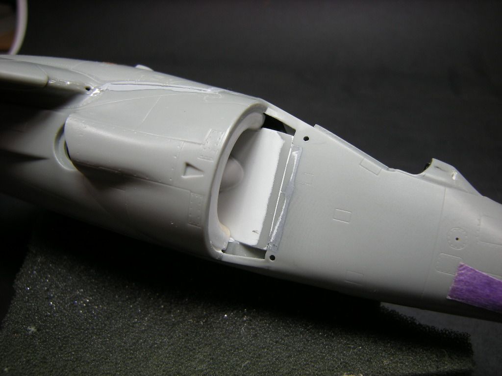

Well I have managed to get the main wing attached to the fuselage so now it is time to get down to the drudgery of filling and sanding seams. The fit is actually not as bad as the pics would have you believe as I am using liquid filler painted on to fill small, shallow seams.
The intake duct was the first area that has been tackled
Next up, the seams around the upper fuselage/wing
Note these seams fall along natural panel lines so the aim is not to completely eliminate the line, just reduce its depth.

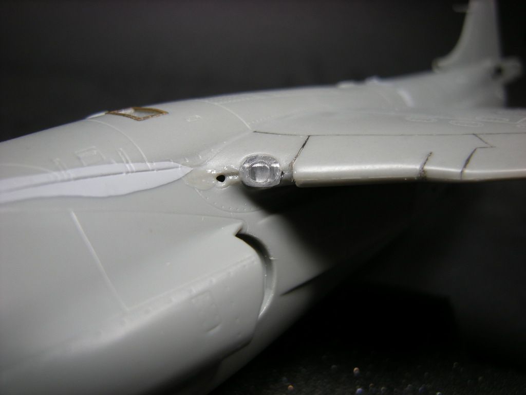

Next up this small clear part is the In Flight Refueling (IFR) light
When the IFR probe is not installed, a solid panel is normally fitted in its place and the kit offers both options. The fit is not too bad once the wing recess has been filed to better suit the contours of the part

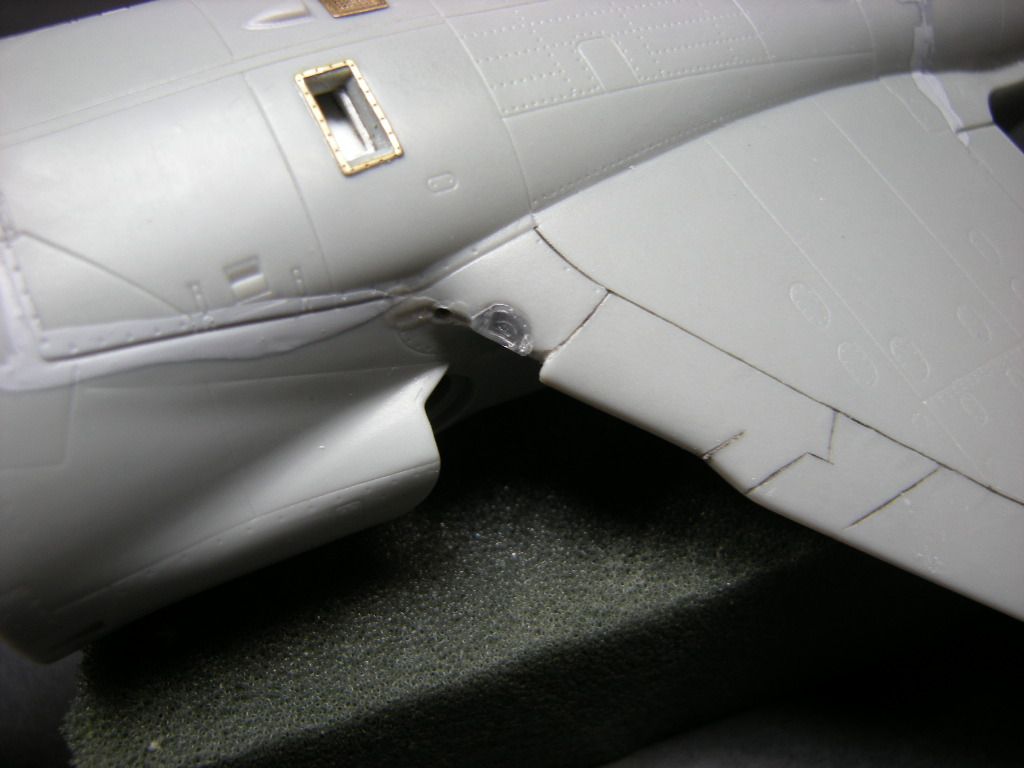

Now for the really ugly bit, the wing root fit is bad and will require some proper filling and sanding

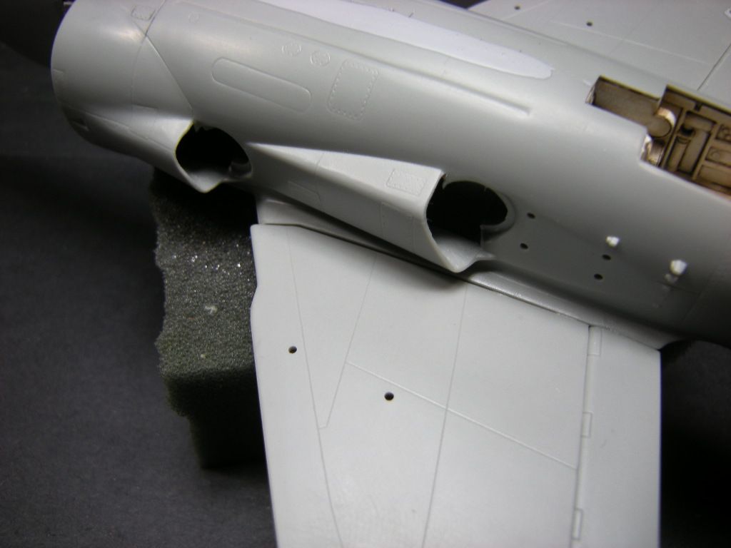

Kinetic stuffed up the rear RCV part E25.
The part fits very well as per the kit instructions but the details have been transposed. The rectangular outlet should be at the back and the two circular grilles at the front, not the other way around as Kinetic have them moulded. The problem is more complicated as simply turning part E25 around so that the details are correctly orientated introduces another problem as the tail boom tapers in two planes and you will need to sand back the aft end and build up the front end with putty and restore the circular grille details.  It is not really that hard but I have already done it once in my FRS.1 build and didn't feel like doing it a second time. Hopefully Kinetic will correct this mistake when they eventually release their GR.3 kit.
Instead I decided to leave off part E25 altogether and scratchbuild the exposed RCV mechanism instead. I began by removing the side RCV panels from the tail boom and the top and back were then boxed in
Next up, i knocked up a representation of the RCV mechanism using bits of scrap styrene and sprue
After an enjoyable morning I was happy with my mech. It is not super accurate but will pass a cursory glance
After  a splash of paint I temp fitted the mech
Happy days! This will be put to one side and installed once all the main painting and weathering has been completed
