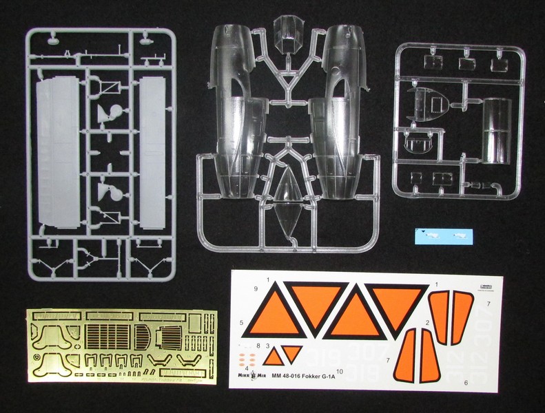

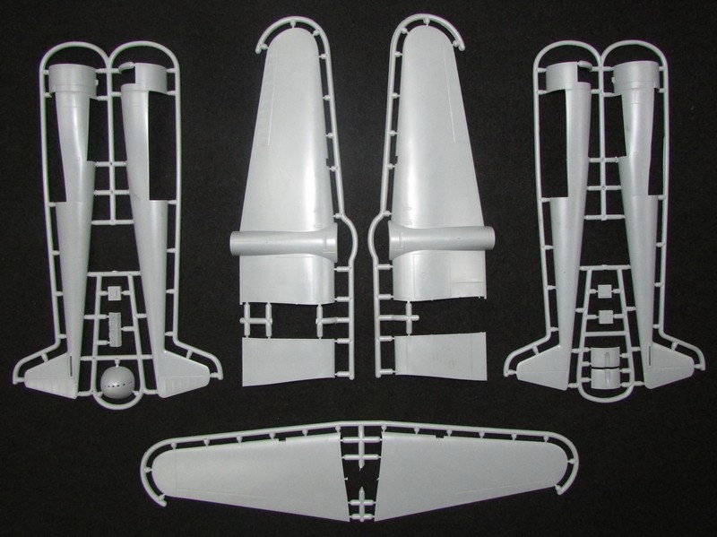

Homebee 23,159 Posted August 30, 2019 Author Share Posted August 30, 2019 (edited) Some more pics from the final product: sprues+decals+PE Sources: https://www.aviationmegastore.com/fokker-g1a-expected-end-of-august-2019-early-september-can-now-to-be-preordered--mm48-016-mikro-mir-mm48-016-netherlands-military/product/?action=prodinfo&art=145361 https://www.hobby.dn.ua/mikromir-mkr-48016-fokker-gia-p-94596.html V.P. Edited August 31, 2019 by Homebee 4 Link to post Share on other sites

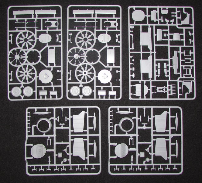

Homebee 23,159 Posted October 18, 2020 Author Share Posted October 18, 2020 (edited) Sprues & more - ref. 48-018 - Fokker G-1A reconnnaissance version Sources: https://www.hannants.co.uk/product/MM48-018 https://www.hobby.dn.ua/mikromir-mkr-48018-fokker-gia-reconnaissance-version-p-99415.html V.P. Edited February 1 by Homebee 1 Link to post Share on other sites
