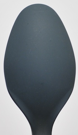

toniosky Posted May 28, 2017 Author Posted May 28, 2017 Thanks to the two of you for your suggestions. Fernando, Now having the FS number will realy help. I agree that the -66 looks a bit light and I prefer XF-50. XF-66 XF-50 1
