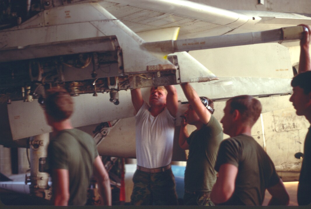

Finn Posted May 13, 2017 Posted May 13, 2017 Here are a few A-6A in Vietnam pics: The ALQ-100 antenna: Jari 4
