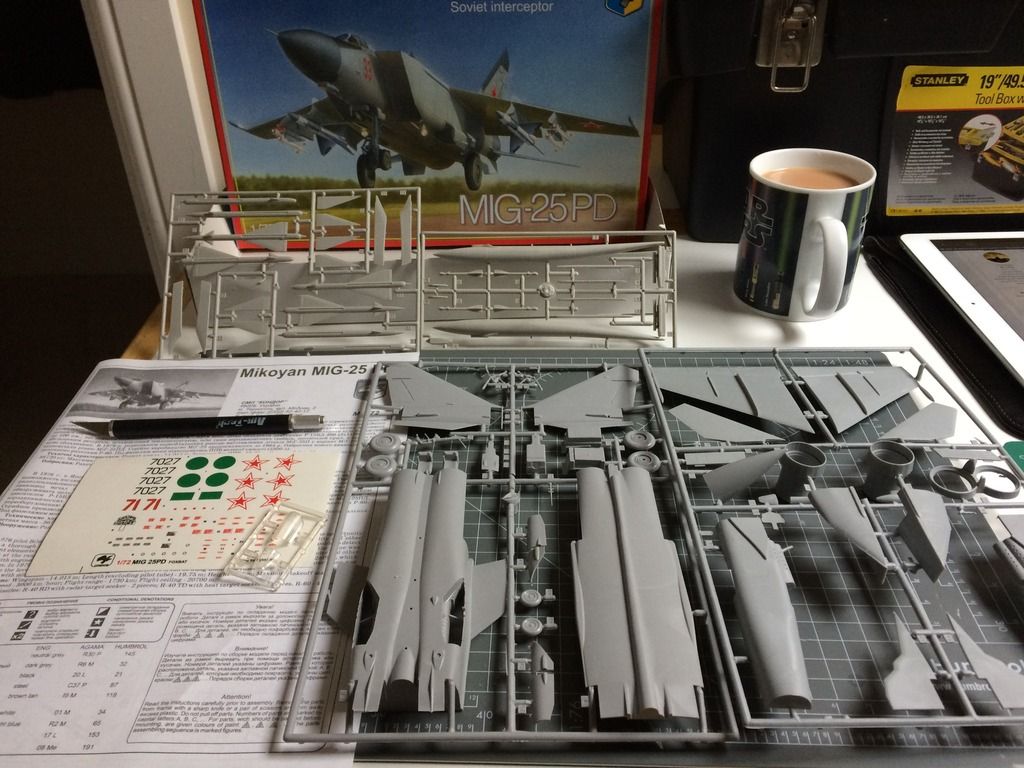

Valkyrie Posted February 5, 2017 Author Posted February 5, 2017 Box contents...I don't really know this make. Instructions in Ukrainian, Russian and English, stencil data for the Russian version only, lucky. It has an old feel to it, and again it seems a large aircraft. Started on the cockpit pieces. Don't have an actual soviet blue green so I will need to make one... 3

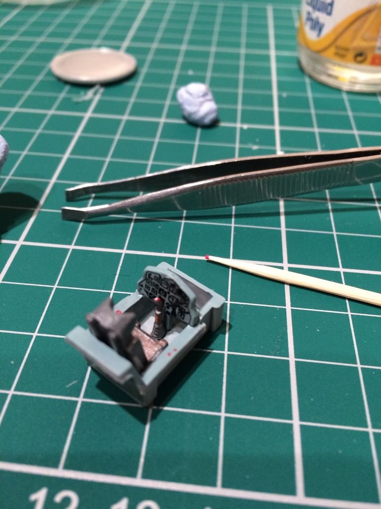

Valkyrie Posted February 7, 2017 Author Posted February 7, 2017 Ok absolutely hated doing that, decals fell to bits, spent ages researching and blending cockpit colours..but, after it was done I am feeling better. Doubt you'd be able to even see the office once we are in the frame. Reading more and more about the 25 and NATO and Warsaw Pact and the vastness of this GB and effort everyone is going to is really spurring me on. Took a half day off to do the tub to get me on track...brilliant. 5
Valkyrie Posted February 8, 2017 Author Posted February 8, 2017 3 hours ago, Pin said: Hmm, cockpit colour should be emerald green Thanks Pin, its a pest trying to make that colour, I wish I'd just spent that £3 on the mig turquoise paint! I have done 2 Eduard Czech MiG 15 cockpits and that blue was sort of nearly pretty close to the photo etch colour. Pin, if I bought turquoise stuff would I need to scrape my blue off then apply or would it work on top of it? Also, the grey for this asks for neutral gray from Humbrol 145, but I don't think they do it anymore.. any ideas? I might as well order that while I'm upgrading the green.. any help much appreciated

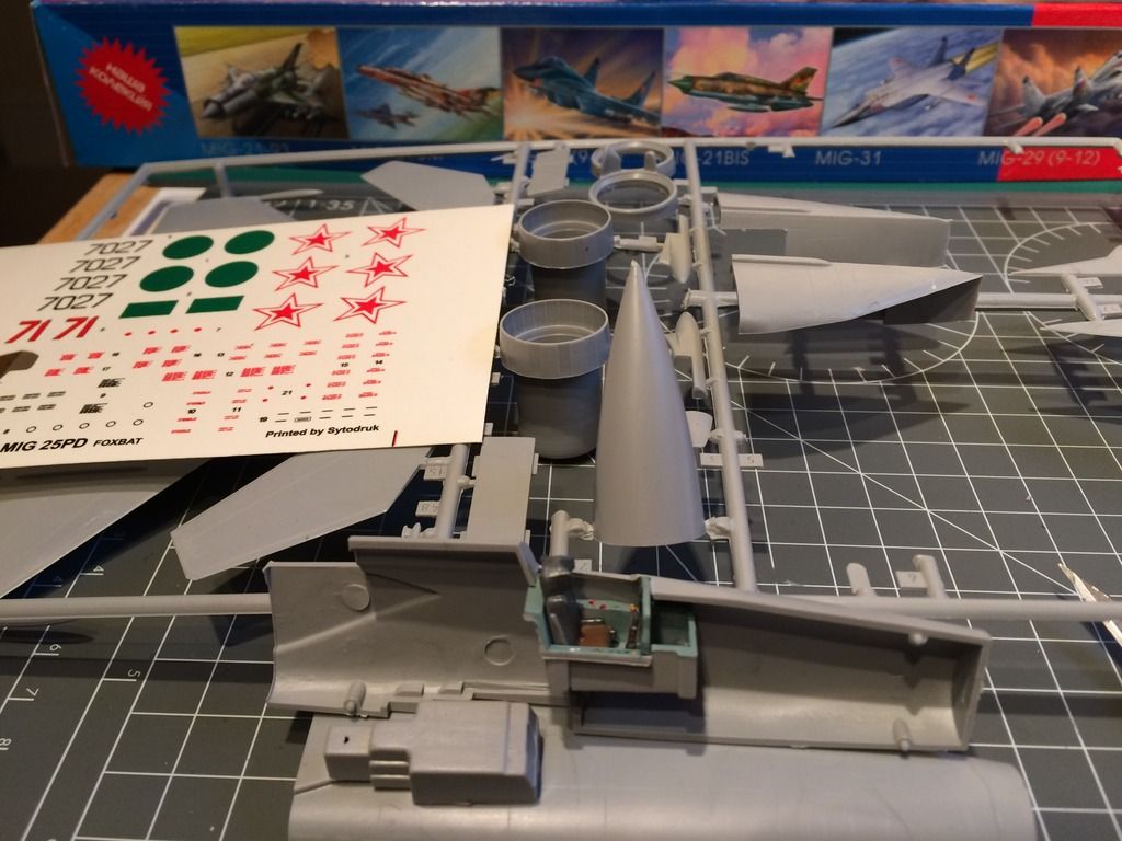

Valkyrie Posted February 9, 2017 Author Posted February 9, 2017 Small dry test fit. Cockpit virtually snap on! All fits together seamlessly until the cockpit is inside. Do I file the cockpit down a tad at the sides or really squeeze the thing shut once glued and hope? I'd like the seamless finish, perils of being a newbie. I have time to wait to decide my new cockpit green won't be here till Saturday, I'll need to intercept the postman as that's not all that's coming.... 1
Valkyrie Posted February 9, 2017 Author Posted February 9, 2017 (edited) Waiting on paints, time to be brave and see how this fits together on a dry run.....it's not going to be an easy build. It's certainly snap tight but when u add the wet sticky gluey stuff you don't get to fiddle without making a real mess. I am worried, be a great model for an experienced builder, not for a raw newbie. Edited February 9, 2017 by Valkyrie 1
Col. Posted February 9, 2017 Posted February 9, 2017 I'd say take the edge off the cockpit components to gain a greater quality fit of the fuselage parts. That will improve the final finish of the kit and give you less work in the long term. There also looks to be a slight lip on the edge of the cockpit moulding that needs to go. 1
Valkyrie Posted February 9, 2017 Author Posted February 9, 2017 Thanks Col. I am never sure what's meant to be there and what's not. I have cut vital parts off before, this is the first kit I've dry fitted and it is a good idea. Trim cockpit the way to go, thanks again. 1
Col. Posted February 9, 2017 Posted February 9, 2017 Go little and often. Try to be equal on both sides as well 1

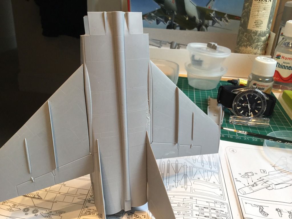

Valkyrie Posted February 10, 2017 Author Posted February 10, 2017 HELP...liquid poly seeped from a stabiliser join and like falling buttered toast, yes it's on the side you don't want it on. I tried thinners and a cotton bud but seemed to make it worse. Please tell me there is a way to get this repaired? Was going so well...
Bodmin Posted February 10, 2017 Posted February 10, 2017 All I can suggest is letting it dry fully. Then lightly sand to rid the roughness. There maybe a magician here shortly with another solution. Hold tight!! 1
Mountain goat Posted February 10, 2017 Posted February 10, 2017 (edited) Nice work Shame about the accident. Cannot offer much more in terms of advice than Bodmin. So probably wait a day or two until it's thoroughly dry, sand back, see if the glue etc has caused a depression in the surface - if not, sand until smooth, from coarse to fine. However if there is a depression in the surface you want to get rid of, you need to add a layer on top. You could try the following: combine plastic shavings (just shave or cut tiny plastic bits from the runners and sprues, or collect sanding dust from plastic) with poly cement such as Humbrol cement or Revell contacta in a small left-over metal or glass jar or bowl. The plastic will slowly dissolve when you stir the ingredients together to create a home-made filler- try to get a paste-like texture out of it and apply on the area where you want it with a cocktail stick or something else of wood. Let it dry a few days, then sand back. Repeat if necessary. Fumes are dangerous so keep the place ventilated. The build can continue during all this. An alternative is simply to apply a layer of CA superglue. Another possibility: use a good commercial filler paste such as Tamiya filler. Just see what works best. As long as you keep sanding until smooth, that's the main thing. Jay Edited February 10, 2017 by Mountain goat 3
