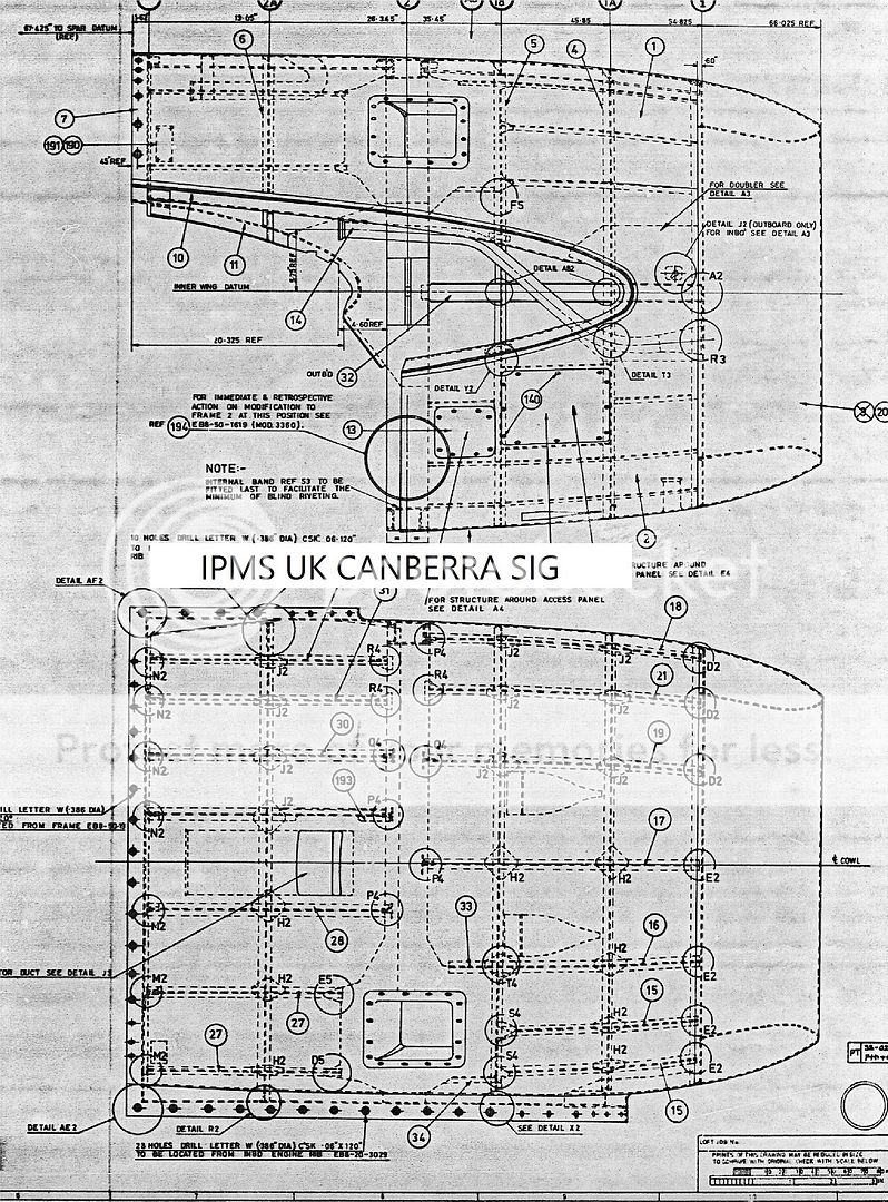

I'm currently scouring John's gallery of photos trying to find a close-up of this exhaust. Whatever I do on the starboard side, I'll also have to do on the port side to make sure they both look the same.

This may help Bill
John

The intake exhaust vent omission is a strange error by Airfix but easily solved, perhaps they could only get access to one side of an aircraft though why not access to Google is anyone's guess. Also notice the poor fit of the tailplane in the English Electric kit...dreadful gap :bandit:

Indeed, that helps tremendously. I never realised there was a mesh or grate inside.
Well, I think I'm limited to where Airfix moulded the vent on the port side, since it's a depression in the surface. It's not exactly where it's supposed to be, and it's not the right size. Accordingly, I measured where it was relative to the front of the nacelle, and cut out a rectangle of the same size on the starboard nacelle.
IMG_1105
Next, I did the same for the port nacelle. I tried to get them as close to square corners and the same size as possible. For the grate that's inside, I used some 1:700 ship railings in photoetch. As it turns out, I think it's a reasonably good match, especially in this scale. I hope you can see the little buggers in this photo.
IMG_1108
I didn't thin down the plastic from the inside, as John's photo shows the grate inset quite a bit. Now I have to fill in the erroneously moulded vent on the left side of the starboard nacelle - that should be pretty easy.
The engine nacelles will be closed on either end, so I don't think I need to put anything else behind those grates. It will be very dark in there. From John's photo, it looks like the grate is also painted Hemp, or Camouflage Beige Grey as I guess they call it now. Same as the upper fuselage.
