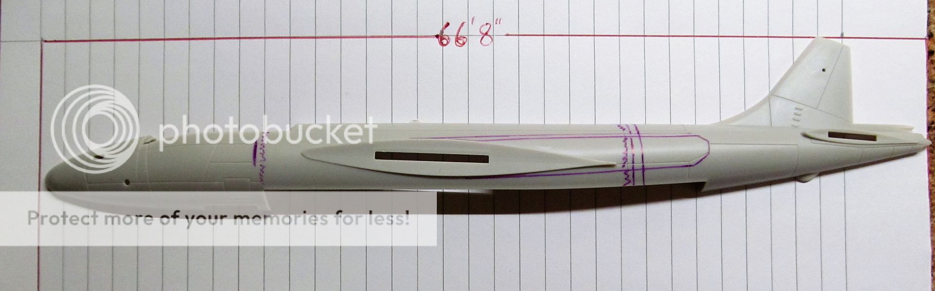

canberra kid Posted February 4, 2017 Share Posted February 4, 2017 I've had another go at measuring the two kits and they boath appear to fall short of the 66'8" by approximately 9" it's hard to be accurate without cutting the Airfix nose down the centre. John 1 Link to comment Share on other sites More sharing options...

canberra kid Posted February 4, 2017 Share Posted February 4, 2017 In the interests of science I've cut the Airfix nose in half! the up shot is it works out at around 8" short. In the attached photo it looks like the RWR is over the edge of the page this is an optical illusion. I've tied to do the same with my Xtrakit 9 but seeing as the fuselage is together I can only guesstimate but it looks to be around a foot shy. 4 Link to comment Share on other sites More sharing options...

Navy Bird Posted February 6, 2017 Author Share Posted February 6, 2017 On 2/4/2017 at 04:23, woody37 said: Popcorn stocked up, this is going to be a great show A show? Perhaps. Great? I wouldn't bet the crown jewels on it! On 2/4/2017 at 04:54, canberra kid said: In the interests of science I've cut the Airfix nose in half! the up shot is it works out at around 8" short. In the attached photo it looks like the RWR is over the edge of the page this is an optical illusion. I've tied to do the same with my Xtrakit 9 but seeing as the fuselage is together I can only guesstimate but it looks to be around a foot shy. Thanks, that jibes with my conclusion that Xtrakit is a bit shorter than Airfix. However, I don't see the Airfix kit being short. The fuselage is 260 mm long (I placed it against a machinist's metric scale for a direct reading), the nose is 17.5 mm (digital calipers - no need to cut in half!), and the RWR is 4 mm or 4.3 mm (there are two optional parts), Adding these up you get 281.5 mm or 281.8 mm. This works out to 66' 6" or 66' 7" - if the real figure is 66' 8" then I would say that my copy of the Airfix kit is pretty close, just one or two scale inches short. I'm quite confident of these numbers. Yours could be different - fickle styrene and all. In any event, since I plan to have the nose open to show off all that nice detail in the Pavla resin, I don't think anyone will notice the overall length of the fuselage. Either one of the kits will serve my purpose (but I really like the surface detail on the Xtrakit...) On 2/4/2017 at 12:56, Plasto said: If you use the Airfix kit will you do anything about the panel lines? No doubt. Probably fill them in a bit with Mr. Surfacer. On 2/4/2017 at 18:26, keefr22 said: This is probably a really dumb idea (especially from one whose only finished model last year was an Airfix B(i)8 built, warts & all, straight OOB & who would therefore never even think of doing it himself) but instead of substituting the entire Airfix upper outer wing, would it be possible to cut out the panels containing the gennies & let them into the Xtrakit upper wing? It would mean that you wouldn't have any of the Airfix panel trenches sticking out like a sore thumb against the Xtrakit ones. As I say I wouldn't even dream of attempting it myself, but to a man with your skills Bill.... Oh, you're evil you are. Naughty, naughty, naughty...but an interesting idea nonetheless. On 2/4/2017 at 18:50, limeypilot said: I think I'll quietly sneak up to the bar whilst all these dimensions are being debated....should be able to grab a beer without being noticed....... Please, and while you're at it get one for me! On 2/4/2017 at 23:10, Plasto said: Aye I'll join you... I'll have a pint of mild and a packet of pork scratchings hopefully the packet when removed from the retail card behind the bar uncovers some more of if the lovely 'Miss Scratchins' and we can debate which is bestest the Austin Allegro or Austin Princess... Oohh, pork scratchings. We call 'em pork rinds over here, and I like mine with red hot sauce. And I always thought the Allegro had the reputation as the worstest, not the bestest? I spent last weekend in Maryland with my son, but now I'm back and can continue the "head scratchin' " to see how I proceed with this model. It really is starting to feel like another kitbash is coming on. Cheers, Bill 4 Link to comment Share on other sites More sharing options...
