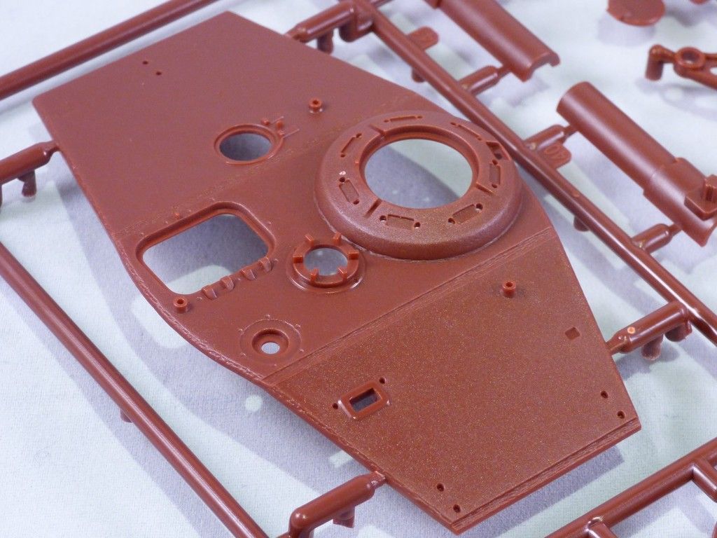

Turret roof with nice weld detail. Designed to left unglued if adding the interior.

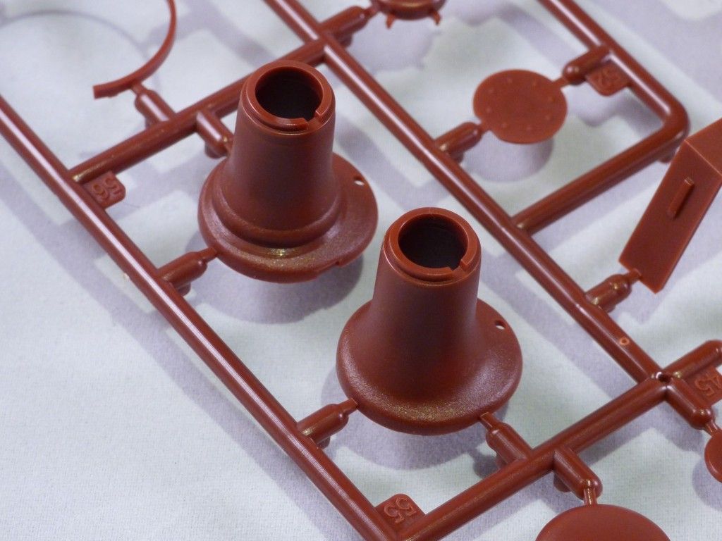

Both types of mantlet included.

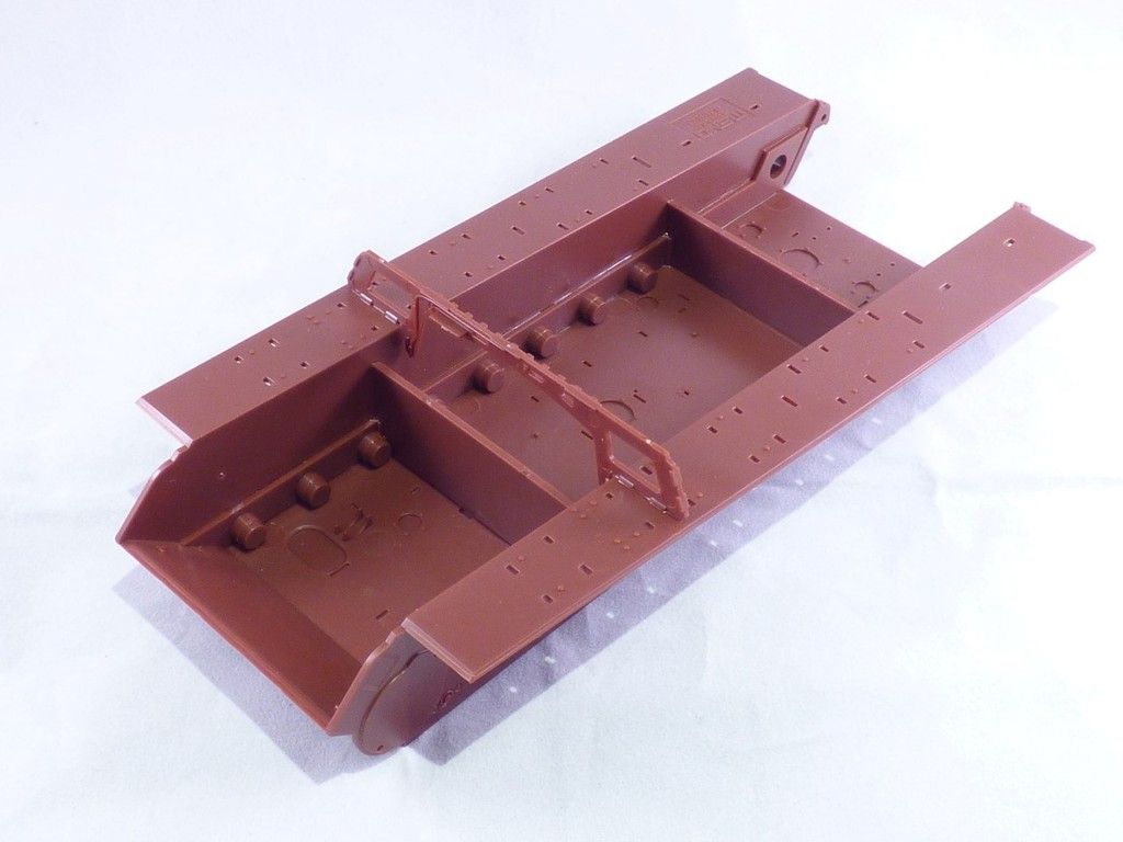

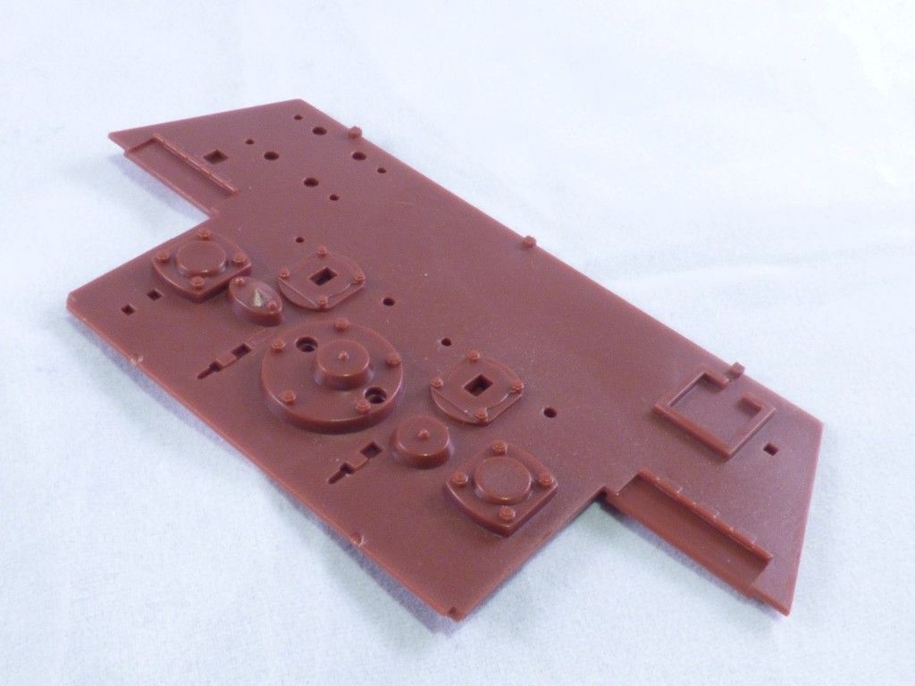

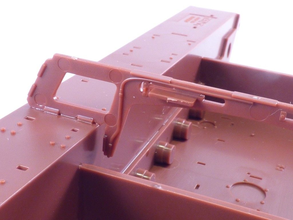

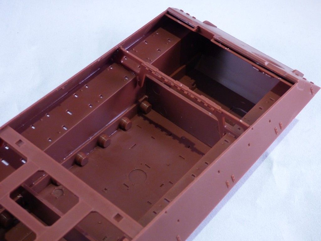

Lower hull tub. Note that there are a lot of locating holes for the interior that will need to be filled if leaving the fenders off.
Hull roof is also separate for easy viewing of the interior.

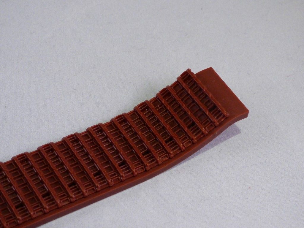

Link and length tracks very nicely detailed. Not a pin mark in sight :)

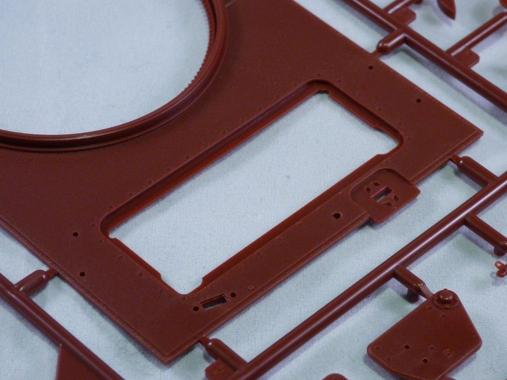

Upper hull with excellent detail

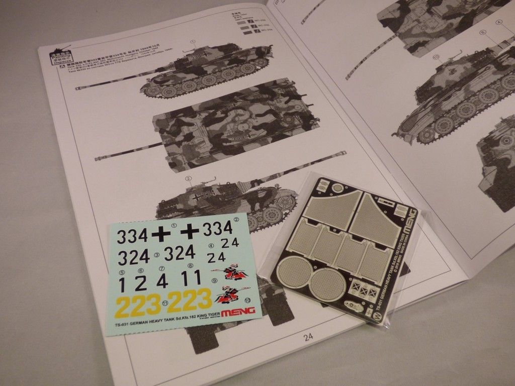

PE, decals and Instructions showing some of the 5-view painting guide. Nice to see all 4 decal options having a full painting guide too.

Accuracy wise, there is very little to comment on. The only 'issue' being the the turret ring is molded to the hull roof. This should be part of the turret but it's not really an issue and it was likely done this way to keep everything lined up. The kit best represents a vehicle built between June and mid / late August 1944 and would be better off having zimmerit applied. Of the 4 decal choices, the 2 with zimmerit are closest to the details provided but '124' of Pz Abt 505 will require a few parts to be left off. The 2 options without zimmerit will require a few more changes to be 100% accurate. Most of these details are minor in reality so unless you are wanting to be as accurate as possible, it's a non issue. My only other comment would be that I have doubts about the painting guide for option 4, '324' Pz Abt 509. I'm yet to see a photo of a partial whitewash over ambush camo as depicted but would be happy to see one :)

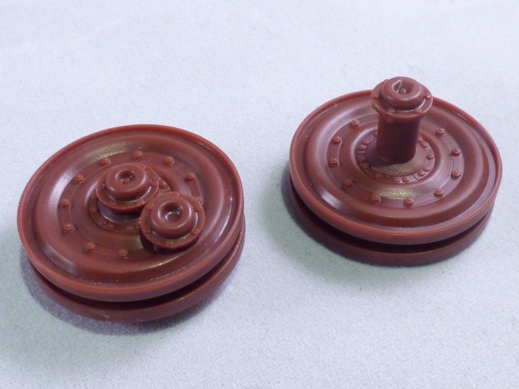

The breakdown is the same as most KT kits so nothing new here. They are very nicely detailed with only a very fine mold seam to remove. Here you need to chose which hubs you want to use but Meng doesn't explain the difference. Parts B13/14 represent the common hubs with the D shaped depression whereas B11/12 represent the late circular hubs. Unless you are building a late version use B13/14. A small poly cap is sandwiched in the middle of each wheel which will help with building the tracks and painting.
The sprocket and idlers are also very nicely done. Note the fine casting number on the hub of the idler wheel. The fit of the idler parts is very tight, you could probably not bother gluing it together.

Step 2 - Hull
The lower hull has been designed to accept workable torsion bar suspension but this is not included in the base kit. Instead, Meng have you fit inserts into the hull to act as anchor points for the non workable swing arms. There are also 2 inserts that act as bracing for the hull as the main firewall is also not included. I also decided to add the forward hull brace at this point.
Meng would also have you attach the the front hull extensions in step 2. I would advise against this as you would then have to slide the upper hull underneath them. It's much easier to drop the hull in place and then attach them, especially if you are adding the interior. Just a note on the hull brace for those adding the interior. The detail is great but there are some considerable pin marks which may be a bit of a pig to fill. They will be very noticeable with the hull roof removed.

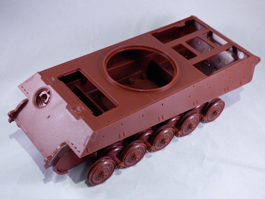

At this point I decided to stop following the instructions and get the hull together. Meng would have you build and detail the upper and lower hulls separately and then joint them together at the end. I prefer to build the main components first before adding the smaller details to avoid breakages.

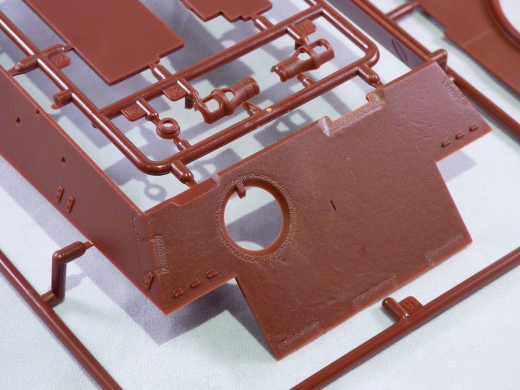

First up to add was the rear plate. Strangely the sprue attachments are on the detailed side of the part. You will have to be careful cleaning them up and some the surface texture will be lost.

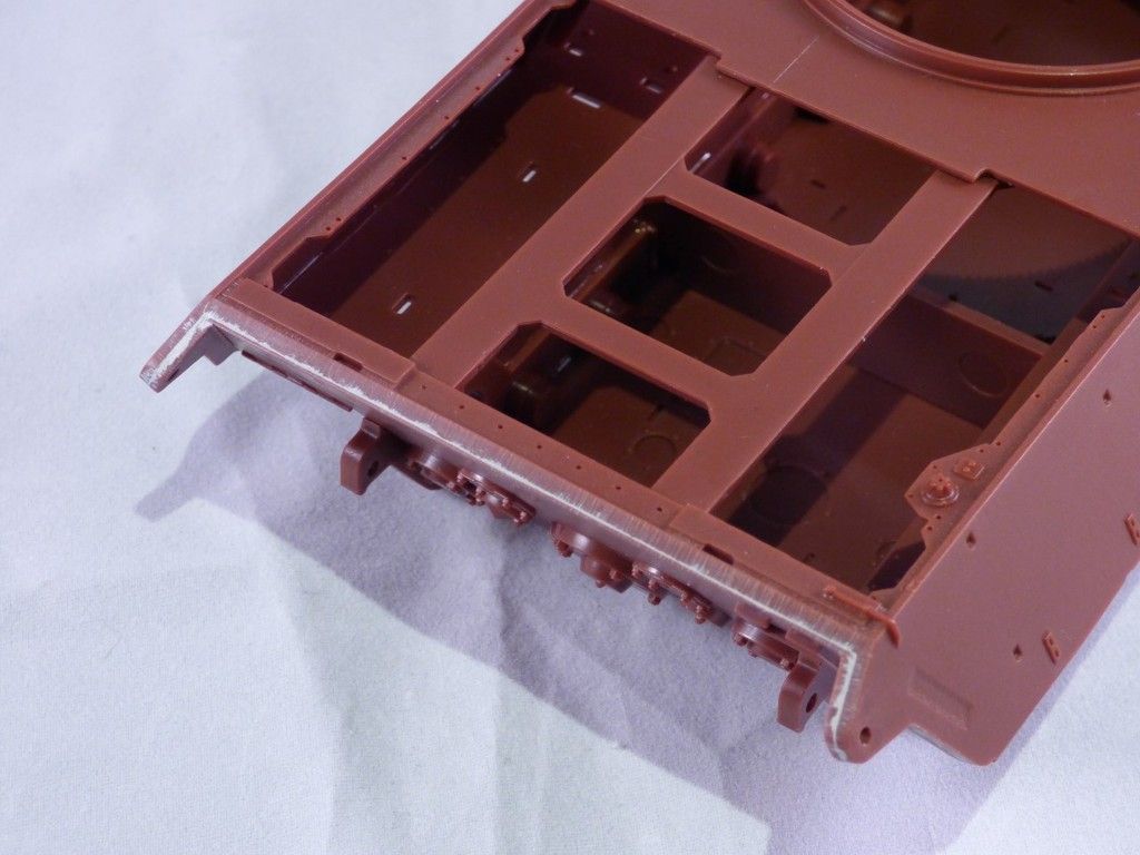

Once the rear plate had been fitted the upper hull was cleaned up. There are some large pin marks on the inside of the upper hull which may need to be cleaned up. For the exterior version there is a large brace to be added to the upper hull which provides more rigidity and also provides a mount for the engine deck plates.
This is the hull glued together. With the roof plate left off you can glue it all together from the inside.
Here you can get an idea of just how much of the interior will be view-able with the roof plate removed. Certainly a good solution if you don't fancy doing cutouts.
My only gripe with the exterior detailing is how the upper hull attaches to the rear plate. There is a noticeable join which will need to be filled. A shame really as some of the nice flame cut texture will be lost :(

Looks good but the join on the rear plate raises the question if these kits were designed by modellers.

Stix, Bernd, got to agree that it is not something you would expect in a new kit. The join seam I can understand considering the design of the kit but the attachment points is a strange one. Some of them are perfectly placed while others appear to have had no thought put in to them at all. It's not a huge issue by any means but when the rest of the kit is such high quality, it stands out.

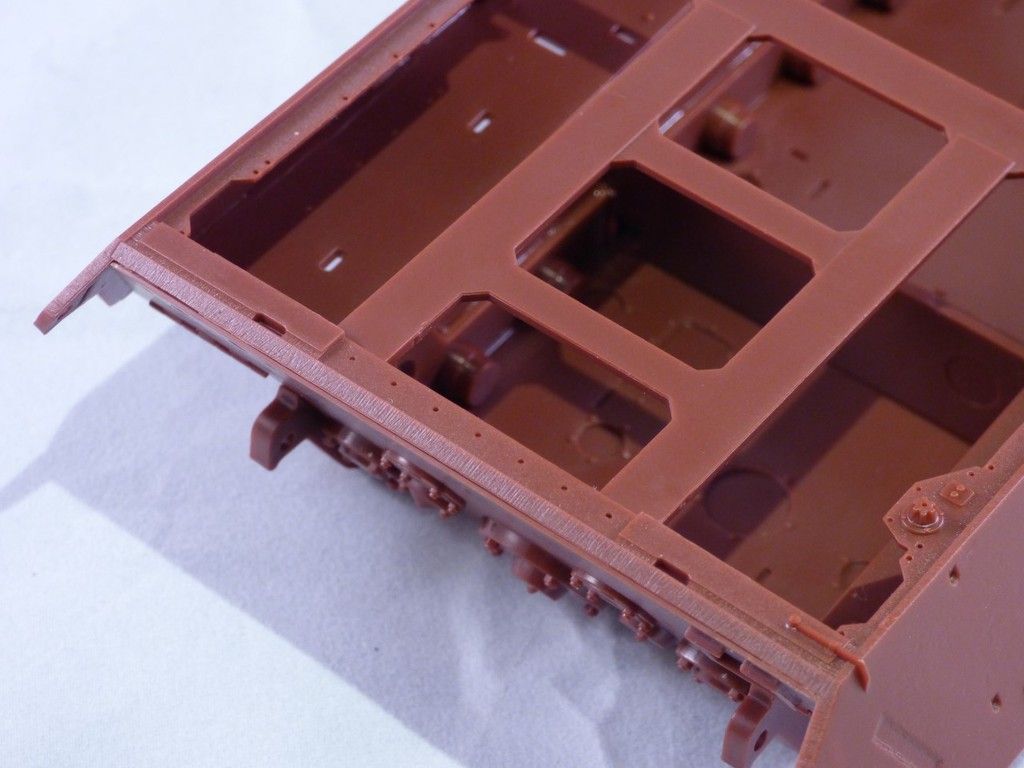

Hull - Continued

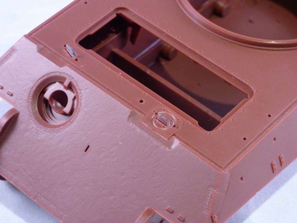

The hull roof has now been fitted, along with the front periscopes. The fit is very precise.

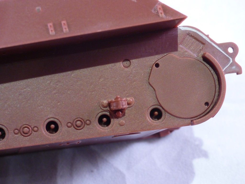

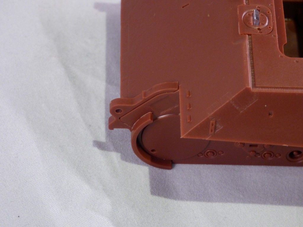

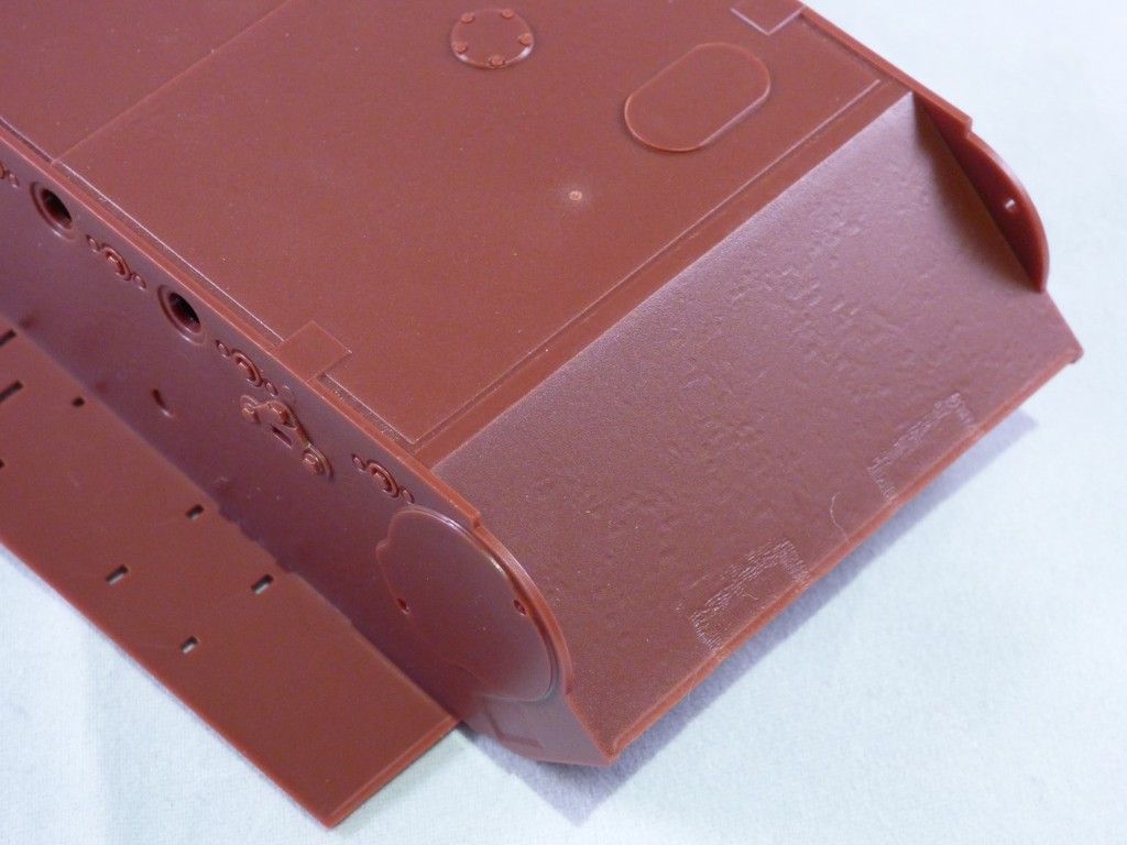

The front hull extensions are now on. Strangely fit is quite poor. After some sanding and scraping they still would not fit flush. Some filling to be done here.
The rear hull extensions have also been fitted. This creates more seams to fill :( I tackled this now, also adding the flame cut texture that has been sanded off.

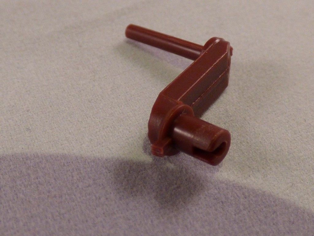

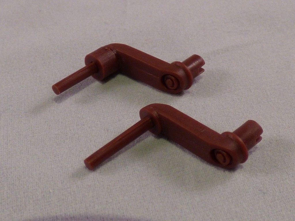

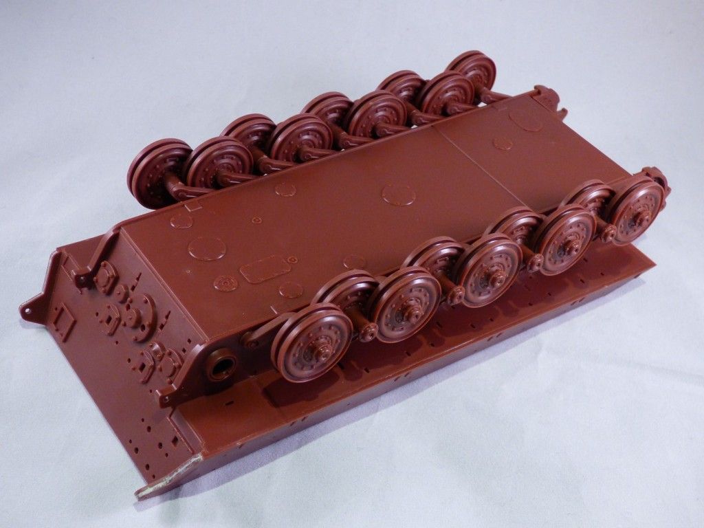

Next I cleaned up all the swing arms. There is an annoying attachment point that will interfere with the fit to hull which needs to be carefully removed. There are also some quite thick mold seams that should be removed.
As all of the swing arms are the same, Meng have you add spacers to ten of the arms. This creates the spacing for the outer wheels.
So now onto the first issue I have had with the kit. I've mentioned that some of the kit is precision fit and it turns out this is true for the suspension. When I fitted the two inserts inside the hull for the swing arms (C3/4) I was certain they were properly in position. It turns out they are are not! The holes in the hull do not fully line up with with the inserts. It doesn't look like much but the precise fit of the parts means most of the swing arms will not fit :facepalm:
The solution was to cut off most of the locating pin on the swing arms and glue them in place by eye. I'm quite happy with the result considering the issues.
I really can't say if this is an issue with the kit or one of my own doing. One thing that is for sure is Meng leave you with no room for error here. Double check the alignment of the inserts before gluing them!

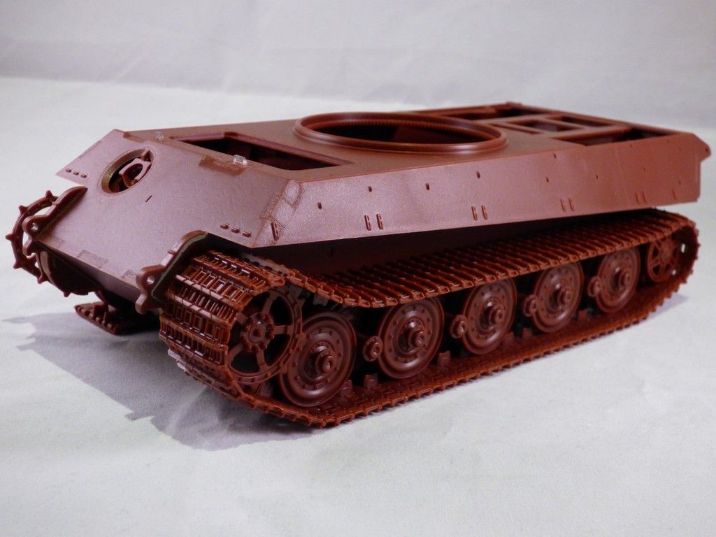

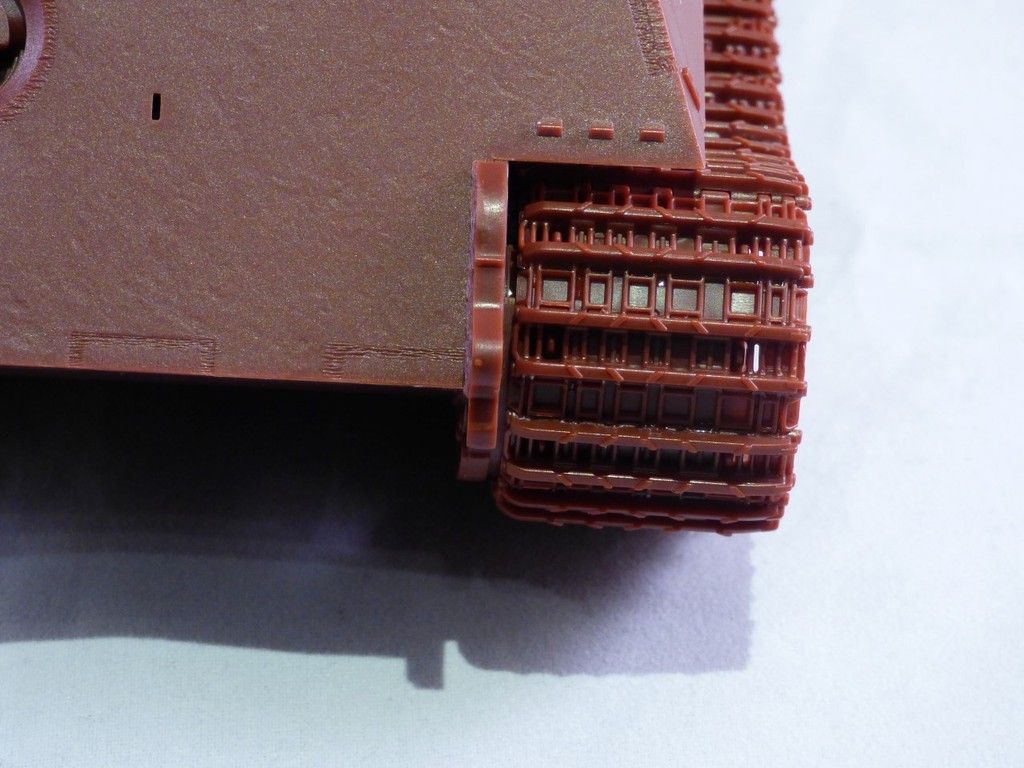

Step 3 - Tracks
I've now started work on the link and length tracks. Meng provide you with a jig for the upper track run to get the sag just right.
I built up the rest of the left track pretty quickly. I think the link and length system works quite well and should look good under a coat of paint.
I would suggest gluing the running gear in place once painted. Despite the ploy caps there is a bit play in the wheels, sprocket and idler which allows the tracks to sit at a angle. I'm certain that some of the blame lies with the swing arm issues I had but the sprocket and idler are particularly loose. The tracks tend to bow inwards.
