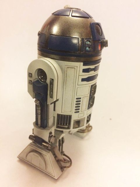

As i see that i am not the only Star Wars fan here (there is a good bunch of pretty Star Wars kits builds here), this is some pictures of my C3-PO and R2D2 WIP

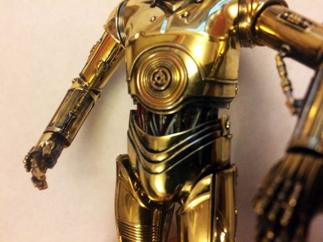

C3-Po was very easy to build
R2D2's colors was not very nice in my humble opinion. The blue parts and the aluminium parts didn't pleased me so i decided to paint them.
So I sprayed a coat of white on the white parts, and a coat of Tam X4 blue on the blue parts.
Then i coated the grey parts with a layer of Alclaad black primer
After a couple of days i started to spray some Alclaad aluminium layers on the black parts
I've been very pleased by the alclaad render - it was the first time i used this product.
The metalic render is very good.
The only problem was that the R2D2's head is made from two half domes that don't fit very well...
I used some Klir + talc powder to seal the gap between the two parts :

I'm thinking to add some weathering on R2D2 (water+ liquid soap + pastel powders) but i'm affraid to try a weathering on C3-PO because don't know what to use on that shinny gold and chrome plastics to keep them shinny and also because i read that some plastics used by Bandai don't like certain solvents and i no longer remember which ones.
Any advices please, some body  ?

When I did mine I wanted them slightly tarnished, not so heavily weathered. All I did was apply some oil painting wipe it away after a couple of minutes.
I think it really helped pick out the details 3PO and the paneling on R2.

I used a oil paint & solvent on R5D4 which I built 1st... It eat through his ankles poor soul... I did manage to save the kit but his feet are glued into place.
After a bit of experimenting with left over parts and sprue I figured out its the solvent not the oil paint that Bandai plastic doesn't like.
Have a bit of a play with some of the spare C3PO parts.

Here is a first attempt of (light) weathering using pastel chalks + water + windows cleaner fluid :
I've been pleased to see that the wash made with pastel powder + water and windows cleaner soap can also be used on alclaad !
