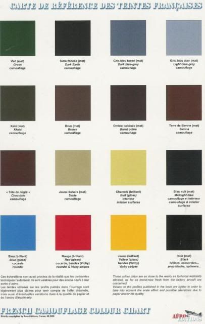

sapperastro Posted December 5, 2016 Posted December 5, 2016 Hello all, I have a couple of French WW2 aircraft kits incoming, and wish to know exactly what colours to use with them. Especially the 3 tone upper (bluey grey, brown, green/light blue underside).
Black Knight Posted December 5, 2016 Posted December 5, 2016 Try this website for a starting guide http://www.ipmsstockholm.org/colorcharts/stuff_eng_colorcharts_france.htm
spitfire Posted December 5, 2016 Posted December 5, 2016 This might help as well http://memorial.flight.free.fr/nuancier.html Also I collected this on my travels, I think it was from Modeldad over on HS. Cheers Dennis
sapperastro Posted December 5, 2016 Author Posted December 5, 2016 Thanks Blackie, that is a great website, but I didn't even think to look at that section... Spitfire, thank you for both of those links. Now I can hold my swatches up and get a (as far as monitors allow, good match for any of my differing paint brands. I should be able to suss out the correct colourcoat paints with these too. Thanks again gents. I appreciate the help.

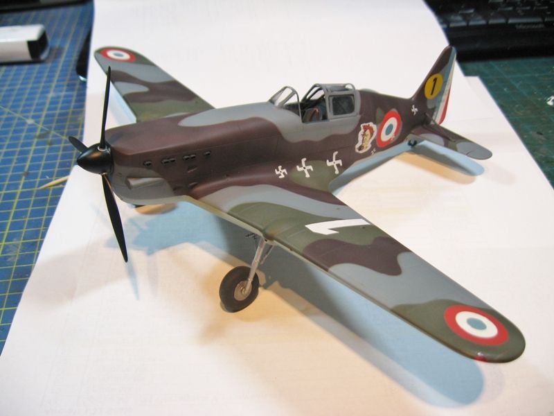

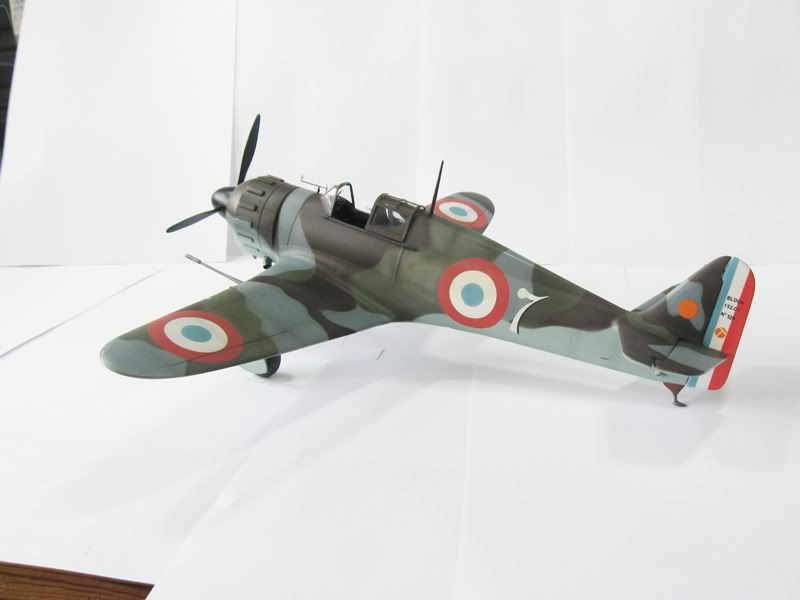

spitfire Posted December 6, 2016 Posted December 6, 2016 The ACF04 Chocolat and ACF09 Gris Bleu Clair look great but the Kaki looks a lot more realistic than the Vert, here's a wartime photo of a D520 that shows it well. Here's my attempt at an MS406 and a Bloch 152 using Colourcoats and Xtracolor as mentioned. Cheers Dennis 2
sapperastro Posted December 6, 2016 Author Posted December 6, 2016 Is that a four colour scheme spitfire? The reason I ask is because of the colourcoats swatches on their website have the French Kaki being a very dark greyish hue, similar to the colour on the tail. The Kaki I am seeing in that picture, near the exhaust vents, seems more like the tried and true Khaki of uniforms and so on. Perhaps I am actually colour blind...
