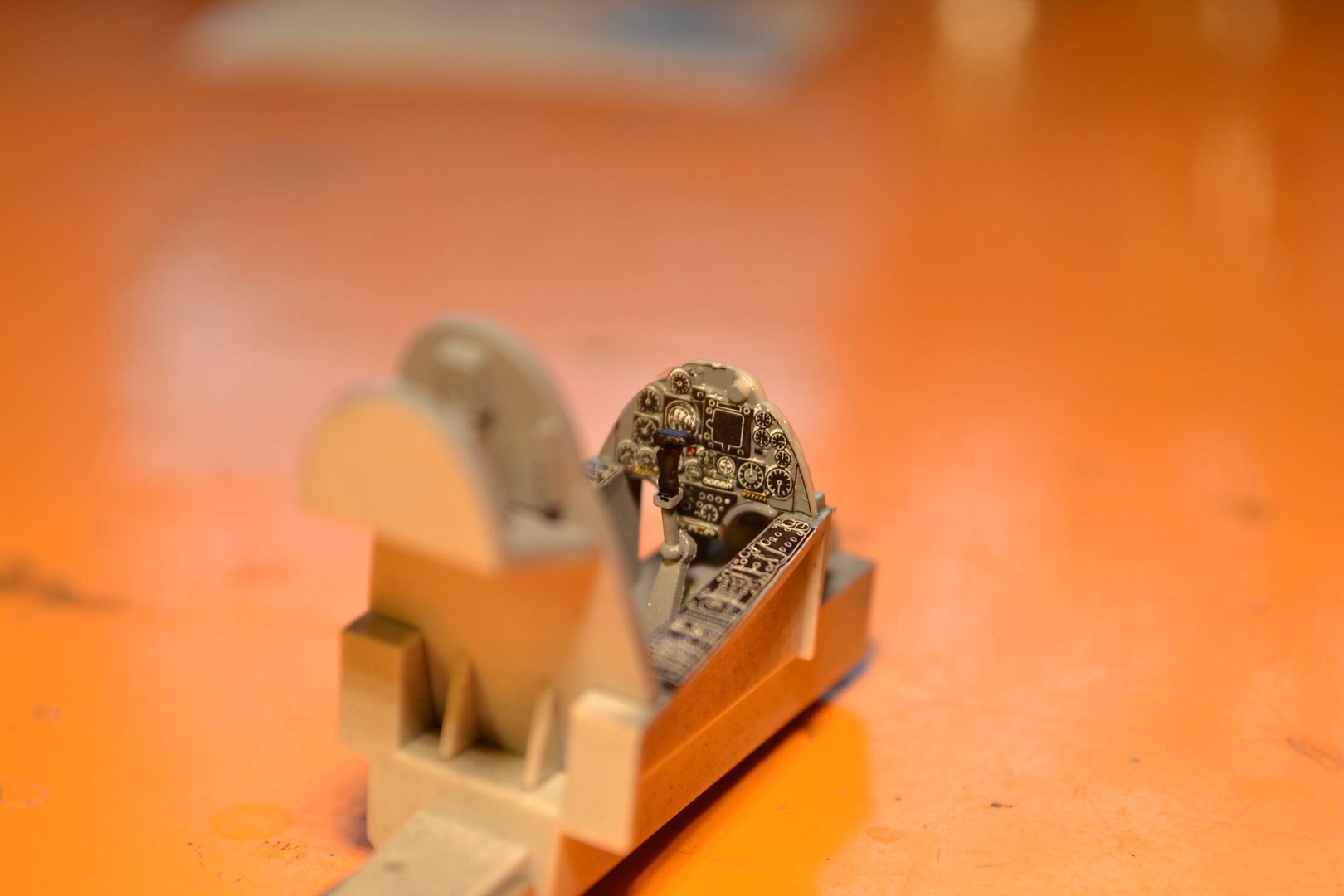

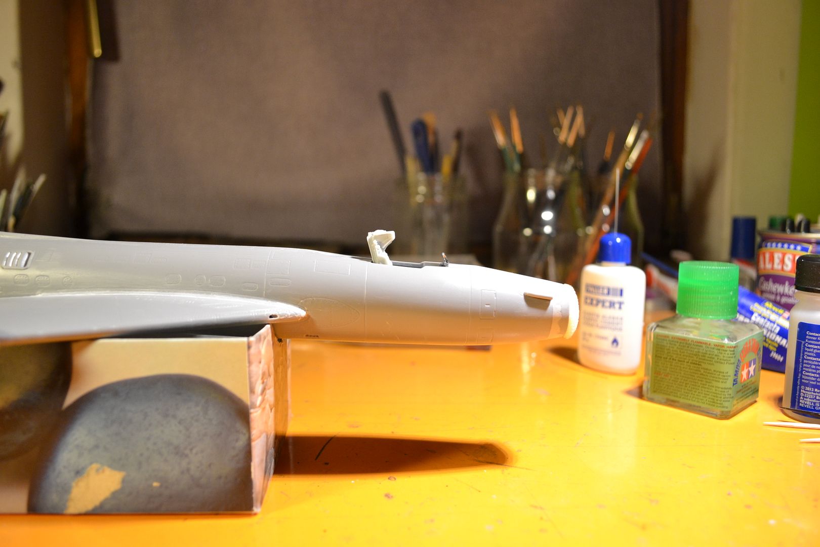

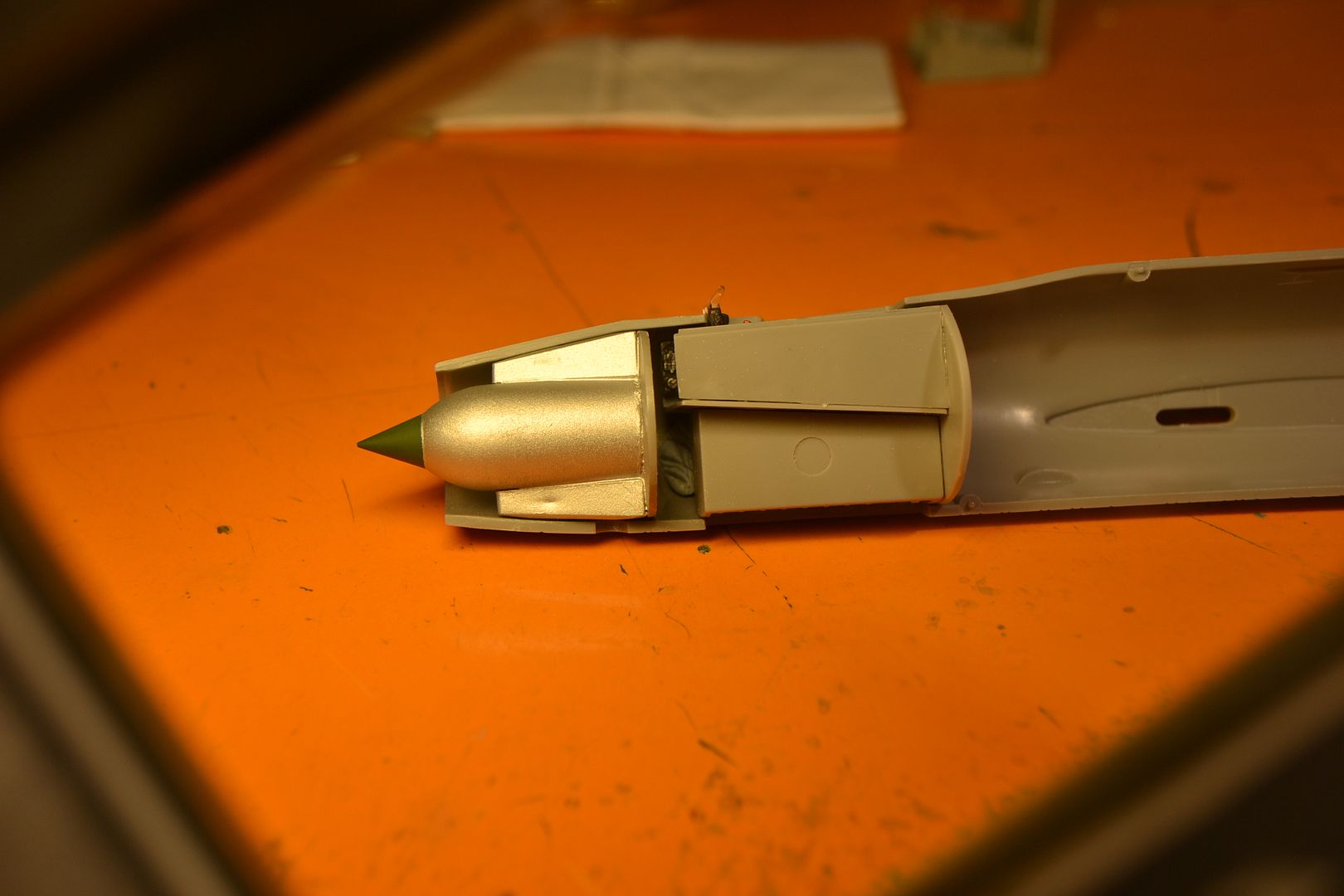

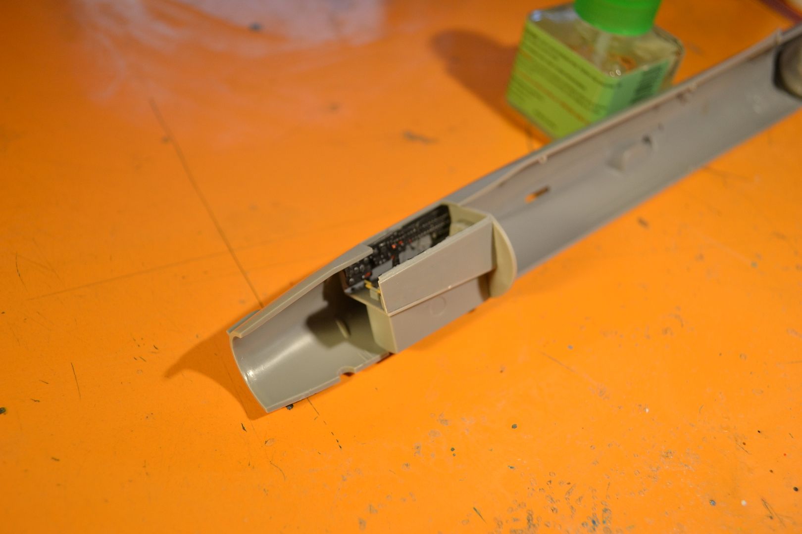

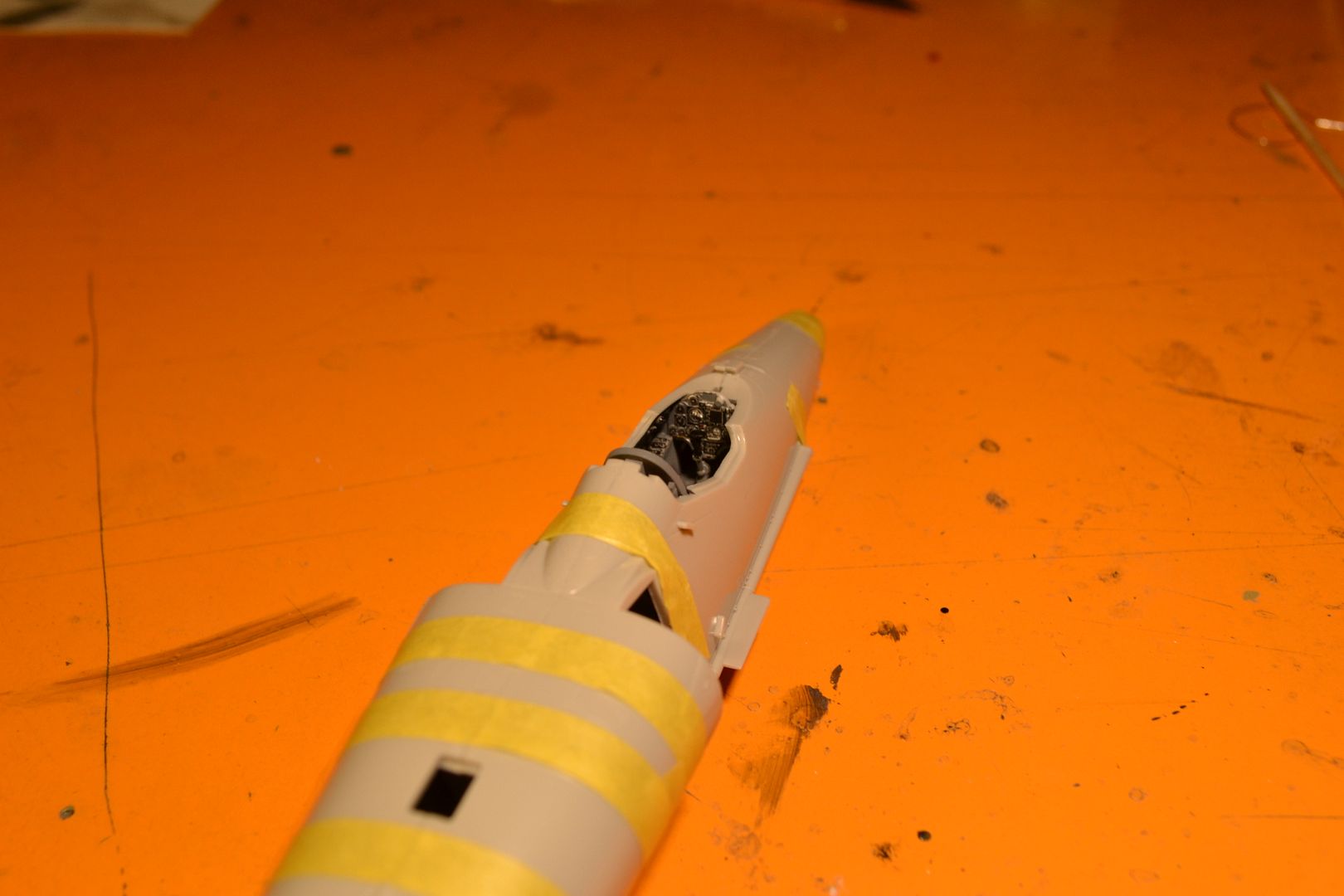

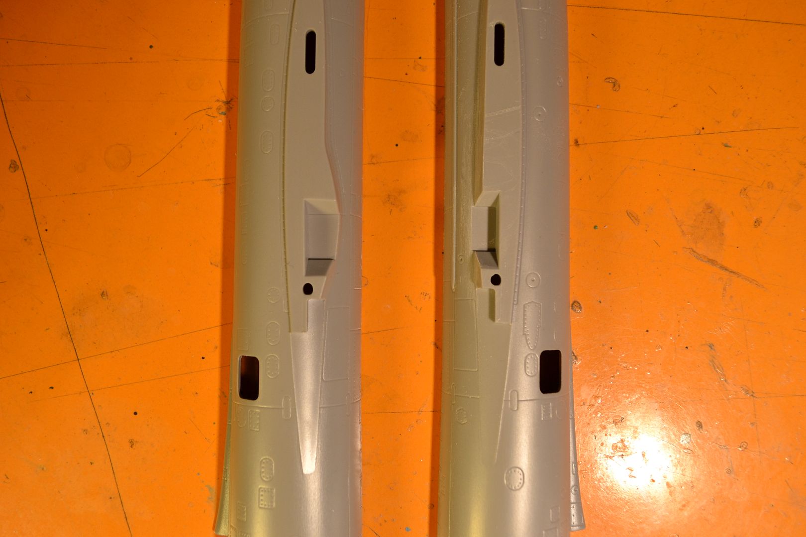

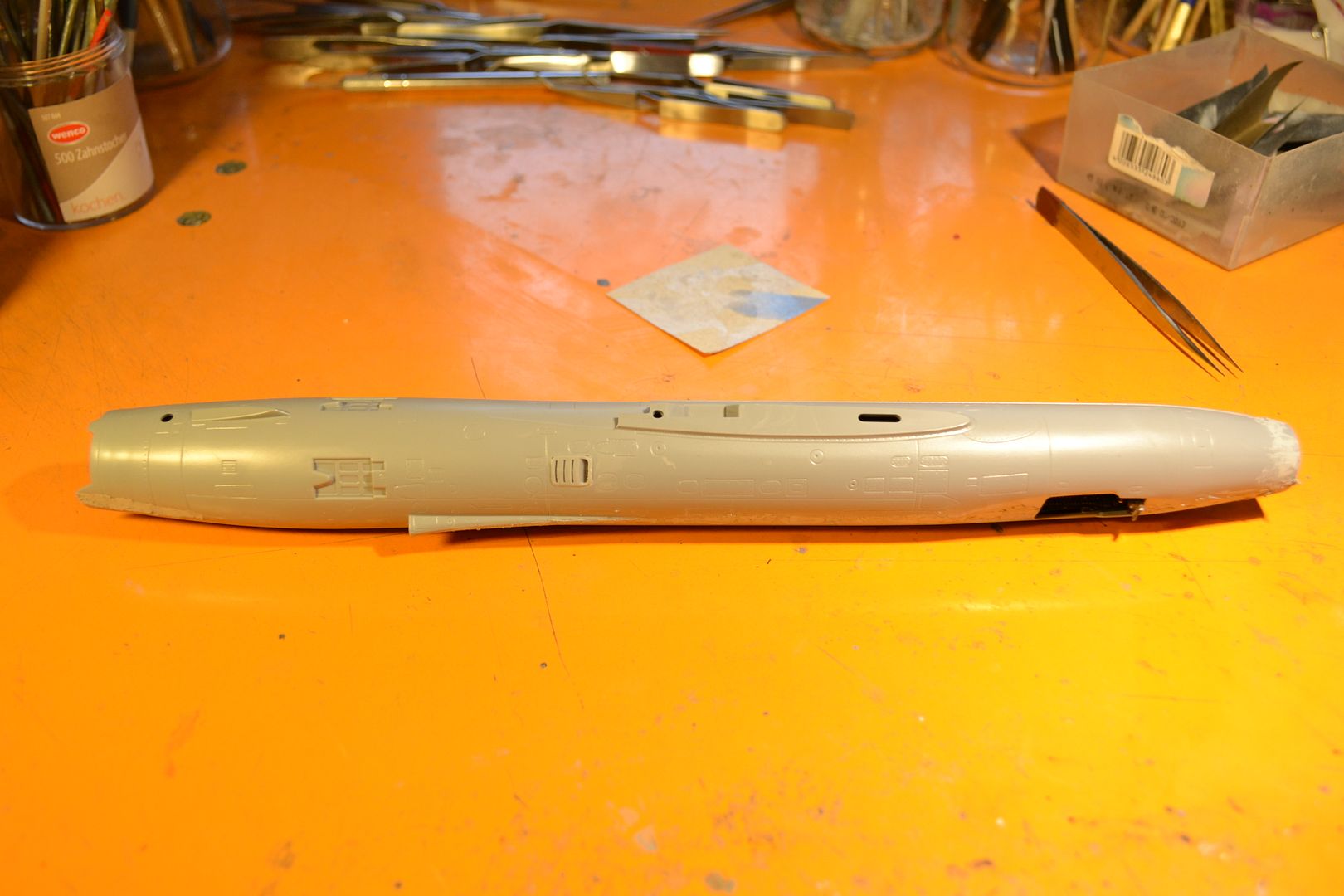

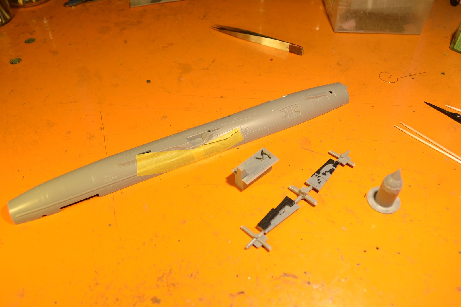

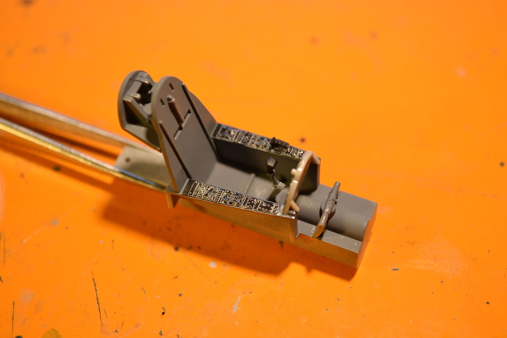

Slow progress with the beast, glued in the air intake cone, about 5mm more forward then it is shown in the instructions. According to the plan, the cockpit tub should be glued together with the backwall of the nose cone, but if you do so, the tip completely disappears in the fuselage after you apply the nosering, which would be wrong.
put some weight into the nose cone, added some more around the cockpit tub using lead paste by Uschi van der Rosten

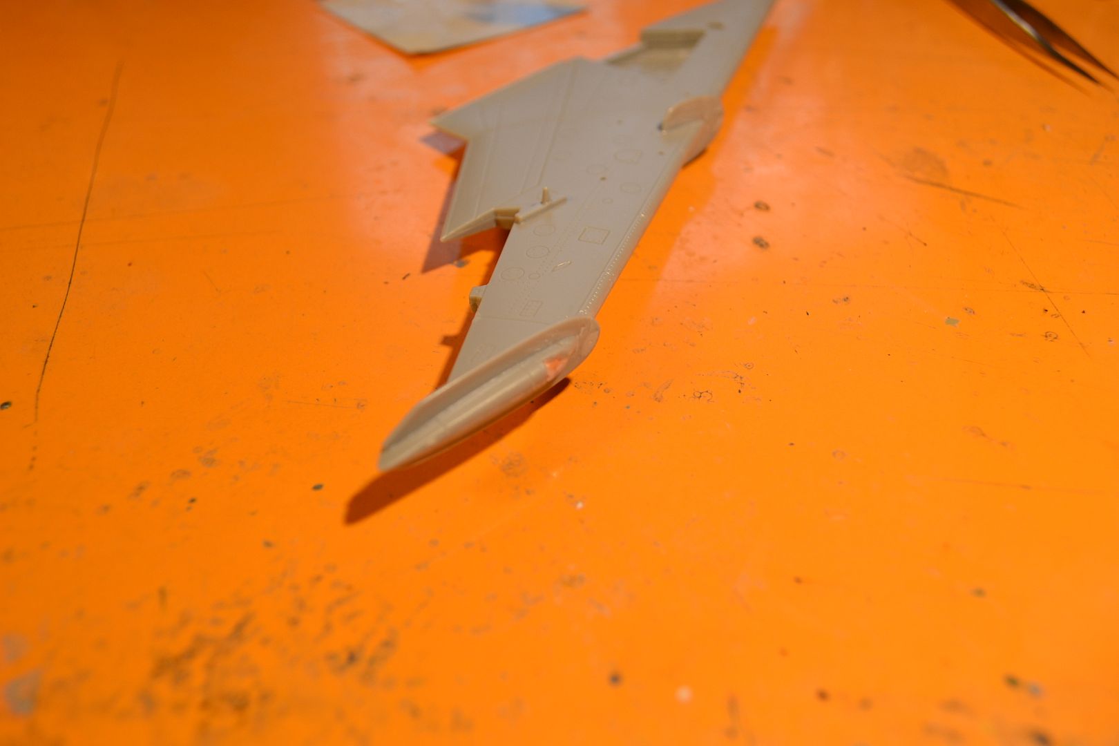

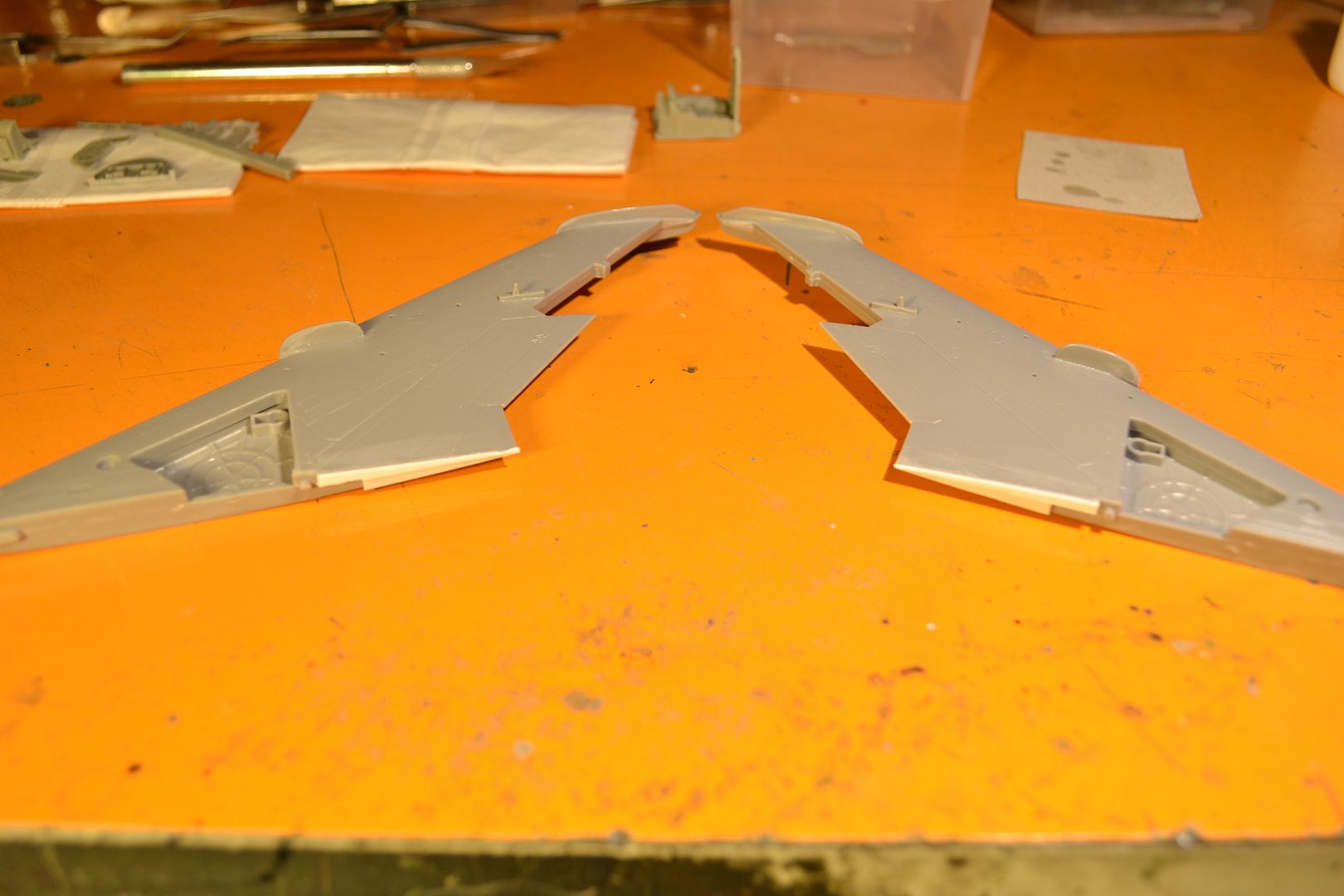

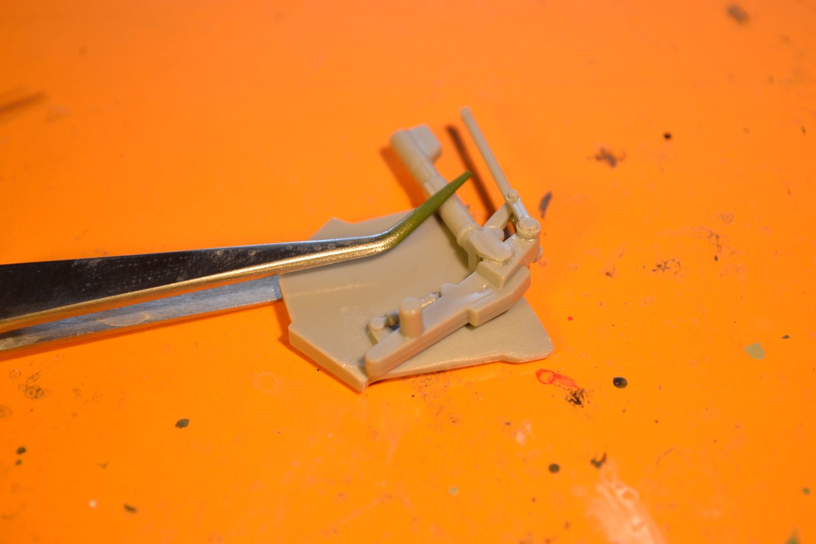

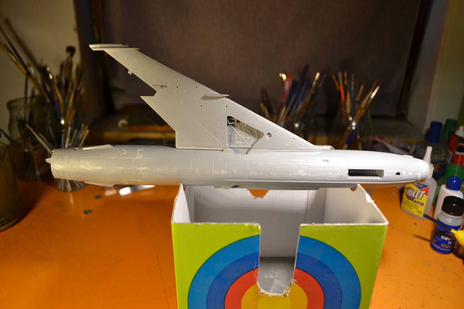

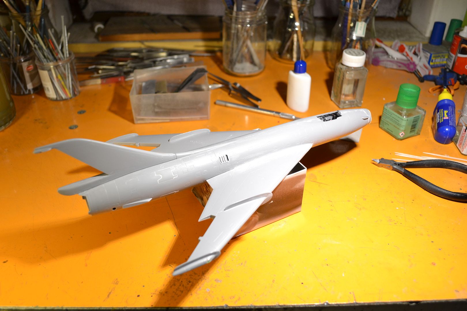

there is a bigger gap between flaps and fuselage, so glued some plastic sheet onto the wing parts to close the gap

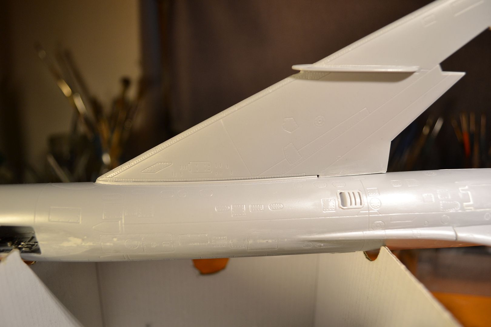

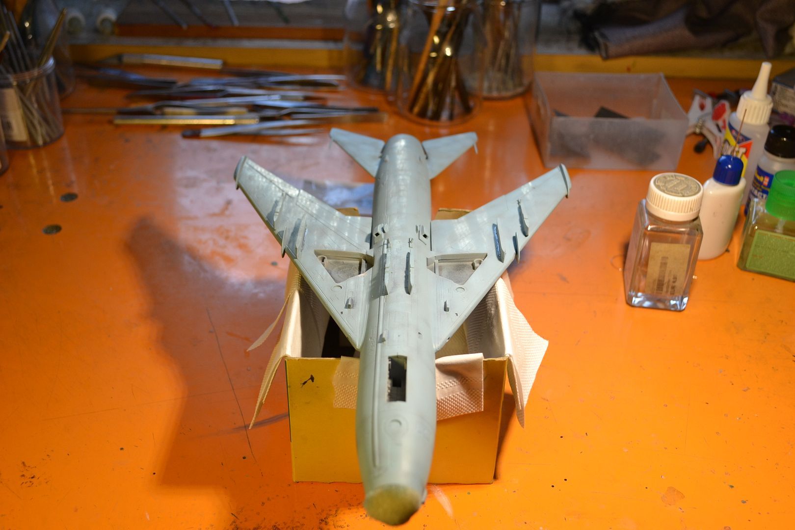

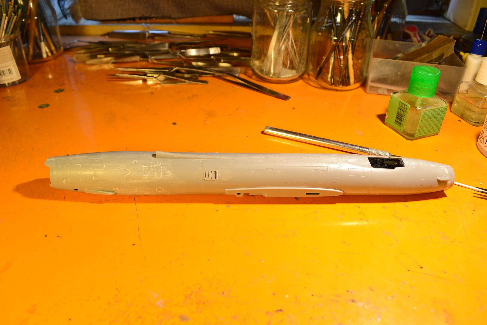

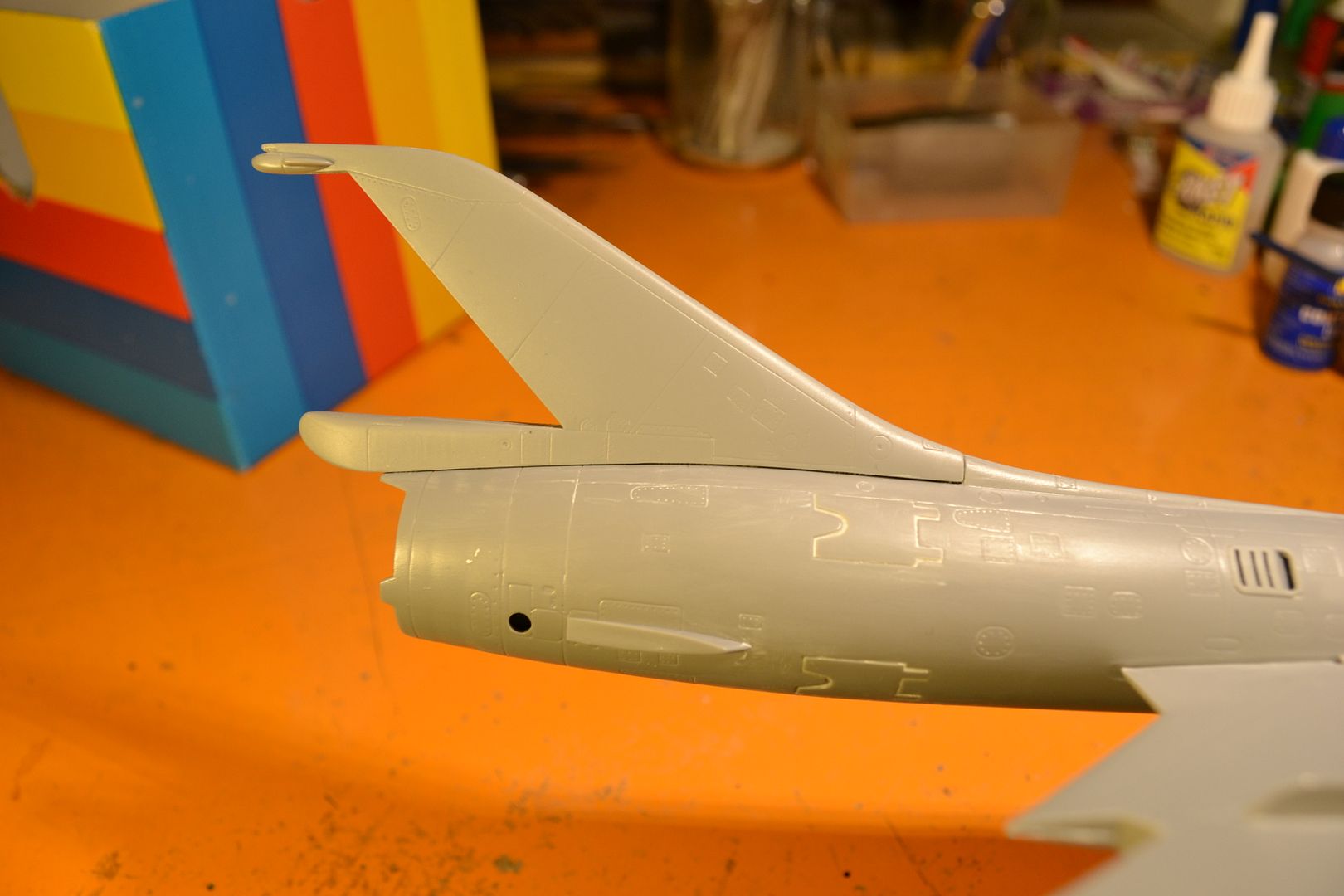

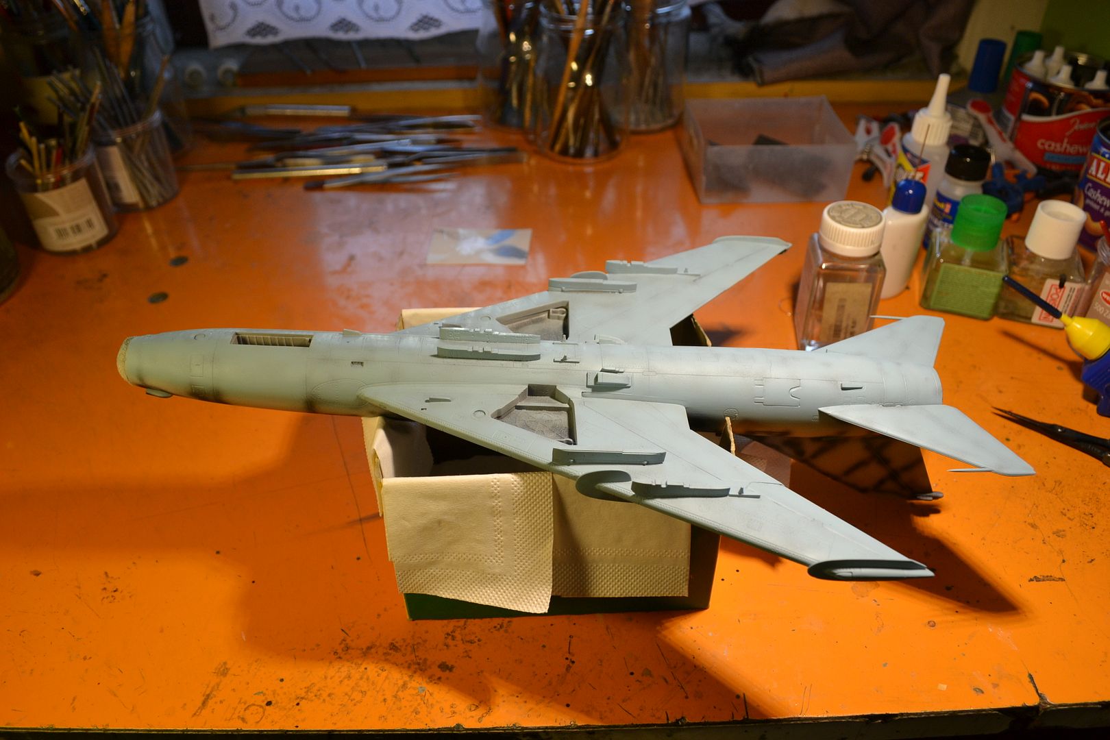

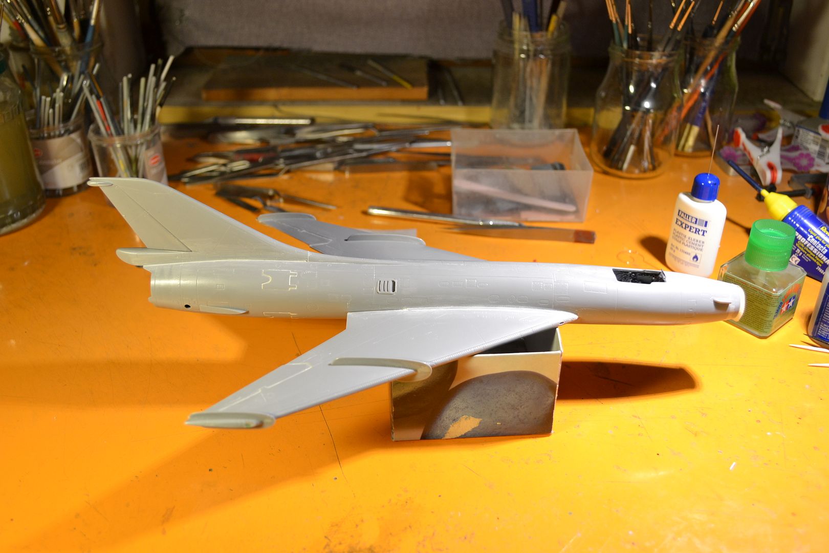

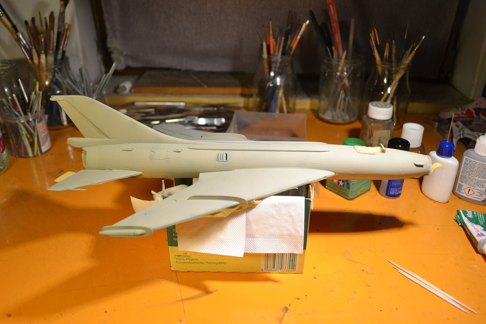

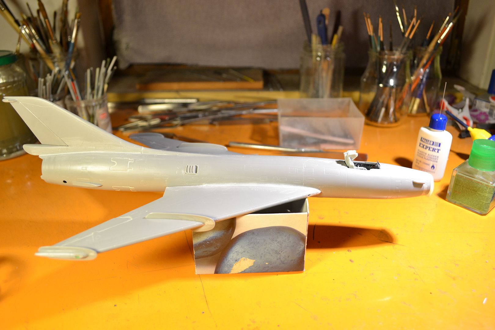

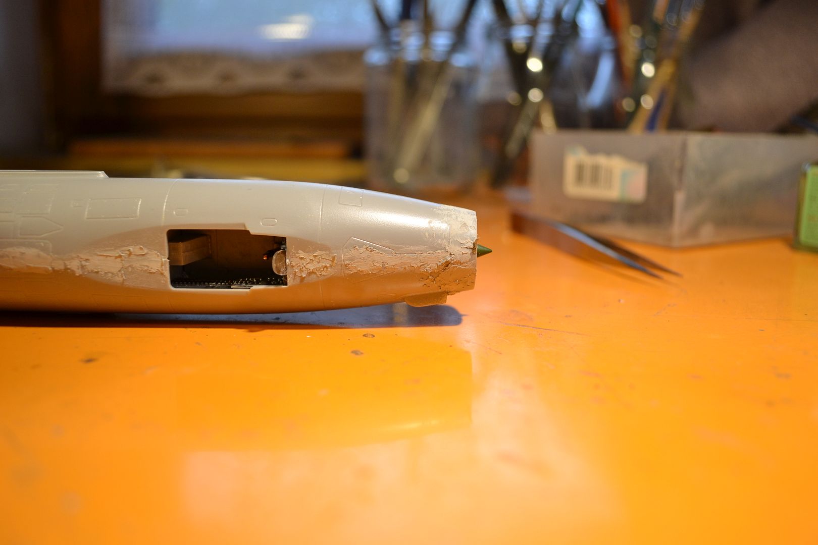

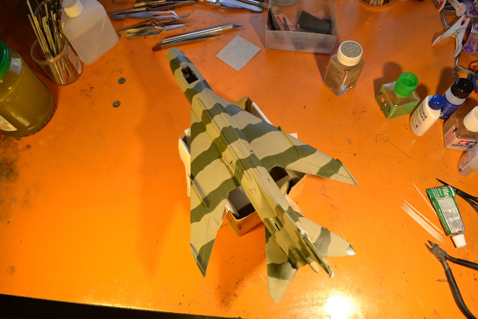

Big step to victory! :D fuselage closed, now filling, sanding, re-scribing
And as you can see, the air intake cone tip looks out as it should.

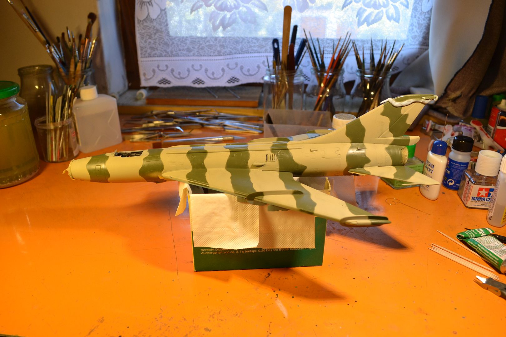

already made the position lights, they are gonna be painted together with the camo, afterwards washed off again

impressive build so far!

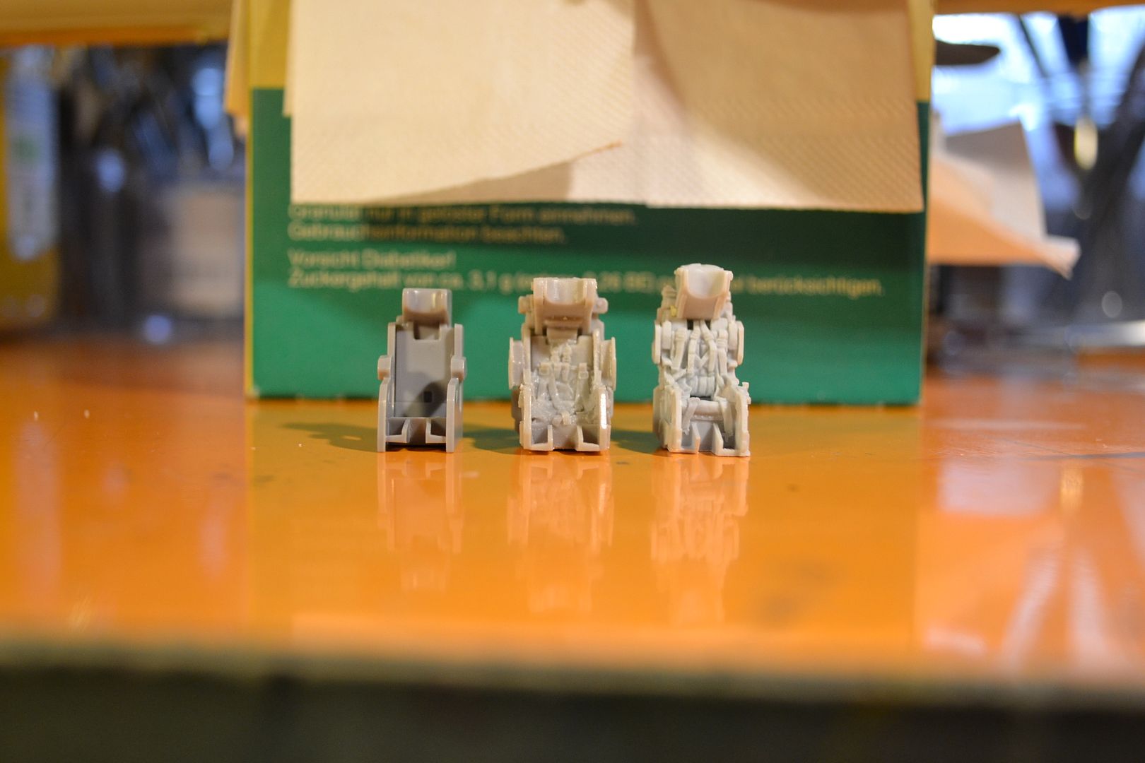

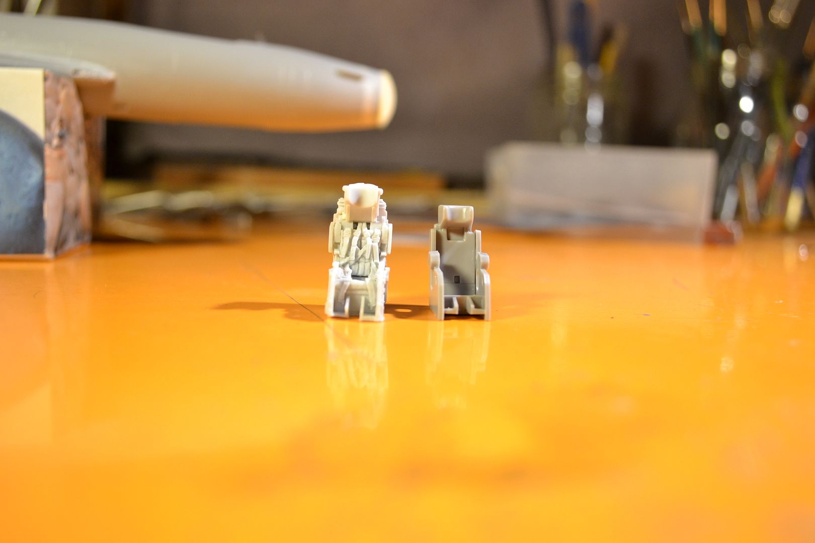

but how come????! that is hardly possible no? is it really said to be or this kit? woldpack-d has a cockpit set also listed on their hompage.. but unavailable still.... maybe the seat only fits their cockpit!!
:huh:
maybe you should tell them!
:huh:

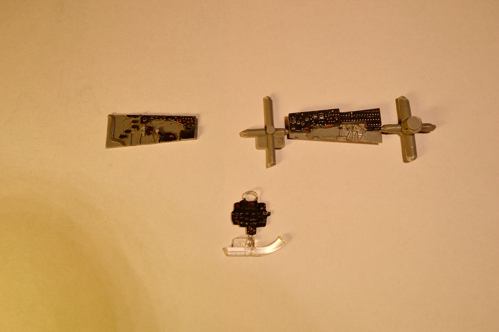

yes, written on the package, for 1/48 Kopro kit....gonna keep the seat, maybe it fits in/for another model
Link to comment
15 hours ago, toniosky said:
Good work !
I had the same kind of issue with the resin seat provided in the special edition kit from Eduard.  I ended up lowering the cockpit floor and sanding down the seat a bit...
 my dad´s gonna try out a resin seat from Pavla (not yet arrived), see how that one works..

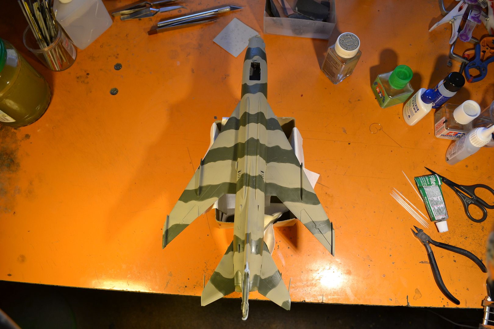

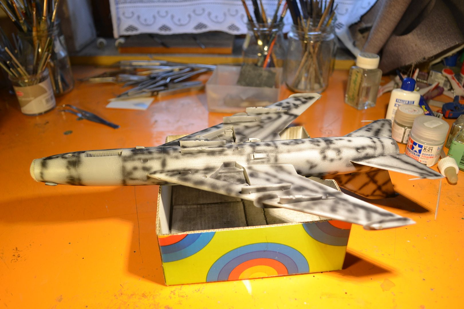

wow!
looking perfect!
colors are spot on I'd say!
where do you get  BluTac from?
strange thing about the seats!
I would like to compare those to the Eduard offering! wonder if that one actually fits!
