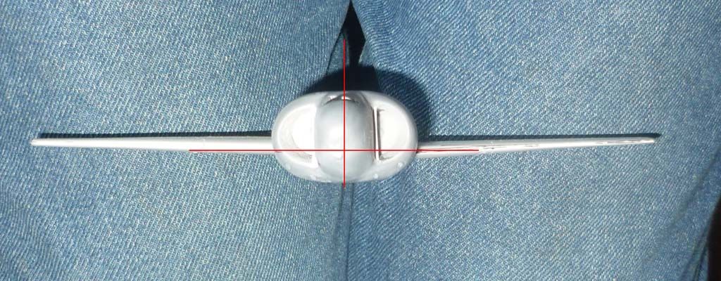

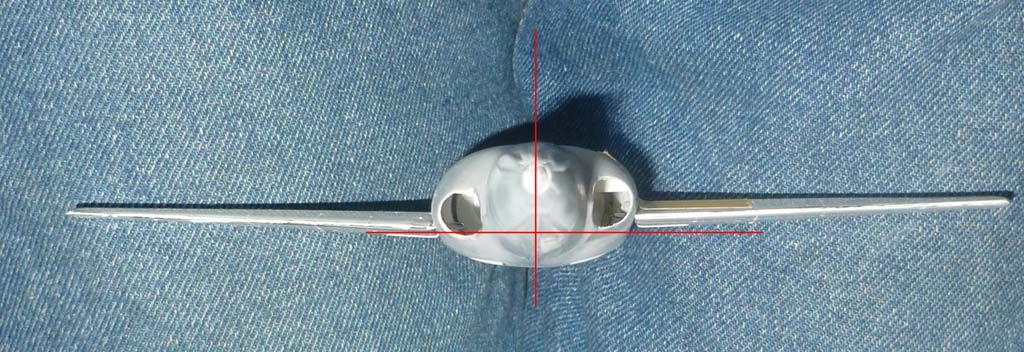

John R Posted September 26, 2016 Share Posted September 26, 2016 (edited) All seemed to be going quite well after starting to build one but when I came to fit the wings to the fuselage it was obvious that something was very wrong. One wing seemed to be higher than the other. Further investigation revealed that when the fuselage was viewed from thr rear one engine exhaust outlet was significantly higher than the other. Has anyone else encountered this problem and what can be done about it? John PS. I wonder if the same problem is present in the Whirlykits version? Edited September 29, 2016 by John R Link to comment Share on other sites More sharing options...
Andrew Jones Posted September 26, 2016 Share Posted September 26, 2016 Short of cutting the fuselage and relining everything up , probably not a lot you can do. I haven't actually seen this kit , but if it's not moulded evenly then the "cut and shut" is normally the only option or live with the discrepancy. Andrew Link to comment Share on other sites More sharing options...
Kevin Callahan Posted September 29, 2016 Share Posted September 29, 2016 My understanding is that the Whirlykits is the same plastic (maybe with some added resin; not sure). So any problem you had with this will likely be present there too. Link to comment Share on other sites More sharing options...
John R Posted September 29, 2016 Author Share Posted September 29, 2016 I have been in contact with Whirlykits and it is indeed the same mould and it has the same problem... The error is fixable. When some filler has dried and been sanded I'll post pictures in the next day or so. John Link to comment Share on other sites More sharing options...

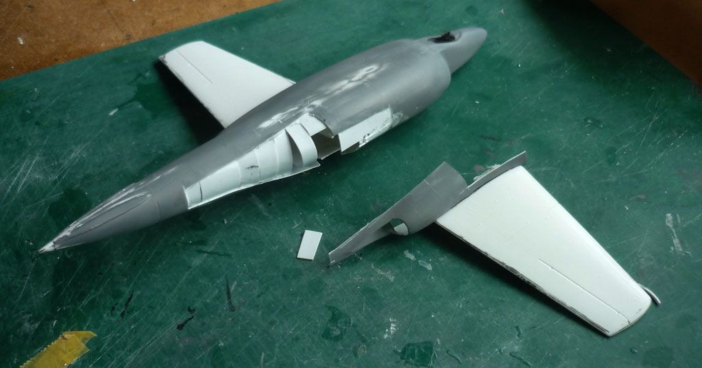

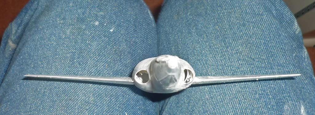

John R Posted September 29, 2016 Author Share Posted September 29, 2016 (edited) Progress so far - next step RFI ? First step was to cut out the offending section. Then strips of sheet were put in to replace the removed bits to form an internal skeleton. The cut out portion was then glued to this in a lower position. The wing having been loosely attached to the removed piece so that it could be aligned by eye as it was put back. This left lots of holes and uneven bits which were filled with plastic 'goo' made by dissolving offcuts in cement and then smoothed out with Milliput. It sounds a lot easier and less time consuming than it was but not in the 'experts only' category. Anyway if you want a 508 you have to go through with it as it's the only game in town. I wonder what the rest of it holds in store... John Edited September 29, 2016 by John R 5 Link to comment Share on other sites More sharing options...
