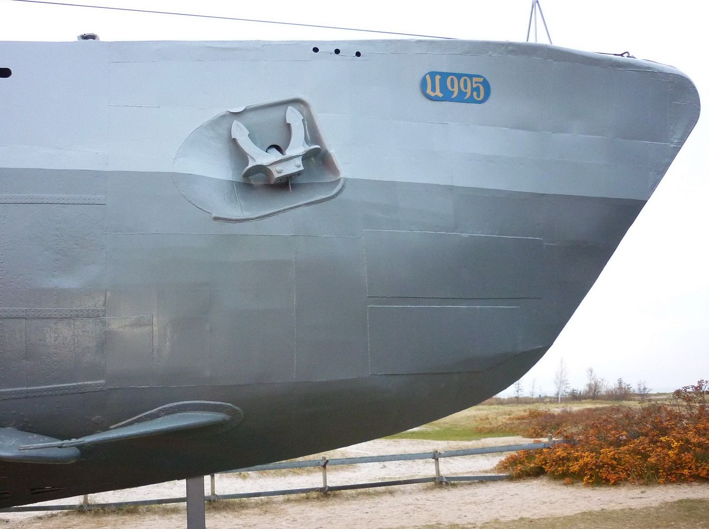

whitestar12chris Posted September 6, 2016 Posted September 6, 2016 Hi Tony i have consulted my library, the anchor is in the right position, unfortunately the planes are too far forward, well spotted. Drawings of the VIIC confirm this. heres a link to a video on the U-995 at Laboe, the first image shows what im saying. all the best Chris 1 1

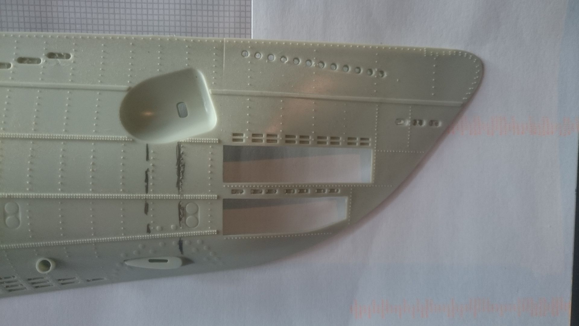

whitestar12chris Posted September 7, 2016 Posted September 7, 2016 Yes it does Billy, had a hull half to hand, definitely too far forward, thanks to Tony for bringing it to our attention. All the best chris 2

whitestar12chris Posted September 12, 2016 Posted September 12, 2016 I have replied, see photos as to why the query, raised by Tony. HI Honer, many thanks for your quick reply, personally I love your submarine models and am looking forward to your type XXI release in 1/72. Heres some photos regarding the query, firstly is a bow shot of U-995 at Laboe, a VII C/41. Secondly is a bow shot of your 1/72 VIIC hull half, note the pencil marks based on the photo observation, hence the query about the bow planes being too far forward and fouling the anchor. Regards Chris King All the best Chris 3
Billydick Posted September 12, 2016 Posted September 12, 2016 Hi Chris, Thats certainly an interesting reply from Revell. Your photo certainly tells the story as it is. Revell can't argue with that. Surprised that the kit has so many rivets compared to what is obviously welded hull plates on the real thing. BillyD

EnglishLion Posted September 12, 2016 Author Posted September 12, 2016 Hi Chris, Thats certainly an interesting reply from Revell. Your photo certainly tells the story as it is. Revell can't argue with that. Surprised that the kit has so many rivets compared to what is obviously welded hull plates on the real thing. BillyD Billy, I'm not too sure U-995 can be relied upon for detailed comparison. There has obviously been patching work done to it to make it a good general exhibit - plated flood holes & torpedo hatches are obvious ones and to my untrained eye, the whole bow on that side looks plated as well. I suspect that explains the lack of rivets. Could be wrong tho. 1

Billydick Posted September 12, 2016 Posted September 12, 2016 Billy, I'm not too sure U-995 can be relied upon for detailed comparison. There has obviously been patching work done to it to make it a good general exhibit - plated flood holes & torpedo hatches are obvious ones and to my untrained eye, the whole bow on that side looks plated as well. I suspect that explains the lack of rivets. Could be wrong tho. Ah yes Tony, of course you're right. I had a look at U534 photos I took in Birkenhead and she too has welded plate work on the hull as repair jobs along side the original riveted plates. Thanks for pointing that out .... BillyD 1
